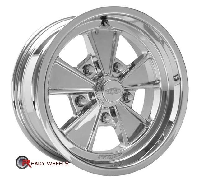

  3. powrshftr
    Joined: Mar 29, 2013
    Posts: 4,551
    powrshftr
    I have to admit,those cragars will make damn near anything look hot as hell!
    They just look a little more ******** racer than Keystones.
    I know Sox & Martin ran keystones,but those cragars just look *****en with a nice paint job,as Ric stated.:)
