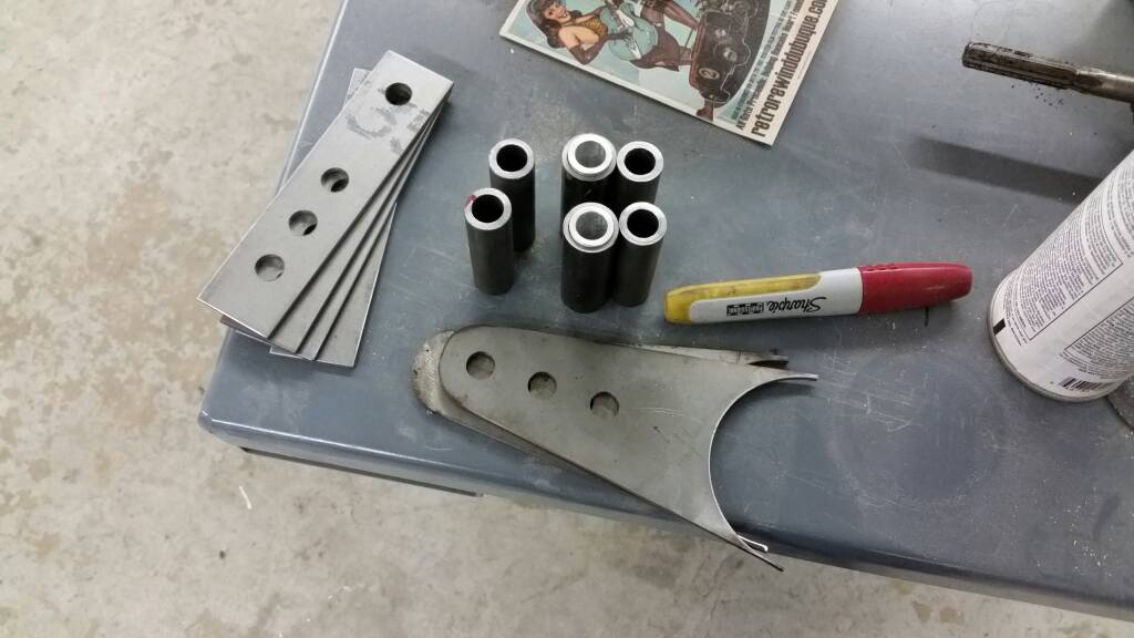

    Made a little progress this weekend. Made a few steps forward and a few steps back. The back steps will pay off in the long run when I first started building this car in my head I wanted to put a FE in it until I looked into building one. This past week Rick got me in touch with the FE guy Robert Pond and I called and spoke to him on the phone this week and now I am switching directions on the power plant. On the steps forward I machined all the bushings for the leaf spring sliders and shackles,finished up the brackets for the rear end and started welding the 9" up i put new stronger axle tubes in it. This also changed as I planned on puting a Dana in it but didn't want to mess with gear changes when I run 1/8th mile with it. Pulled the body off so I could get the frame blasted hope to get that done this week if the roads clear up. Maybe in the next week or so I'll have the rear end in it.

    Jeff, I have a question for YA... On the original rear leaf springs, do you remember how many leafs there were? I was checking out some replacements & they were 5 leaves. On my brothers 55' he has a stack of 9 so it has me wondering?

    Jim my springs are 5 leaf. I still have them if you want them you can have them otherwise they are going to the s****per. I cut them apart just the center pin that holds them together and the straps around the few end springs but they are still useable for sure not all pitted up or anything. I had the frame blasted and it looks perfect not a spec of rust on it. let me know if you want the springs ill save them if you want them. Jeff
