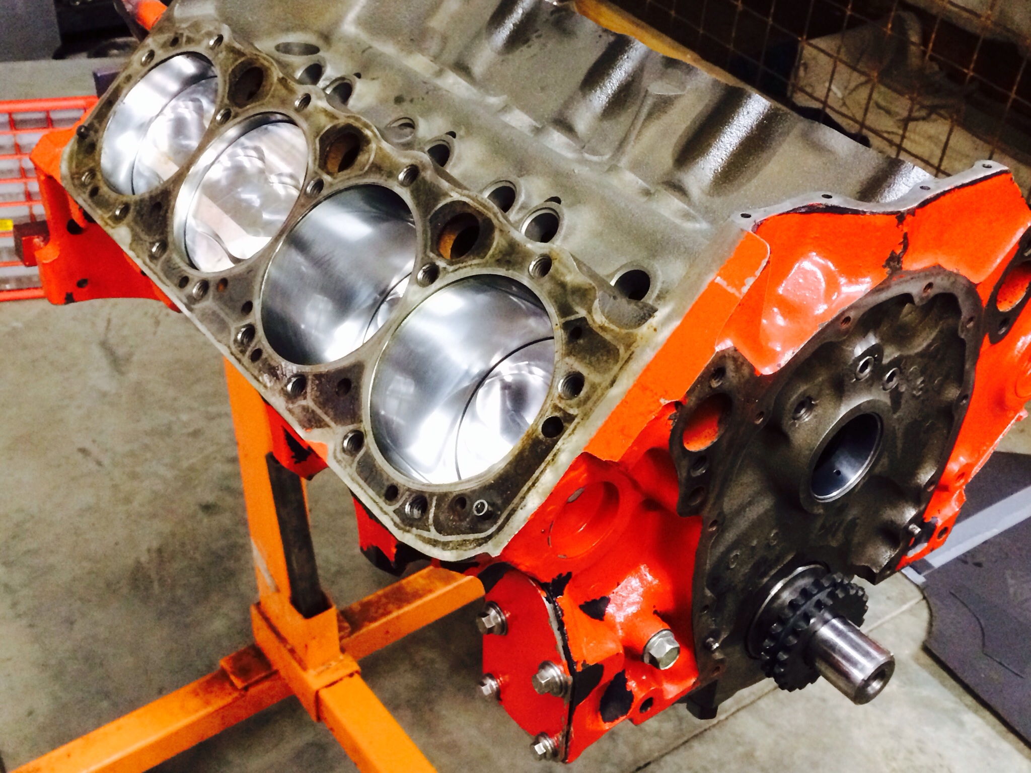

  2. beebee78
    Joined: Oct 15, 2008
    Posts: 259
    beebee78
    from illinois
    image.jpg Short block is back on the stand and ready to go !!!
