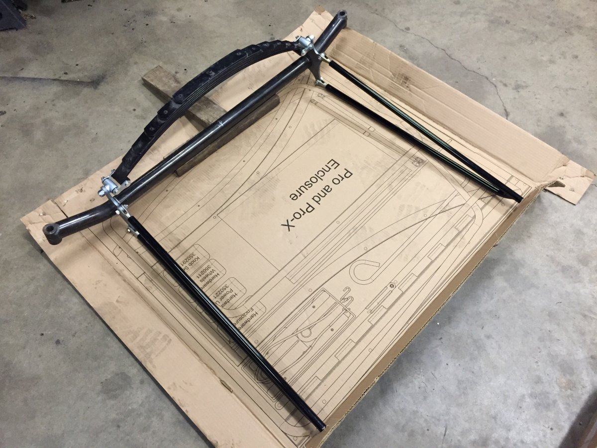

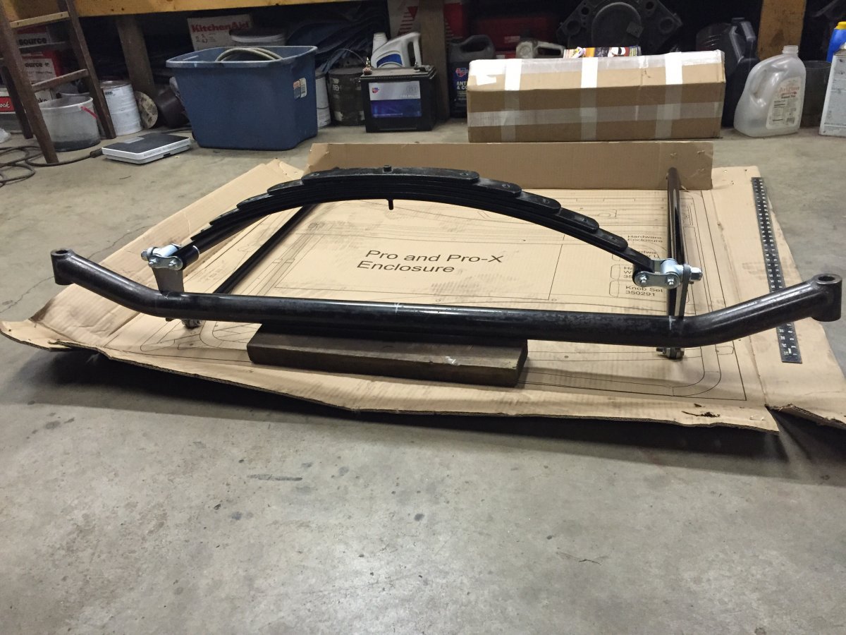

    image.jpg image.jpg image.jpg I think I have my front suspension figured out...I've never used this style front suspension, so I have been asking questions and reading everything I can find on the subject. I had planned on doing it just like Pannetons Yesterday's chili, but it wouldn't work, so I went with speedways brackets.

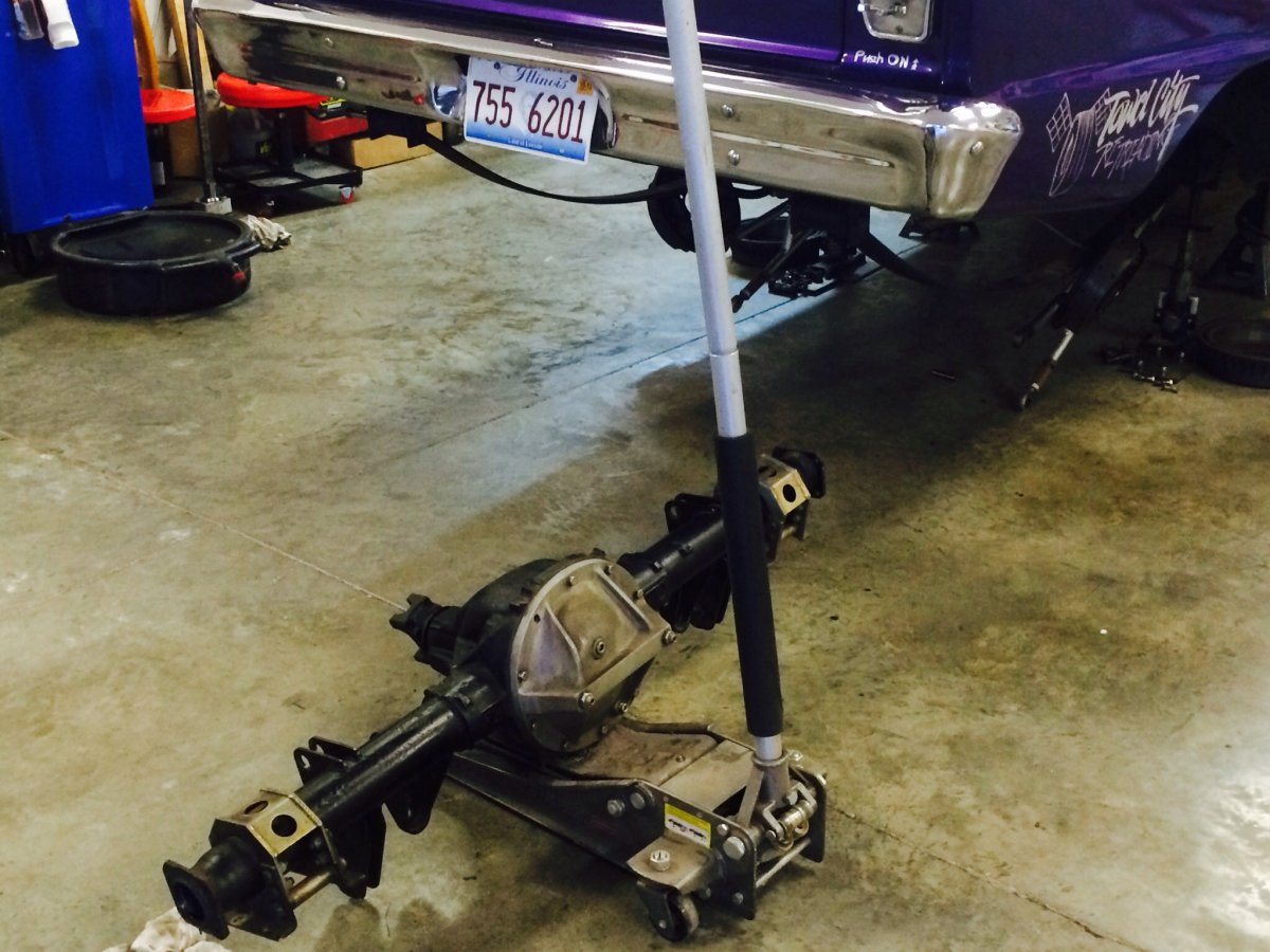

    image.jpg G****s getting a new ratio !!

  21. YA! get rid of those little candy ***** freeway gears!

    from illinois
    Hope this works out....... If so then thinkin about building a stronger unit this............ Don't wanna say it yet but winter !!

    To me it looks like a rear end with a crutch.
