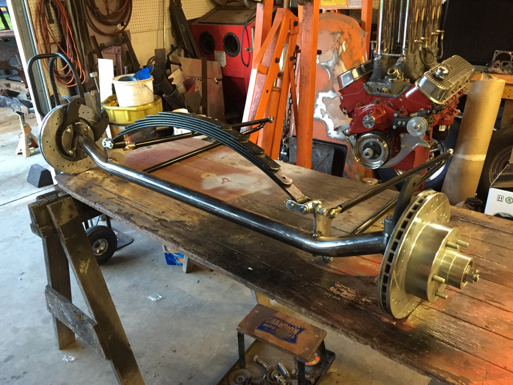

    I mocked up the front axle brackets and hairpins, then tacked them together. Normally I would have just burned the brackets on, but I decided that a tig bead would look cleaner. I tig weld at work, but on nothing more than an 1/8" thick material, so I dropped it off at Jefferys and had him burn them on. ImageUploadedByH.A.M.B.1442975832.592776.jpg ImageUploadedByH.A.M.B.1442975848.931237.jpg

    Tonight I put the spindles and brake rotors on...the drilled and slotted rotors look gayer than a bag of fake ****s, but they came with the kit, and were a good deal. I will be switching to a set of standard rotors for final ***embly. ImageUploadedByH.A.M.B.1442975991.353343.jpg

    Good looking axle where did it come from. I like the gentle bends instead of the real sharp bends at the very end like the speedway stuff.. Yours looks like a copy of an old Don Long axle.

    It's a new old stock MAS axle that I bought from the cl***ifieds...I bought it for the same reason you like it. It looks more correct than what's available today....it's also wider than speedway sells 51" kp to kp and only a 2.5" drop.

    Where did you get the brackets for the axle? Looks cool

    The brackets are from speedway and the hairpins are from the Panneton Bros.

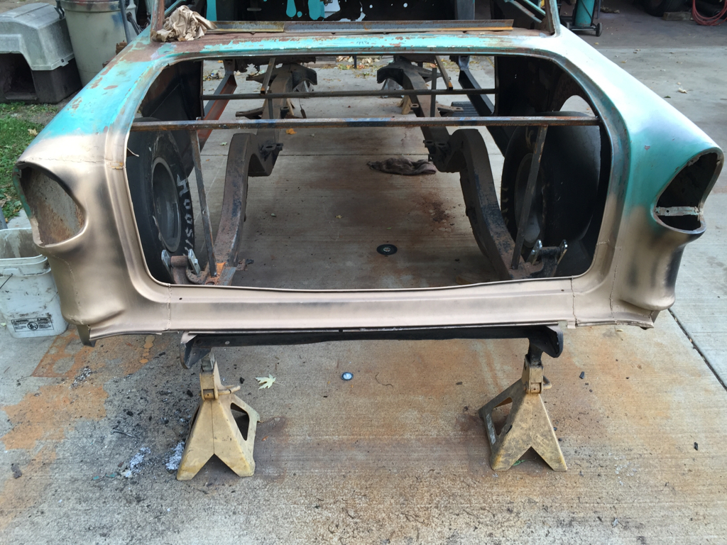

    I went past the point of no return tonight... ImageUploadedByH.A.M.B.1444179797.546079.jpg
    beebee78 and strokedstang331 like this.
  27. II FUNNY
    Joined: Jul 31, 2010
    Posts: 1,840
    II FUNNY

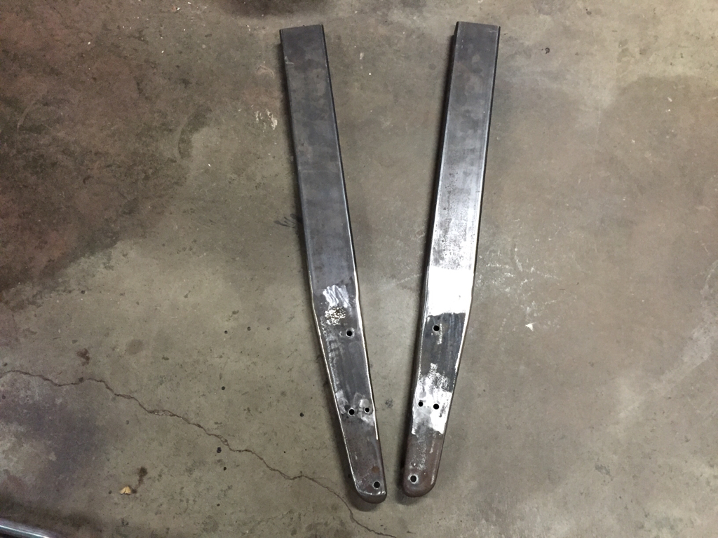

    I saved the stock front frame horns...since this is going to have the Ford style front suspension I don't need heavy tubing all the way out front for strength.

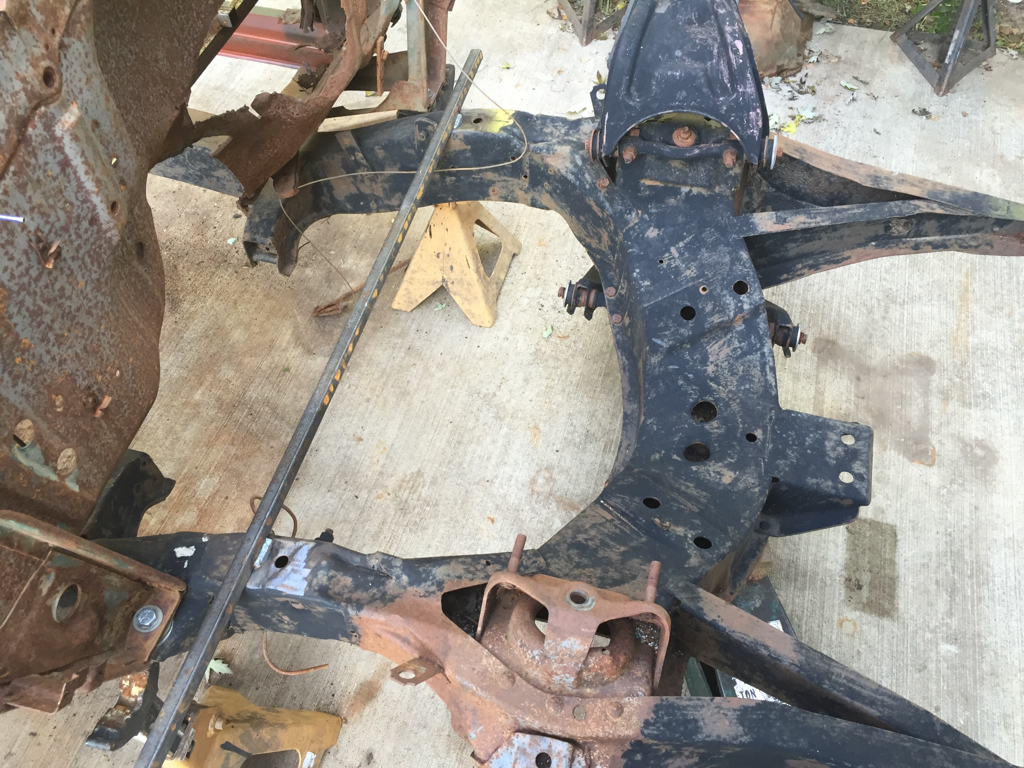

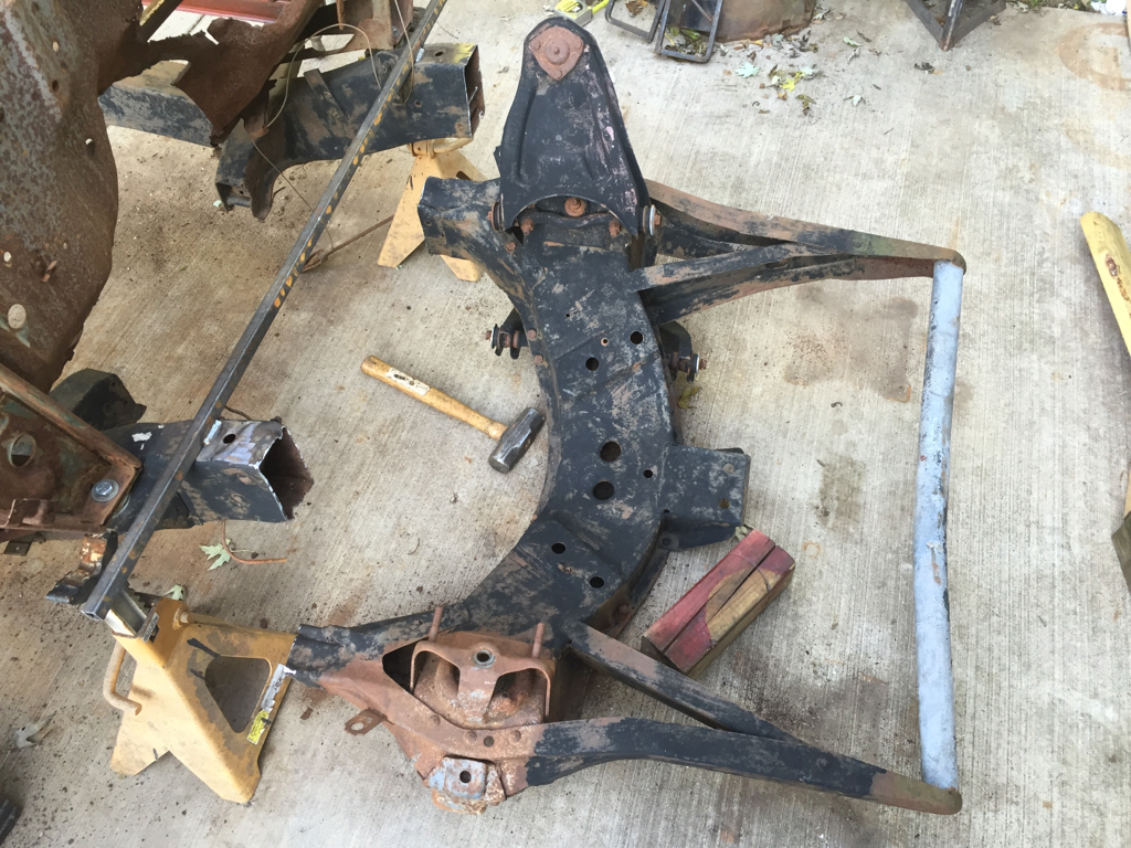

    I have the tail pan and fin area panels in and rough ground. I also made the front frame rails. I hope to pull the body off and carry the Frame into the shop so I can start working on the ch***is. ImageUploadedByH.A.M.B.1445529212.420072.jpg ImageUploadedByH.A.M.B.1445529229.359658.jpg
  29. Another stock Tri-5 front clip headed where it belongs.., IN THE S**** HEAP, THAT'S WHERE!
