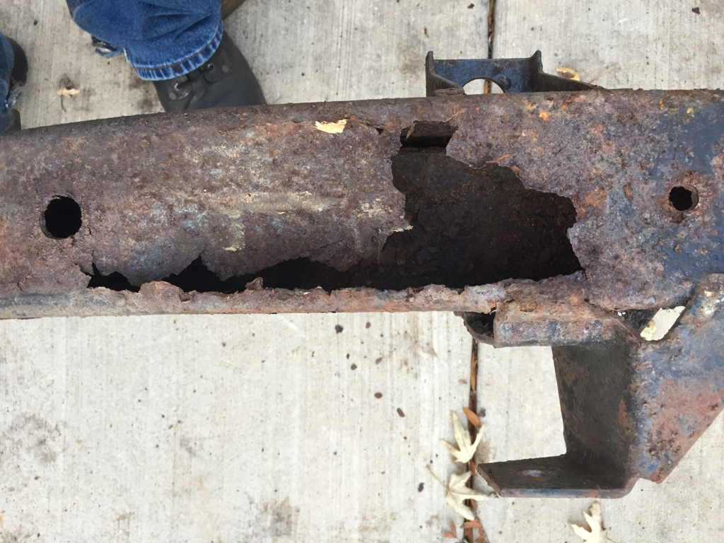

    A few weeks ago I removed the body off the 55 Chevrolet, and checked out the frame. I knew it wasn't perfect, but I didn't know how not perfect... ImageUploadedByH.A.M.B.1448143033.885981.jpg ImageUploadedByH.A.M.B.1448143062.699319.jpg ImageUploadedByH.A.M.B.1448143088.193927.jpg ImageUploadedByH.A.M.B.1448143118.809157.jpg
    As you can see...its FUBAR.

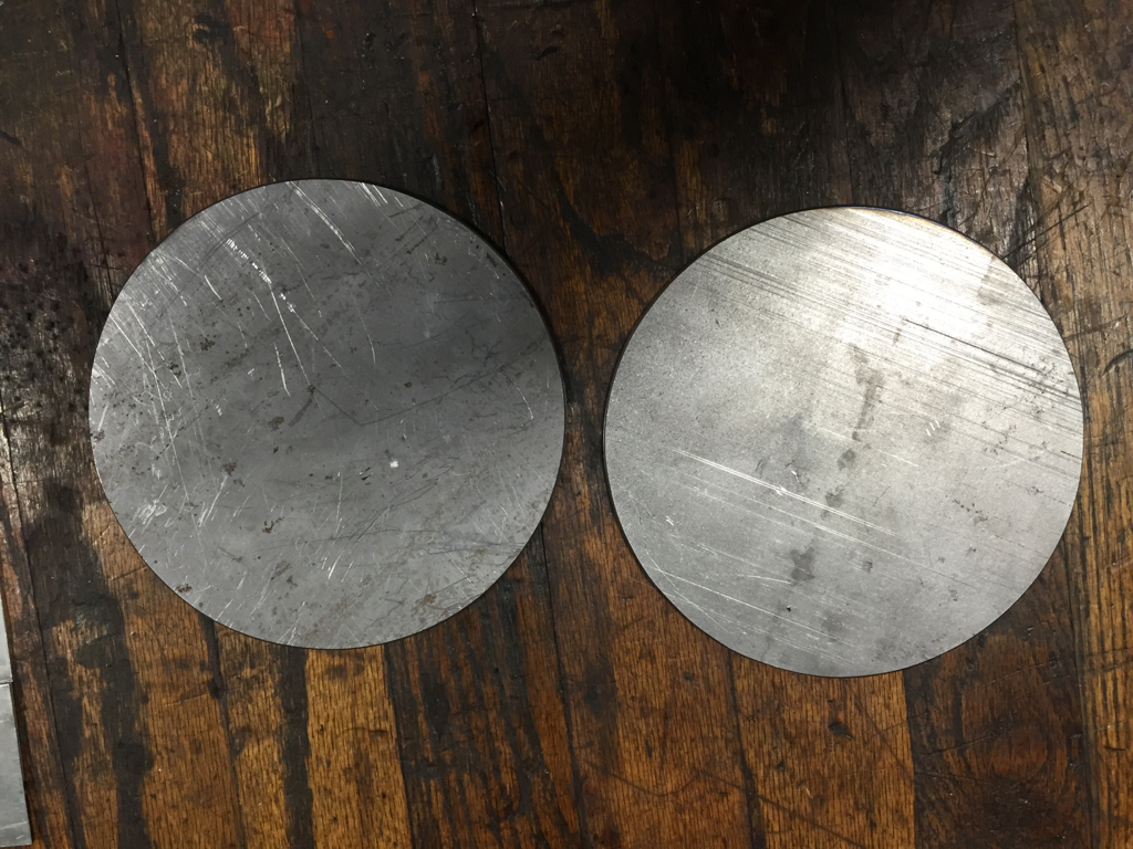

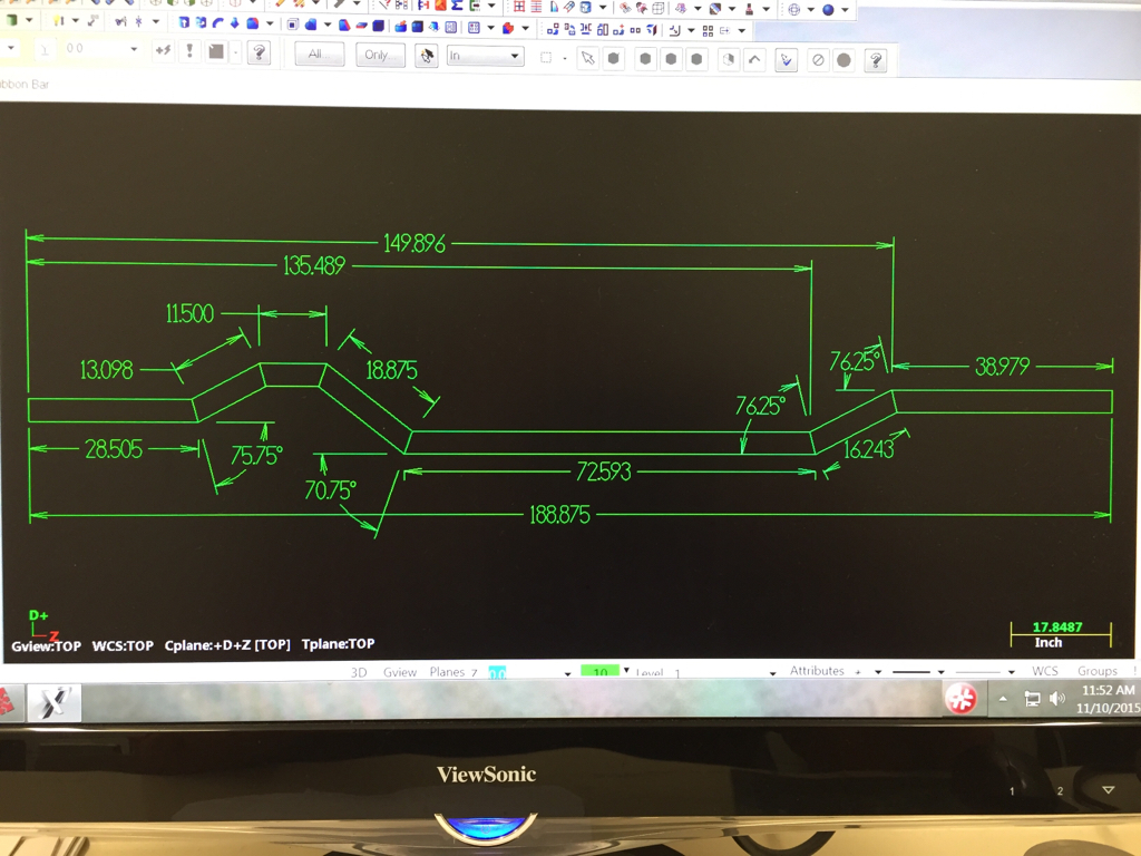

    So I decided to build a new one rather than fix this one.... ImageUploadedByH.A.M.B.1448143229.181378.jpg ImageUploadedByH.A.M.B.1448143264.564464.jpg ImageUploadedByH.A.M.B.1448143302.285218.jpg
    I spent my lunch hour and drew up my plans for a new frame.

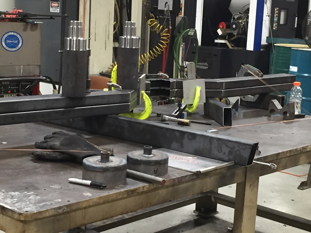

    I don't have a frame jig, so the welding table at work was as close as I could get... ImageUploadedByH.A.M.B.1448143509.420918.jpg
    You can see my redneck frame jig...
    9sectruck and Nitrofreak like this.

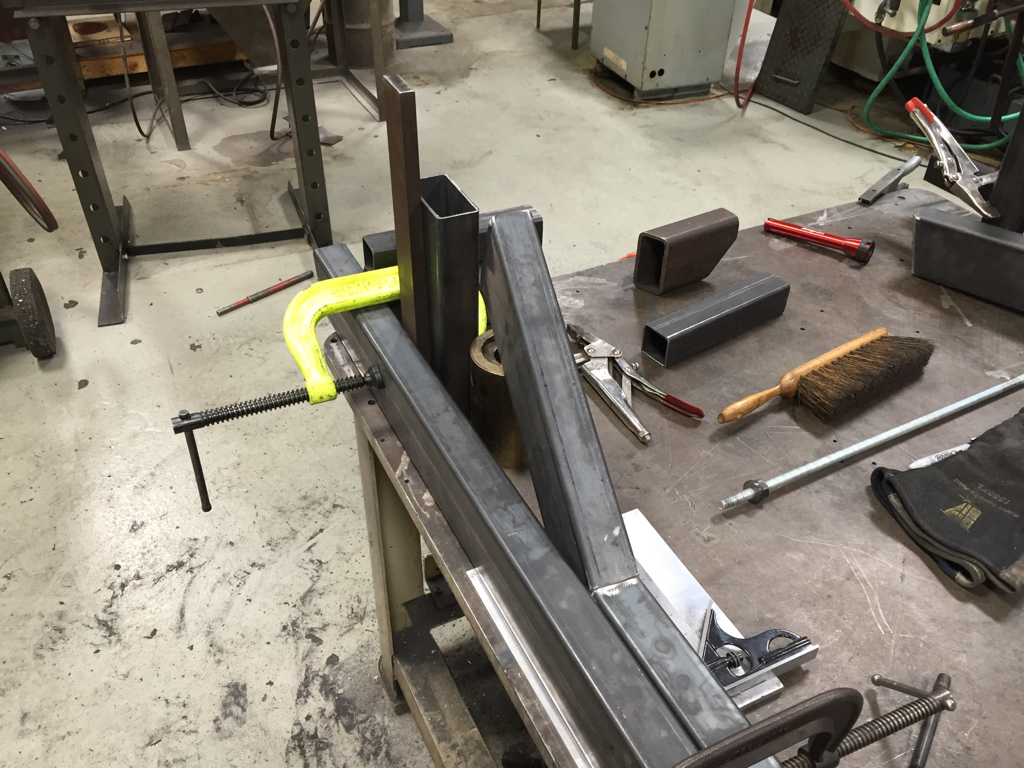

    I built on rail and then clamped the other rail to it, so they would match... ImageUploadedByH.A.M.B.1448143591.497371.jpg ImageUploadedByH.A.M.B.1448143601.852504.jpg ImageUploadedByH.A.M.B.1448143616.109741.jpg ImageUploadedByH.A.M.B.1448143638.087634.jpg
    The notches in the rails are for the springs.

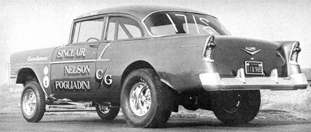

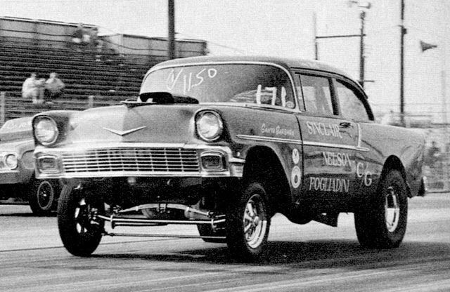

    The Nelson, Sinclair and Fogliadini 56 Chevy is one of my favorites. It was coil spring rear and suicide front suspended. ImageUploadedByH.A.M.B.1448202812.369865.jpg ImageUploadedByH.A.M.B.1448202834.130582.jpg
    Plus the coil springs are way lighter.[emoji51]

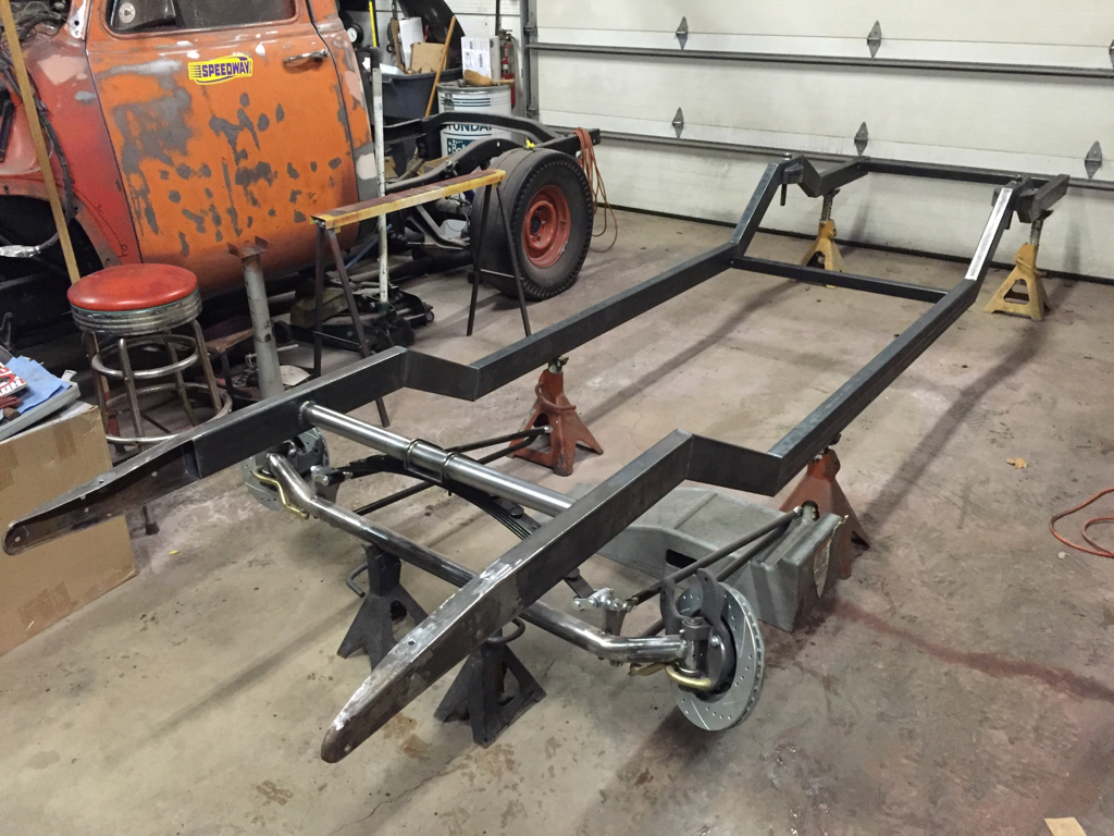

    Here's the frame back at the Old Boys shop. I had to slide the front suspension under it.
