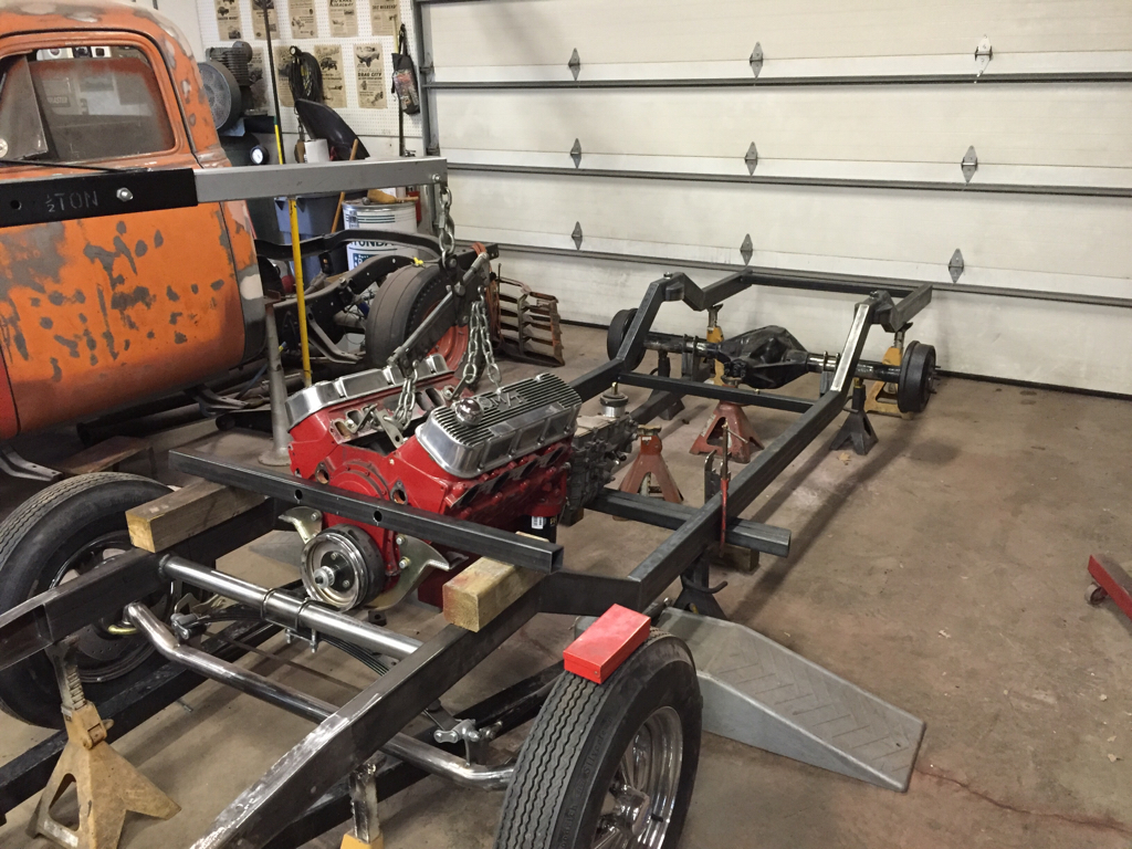

    Today I learned that my research fell short. Jeffery stopped by and helped me get the motor set in place. I had looked at as many Ford style front suspension tri fives as I could find, and settled on the front crossmember I had put in. Well...it needs to be 3" lower, so that the ride height is SEG legal...this will also allow me to move the motor ahead, because as is its 10% of the wheelbase which is legal, but with modern tires and sticky tracks not necessary. ImageUploadedByH.A.M.B.1448579099.436578.jpg

    Nice frame :D

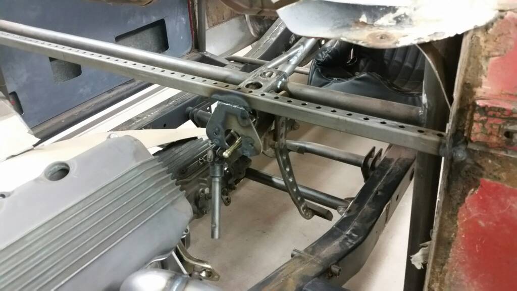

    Got some work done on the ford wheel tubs are done and also started on the rear tin. I ended up cutting the rear part of the frame out a little also so I could set the car a little lower in the back. As it was I couldn't use the lowest hole in the shackle because the spring hit the frame.

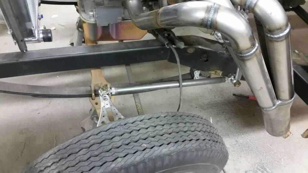

    from Beloit WI
    Also got the radiator mounted and made a brace to bolt the firewall to. The radiator mount slides over a smaller tube welded to the frame so it is easily removed for when the motor has to come out at some point in its life. Re made the pad the master cylinder bolts to also so it could be a little further away from the valve cover. Hope to have a firewall figured out this weekend waiting on my tipping die for the bead roller to try something I haven't ever done with it.

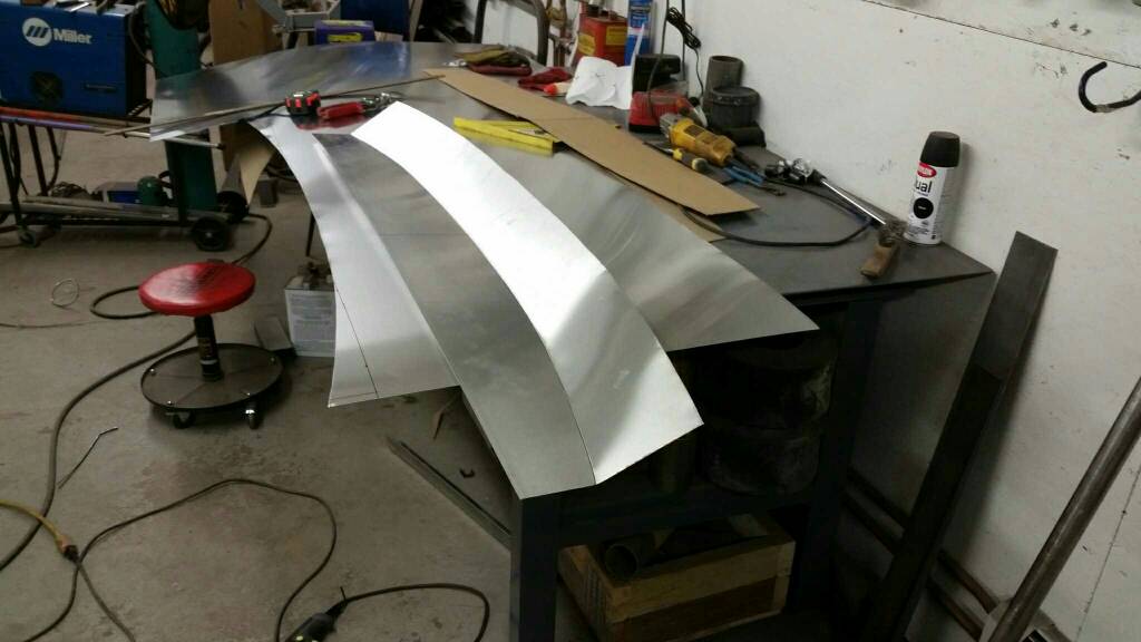

    Really digging the new tipping die for my bead roller. Can't afford a electric bead roller rite now so I got the wife out in the garage to help me out she did great. :D

    Not to shabby only took 2 times to get this one rite.
