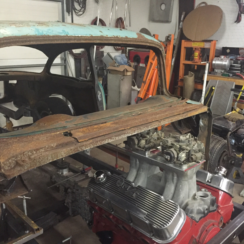

    Got the front shocks mounted, made the cables for the flip front I used 10 32 heim joints and soddered them on the end of the cables. Also got the rest of the firewall build I'll post better pics later of it. I made some 18 gauge sheet metal angle to weld to the inside of the a pillar for support and to attach the firewall to. Turned out better than I thought

    I milled an inch total out of this manifold between the base and intermediate piece, so the carbs would fit with more space than a feeler gauge.

    Looking good Kip! Your going to have to skimp on air cleaners though:rolleyes: Gary
