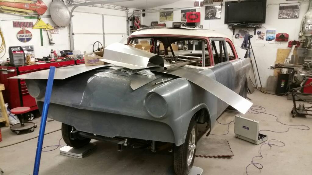

    This aught to scare the **** out of some people.This is my ford on the scales with everything I could possibly think of except drive shaft and front and back lexan and I had extra weight that won't be on there to hopefully to compensate for the things I forgot. Also will be changing out the heavy g body disc brakes up front for some light weight drag brakes. And did I mention I was also sitting in the drivers seat.:eek:

  12. saltflats
    Joined: Aug 14, 2007
    Posts: 13,612
    saltflats
    from Missouri
    Don't put on to much paint and you should be good.

    Just weighed the drag brake brackets and calipers compared to the stock g body ones I had on the front when I weighed it the drag brake calipers and brakets are 18 pounds lighter and the rotors will take off more yet lol

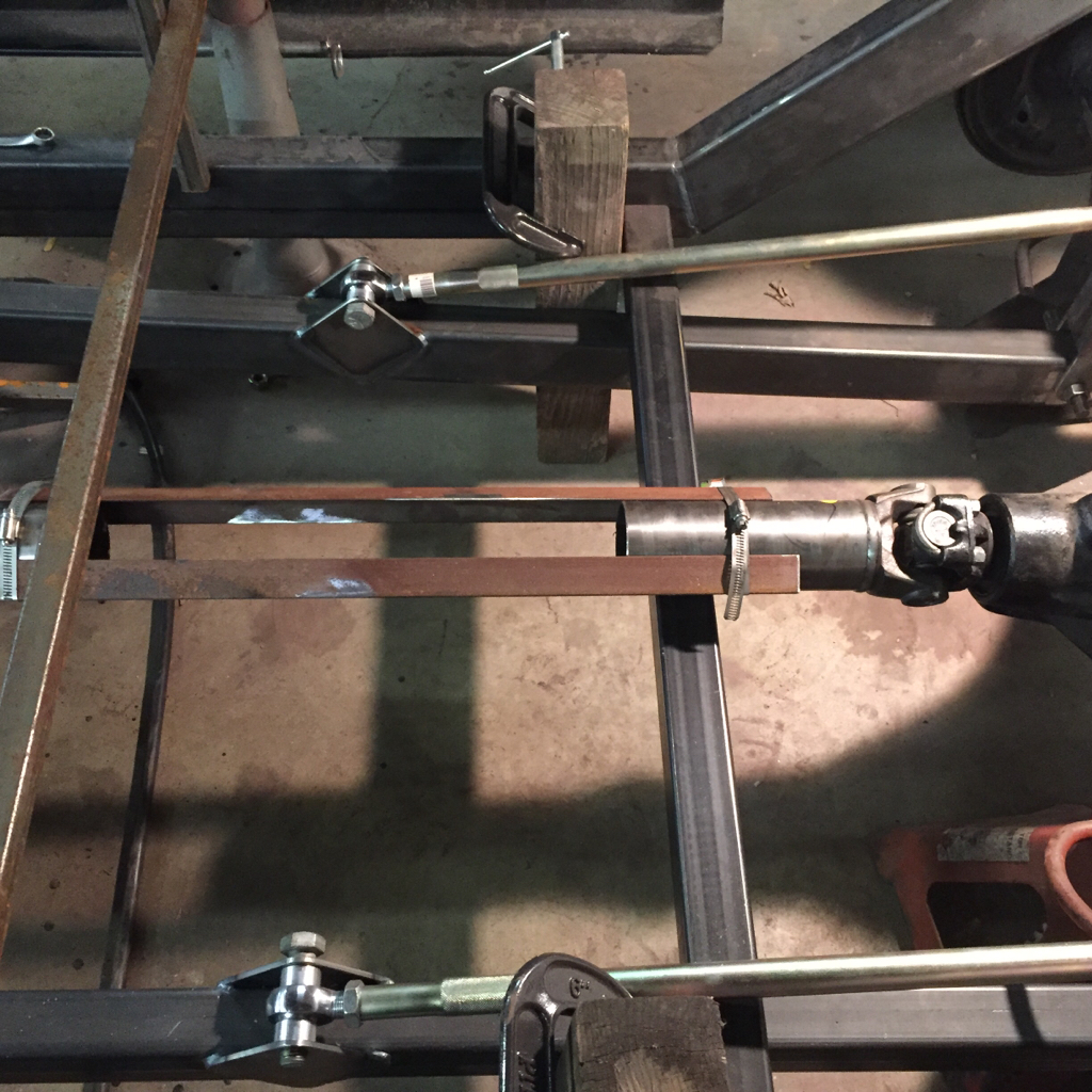

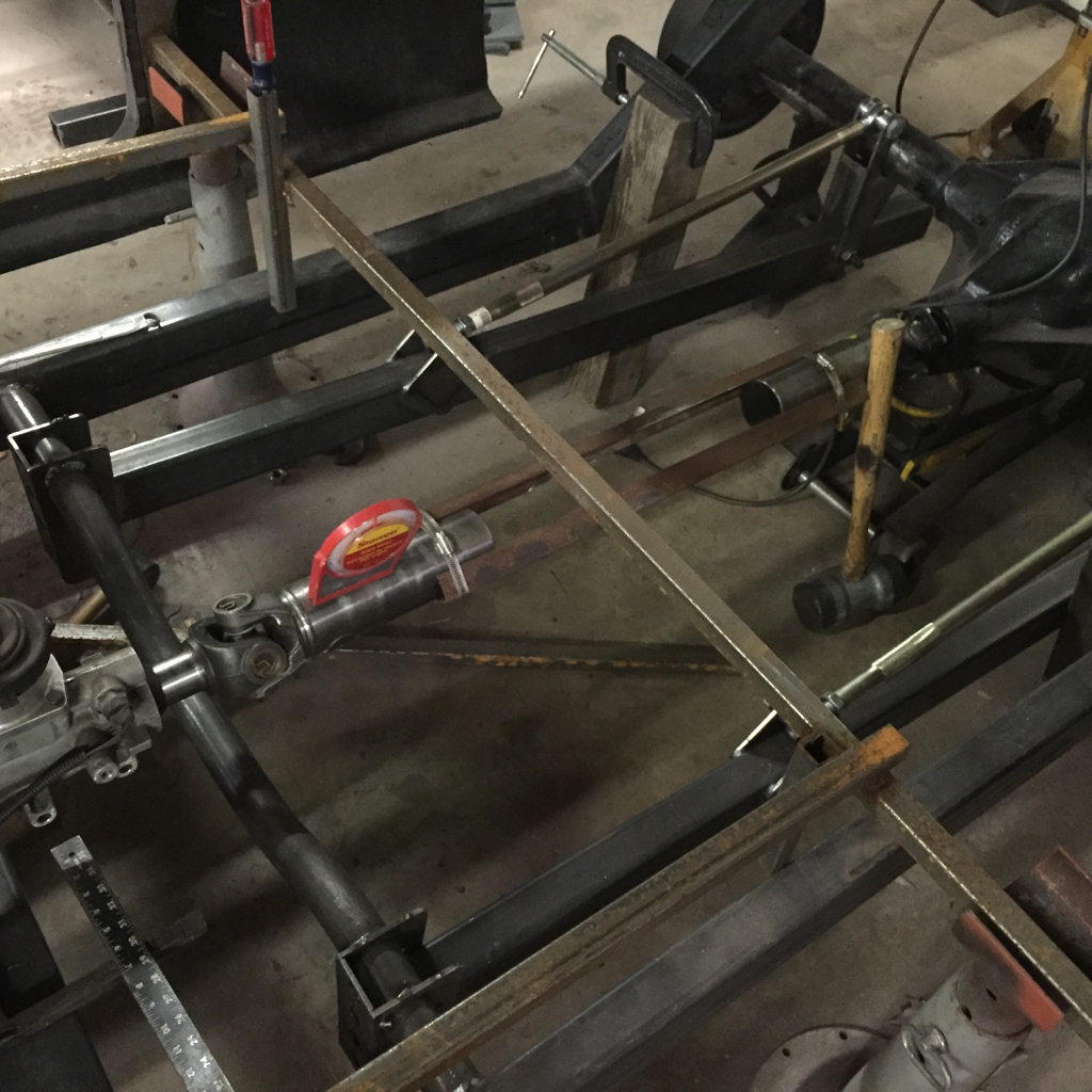

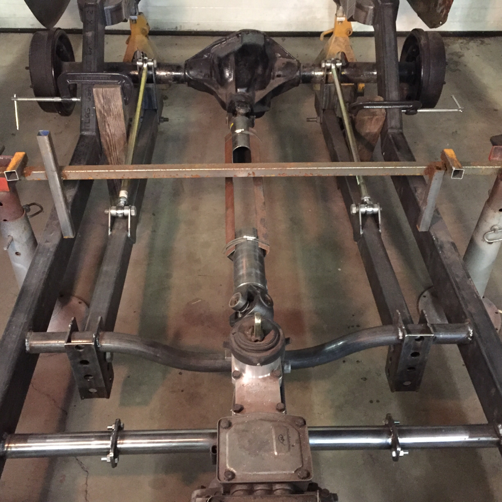

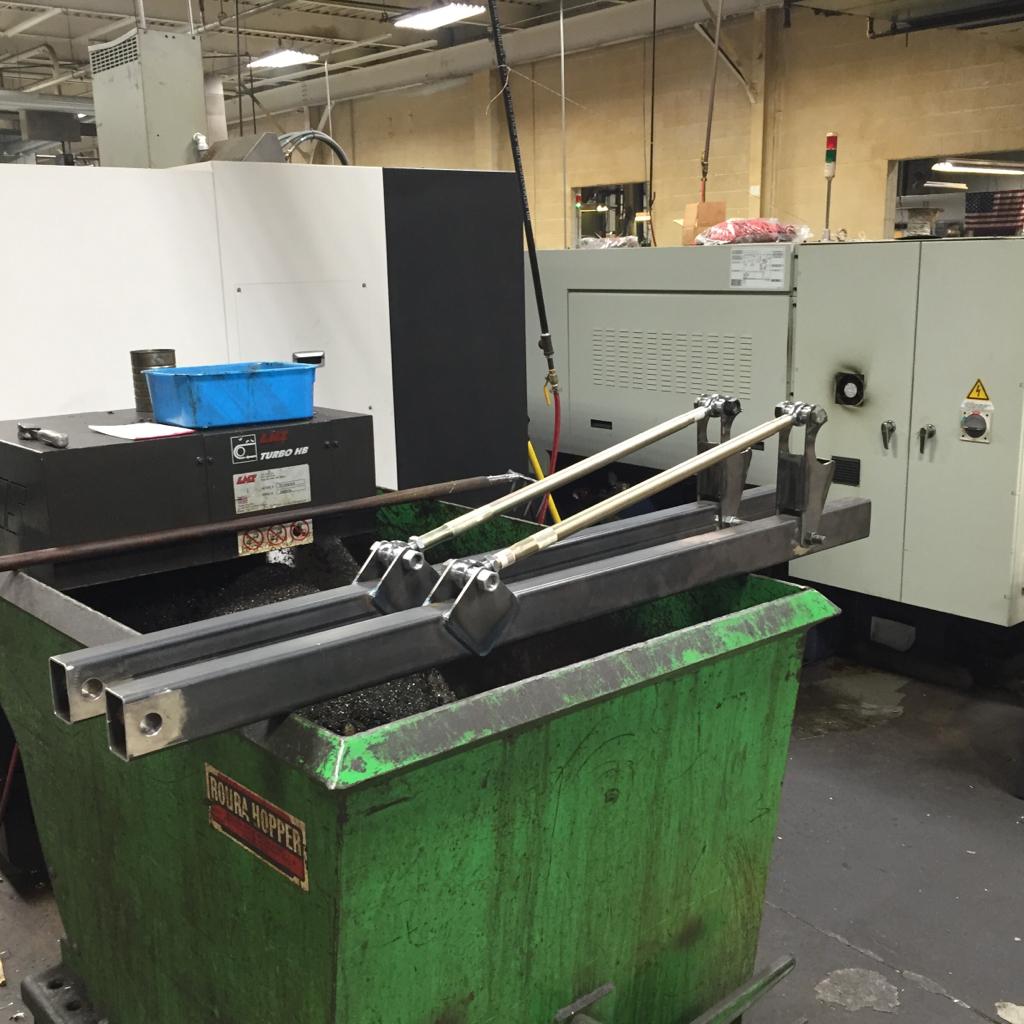

    I finished up the lift/traction bars...I'm going to trim off the extra material off when I figure out where the shocks go. ImageUploadedByH.A.M.B.1452987863.197949.jpg
    I modified some brackets for the lift bar mounts that I had made awhile back. I was going to use square tube, but had this bent pieces already. You can see my redneck 4X4 spacers to keep everything square... ImageUploadedByH.A.M.B.1452987482.494024.jpg

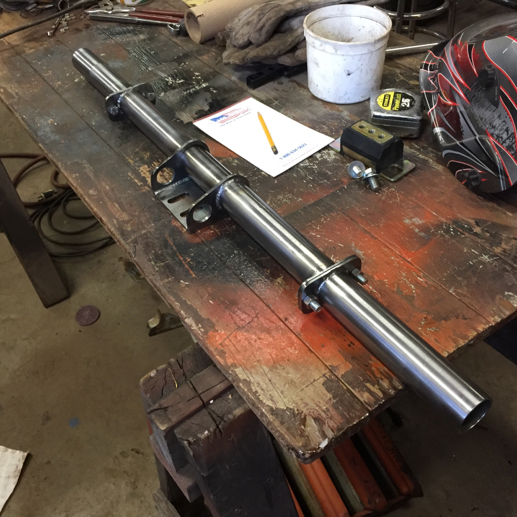

    I modified the front spring mount I had made to fit as a trans crossmember. It worked out perfect. ImageUploadedByH.A.M.B.1452987632.836630.jpg
    The motor mounts turned out good, but they are a little different looking. I think they will work fine. ImageUploadedByH.A.M.B.1452987701.719915.jpg

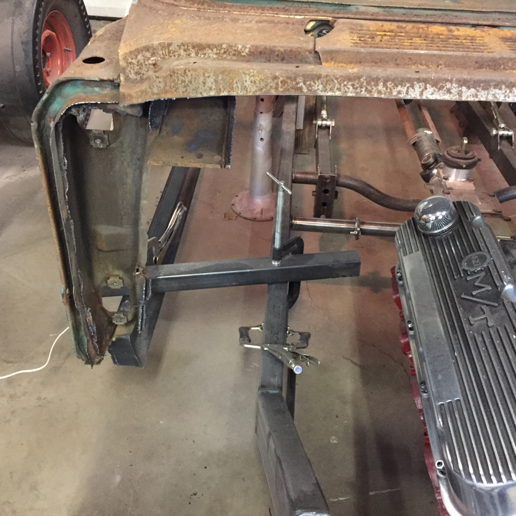

    I also removed a little more material in the "A" pillar area. ImageUploadedByH.A.M.B.1452987772.656393.jpg
    Here is an inside shot of the ch***is through the windshield area. ImageUploadedByH.A.M.B.1452987810.792435.jpg
