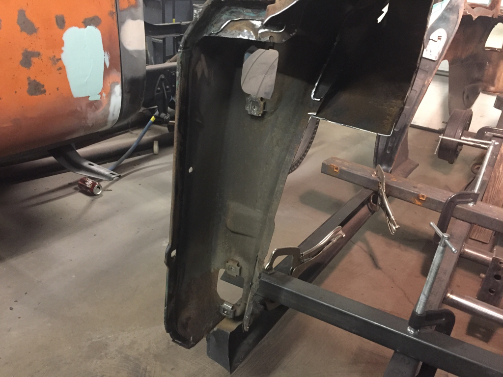

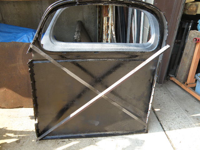

    Quain said to get rid of as much unneeded metal as possible...I hope it doesn't end up too weak.
    I want to get the doors back on, to see if I need to box this or if it's sturdy enough.
    I also did some more cutting on the doors...
    I still need to clean up the holes after plasma cutting them out.

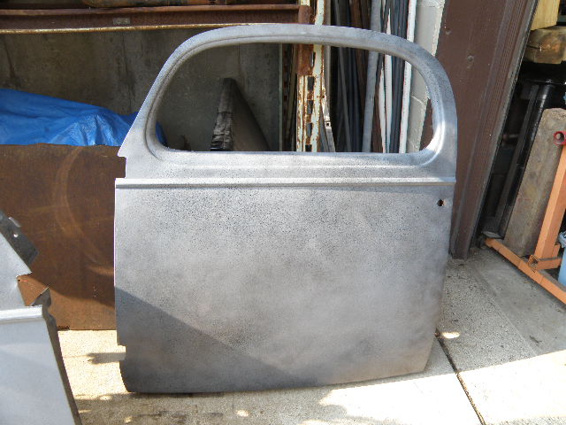

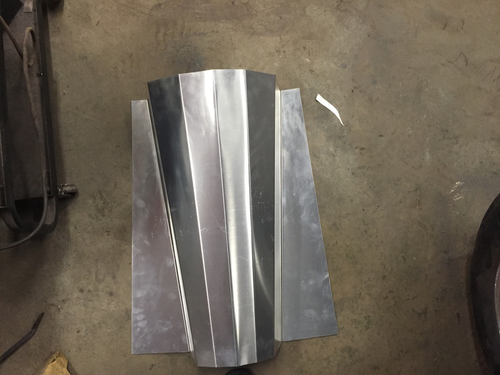

    Hey Tony, I stopped over to Jefferys, and he gave me his first good transmission tunnel that he made. It ended up too short for his car, but works fine for mine...if you lived closer you could of snagged it.lol

    Kip, I think your doors have a way to go yet to be Light LOL :D The braces were for sanding them!;) Gary

    You are one lucky man to score that! Pure art right there. Amazing. Some guys have all the talent :rolleyes:

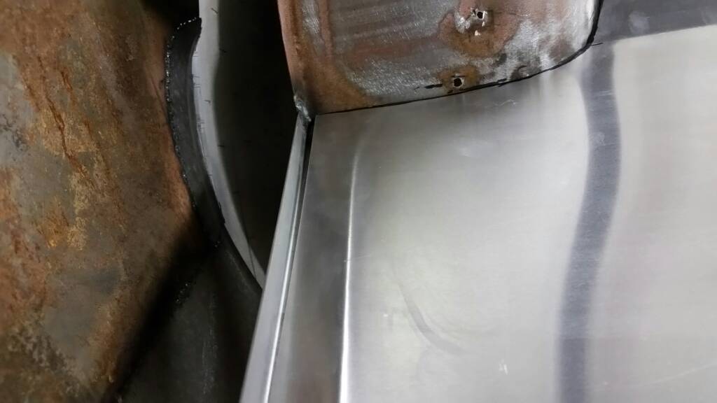

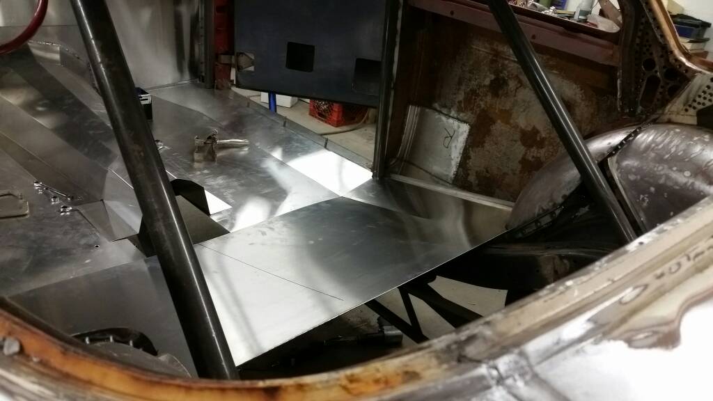

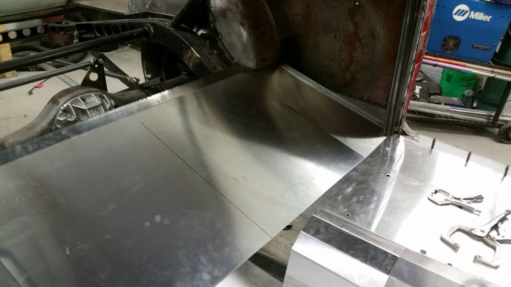

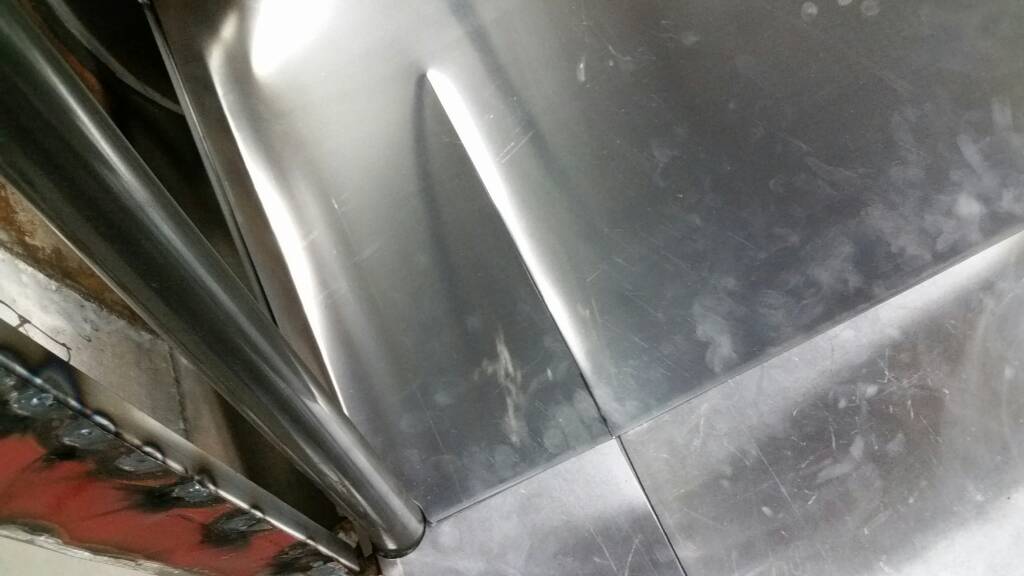

    Not a lot of stuff getting done worthy of pictures. But I did get the motor all mocked up and off to the engine builder 5 hrs from my house one way. I also made the rear floor piece for the back seat area. It turned out pretty slick I used the tipping die again to match the front part of the floor. Also on the sides where I put 18 gauge angle to attach the tin and I made the break fade away up by the wheel tub so it looks really clean. Next the rear panel and package tray area
