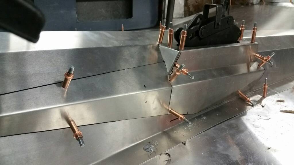

    Finally got the tunnel completely finished. Just have to take it back apart and Finnish t******* the edges inside the shifter box and bolt it all together.

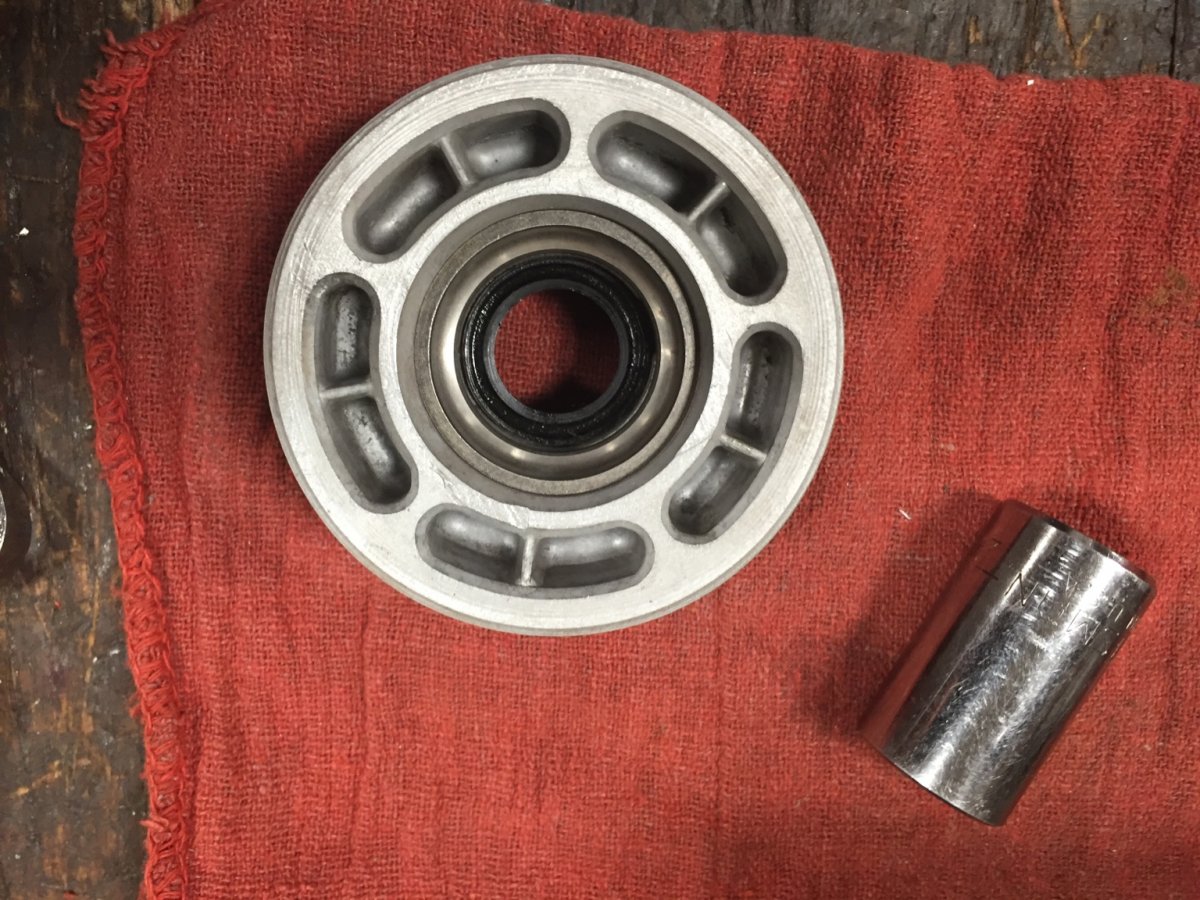

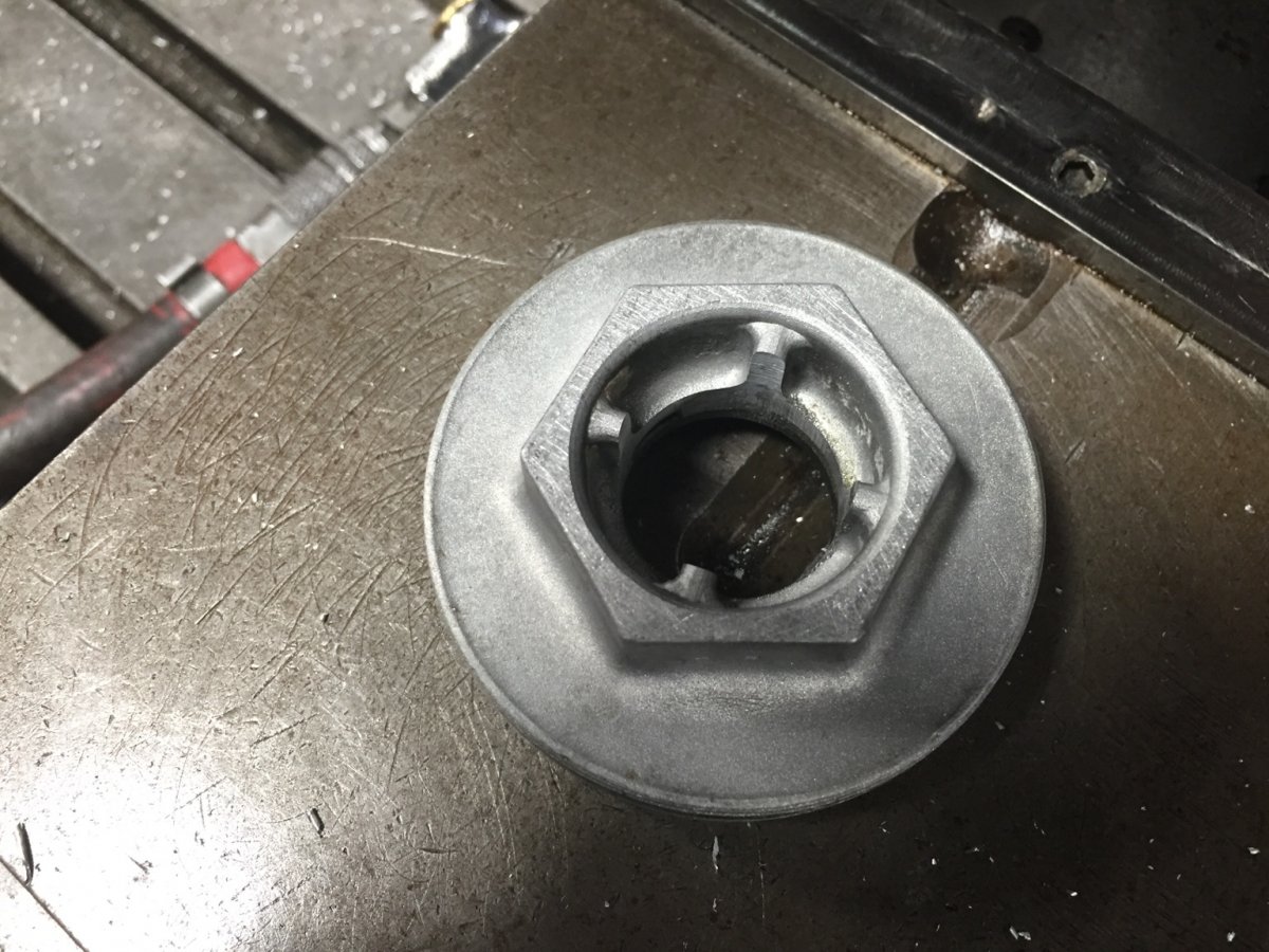

    I finally picked up a steering box. I decided to try reversing a stock aluminum corvair box. ImageUploadedByH.A.M.B.1457056119.981582.jpg
    I picked one up on eBay for $120
    I dis***embled it and drove out the seal. ImageUploadedByH.A.M.B.1457056199.069920.jpg

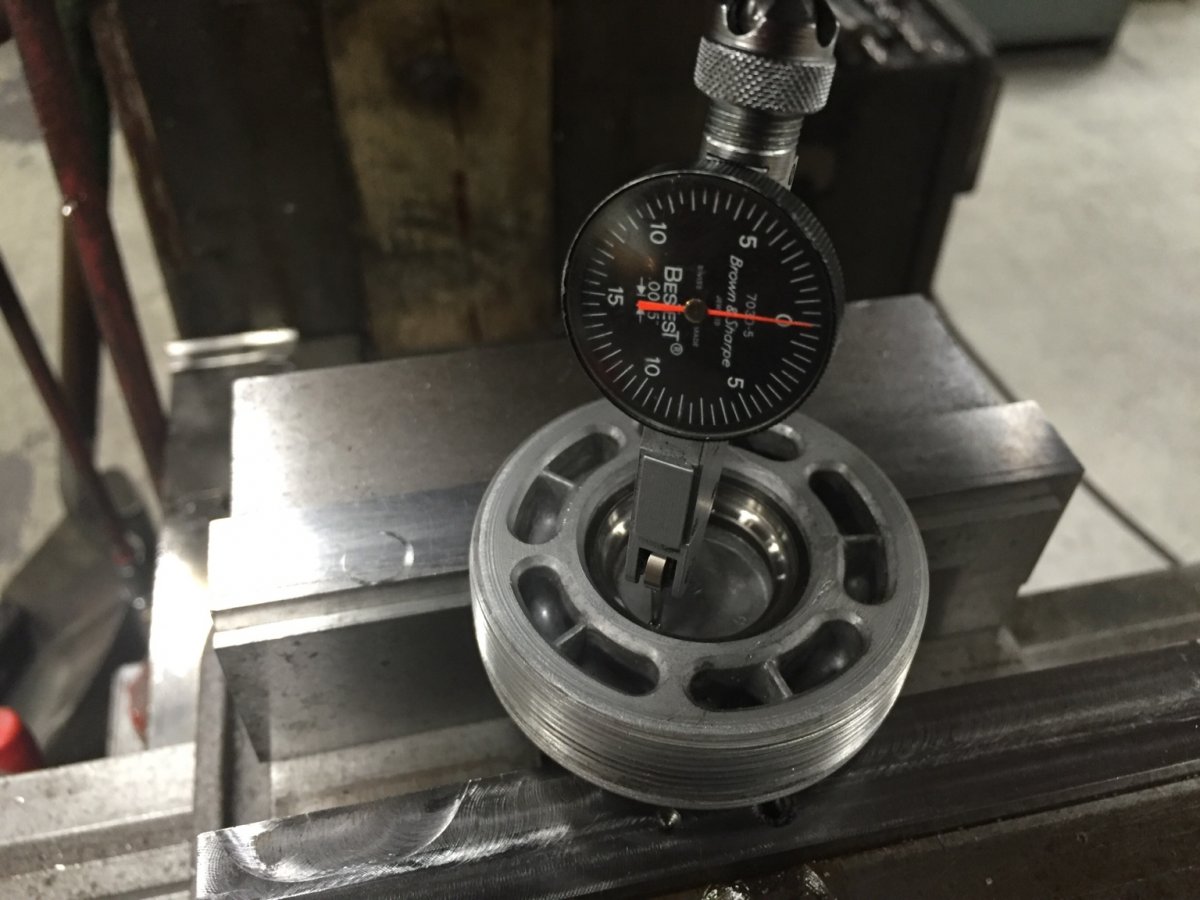

    I indicated the bearing race in...the interweb says to just drill it on a drill press, but I wanted it dead on. It also said to drill it out to 7/8", but the seal measured 15/16", so I went to .936 for a little press fit.
    And all re***embled...it was a piece of cake.

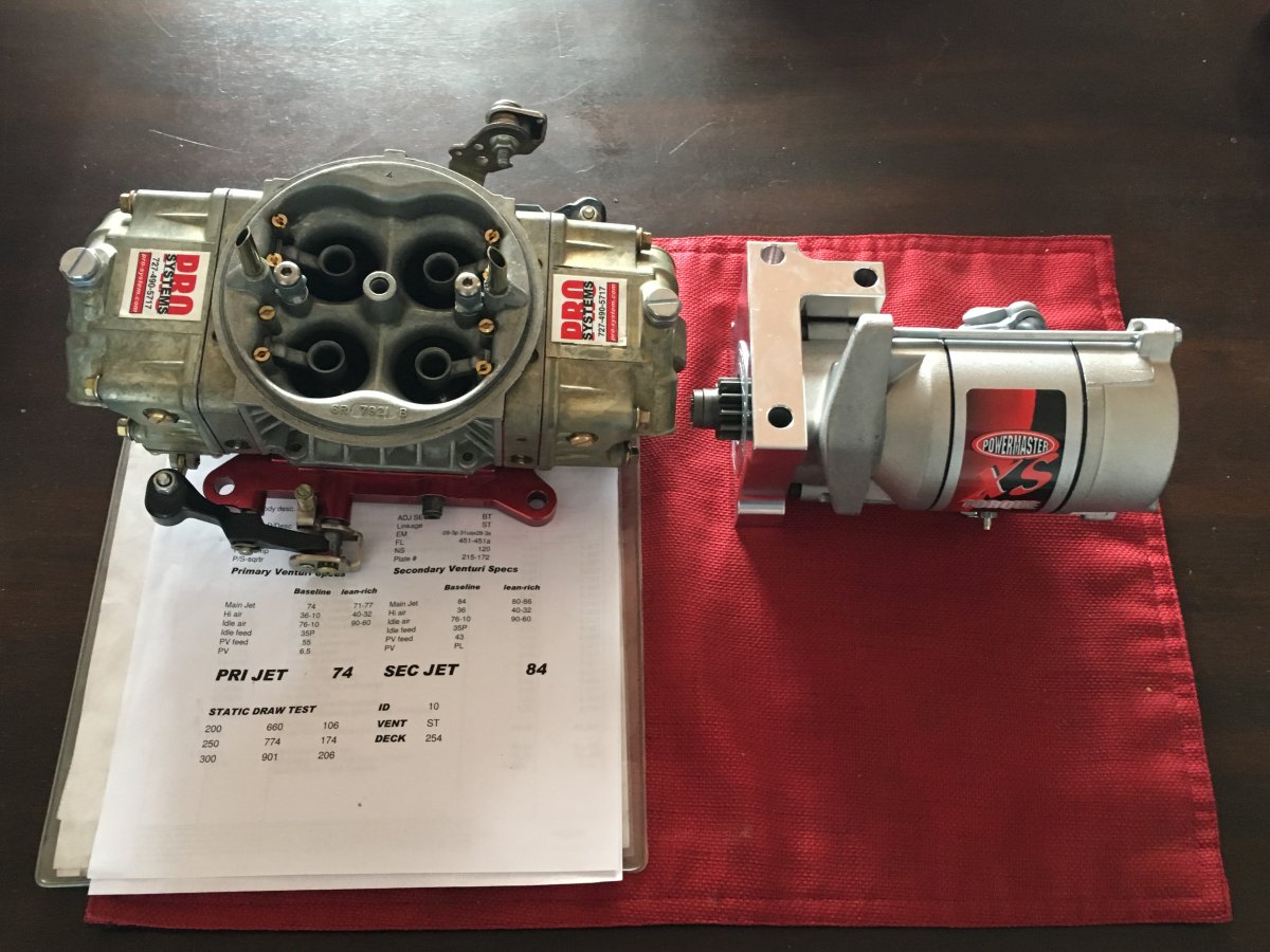

    from illinois
    image.jpeg Not much progress to report on the G****, new starter and sent the carb out for a refresh?? Now gotta get out there and install, lol

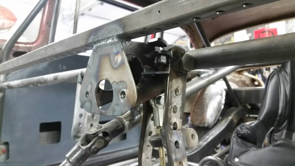

    Got the tin finished up except the kick panels. Made another drive shaft loop and more stout crossmember to attach the seat belt tabs to. Also made clutch pedal and gas pedal stops. Window net tabs are welded on incase I have it certified. Hope to have all the ch***is work done tomorrow so I can take it down to my shop for body work and paint.

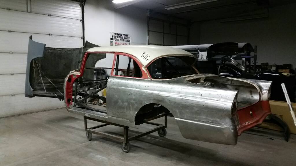

    The Skairlane made it to its new home for a little bit. Let the body work begin :D

    I got it mostly tore down tonight going to the blaster tomorrow to take the rest of the paint and rust off the inside. Only estimate I gave my self is when I want it done lol. Don't worry I'm full steam ahead plan on putting a ton of overtime in on it after work to get it done. I hope to have it really close to paint or maybe even painted in 3 weeks.

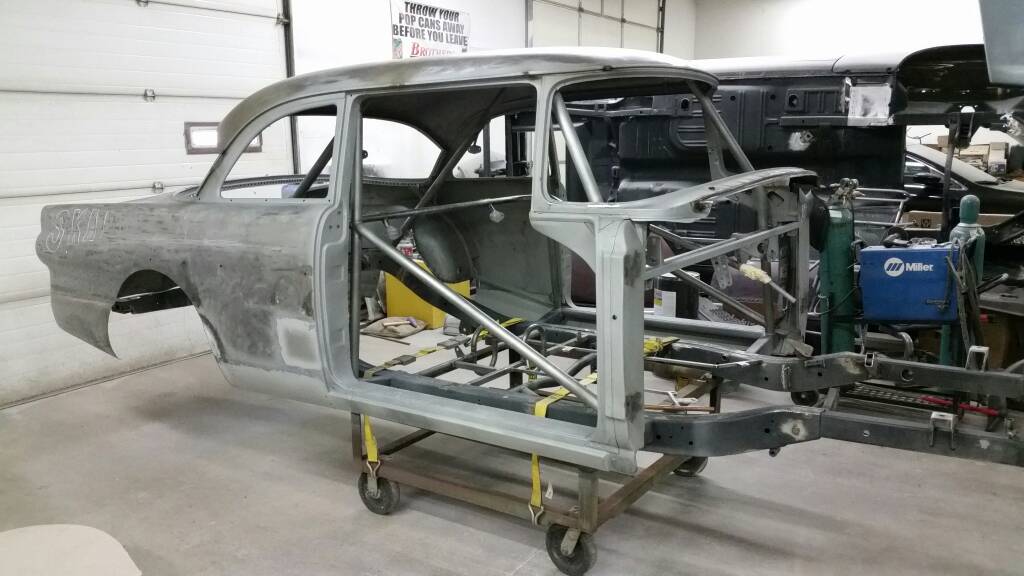

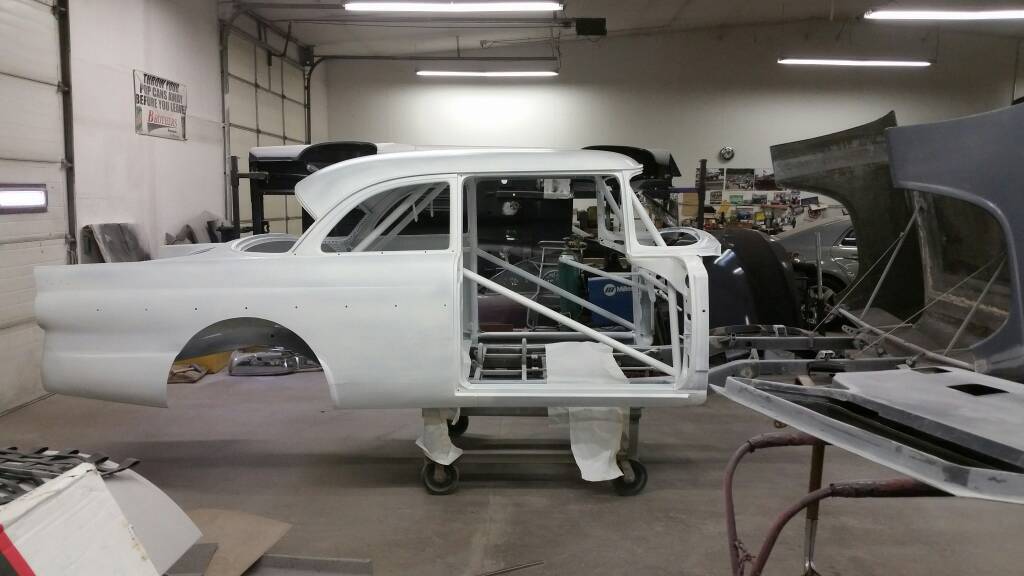

  25. strokedstang331
    Joined: Oct 14, 2008
    Posts: 531
    strokedstang331
    from Beloit WI

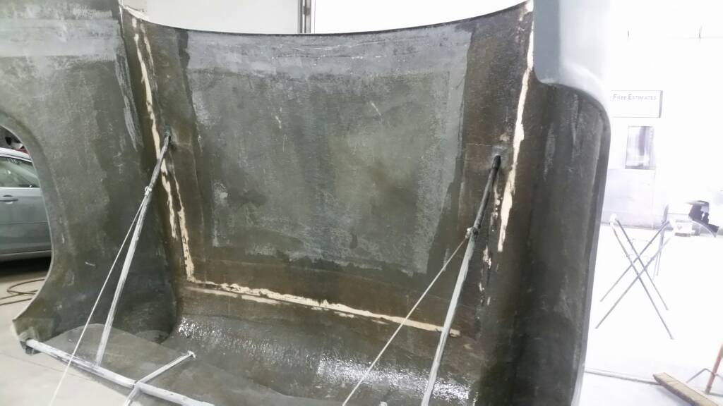

    Got the body all blasted not a spec of paint left on it. patched up a few small holes and got it in sealed with epoxy primer. Also did a little fibergl*** work on the front end. This week will be body work and more fibergl*** work on the doors and front end.

  26. saltflats
    Joined: Aug 14, 2007
    Posts: 13,550
    saltflats
    from Missouri
    Looks ready for paint don't weigh it down.
