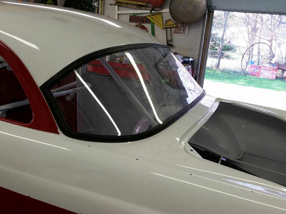

    This weekend I worked on the window's for the ford. Since I couldn't find a lexan front or rear window for it i decided to buy a sheet of lexan and try to make them. I think it turned out pretty good for my first attempt. I made a template out of paper and cut a piece of lexan about 1" big all the way around the pattern. Then we just put the flat piece on the outside of the window and stuck it In a huge oven for powder coating. It took like 300° to get it to form around the gl*** and when we pulled it out we clamped it on the edges til it cooled. Once that was done I trimmed them to the size of the gl***. The rear window came out a little wavy from clamping it but not to bad. The front one we didn't clamp rite away so it didn't leave the marks from the clamps. I also moved the car back home this weekend. The motor was supposed to be done this weekend but we ran into a few problems so now I'm hopefully dynoing it and picking it up on Saturday as long as everything goes as planned.

    Food for thought. You may consider gluing the rear window in along with some sort of fastener (if you haven't already). A friend of mine had a 55 Chevy lose the rear lexan window on the top end of the traps. I don't know what the proper procedure is for installing rear lexan, but I was there to watch it pop out of the car and thought it was worth mentioning. I know his was a similar set up, original window gasket, gl*** doors, aluminum floor. Not trying to be critical, I love the old Ford! Just sharing an experience.

    Yea I was worried about it flying out also. We are planning on gluing it in on the final install. When I trimmed the window I made it fit as little as possible so it Fitts extra tight. Only bad thing about it fitting tight is its a pain to get in but when it's in its really hard to get it back out. Thanks for the heads up

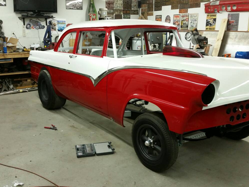

    Been working on all the trim lately. I got it all polished and about all on the car now. No good news on the engine it's been nothing but bad news on it the last few weeks. Was supposed to pick it up and dyno it on sat but got a call Thursday night with a huge problem with it and it had to be tore completely back apart. Not gonna go into detail on it but hope to have some good news in the next few days. If I don't get the motor back this weekend I think the southeast g***ers Knoxville race will not happen for my car.
