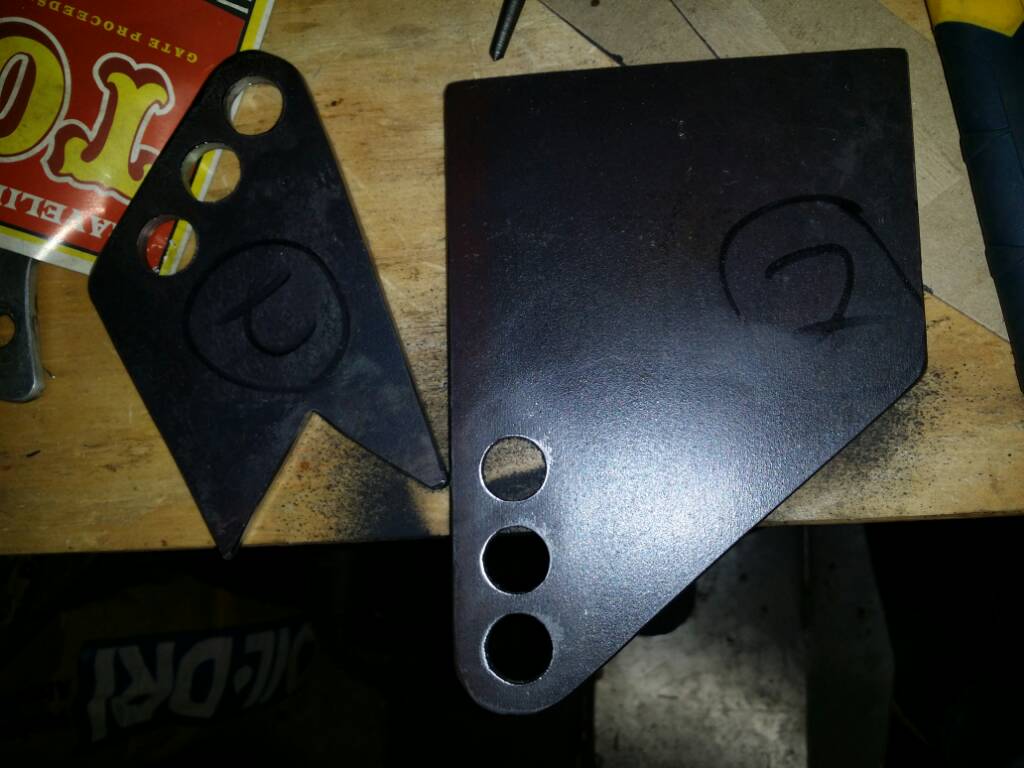

    Got some more jobs done, mid plates made and mounted, cut and drilled ladder bar brackets for the front and tached them on. Next will be to start making the laddar bars and to get those mounted along with the shocks and springs. 1462055580003.jpg 1462055592818.jpg 1462055613917.jpg 1462055637710.jpg

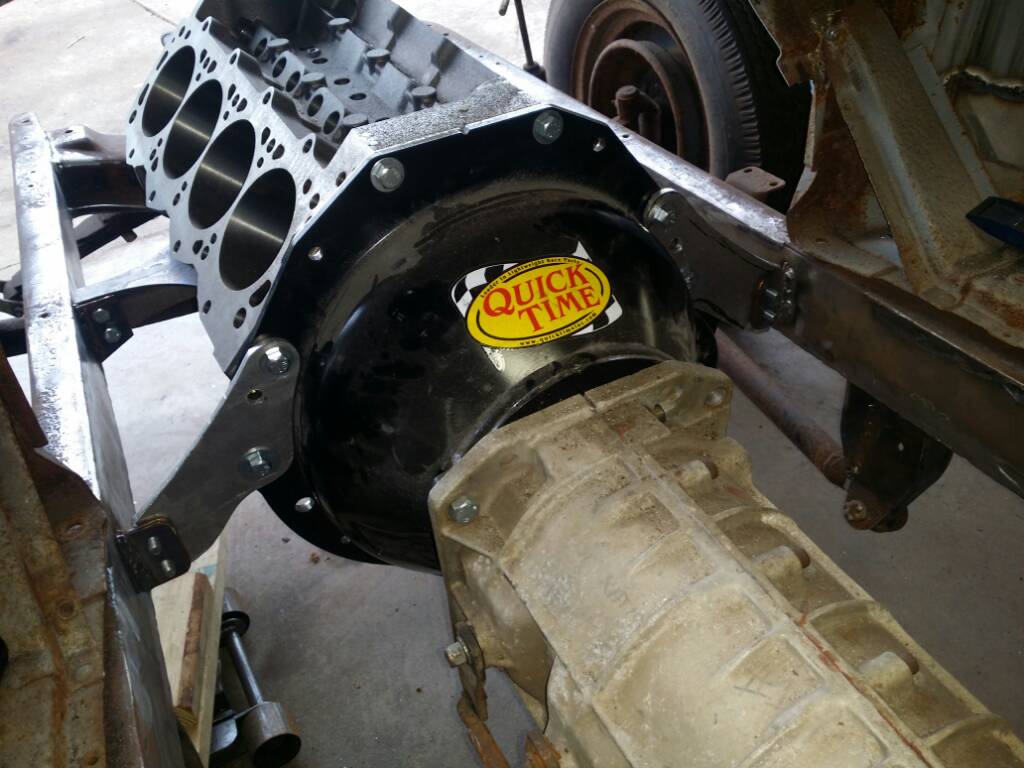

    Just letting you know that if you plan to use the Ram Phase 2 g***er clutch you will need about 1/4 extra space if using a stock depth bell housing. The way we get it is to use a 1/4" aluminum mid mount between the bell housing and block. Hightower makes a pilot bushing that is 1/4 longer so the input shaft won't know. Just letting you know now while it would be easy to change. Some if the other clutches don't need the space.
  8. 91whitestang
    Joined: Oct 6, 2009
    Posts: 232
    91whitestang
    from Wisconsin
    Thank you quain i appreicate the advice.

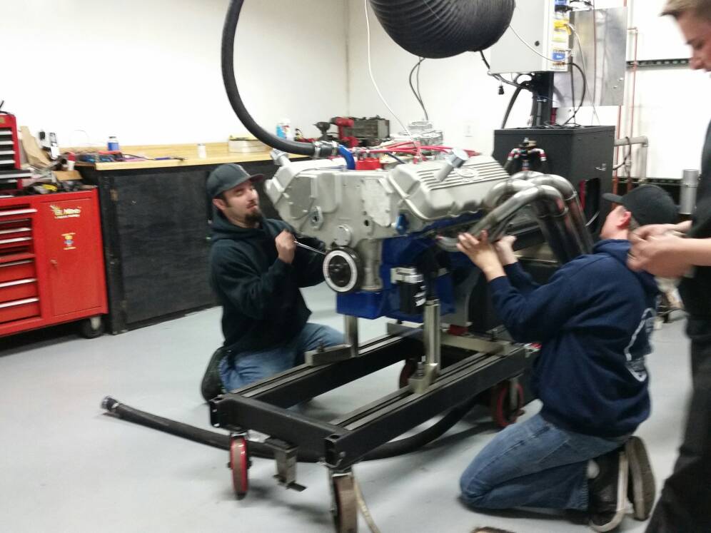

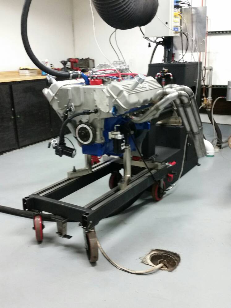

    No to much to update on the Skairlane. We had the motor on the dyno a week ago the first pull made 691 hp @ 6000rpm and the second pull we took it up a little higher and it made 704 hp things were looking good we were expecting to see mid 700s at the least. then we did a jet change and lost 20hp then we switched it back and lost even more. We know it wasnt a lean issue because we had o2 sensors in all 8 header tubes. We pulled the valve covers off and cut open the oil filter and found nothing wrong with it. After we made a few more pulls and continued to loose power we called It quits and had to pull the motor back apart to find the problem. It's not looking like I will make my first few races I had planned but I am planning on making the meltdown for sure. It really ****s but we are gonna make sure everything is perfect on it before it goes back on the dyno. So while they are fixing that I'll keep plugging away on the car. I bought a brand new grille and headlights for it got them put on this week. I also have all the new drag brakes on front and rear. This week I'll be working on running the brake lines and finishing the dash up.

    CP is making new pistons. They are on a rush turn around and should be done next week. Had a few different issues going on.We think the rings and the hone were the main issue for power loss and blow by because it polished the hone in a few cylinders. That's the only update I have. I am hoping to have the motor back in a few weeks keeping my fingers crossed.

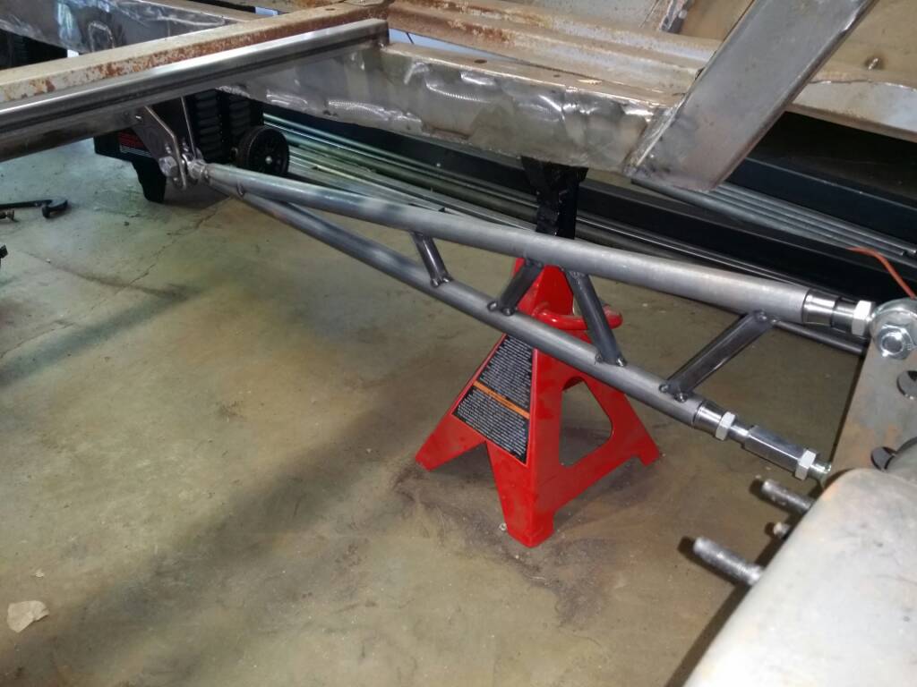

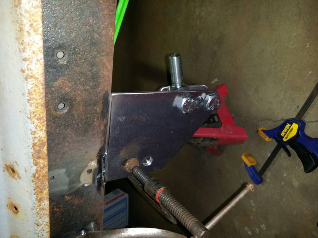

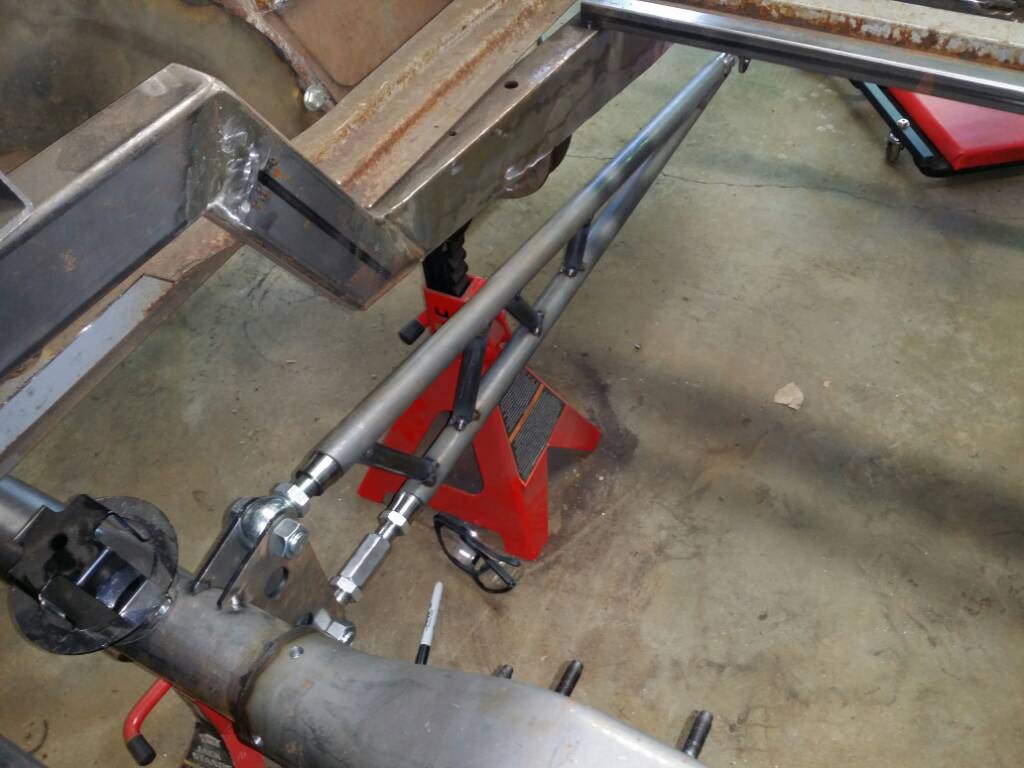

    Got the ladder bars built not fully welded yet but there together and on the car 1465161365247.jpg 1465161370229.jpg

    Yes he did that because the frame kicks in as it goes to the front and if he put a bend in the top bar and the ajuster up there it would have hit the frame there isn't enough room.

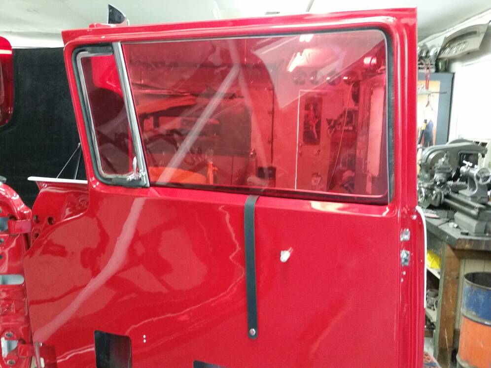

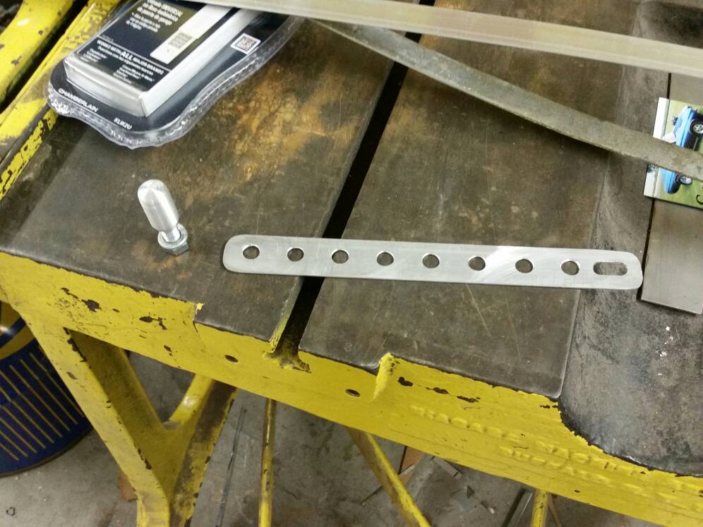

    1465770032449.jpg 1465770037950.jpg 1465770049951.jpg 1465770064956.jpg 1465770081764.jpg
    Got the door windows in today. Made them go up and down with a strap with a snap on it. Also made inside door handles pistons came in Tuesday and the motor is going back together now hoping to have it back in a week got my fingers crossed
