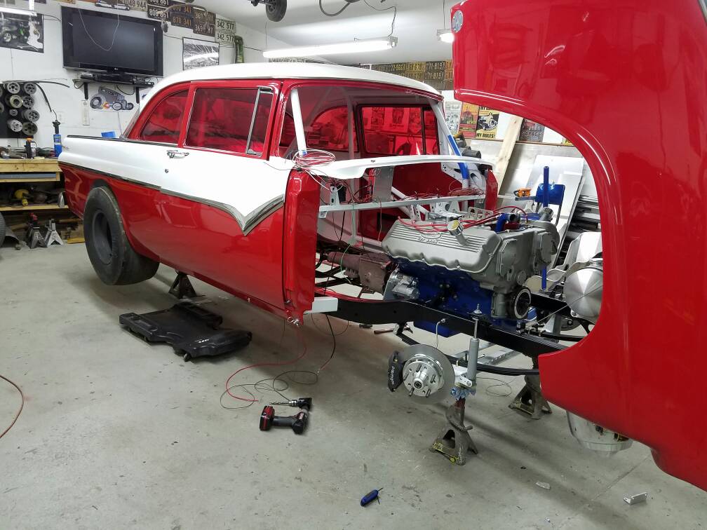

  3. I'm doing the same thing to my doors. did you do anything to keep the strap from falling inside the door
  4. strokedstang331
    Joined: Oct 14, 2008
    Posts: 531
    strokedstang331
    from Beloit WI
    Yes I put a snap on the top edge of the door to snap it to when it's down. I also put a stop on the gl*** so it couldn't go to far down. When the window is all the way down I can still grab it with my hand and pull it all the way up to get the strap out if it ever did fall inside the door. As of now it seems good but we will see once it has been used for a year or 2 I have tried to think of worst case when designing it but I do not know what these doors are going to do after a season of racing. They are extremely lite and the inner structure is paper thin and flimsy. I plan on putting a partial aluminum door panel on the lower 3/4 of the door so I'm hoping that will help a little with the flimsy inner

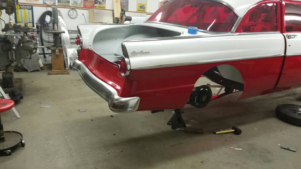

    Got my rear bumper painted and ready to be put on. I decided to try something new with the paint on it. It's fibergl*** and I wanted it to be chrome so I got some house of kolor kosmic krome. It was pretty tricky to spray and looked really chrome until I cleared it. Now it looks more like the stainless trim on the rest of the car so I guess the worked out after all. 1466270336266.jpg 1466270346487.jpg

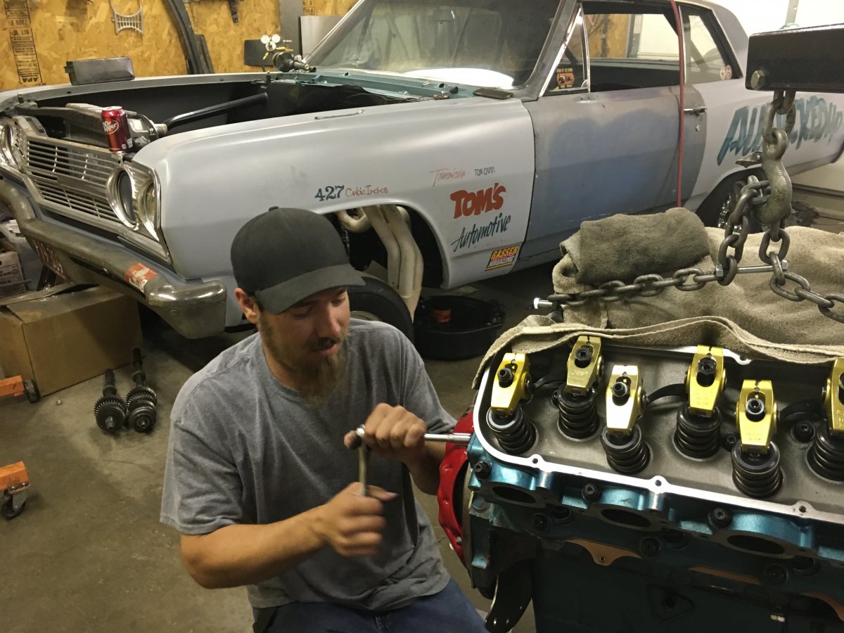

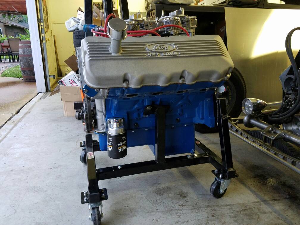

    Well today was a huge step I was starting to believe was never gonna happen. I picked the motor up all done. Hope to have it in this weekend. 1466646005559.jpg 1466646025209.jpg

  11. fast30coupe
    Joined: Nov 15, 2009
    Posts: 1,021
    fast30coupe
    from Illinois
    All that wait and it's at the end of the garage. I think you need to put that in the living room until it's time to install.

  13. strokedstang331
    Posts: 531
    strokedstang331
    from Beloit WI
    Yea if it didn't look like it was going to start pouring I would have had it back by the car but about the time I got the coupe out it would have been pouring. And the motor is to wide to squeeze by it lol. Thanks Gabriel i hope it's as fast as it looks

  15. Dog_Patch
    Joined: Nov 12, 2007
    Posts: 5,133
    Dog_Patch

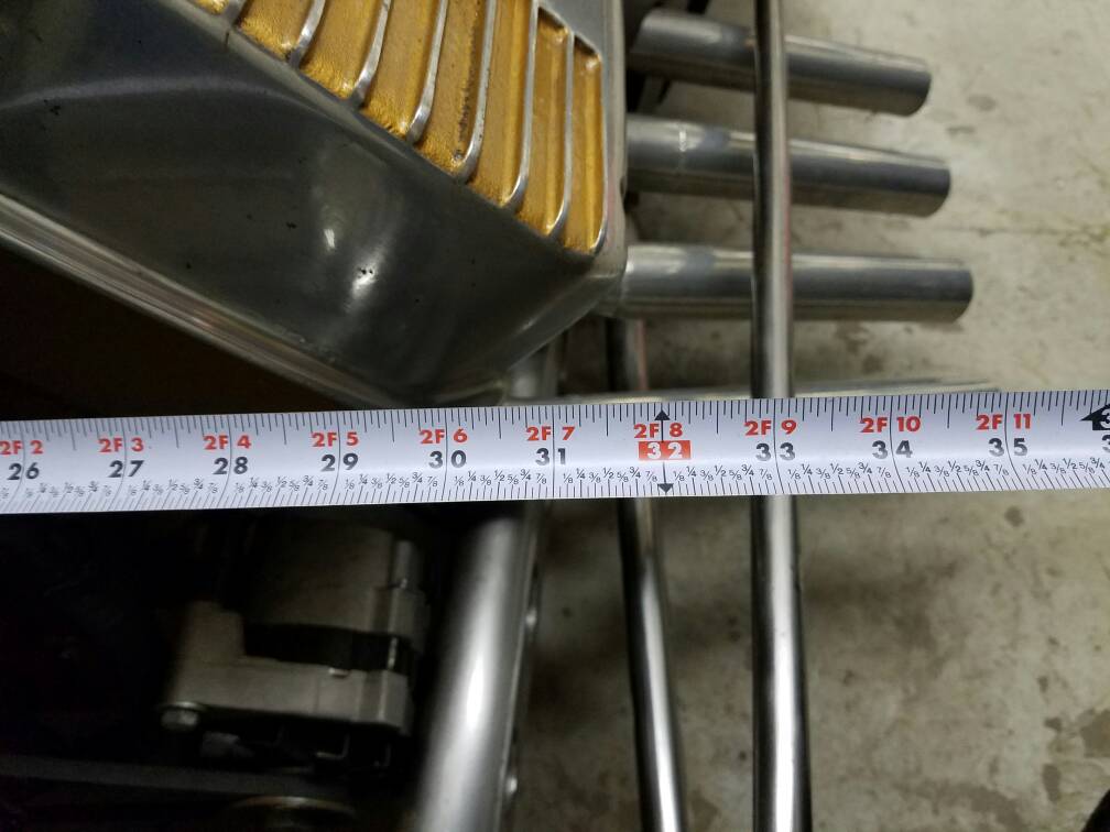

    How wide is that beauty? It looks wider than a 392 o_O
    The 354 hemi in my coupe is like 1/2" wider than the cammer. But the cammer is about 5" taller and a bunch more longer from front to back

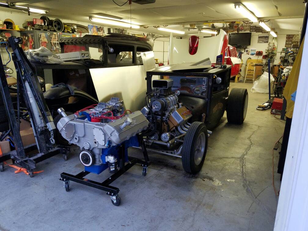

    Finally making some progress. Got the clutch all set up bolted the motor and trans together and dropped it in today.

  18. has the rebuilt engine been dynoed?
    OahuEli and sonic03bluegt like this.
  19. Dog_Patch
    Posts: 5,133
    Dog_Patch
    Man that is going to be stunning.
  20. strokedstang331
    Posts: 531
    strokedstang331
    from Beloit WI
    Yes it has been dynoed. It made less power than the first dyno session. Made 683hp and 564tq. The compression really went down when we cut the valve pockets deeper for more valve clearance. We didn't realize this until after it was dynoed and still ran it on c14 gas with we should have ran c12 as the compression went from 14.8:1 to 12.5:1. We are guessing with c12 it will make around 700hp. The plan is Finnish this year with it like it is and make changes over the winter I want to see 800hp out of it in the spring.
    Sent from my SM-G930R4 using H.A.M.B. mobile app
