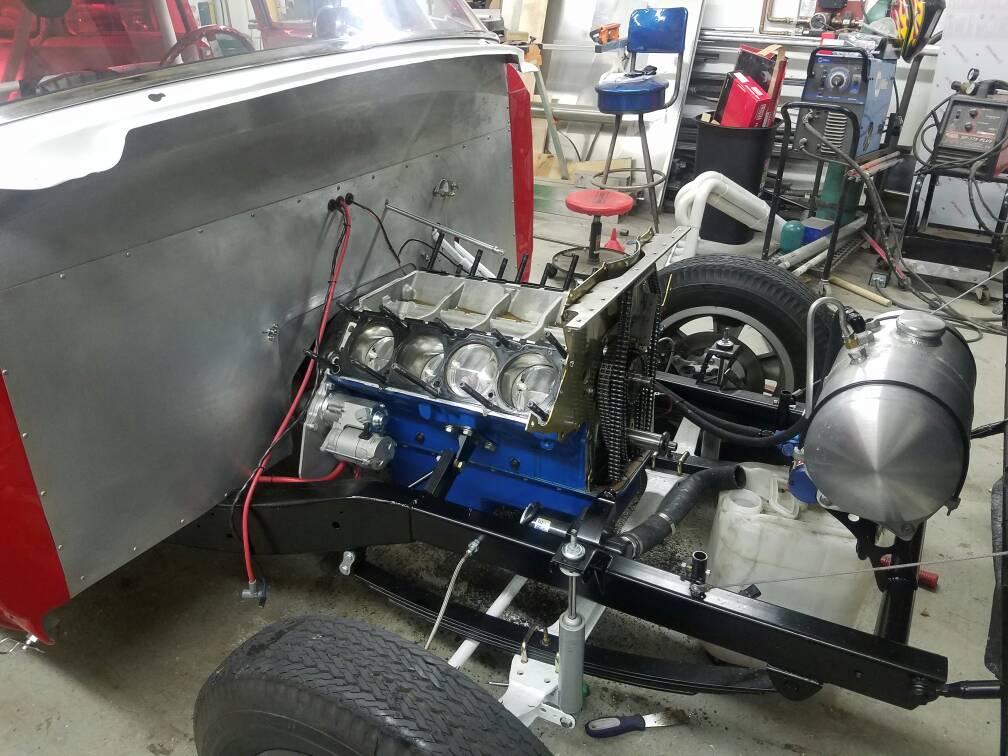

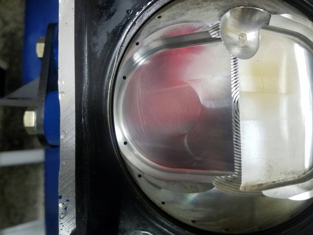

    The original castings is the problem With the heads the valve problem I believe at this time is from the place that didn't pressure check them for leaks. I got it tore down tonight and they did not touch the piston. We were thinking it might have over reved when it didn't shift into 3rd but wasn't 100% sure of that but now that the heads are off the piston looks perfect not a single mark on them. They are Robert pond castings

    Did you wipe the carbon pattern off the pistons or were they that clean?

    I wiped the piston off but it was pretty clean to start with. All the pistons are pretty clean. Only has maybe 2hrs total run time on it. The heads have some carbon on them but not much at all

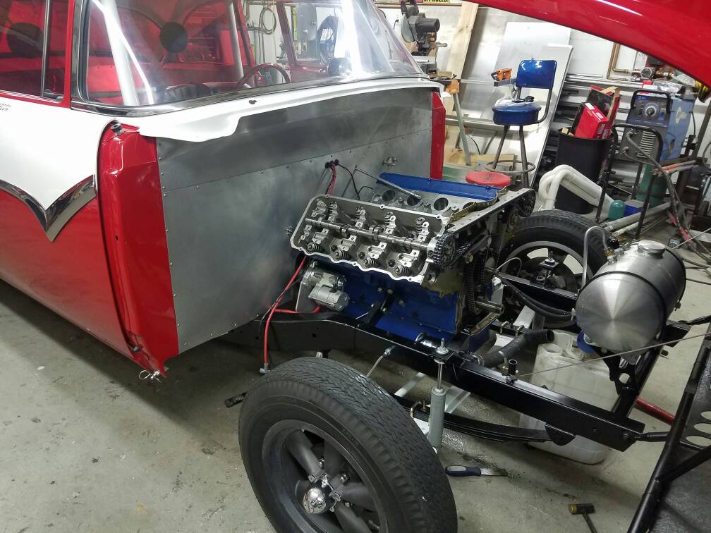

    Got the motor most of the way back together. Let me tell you this thing is a learning curve. The entire chain setup is a real pain to figure out. I had the front cover on and off felt like 100 times mostly double and triple checking stuff. Hope to get it all back together tomorrow and fire it up. I finally got around to figuring out how to make the magnesium valve covers work. These were from dyno Dons estate but they are the early cammer covers and are about 1/4" shorter than the later covers. When I got them I didn't know they wouldn't work with adjustable rockers but after looking them over closer Don had done some grinding on the inside where the adjuster hit and also there was pieces of gasket on them and he had ran them withadjustable rockers he just used 2 gaskets so I tried it and sure enough they clear now so I'm running them. Not only do they look cool but they are 10 pounds lighter than the aluminum ones I had on it.

    Also I added crank case evac since I kept losing the one breather. 1473029757836.jpg 1473029762339.jpg 1473029772227.jpg

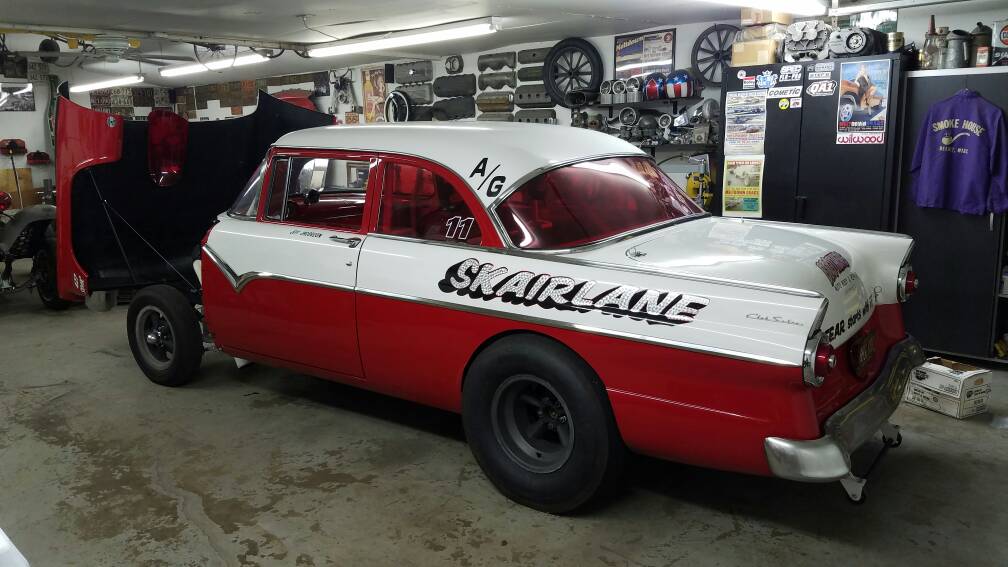

    Well so far so good on the Skairlane. I took it to Union Grove last Thursday night and we went the best of 10.17 @135 mph. The car didn't get any water in the oil made 4 p***es that night didn't have any traction on any of the p***es. We left it on the trailer and headed out for Clay city Kentucky Friday afternoon. Drove through some big storms made it there like 1am sat morning. Sat rolled around we hung out at the track with all the fellow SEG racers made first round qualifying then the rain set it. ****s we couldn't stick around Sunday to finnish the race but we still had a blast. I have some ch***is work to do on it and plan to take it back to the track soon.
