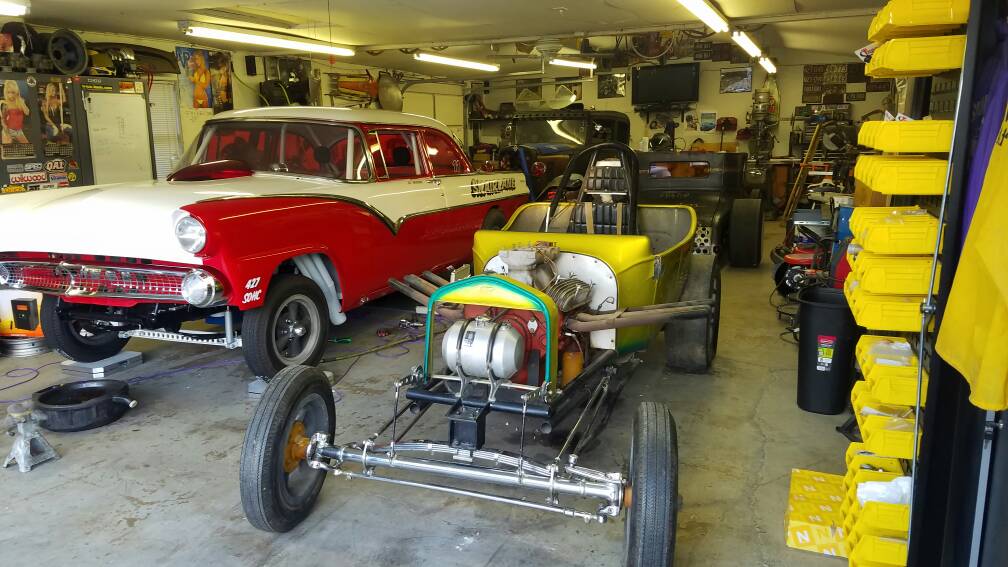

    Thanks fellas I'm hoping to get to the track again in the next few weeks. We are gonna try pretty drastic ch***is changes since it hasn't responded at all with what we have done. The plan is to raise the ladder bars to see if maybe for some reason we are to low. On a side note I picked up a new hot rod yesterday many of you probably seen it on craigslist. It was sold rite away and I contacted the new owner and just by luck he just bought it because it looked cool had no idea what it even was.its kind of a really neat story I'm going to start a build thread for it I plan to just fix what's broke and get it running again. 1476021154815.jpg 1476021174961.jpg

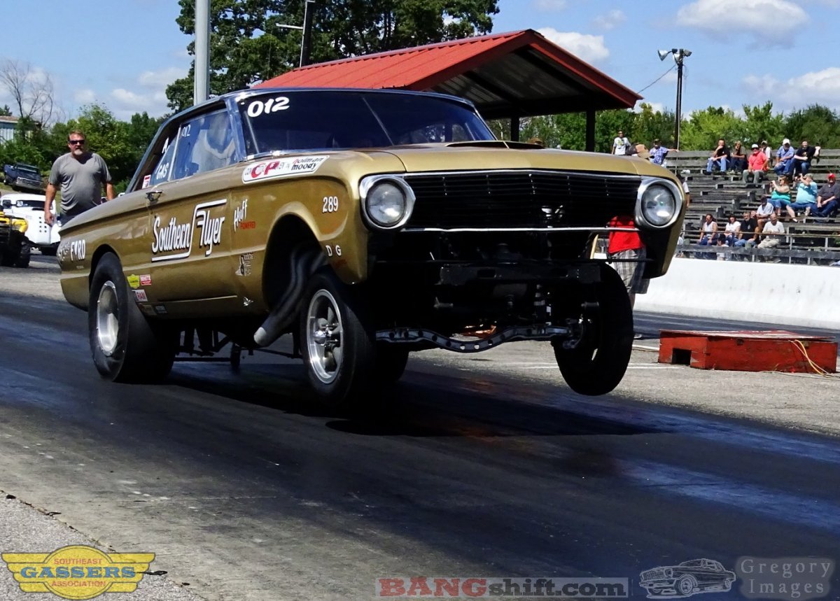

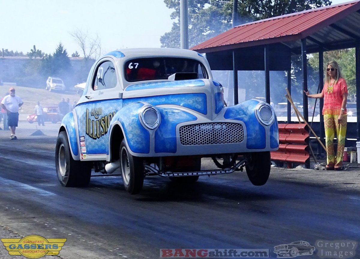

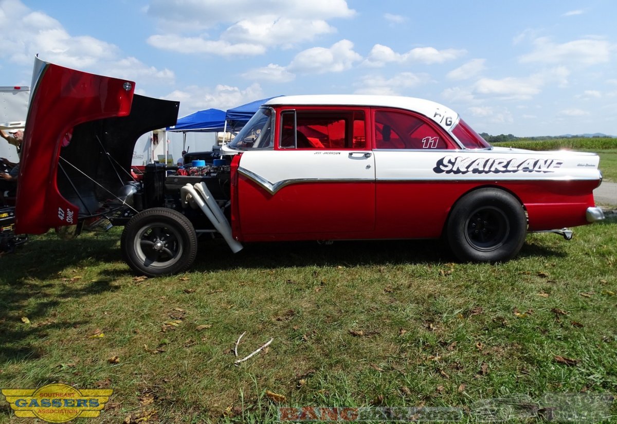

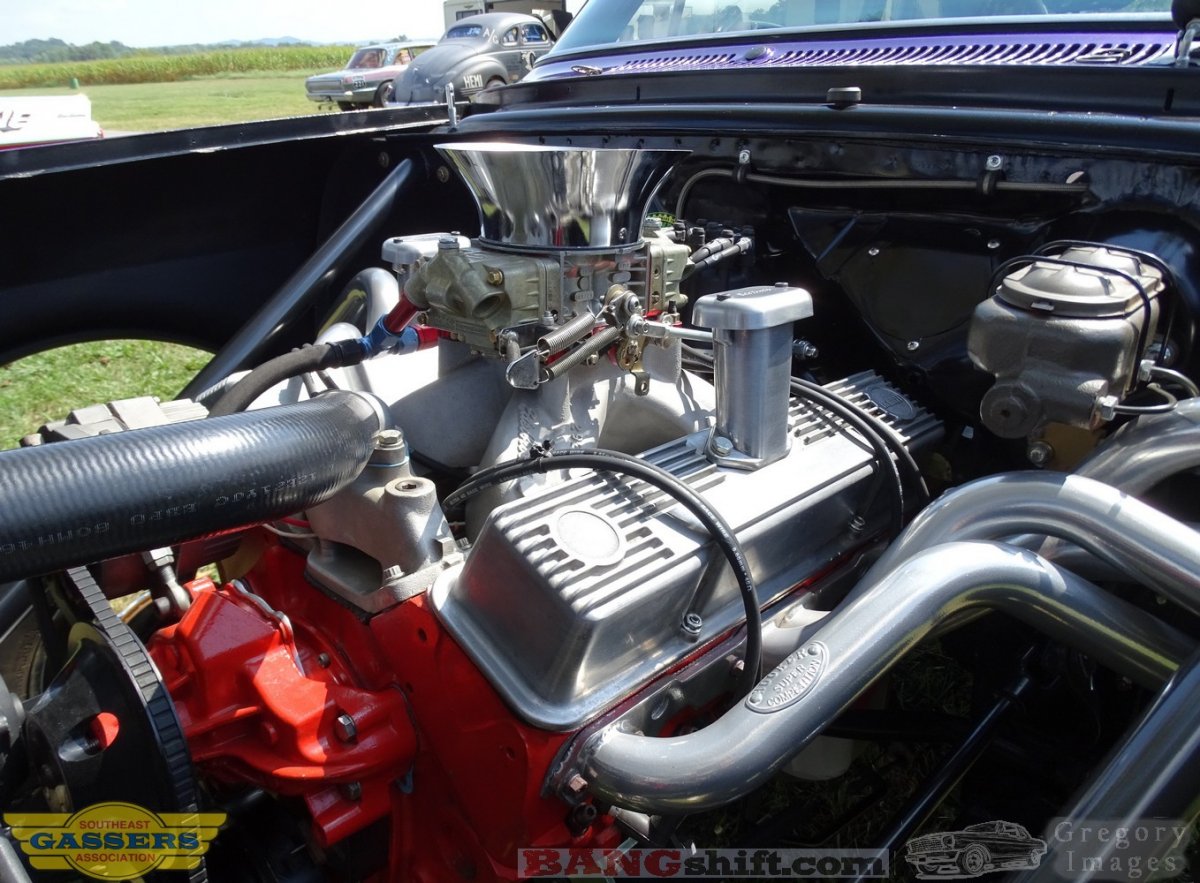

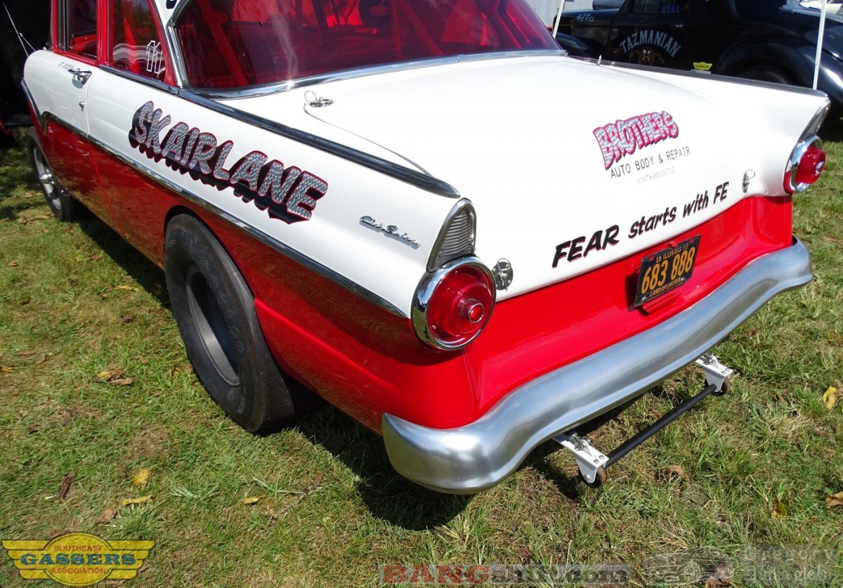

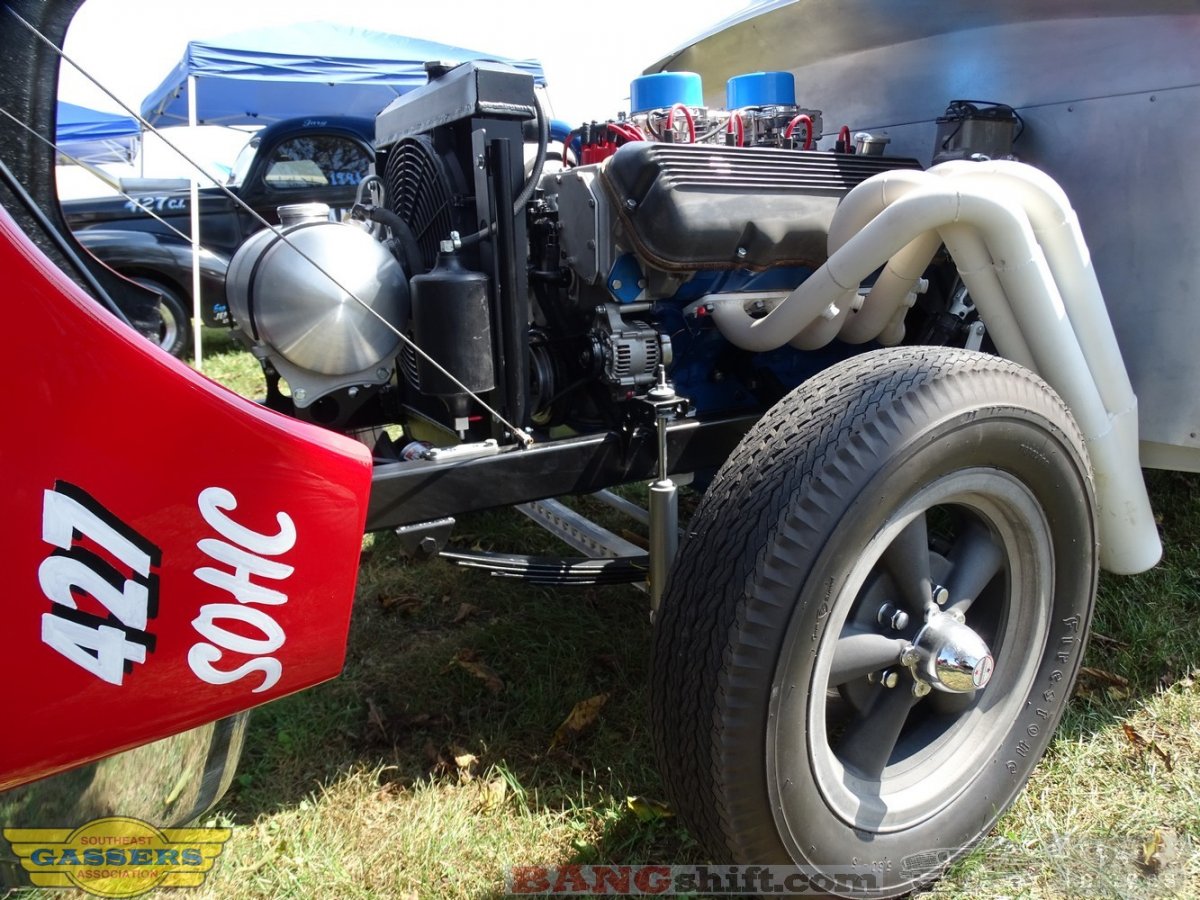

    Well you guys got some good press on bangshift today
    http://bangshift.com/bangshift1320/...-mt-park-dragway-coolest-cars-in-the-country/
    I grabbed some of the photos and will put them here I hope everybody sees their car so I don't have to chase down their separate threads. A couple more guys I didn't recognize from on the HAMB are in the photos too
    Sorry g**** dude I'm a Ford fan so they go first :rolleyes: And yours only got two shots blame bangshift LOL.
    THE MAN
    Pufff, Mtn Goat, 55belairx2 and 7 others like this.
