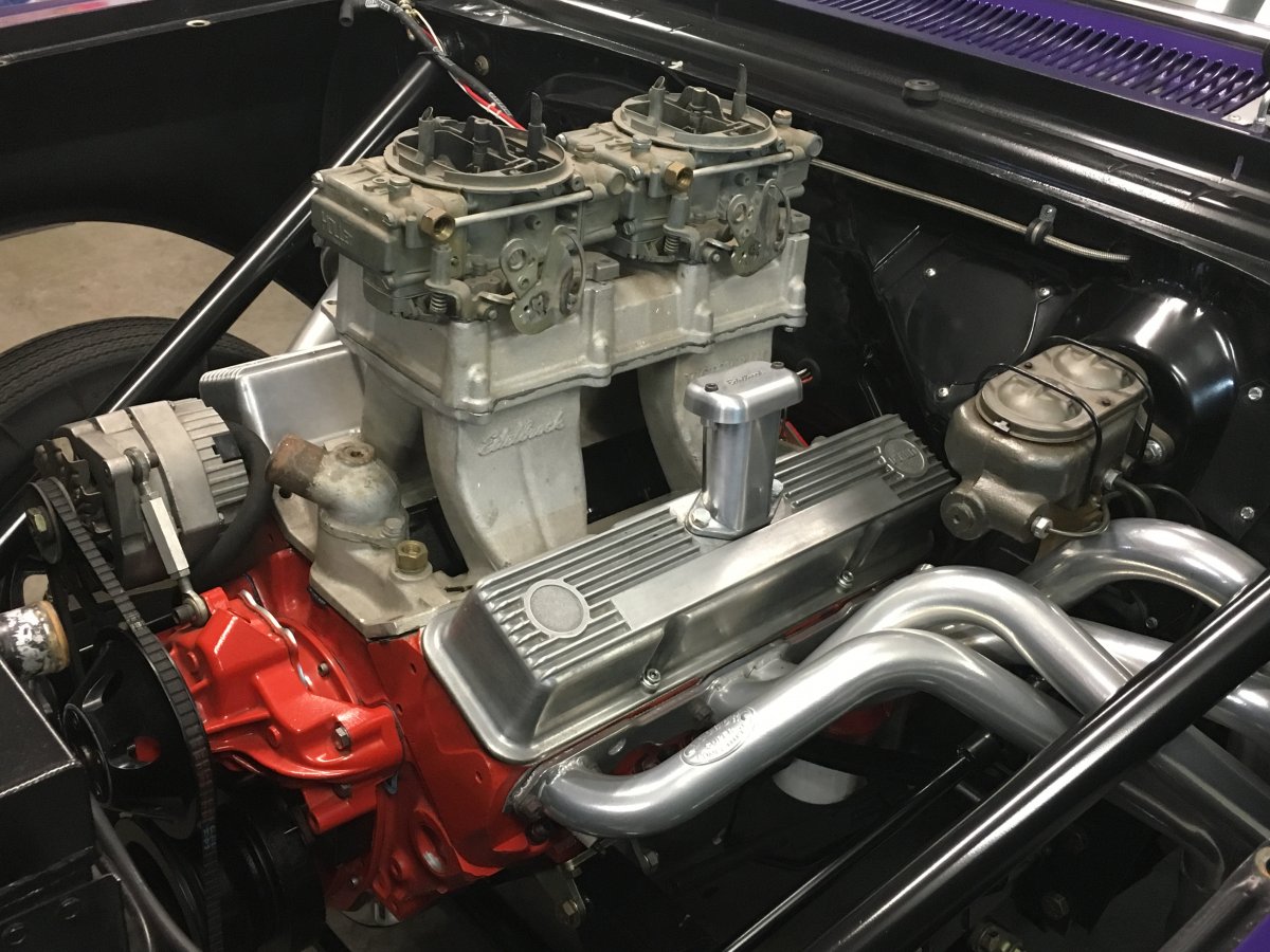

    IMG_0869.JPG Could be big changes for the G**** this year ! Still kicking it around a little ......

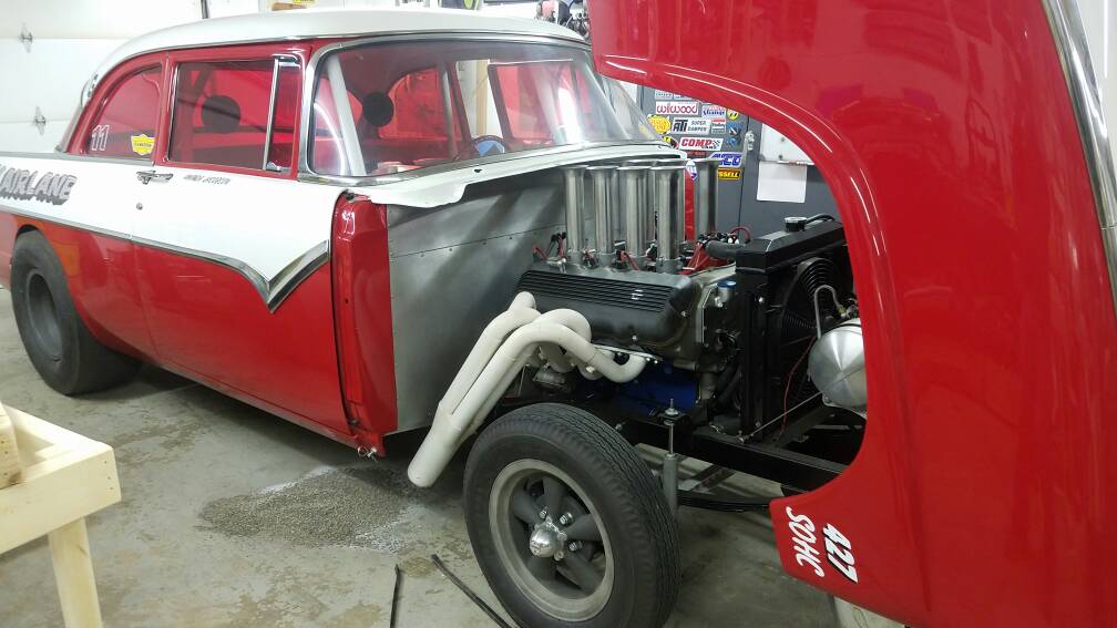

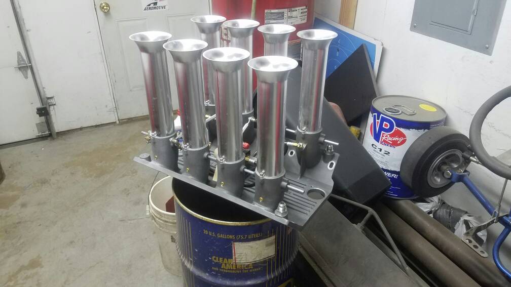

    Christmas started early at my house today. Ups guy dropped this off at my shop this morning. This weekend gonna get it all plummed then pull the motor and send it to the new engine builder. Plan on putting smaller cams in it and make a new set of pistons to get the compression back up where we started beginning of this year at least. Next season is going to be a entire new experience got big plans and plan on hauling this car all over to race with the SEG. Hope my new builder works out better than the last so we can see what this thing can really do[emoji41]

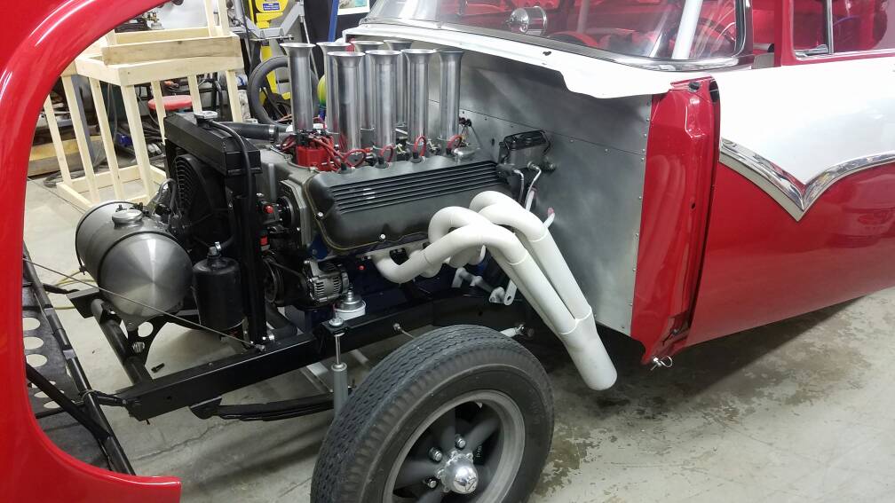

    Got the motor all ready for the new builder it will be heading down there early next week. Injection is all plummed and I raised the moon tank up 3 1/2" so the pump will always have fuel. Had to move the tank forward to I didn't have enough space for the new pump mount to clear the radiator. I also have C***andra Hicks designing a logo for Skairlane T shirts so they will be available this season. Spring will be here in no time so I hope this year we don't have any snags and can actually get it all sorted out.

    Yes they are for the dyno. I hate them I didn't really want to put them in but thought it would help with the tuning so I did it anyways. I plan to build another set of headers sometime this year but that's way down on my list to do so it probably won't happen. The pan holds 7 qts we designed and made it for my setup. No one makes a good looking rear sump pan for a FE that's why I built it. I could probably have called steffs or someone to do it but I didn't want to pay $500 for a pan that I could make for $100

    Do you plan on doing any testing with different stack lengths while on the dyno? Mopar engineers back in the day published info on how long the stacks needed to be based on the transmission being used. Automatics were the longest in the 13- 18 inch area. Manuals were shorter in the 5- 9 inch range. Some were so short they didnt have to cut the hood. There could be some power there.

    Yes I plan to run atleast 2 different length stacks while it's on the dyno. There is a way to calculate the optimal length I'm hoping the engine guy can help figure that out when the time comes.

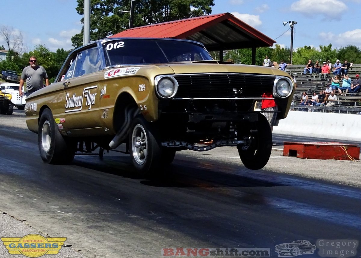

  30. dougg01
    Joined: Jan 18, 2012
    Posts: 9
    dougg01
    from KY
    There weren't more of the G**** because we only had one round of qualifying before the weather blew in. Several cars couldn't stay and run Sunday so I didn't get action shots of some. I did take over 2,400 photos that weekend. I give my photos away to people that ask. Just found this thread so I'm a little late to join the party. Been lurking on here for years and rarely post. All my spare time this winter has been spent working on articles and such. Tons of old school stuff on gearhead in general on my Gregory Images FB page. Easy way to share. Lots of articles in my name on Bangshift. I'm a traditionalist for the most part and believe Land Speed racing to be the purest form of motorsport.
