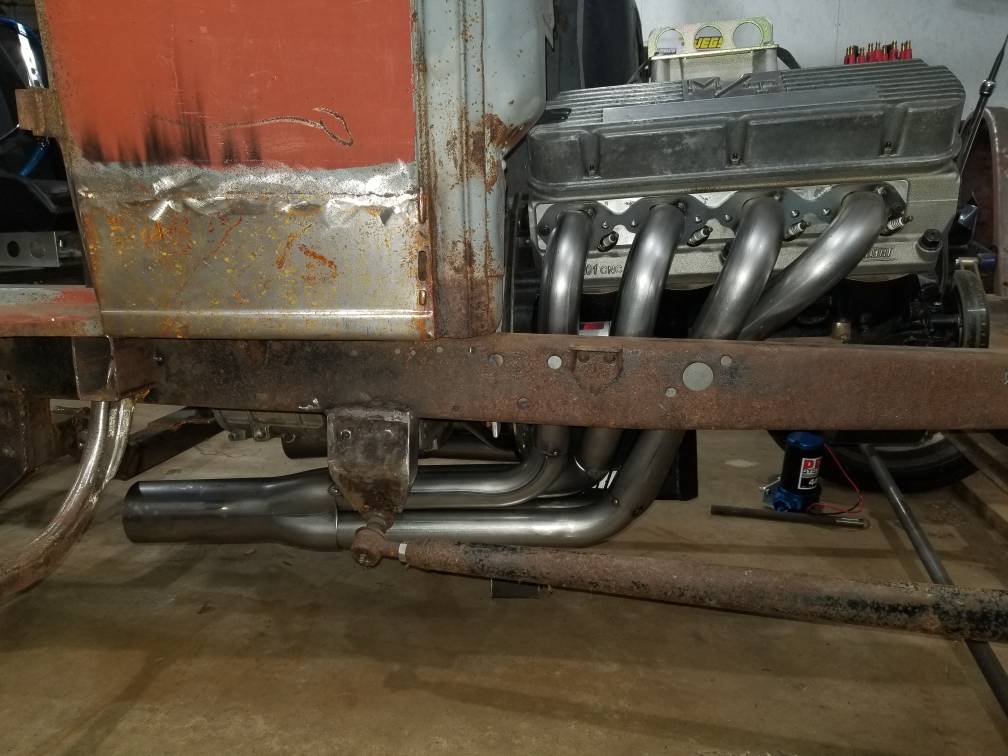

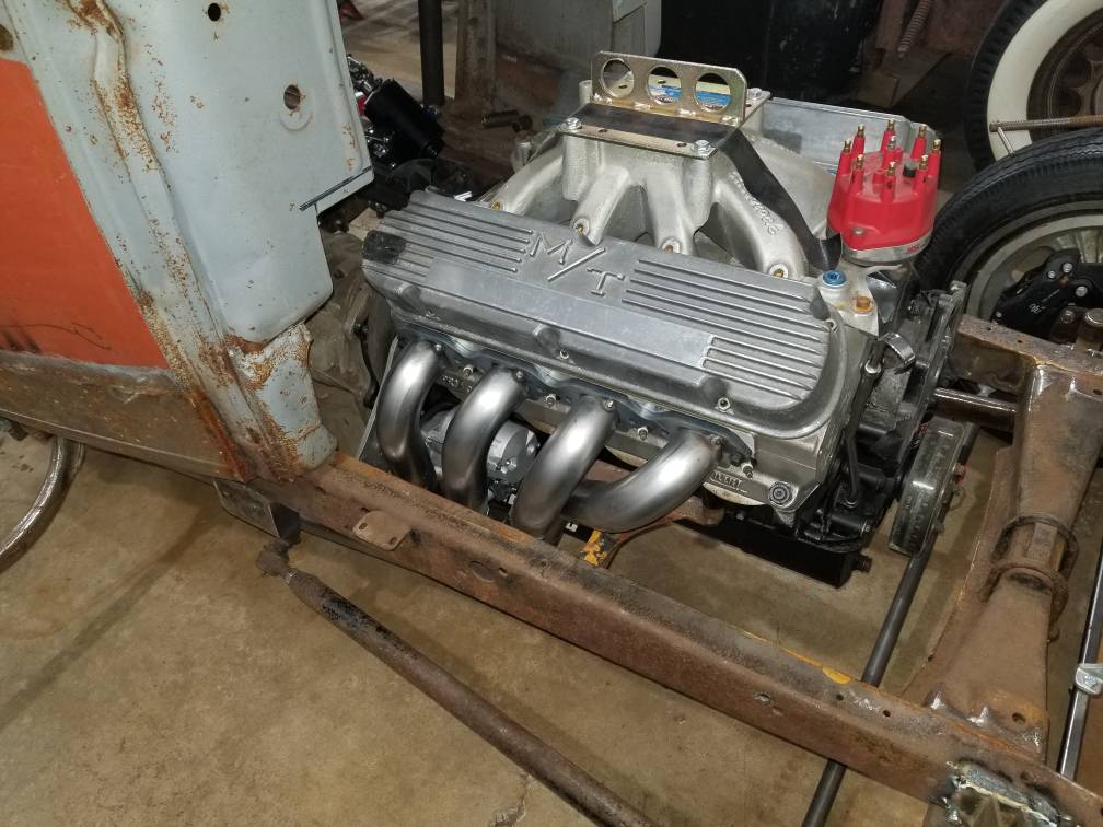

    P***enger side header tacked together
    Side view of p***enger side header with collector.

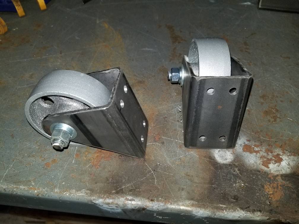

    Wheelie bar casters made.

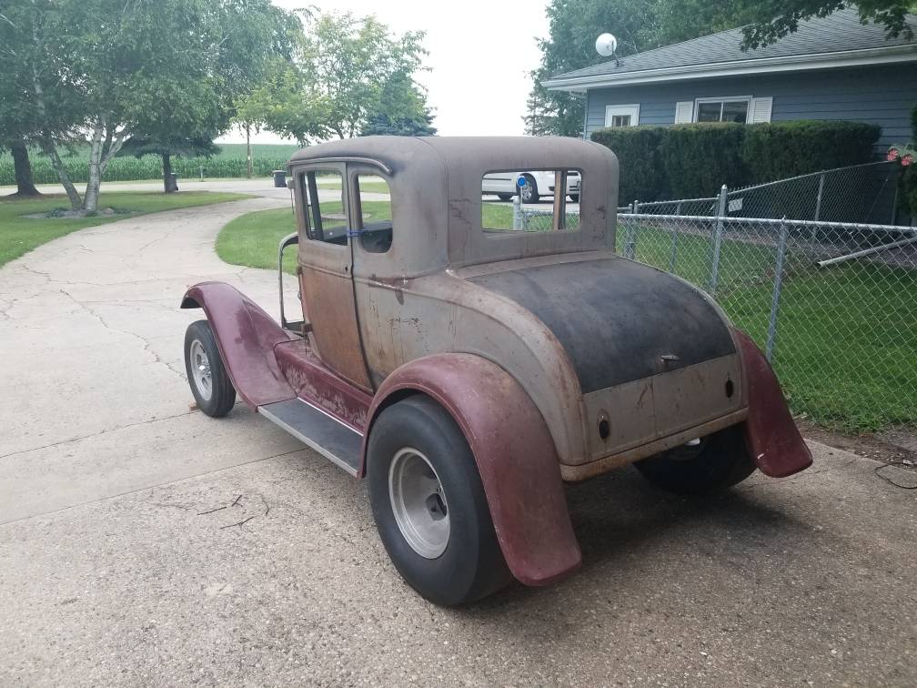

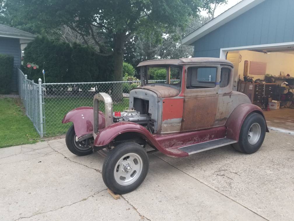

    Front fender braces on the frame.
    Both seats mounted.

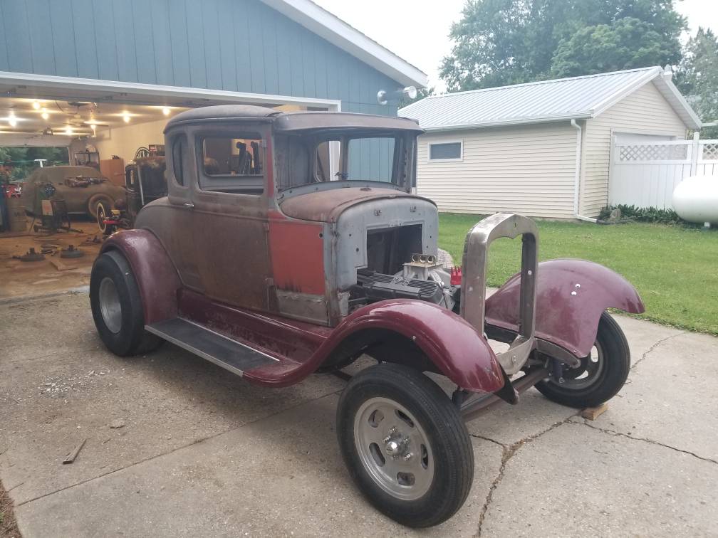

    Put it together partially for the meltdown drags this past year.

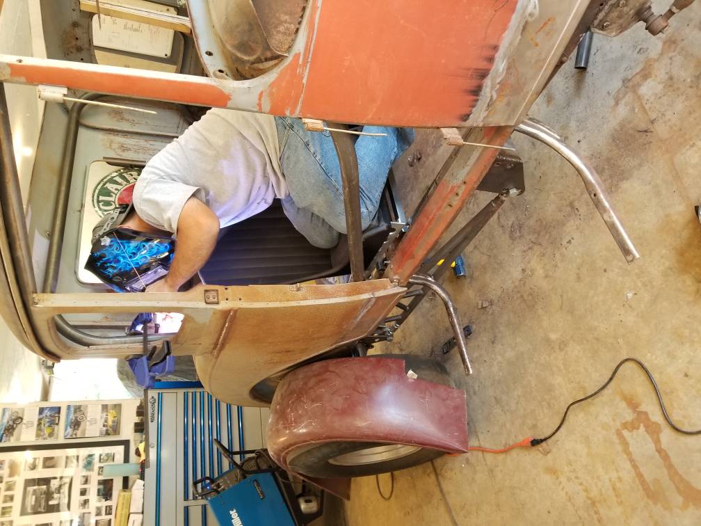

    Got Jeff over to do some more tig welding for me, wish I could tig weld 1/2 as good as him.

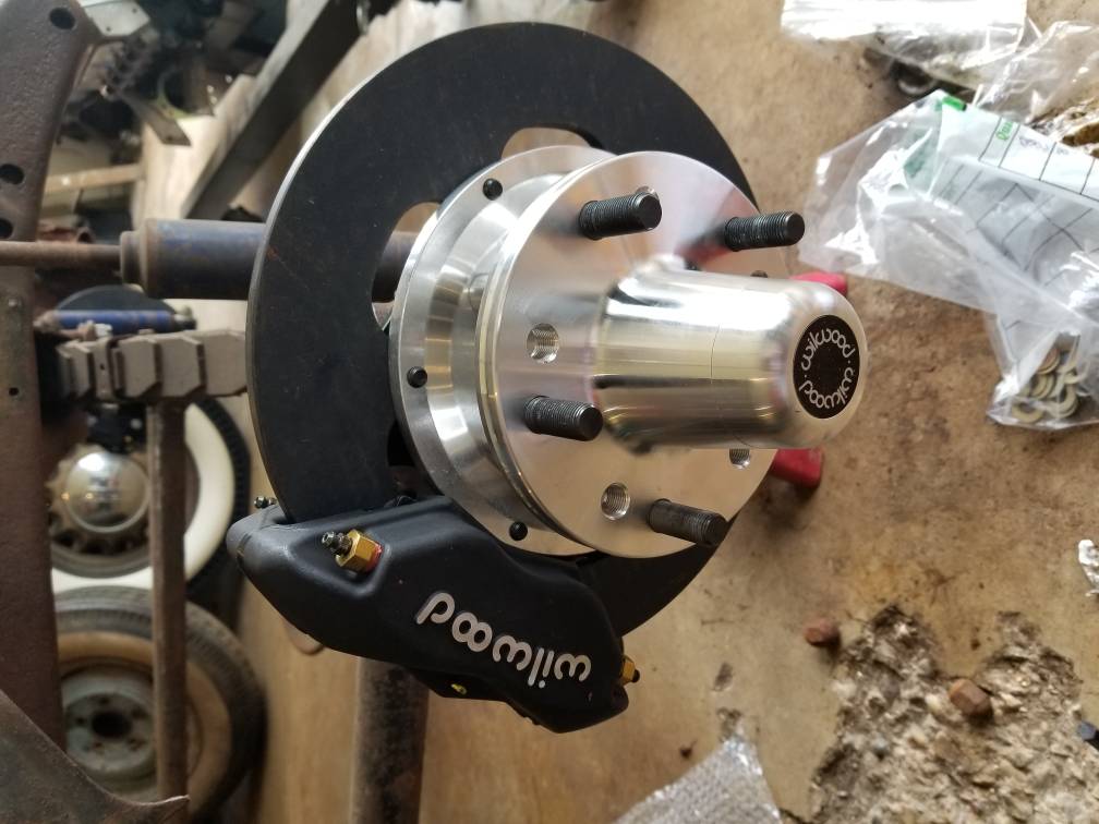

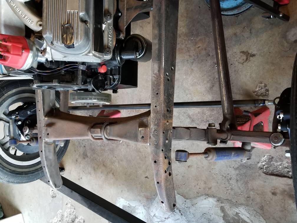

    Getting the front brakes together to make it a roller.

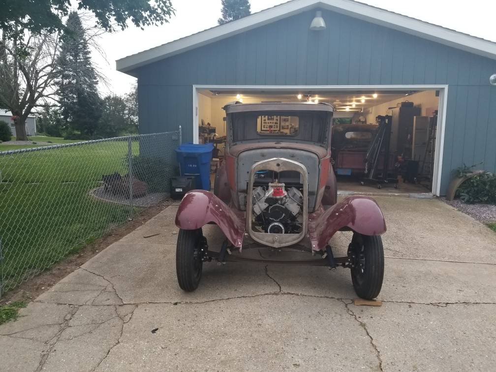

  7. 91whitestang
    Joined: Oct 6, 2009
    Posts: 232
    91whitestang
    from Wisconsin

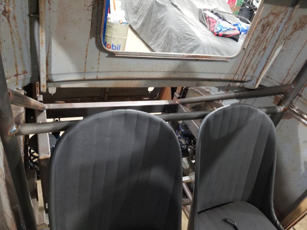

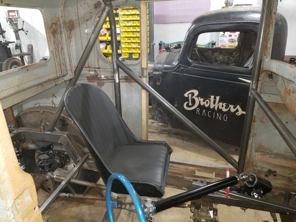

    I'm sure I'm missing some photos in here, but the cage is in besides the door bars and bar behind the seat, rear suspension is getting close to being done. Probably going to get the pedal ***embly done next so I can get the steering box mounted along with getting the steering column mounted in the car. I started a page on Facebook for the car also that if you want to follow along on there you can, search for 1931 Ford Model A coupe the main stage southeast g***ers or you can find it by putting in @themainstageseg

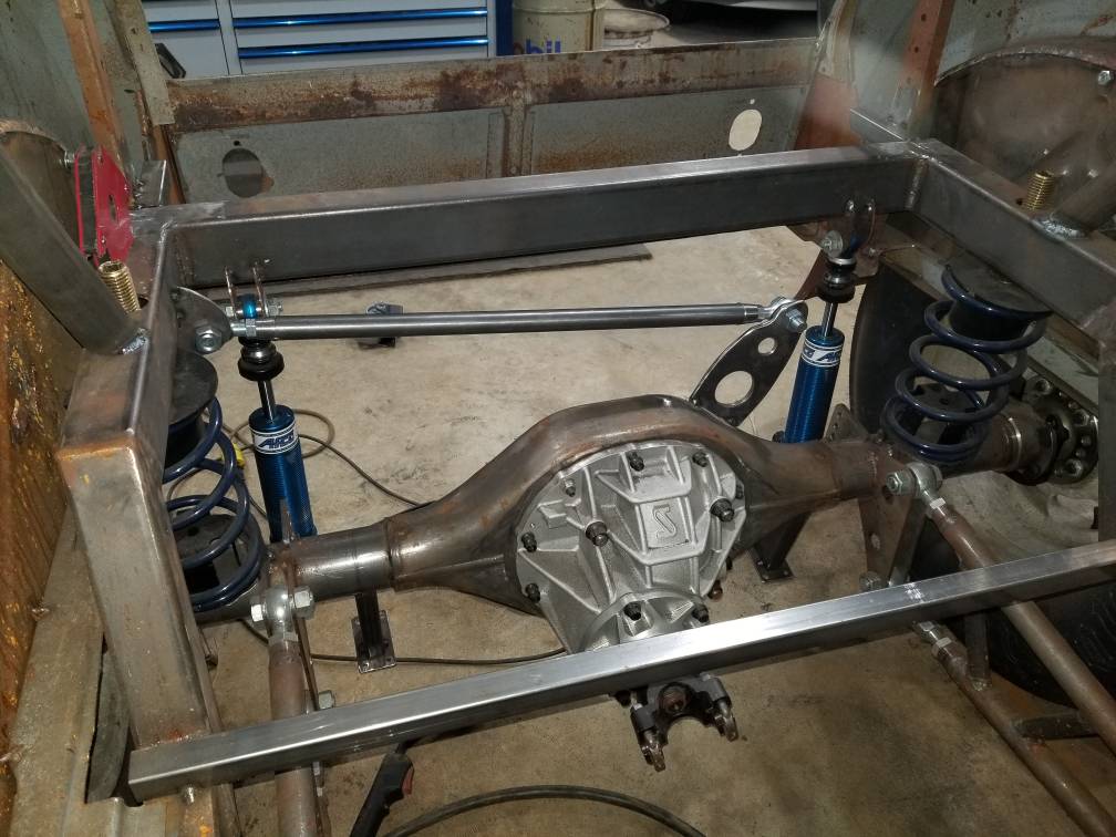

    can you post any more pics of what appears to be jack bolts on the coil springs? Been thinking about this for a while for my car, but can't decide how necessary they are. Any input would be welcome.
  16. 91whitestang
    Joined: Oct 6, 2009
    Posts: 232
    91whitestang
    from Wisconsin
    Sorry this isn't a very good picture but it is a jack bolt that I went through the tubing with and then welded a bung on the bottom side of the frame that goes into the spring pocket to adjust the load. I'm not really sure if I will need them or not just wanted to have them there just in case. Sorry I'm not much help for input but that's how we did it on this frame.
    1931 Model A Coupe G***er

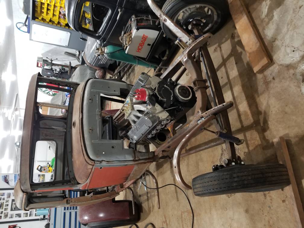

  19. 91whitestang
    Joined: Oct 6, 2009
    Posts: 232
    91whitestang
    from Wisconsin

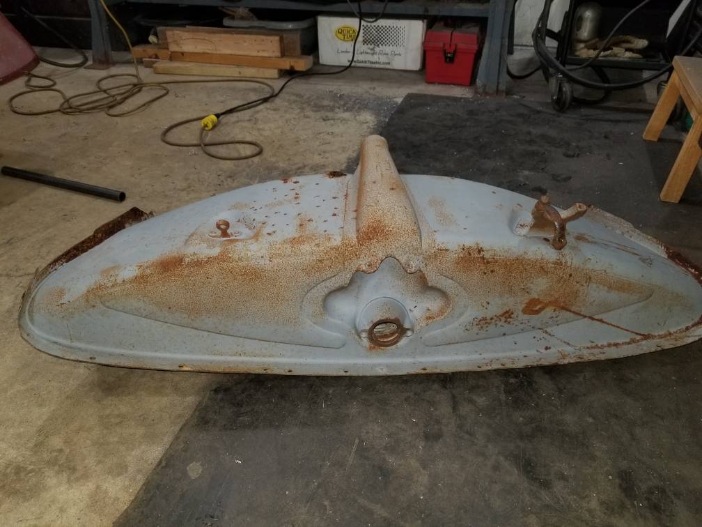

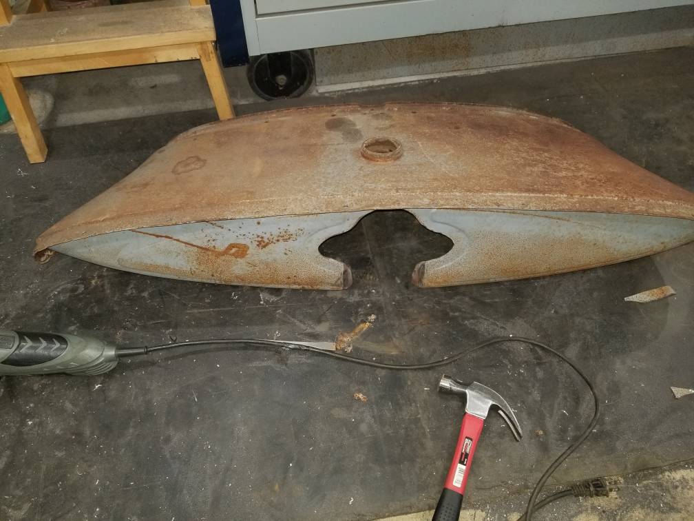

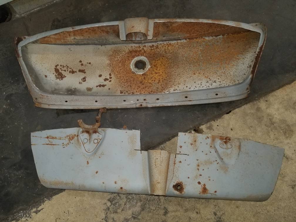

    Started cutting into the old gas tank/gauge panel area to loose some weight. I'm just going to make a panel out of aluminum probably to go into that area with the temp and oil gauges to make a nice clean easy look.
    Then started working on getting the door bars made to fit for the cage.
    Was doing a little practicing on tig welding to on some s**** metal laying around also but I tell ya, that's one thing that takes time to make look decent and actually functional. I have to give credit to Jeff (strokedstang331) for the welds that are currently in my car as I cannot take credit for those compared to my welds.
