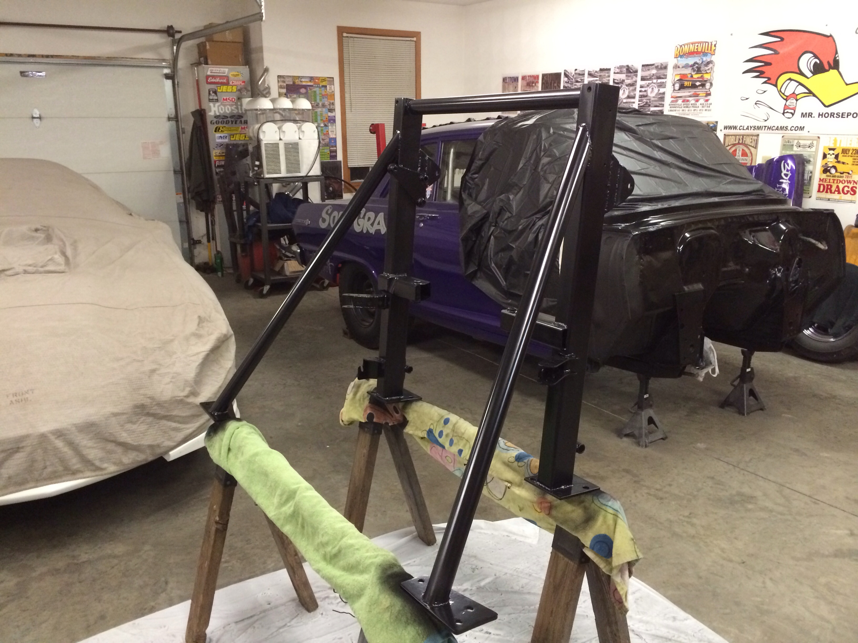

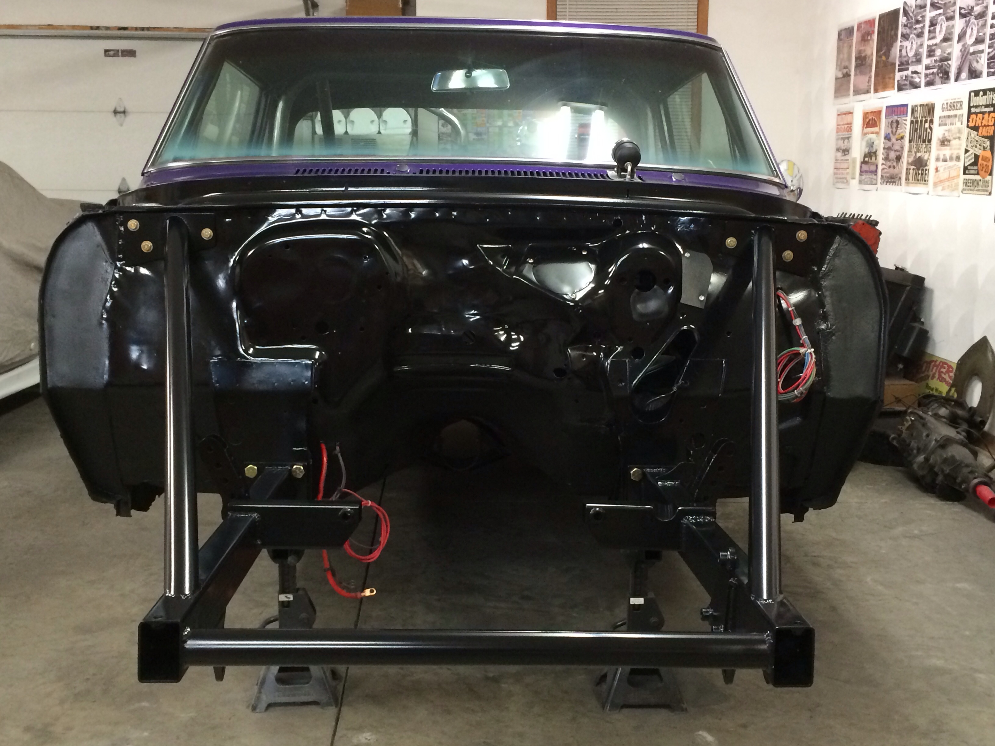

    Quain, Ric, or anyone with legal ch***is building thoughts. I need some help on what to hook my roll cage to...old Chevrolets have the body hooked(nailed) to a wood subrail. I made 2"X4" .125 wall tube ones(when I built it two years ago),and yes Ric it's mild steel. These are bolted to the frame with 6 1/2" bolts. Can I hook my cage to that, or does it have to go through the sub rail to the frame? I can add more mounting tabs to the frame if needed.

    The rule is 2x3 x 0.83 (I use 1.25 in most cases) so your fine with 2x4 x 1.25, but I'm not sure I understand how you have it attached that could be a problem. Post or send me a pic to help me understand better.

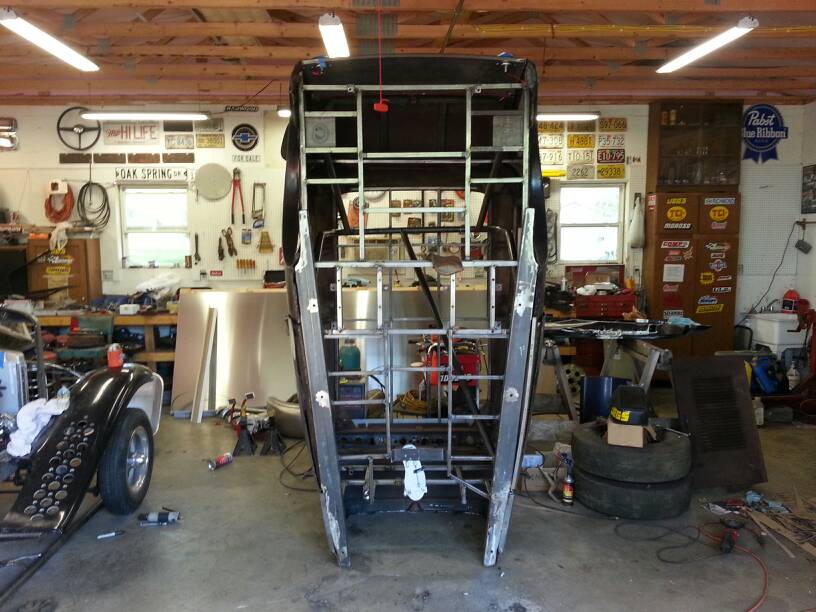

    The 2"X4" tube replaced the wood that was originally holding the body to the frame. Chevy had the body stovebolted and nailed to the original. My body is welded to the tube now (you can see it it the pic with the body stood up) this is all bolted to the frame with three 1/2" bolts per side. I was wondering if I had to mount the cage the frame or if I could mount it to the subframe. The way it sits the subframe is in the way of getting the roll cage down to the frame.
  18. If you want to retain the body mounts you have, looking at the body on/driving compartment pic, I'd say weld a series of triangle gussets connecting the inside of the body bars to the top of the frame (permanently attaching), and several each side under the car, especially where the main hoops will attach to the body bars. If you have a crash, and the body bars aren't welded to the frame, then the whole body could come off when the bolts shear, while your strapped in the seat. You have to make the body mount bars a permanent part of the frame (if attaching the cage to it). It looks like if you attached the cage to the permanently welded body bars, you could still unbolt the body at the original tabs to remove it if necessary in the future. Before you do all that, you could also replace all the .125 wall mild steal mounting bars etc. with new chromoly too. :)

    If I welded and lightened the existing subframe to the frame...would that be a legal mod?

  21. If you lightened it conservatively (hole's etc.) it'd be ok, but holes might take out 3-5 lbs. and I'd rather have the strength at that point.

    Can you weld some outriggers on the frame to mount the cage then just modify your sub frame around those points.

    At the back I can see the frame, because the subrail is wider than the frame at the back...it sits on brackets that are factory riveted and I welded them too. The front will have to be modified, because the subrail sits right on the frame, and an outrigger to move the cage would make the already small cabin smaller.
  24. If you use your existing mounting system, and add some welded gussets underneath, to the outside of the frame with flat plates to mount/support the sub frame, at the roll cage mounting points, that may work. If you tried to tech at an official NHRA type event, they may not be too keen on the cage being welded to something that is bolted to the frame.

    Yeah, I'm just going to make the cage weld to the frame the way the NHRA would approve of, and notch the existing subframe to clear it...I was only going to do this, so I didn't have to lift the body up to weld the cage in the front. Like most things the hard way is the right way.

    So can you shorten the sub rail in the front so the cage can be welded to the frame at that point.
