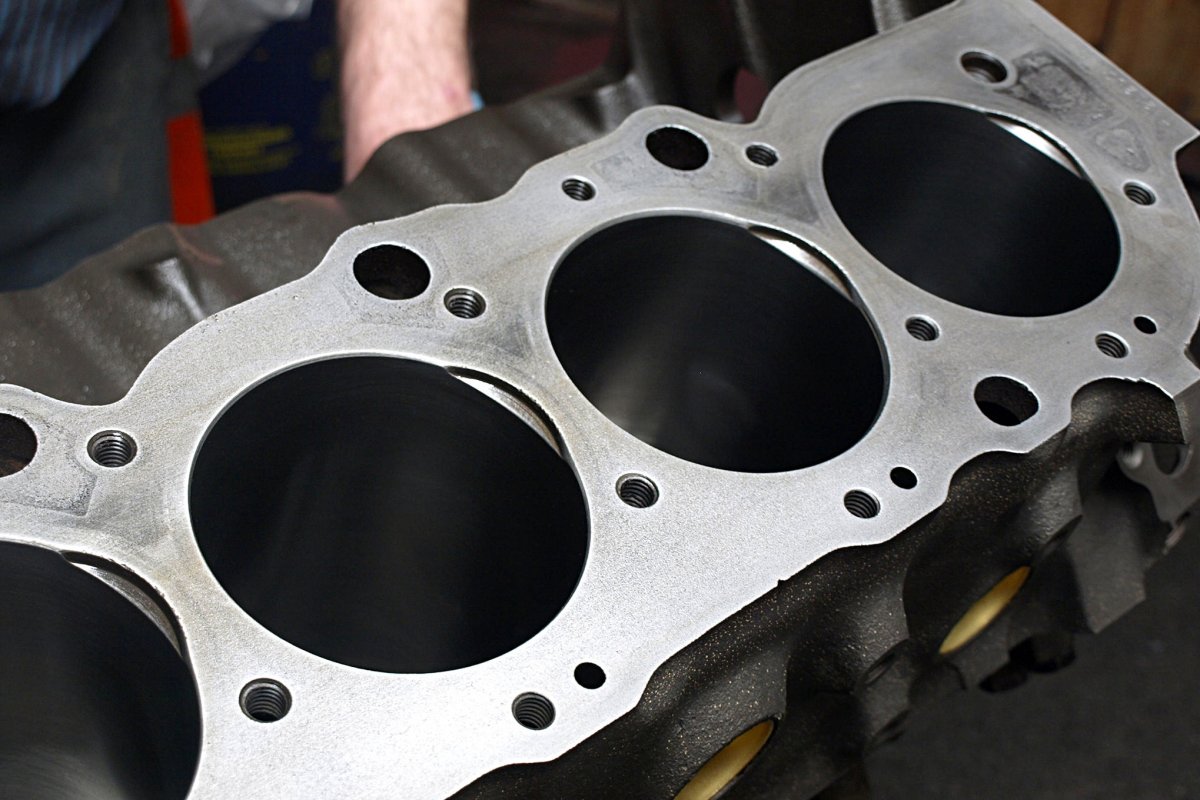

    Chevy notched the bores on the 396....they seem to work just fine....

    With the Canted Valves in the 396 and the notched block it still flows decent. If you notched a 283 to take the 2.02 valves wouldn't the block shroud the valve? I just picture Air flowing in and hitting a proverbial "air dam" into the cylinder.

    The head gasket on the 396 was designed for the notch.
    You also have to notch the gasket as it will interfere with the air flow around the valve.
    When we were running dirt modifieds we experimented with a 366 Small block that had notched cylinders and head gaskets that were done at the machine shop. The engine actually had too much torque and would break loose the tires on the straightaways. Went to a 377 and that was the ticket.
    I saw the results of a 400 block (383) where it had been notched by the owner.......blew an 1/8 deep groove between the cylinders.

    squirrel
    uh....I think the idea of the notch, is to get the bore out to 4" near the intake valve. Not to go past 4-1/8", like that guy did!
    And using normal 4" bore gaskets would eliminate the need for notching the gasket.
