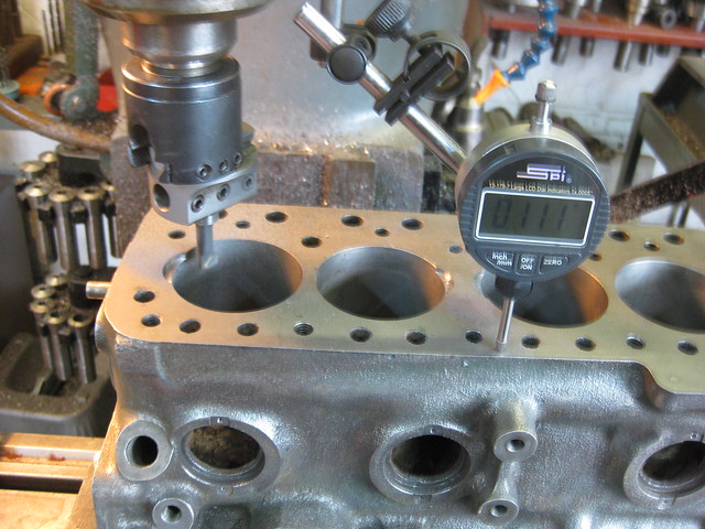

    Will you be doing the bore notching yourself? it's the kind of job that most machine shops (over here anyway) aren't keen on doing -probably the reason that I get to do so many.
    The notches are much simpler to machine on blocks (like this old Austin race motor) where the valves open at 90 degrees to the block face -which of course isn't the case with an SBC motor. As said earlier in this thread, keep the bottom of the notch well above the top piston ring to stop the ring land getting burned.
