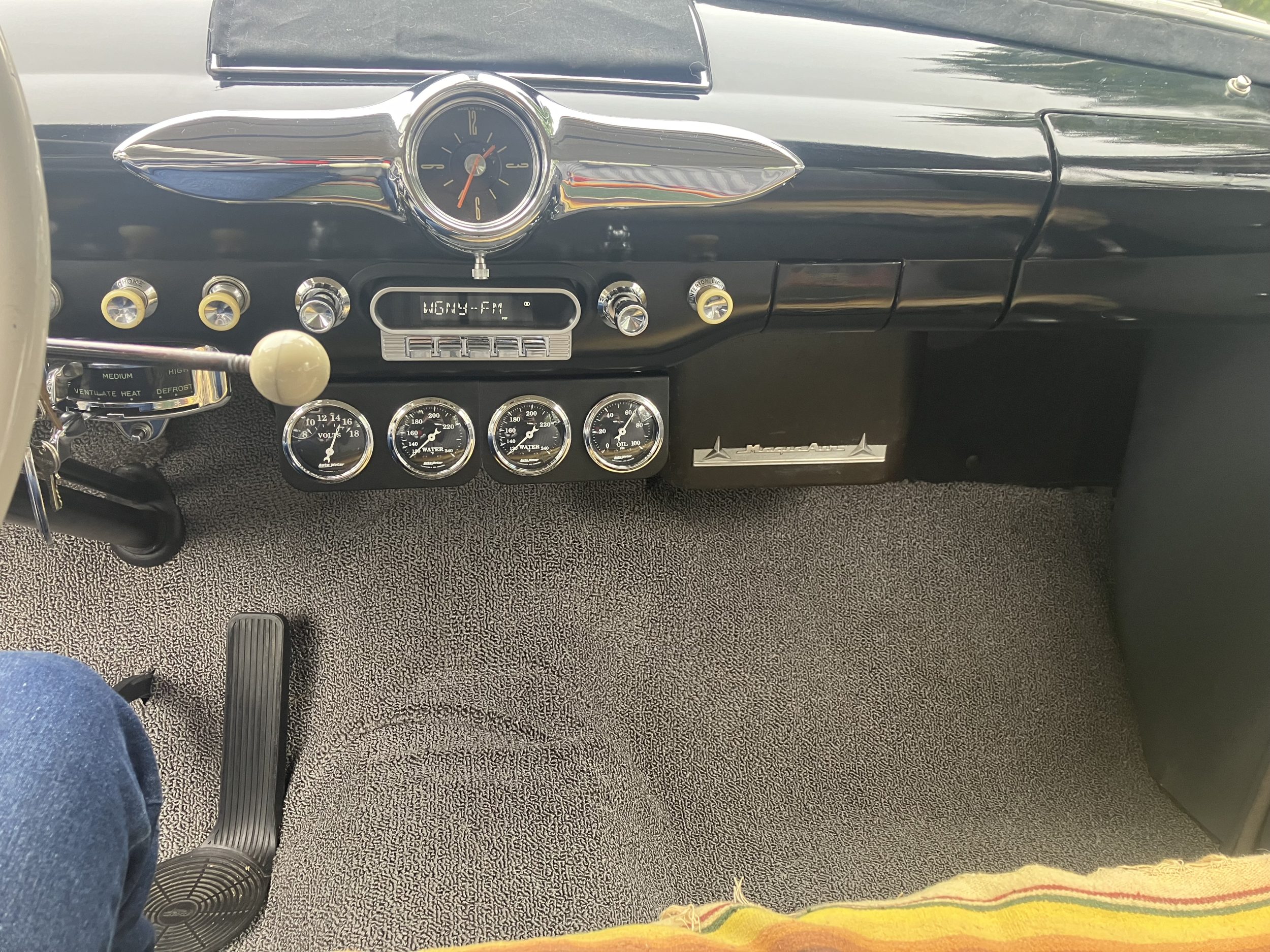

    Thanks all for suggestions. We were able to salvage the pieces - glue them back together! I'll try to post picture eventually here. The clock is back in original place on dash - it looks great! Now, contemplating how to rewire it so that I have a 'kill switch' so as to preserve the clock mechanism when not using during the winter months.

    anyways here's the clock! I have the speaker (which is chrome) covered for while driving because it's blinding at the right angle. tempImage4EeT7Q.png
