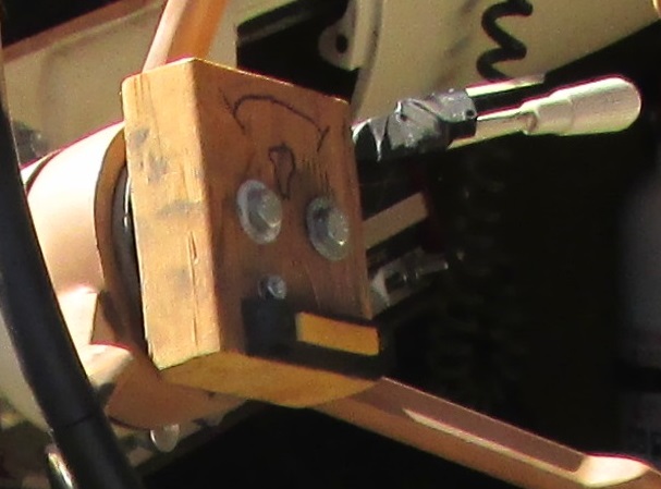

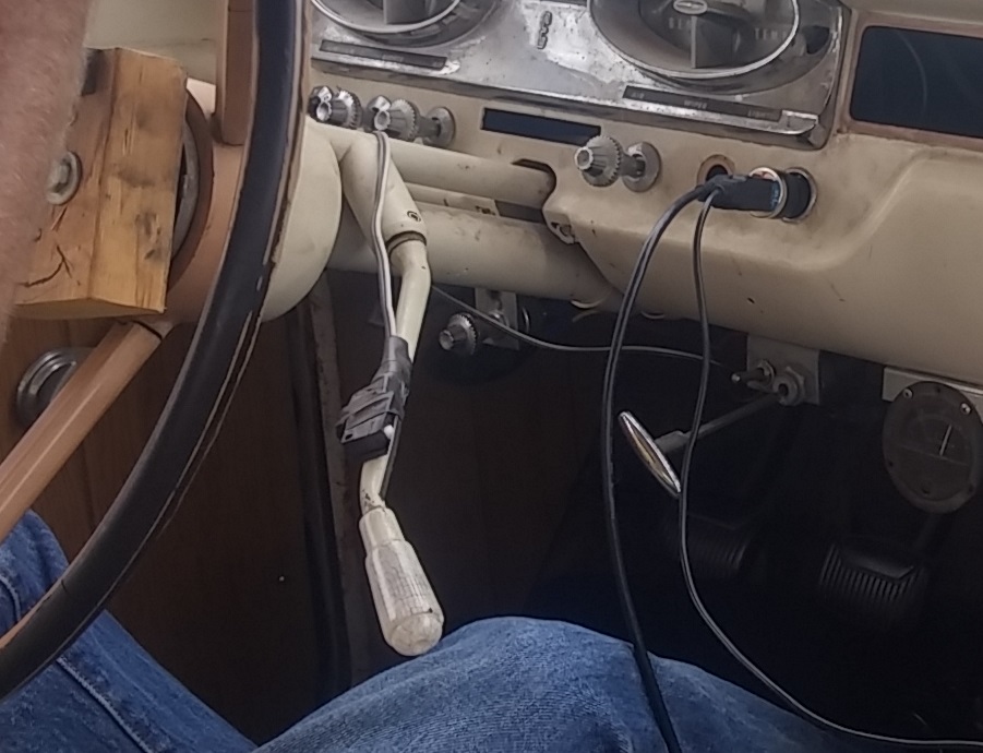

    In the Edsel, I had a KD switch hanging from the column shift lever, and it worked ok, although I think it didn't short the ignition, so I had to let up on the throttle when I used it. The Hudson had the original KD switch on the pedal, it worked great, and got lots of use.
    I suggest you do what you have to to get it set up like original, it makes driving the car more pleasant.
