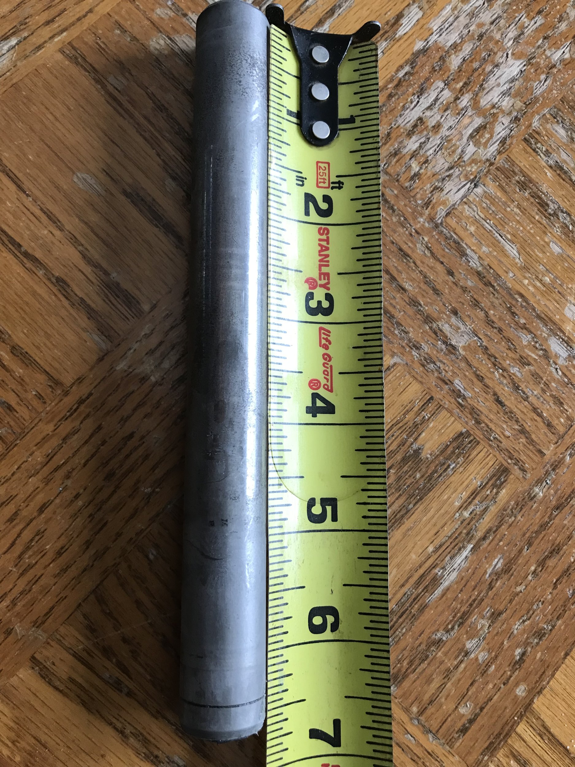

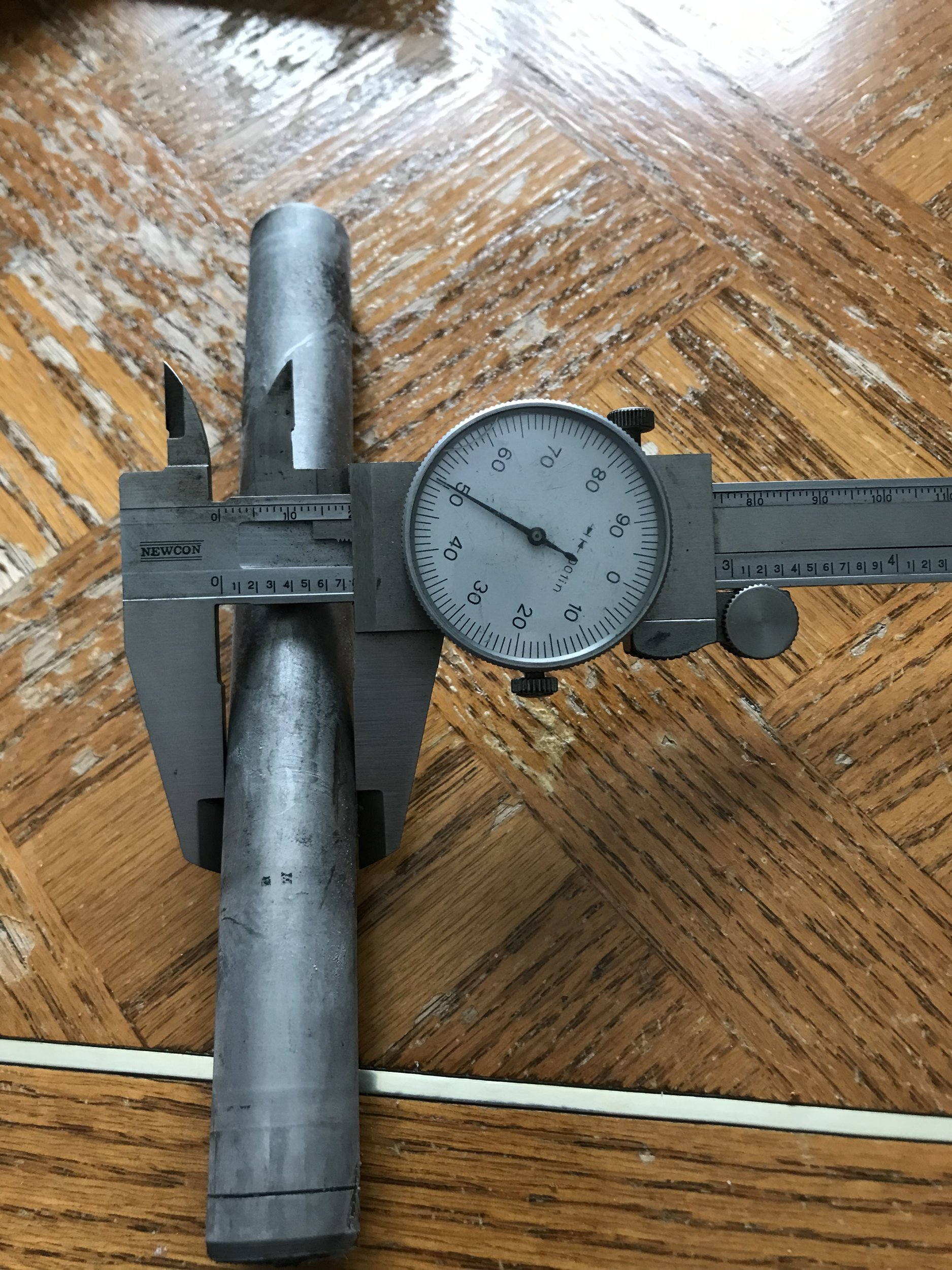

    I’ve lots of spare parts :rolleyes::rolleyes: So I just cut down a shaft 8B7049A4-2167-45BF-B984-FF213B7BCABB.jpeg F97E40A8-F80D-4D8F-9124-A21B4BC34CB8.jpeg
    46international and leon bee like this.
  5. great! 6 5/8" long and 3/4" dia.
