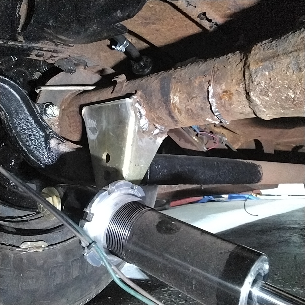

    Look, what's done is done. The shop and people that did this work should be ashamed of themselves, but we all know that. It's obviously wrong. We can dwell on what happened, but ultimately what happens in the future is what matters most.
    So what is the next step here? (I'll preface my next commentary with the disclaimer that I don't have much experience with pre-war Fords).
    @4211papas34 what is your desired result with this car? If you just want a nice, reliable, safe driver to kick around occasionally and take some family for rides in, you can absolutely do that with a functional factory-style ch***is setup. I don't see the benefit to the coilovers in that regard. Or am I missing something?
    These cars came with a rear buggy spring correct? It looks like most of the crossmember is still there. Couldn't the crossmember be repaired and the buggy spring be reinstalled? As for the front, are there dropped axles available for the 33-34? It seems like a fairly common front end.
    I just feel like if the car winds up in the right hands, it wouldn't be the biggest project in the world to just make it safe and functional.
    Thoughts from those more familiar than I are welcome.

    I am a home builder that over engineers everything ( seems common sense to me ), for a so called professional shop to under engineer a customer car is hard to comprehend, here in OZ we need engineer approval for everything modified. I thought the insurance policy's pro shops / registration authority's need, would and should outlaw this type of unsafe ****. Looks like in this case strict registration / engineering guidelines are worth it, even if they seen over the top sometimes. ( although if car already registered, **** like this can slip through - these lowlifes who perform this type of dangerous amateur engineering need to be called out, as you have in this case). Thanks in advance for anyone that would have or about to use these so called pros. Glen

    It appears they didn’t even grind to provide a clean surface to weld to if you call that welding. IMG_1825.jpeg

    Oh man! I can feel your disappointment. That’s just horrific work.
    Surely there is someone on here who can help you. I can only make suggestions from pictures.
    Can someone look at this mess in person and give him some first hand advice?
    Since your first priority seems to be getting it back running asap, is the rear coil over mess the biggest issue?
    Can the rear crossmember be repaired and it converted back to stock spring with the 36 ‘bones? Can you recover the missing parts?
    The front axle mess is pretty straight forward to diagnose and rectify, even it means swapping out the axle.
    Keep us advised of your progress.
    FWIW, that shop needs to be closed down. It’s bad enough that you got screwed over financially.
    Someone being injured or killed because of it is criminal, imho. Time for some accountability.

    did the shop (I use the term shop loosely) return your original parts back to you? sounds to me like all you needed before was new shocks...

    Yes, it can be fixed. You could have the rear crossmember replaced, I believe there are repop crossmembers out there, but you should be able to find an original 34 crossmember you could swap in there. And rear springs are available, you could rather easily go back to the original buggy spring suspension. I would probably clean up the existing crossmember, add some bracing and re-weld everything and stick with the coilovers. That would be the easiest, quickest and cheapest way to get it back on the road. As Marty pointed out, the panhard bar needs to be completely redone, it's too short and not level. There may be more that we haven't even seen that needs to be addressed, but the bottom line is, it's fixable, and the car is well worth fixing. I would press forward pursuing damages from the shop, but I wouldn't count on getting anything, guys like that have a way of avoiding ever having to pay up. the money is likely long gone at this point.

    the very idea of fitting 35/6 rear radius bars is to utilise the
    transverse spring hanger forgeings
    i have no idea how you are supposed to run them in a 33/34
    do you need to swap out the 33/34 curved spring and crossmember for a 35-40 version that is straight across
    how were the shock absorbers fitted before being swapped out
