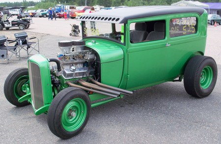

    Thanks guy's, im going for that slammed Hot Rodded kind of look sort of like these pic's I dont have doors but Im working on a cowl as we speak.
