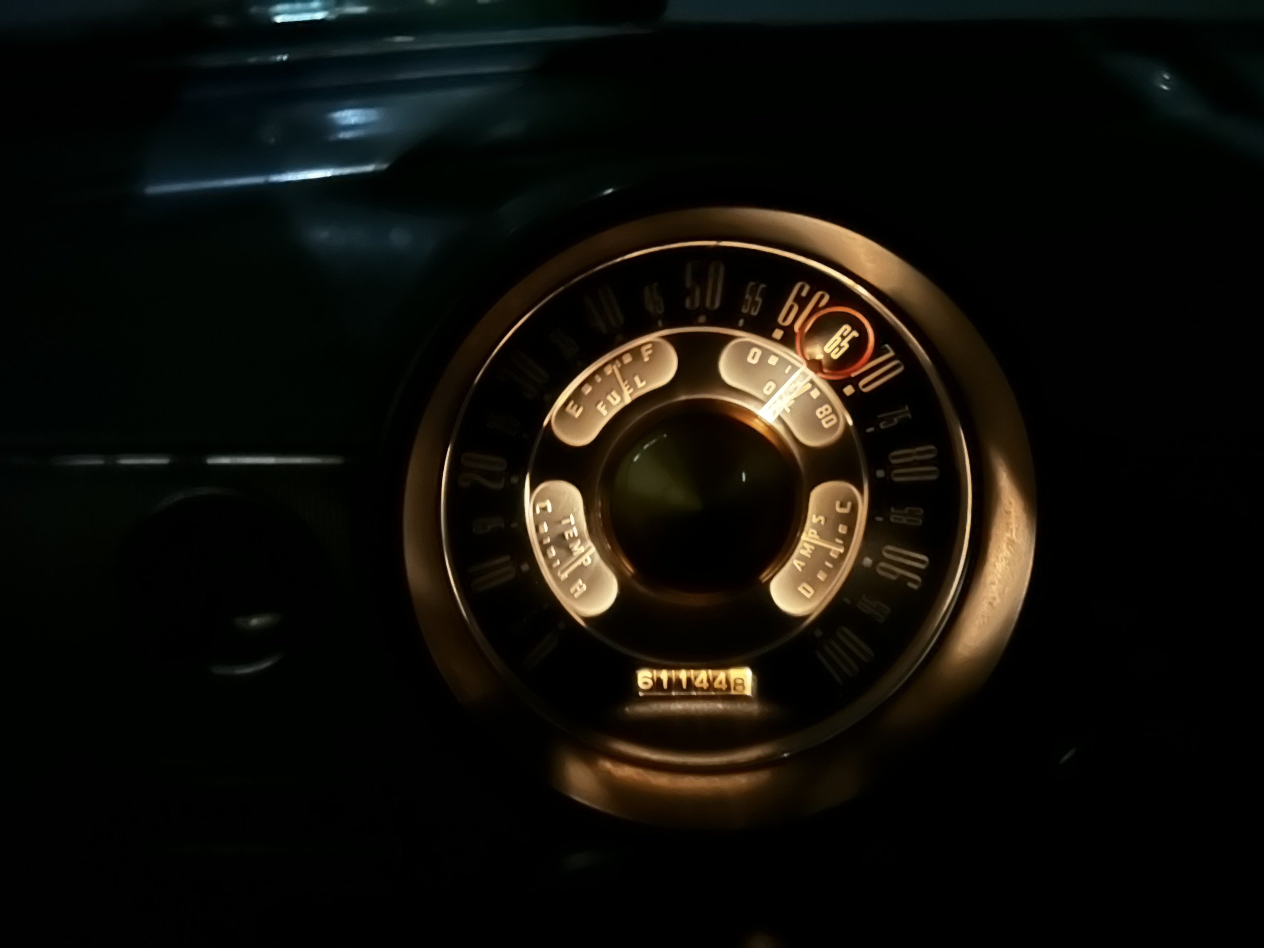

    As of getting home this evening from dinner with my folks and taking an award base to get some sharpie art put on by a good friend and talented guy south of me, sitting at 284 miles driven so far. Planning on another 75 or so tommorow getting to work and back as well as likely a few errands. :cool:
    And, man this is a cool gauge cluster especially how it lights up and circles the speed you are going at night. :D

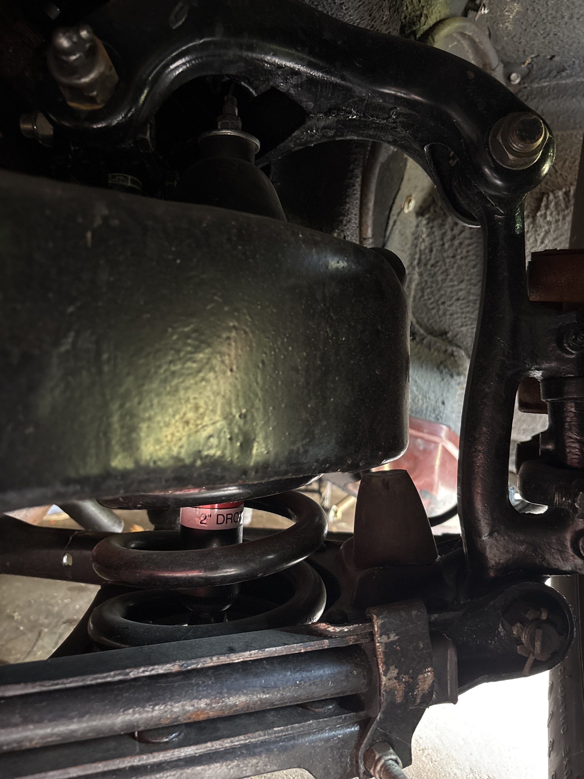

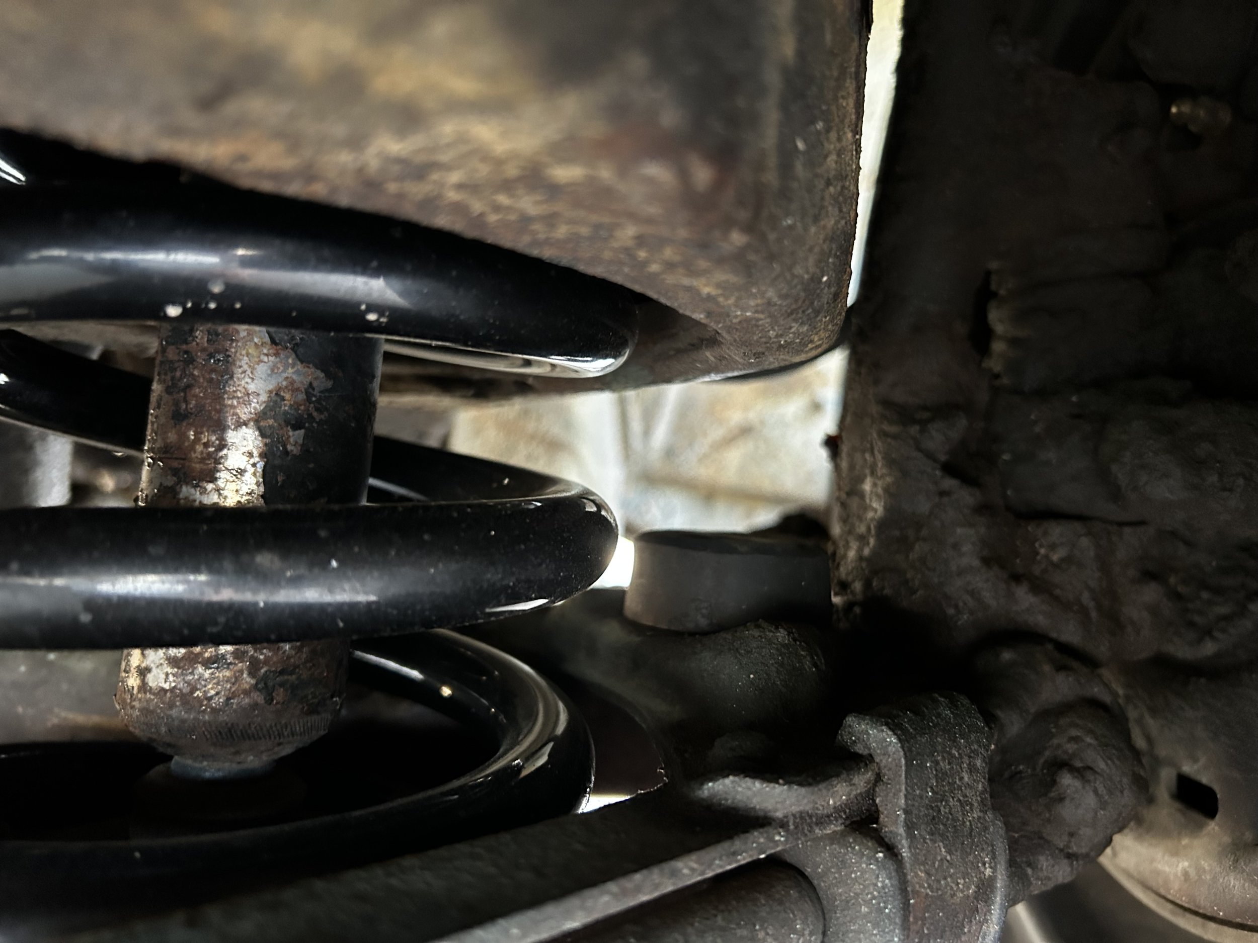

    Great input! That’s what I need to hear. I laid under the car last night to ***ess the whole deal some. What I saw was that after cutting the bump stops in half, I have about 1-1/2” travel before they hit. That seems fine since I don’t know that I have ever smacked them yet. And, I have a set of 1/2” thick spacers for the lower arms that I could throw in which from what I remember gets me about the extra inch I am looking for. That should leave me with an inch or so travel before hitting the bump stops which I could also swap for something even shorter. :D

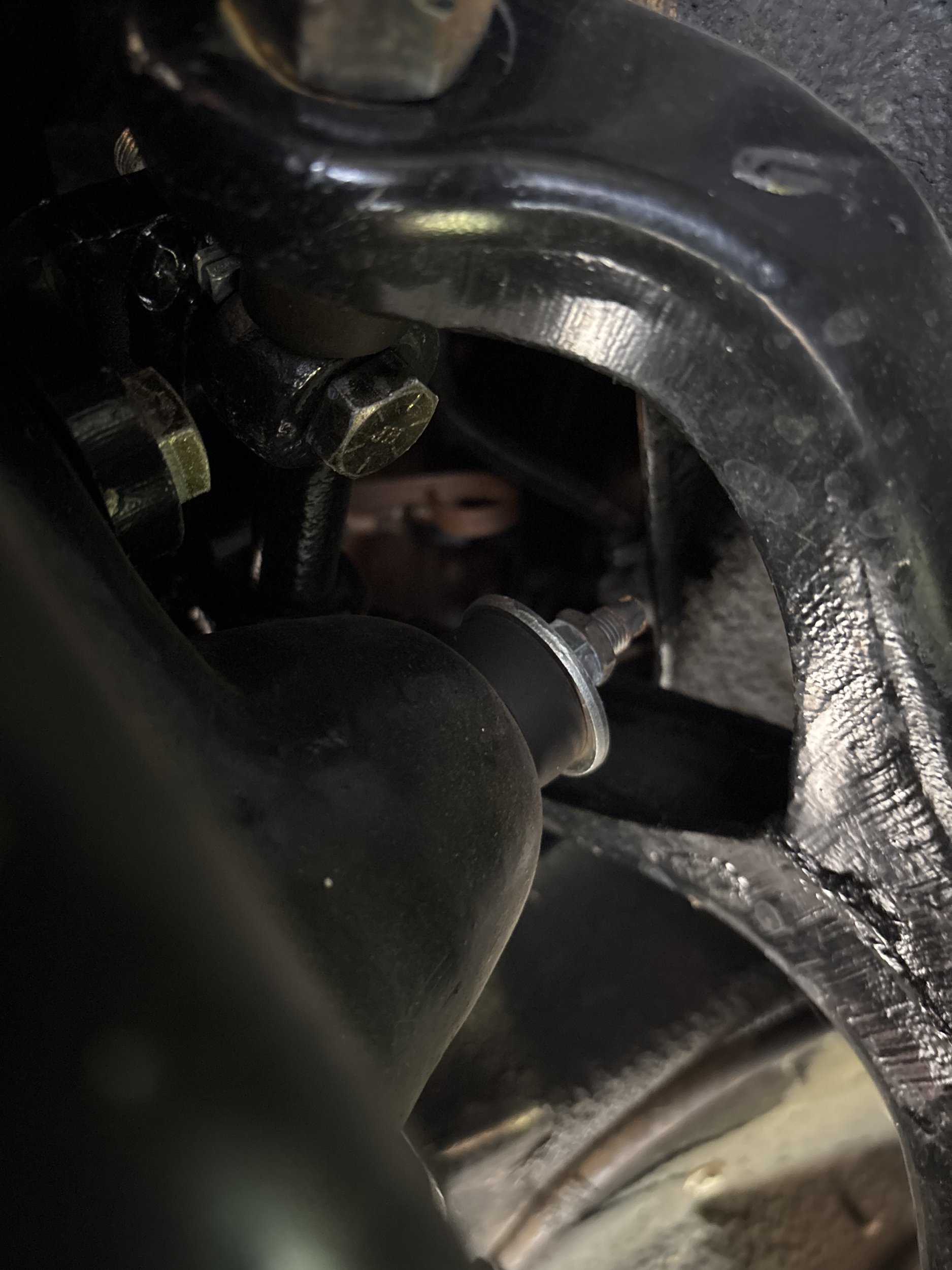

  29. lostn51
    Joined: Jan 24, 2008
    Posts: 3,353
    lostn51
    from Tennessee
    Okay I ran out to the carport and shot these pics. Now that I’m looking at it I might need to cut the bump stops down a little bit but I haven’t bottomed out yet. Then again I’m not playing Dukes of Hazzard so that might be the reason. If you look the spindle is nice and spaced out from the frame and has all the room to move without binding on anything.

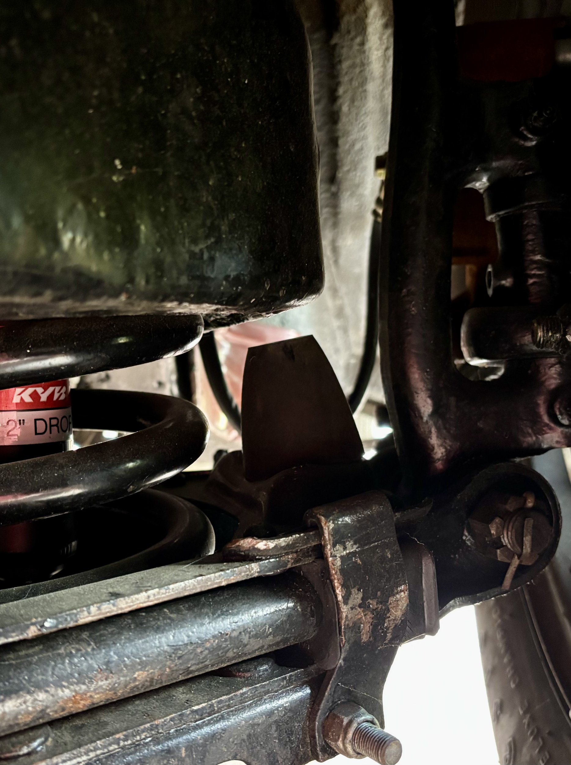

  30. lostn51
    Posts: 3,353
    lostn51
    from Tennessee
    Here is a better shot of the bump stop. I should note that I have the 1” swaybar under the car instead of the dinky factory one. IMG_3594.jpeg
