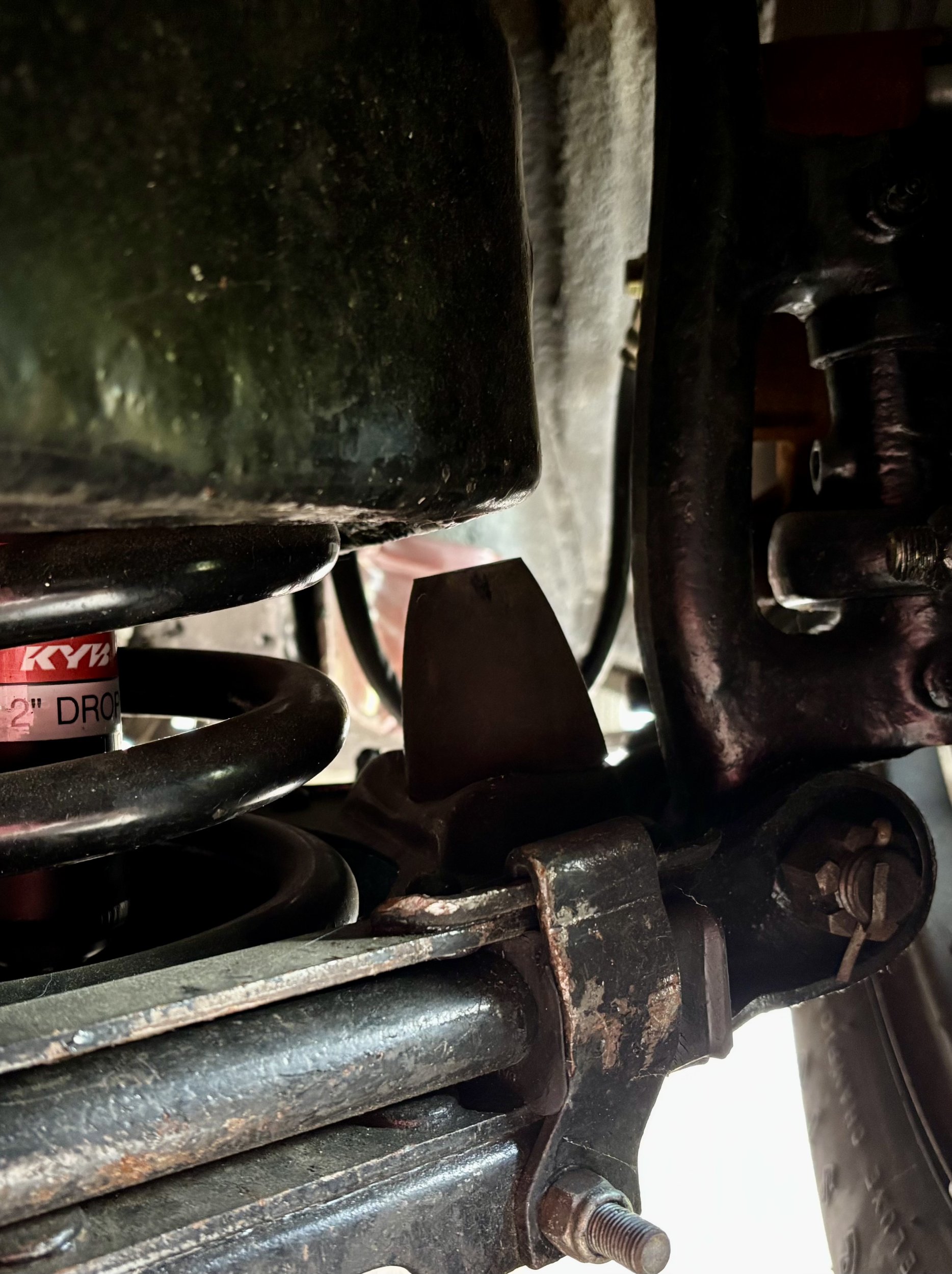

    I would bet that if you chalk the tops of those bump stops you will find that you are bouncing off of them more often than you think.

    Yup, that is why the tops of the bump stops are somewhat pointed. so they hit softly. If you do cut them down make sure you shape the top of it in a similar manner. If you leave the top flat it will hit them hard and cause a harsh ride

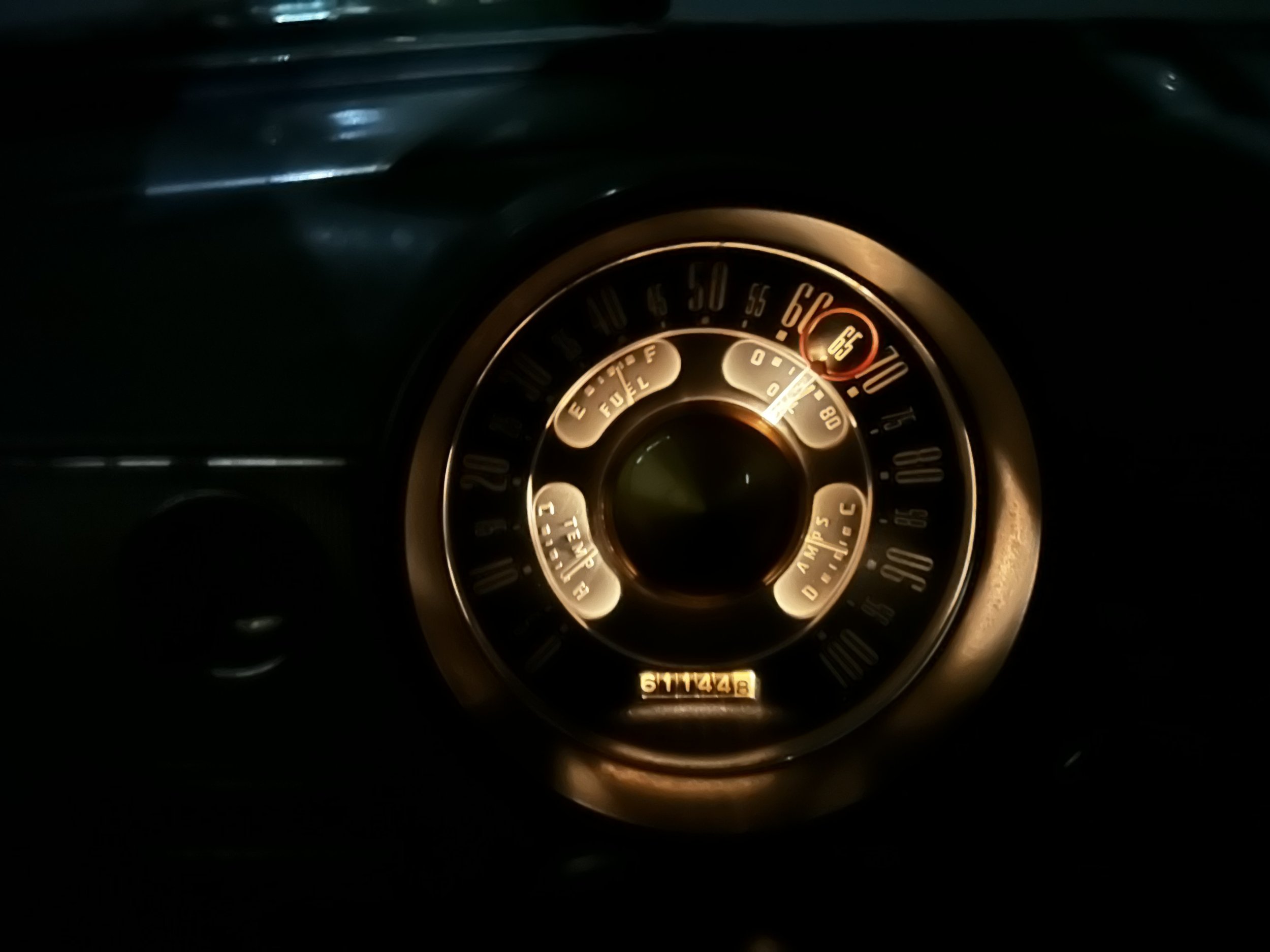

    man that gauge is cool! Mine were replaced when I got it, and I'm too lazy to swap um back, lol. But that thing looks awesome!

    I used short urethane bump stops on my '51.

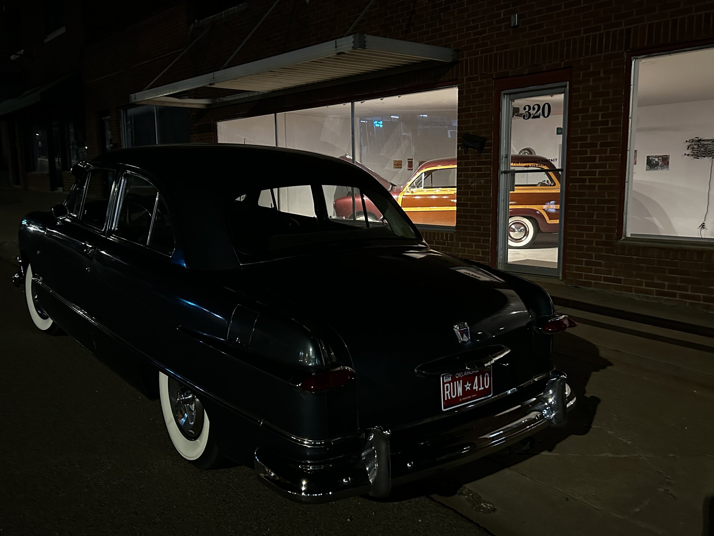

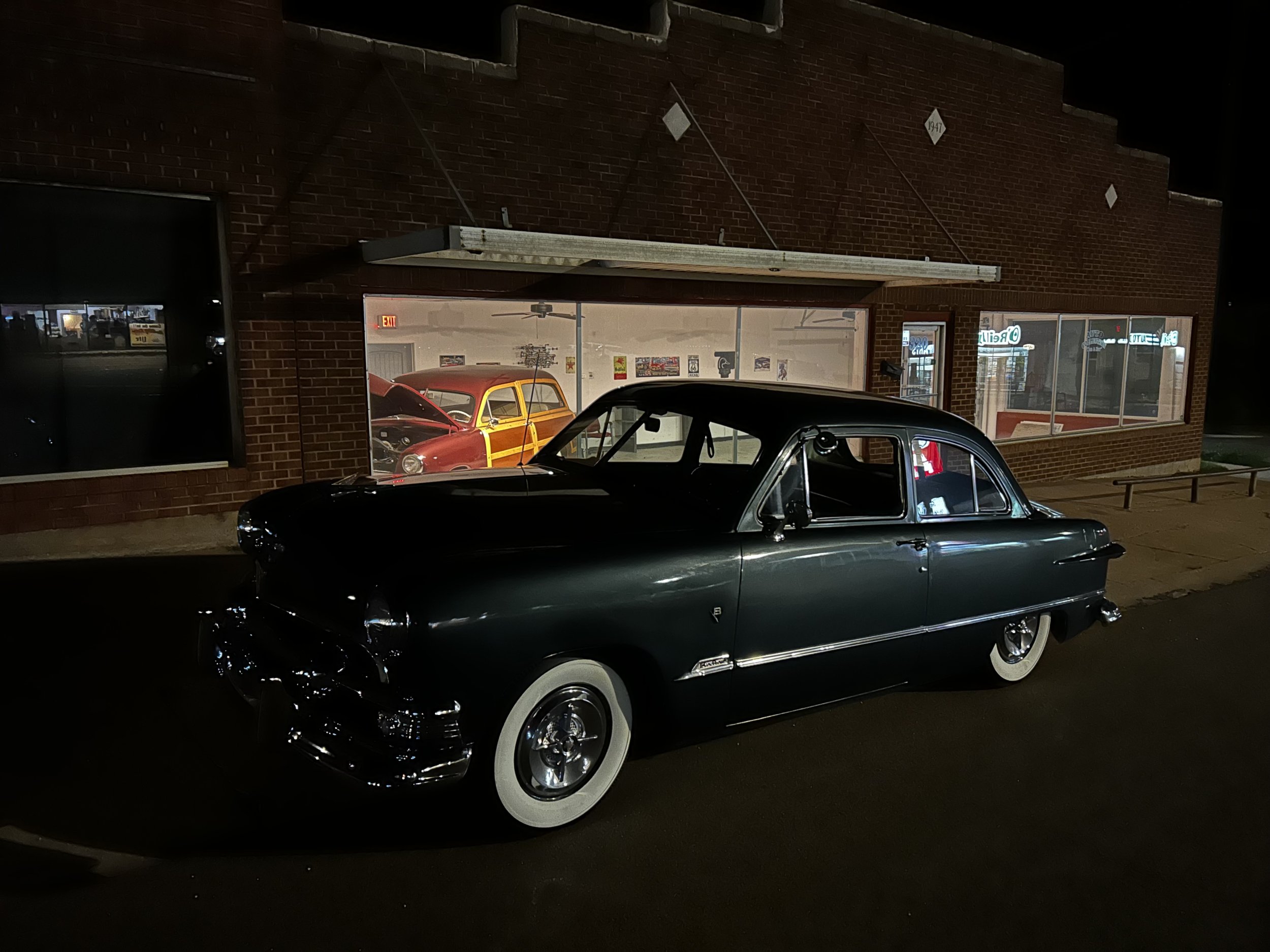

    Since I drive by this car pretty much every day in town, decided to stop and take some pics this evening when I realized it is somewhat the opposite of @lostn51 cars. :D
    One thing I never noticed until tonight is that as nice as this car is, someone cheaped out on the tires and put port-a-walls on it. o_O

    Sweet!!!! That is one nice looking woody and looks like you went back in time sitting in front of a dealership. Are you sure that you’re not living in a time warp or something because all the photos so far look like time stopped. Does 1.21 gigawatts mean anything to you???? :p

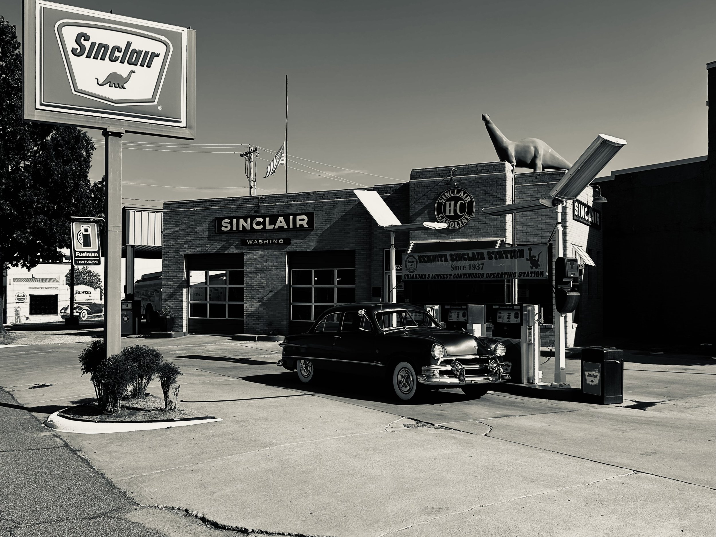

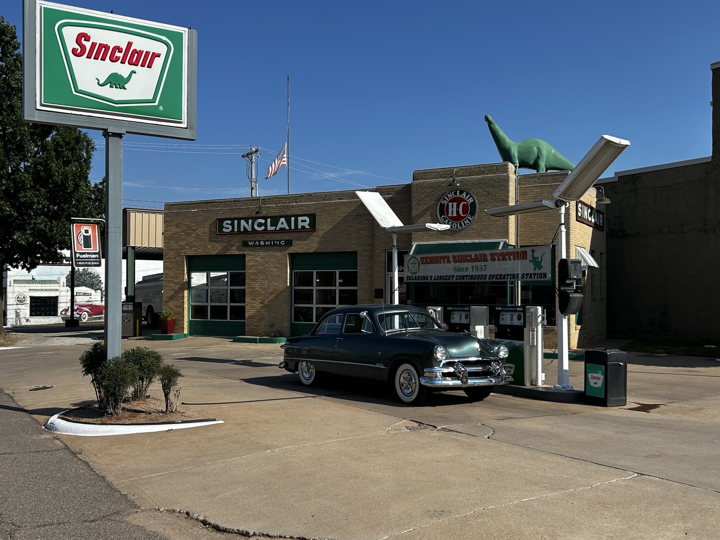

    For @lostn51 to keep him guessing what year I am living in. :p

    cool, I have never seen the Sinclair dinosaur on the roof of the building before. Around here they were filled with concrete to make them so heavy that people wouldn’t steal them

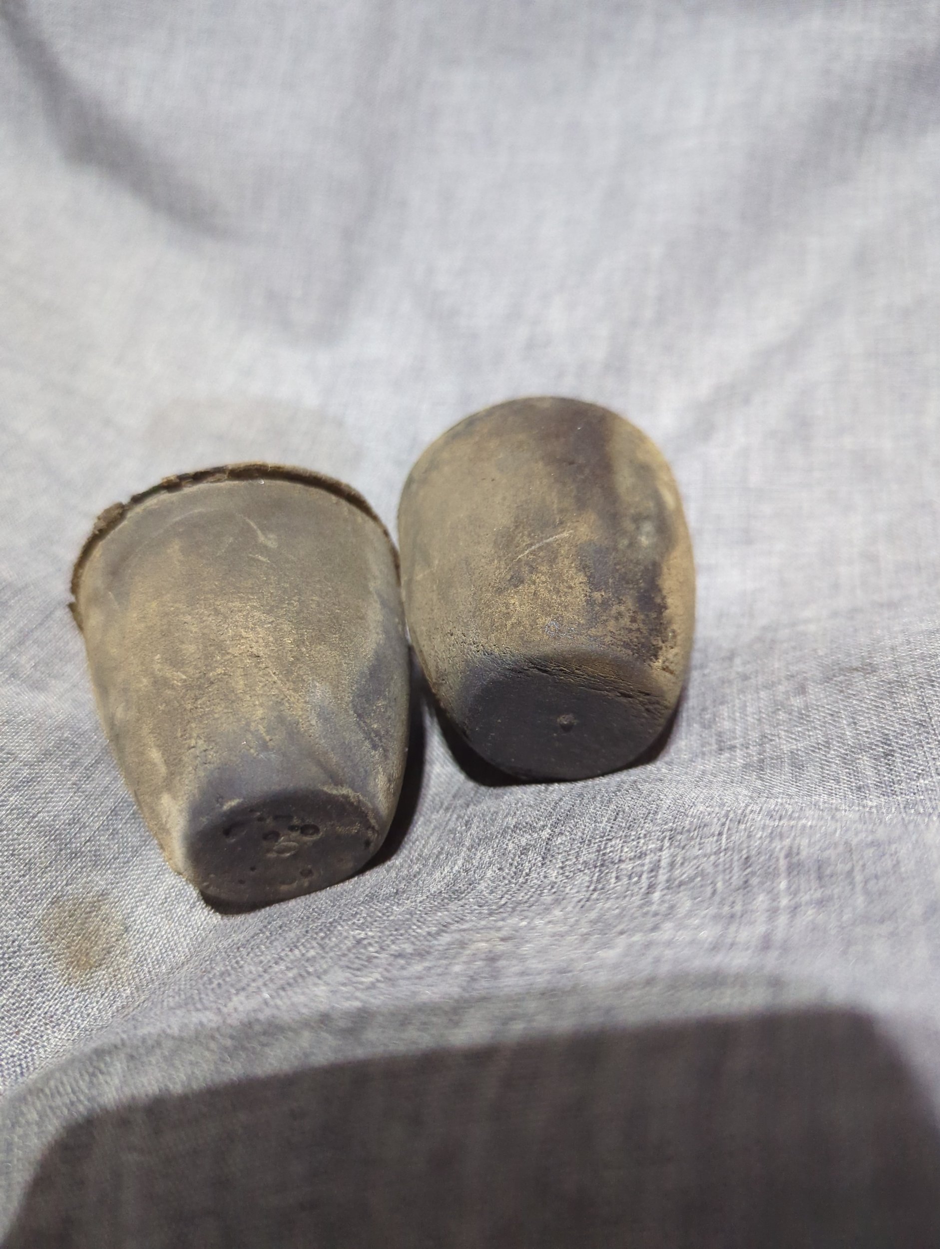

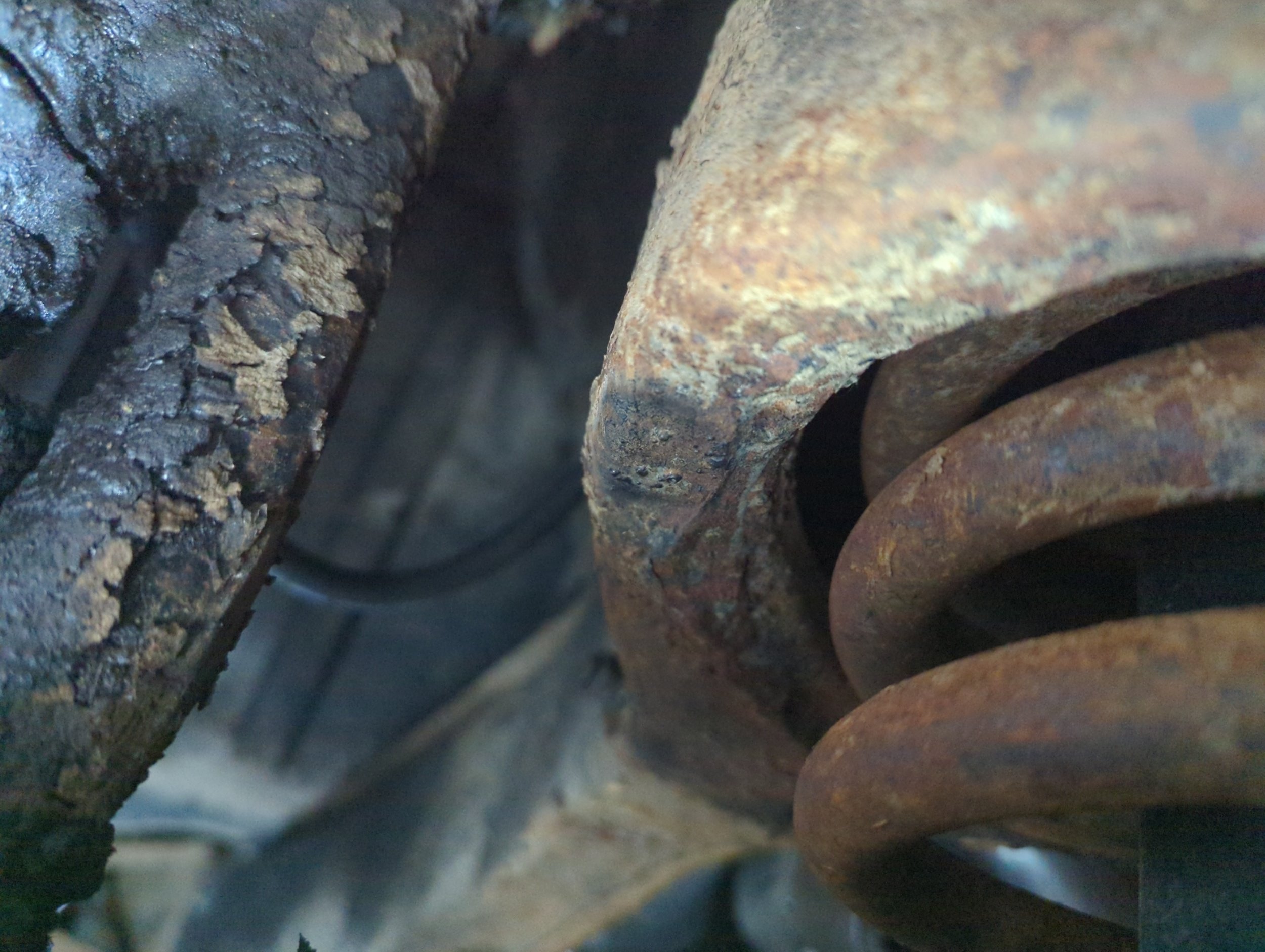

    File this under "HAMBrs helping HAMBrs" - On big dips and ****py highways (like nj on my last long trip) the car seemed to really take the hits hard - two people and a bunch of stuff made it even worse...my car has stock springs and uprights, with 1" blocks between the spring seats and lower control arms (giving me 2 inches of drop) I never even considered the bump stops. When I got home from the trip, I wanted to rip out the whole front suspension - instead I just ripped out these
    Notice how clean they are on top compared to the rest. Can see the witness marks on the frame too.
    It's now back to taking the hits like a "normal" old car - thanks for the thoughts and conversation on this thread! After returning from that trip, I actually got a quote from POL on the old jamco ball joint front suspension system they sell....by the time I added a master, sway bars and shipping it was going to be $2,700! Just gonna keep my old car "old" instead.

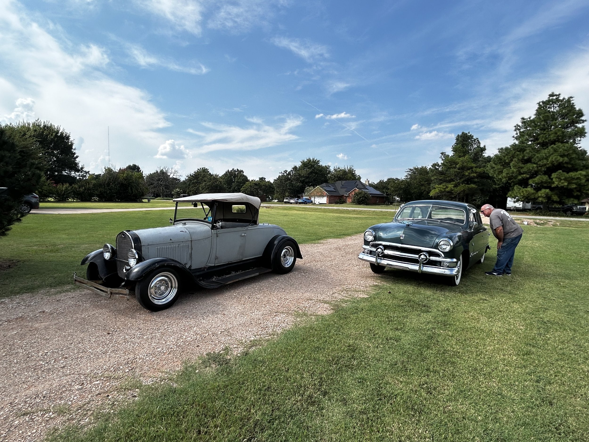

    Good deal! The only reason I thought of them was my 56 rode similar to what you are describing before I pulled them and made them shorter.
    Oh, and after another 100 or so miles on the car today, I am just under 600 miles total in the last couple weeks. Seems reliable to me. :D I still want to swap all the hoses and that u-joint before the Hot Rod Hundred though.
    I did get to watch it go down the road since a buddy asked me to drive his Model A roadster to his house after our local show. So, I let my son drive the shoebox. Trying to get him back interested in an old car. He hasn’t had one since he sold the Edsel.

    @ididntdoit1960 , Don't take this the wrong way, but that frame looks pretty rusty. If you don't already know about it, shoebox Fords have a tendency to have the steering box mounting bolts rust out, allowing the steering box to fall free, leading to disastrous consequences. From the overall looks of the bottom of your car, I'd take a good close looks at them and the overall condition of the frame and frront suspension as well.

    Thanks for your concern and **** shaming me on someone else's thread that I posted on to thank them...car spent the first 55 years of its life in West Texas and the last 19 in a warehouse in the northeast - every bit of sheet metal on the car is original and not rotted, same with the frame - ya, it's ugly - sure, I'll likely get around to cleaning it up at some point....do me a favor and put me on your ignore list

    I'm sorry you took it the wrong way. Not many people know about the shoebox steering box bolt problems, so I thought I'd make you aware of it. As they say, "A word to the wise....".

    I’ve had the bolts snap while driving around in one of my ‘51’s before…..not pretty. I was turning into my apartment complex that sat on a very busy street and while I was trying to turn into the place is when I heard the POP and it stopped steering mid turn. The only bolt holding the steering box on was the one on top that was attached to the tab. It took a while but we managed to get it to my apartment without tearing up too much and fixed it while taking up a few spaces that were ***igned for someone else. Water gets into the frame and rust those bolts and if you run radial tires like I was it puts one hell of a strain on them and SNAP! After that happened I always replace those bolts with grade 10 as soon as I buy one just because
