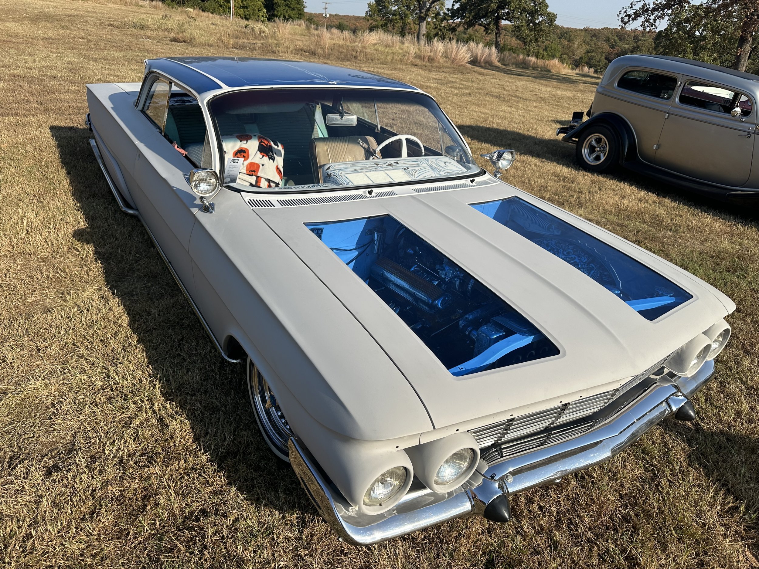

    For reference, this is Alan’s chopped 61 that he has been messing with for a while in his spare time when they aren’t building some Slonaker winner or something. The level of detail on this car is amazing. Hard to see, but there is tons of engraving on pretty much all the aluminum parts on the engine including those vette valve covers you can see through the panels. Also, check out the crazy lake pipes and skirts he built.

  2. That hood and those lake pipes are awesome.

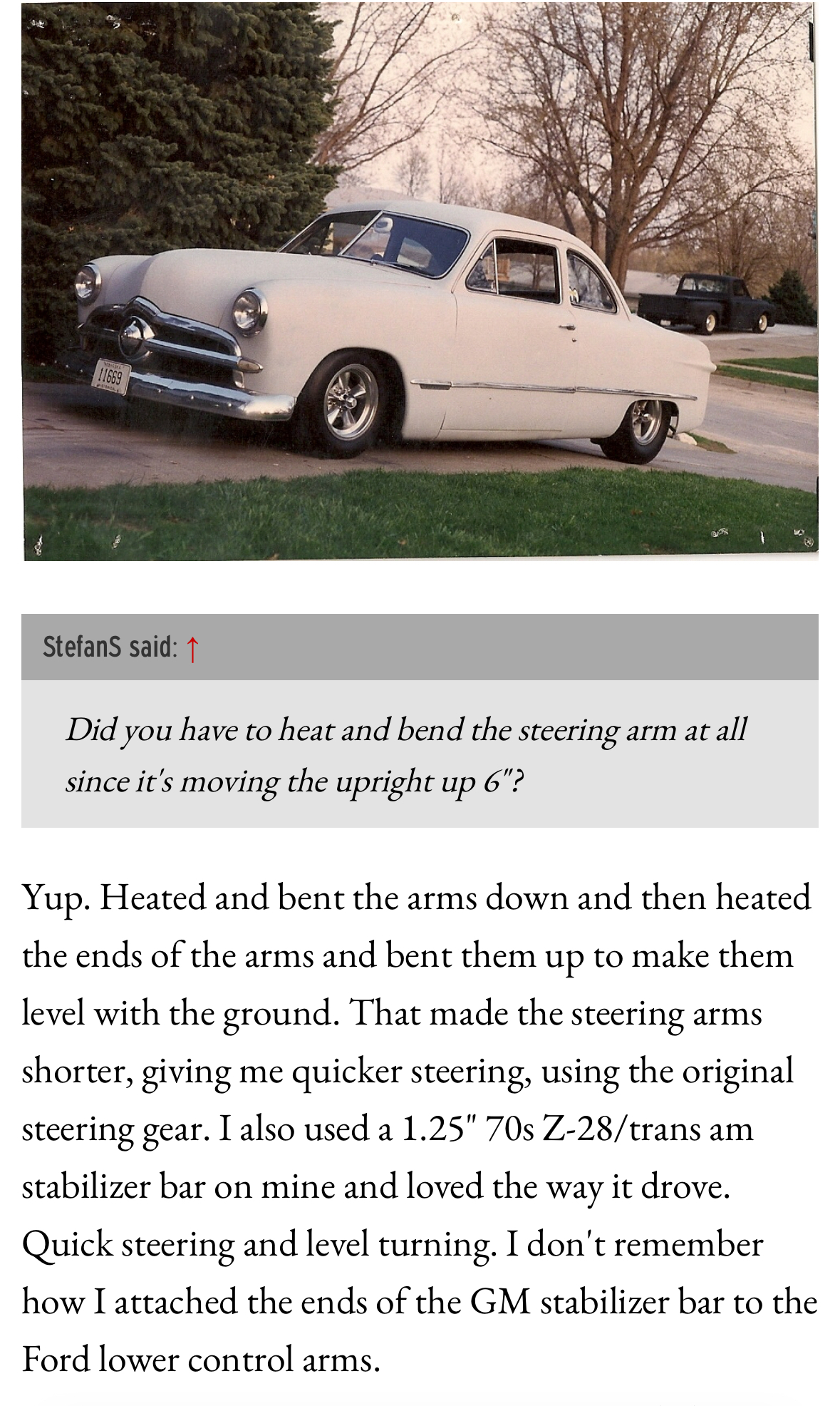

    Lost track of who said what when talking about sway bars but if you dig around the way back machine for Rocky’s thread about flipping his uprights he talks about making a junkyard swap bar work. I want to say it was a trans am? Could be wrong it’s been a couple decades

    If you skip breakfast you don’t have to remember and will have more memory left for important things like sway bar swaps lol IMG_1726.jpeg there ya go

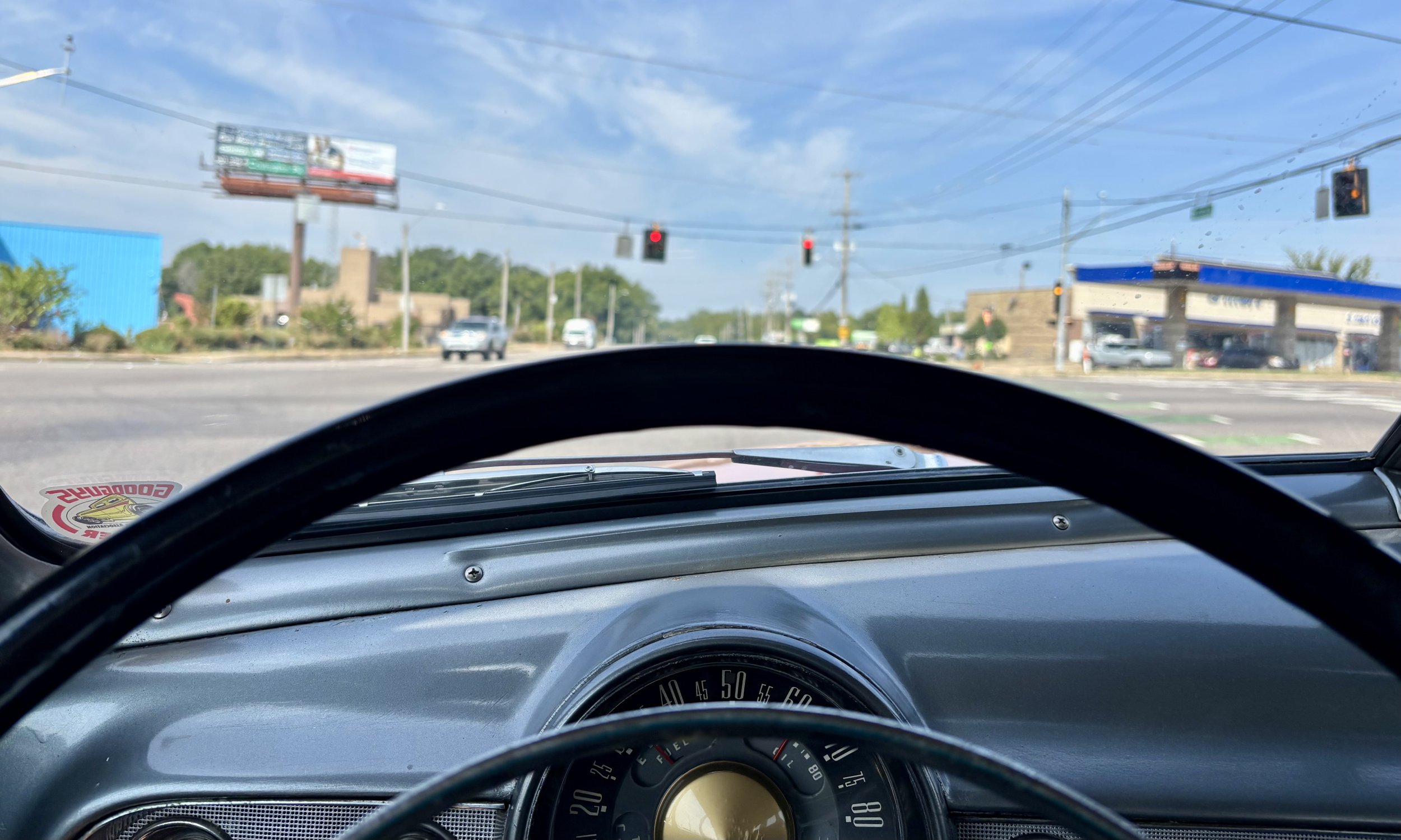

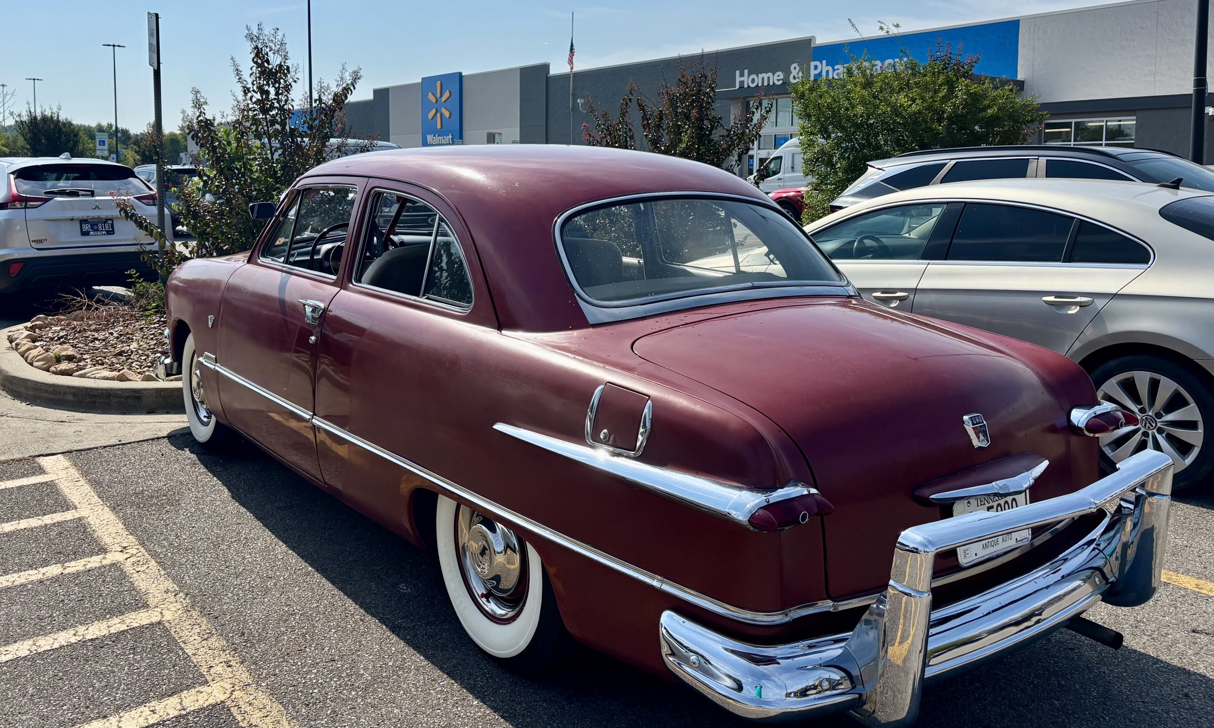

    Okay Jeff I drove my car around the other day and everywhere I went and everytime I took a picture it was 2025 all day long. :oops: IMG_3606.jpeg IMG_3608.jpeg

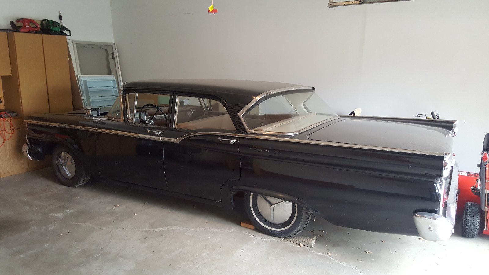

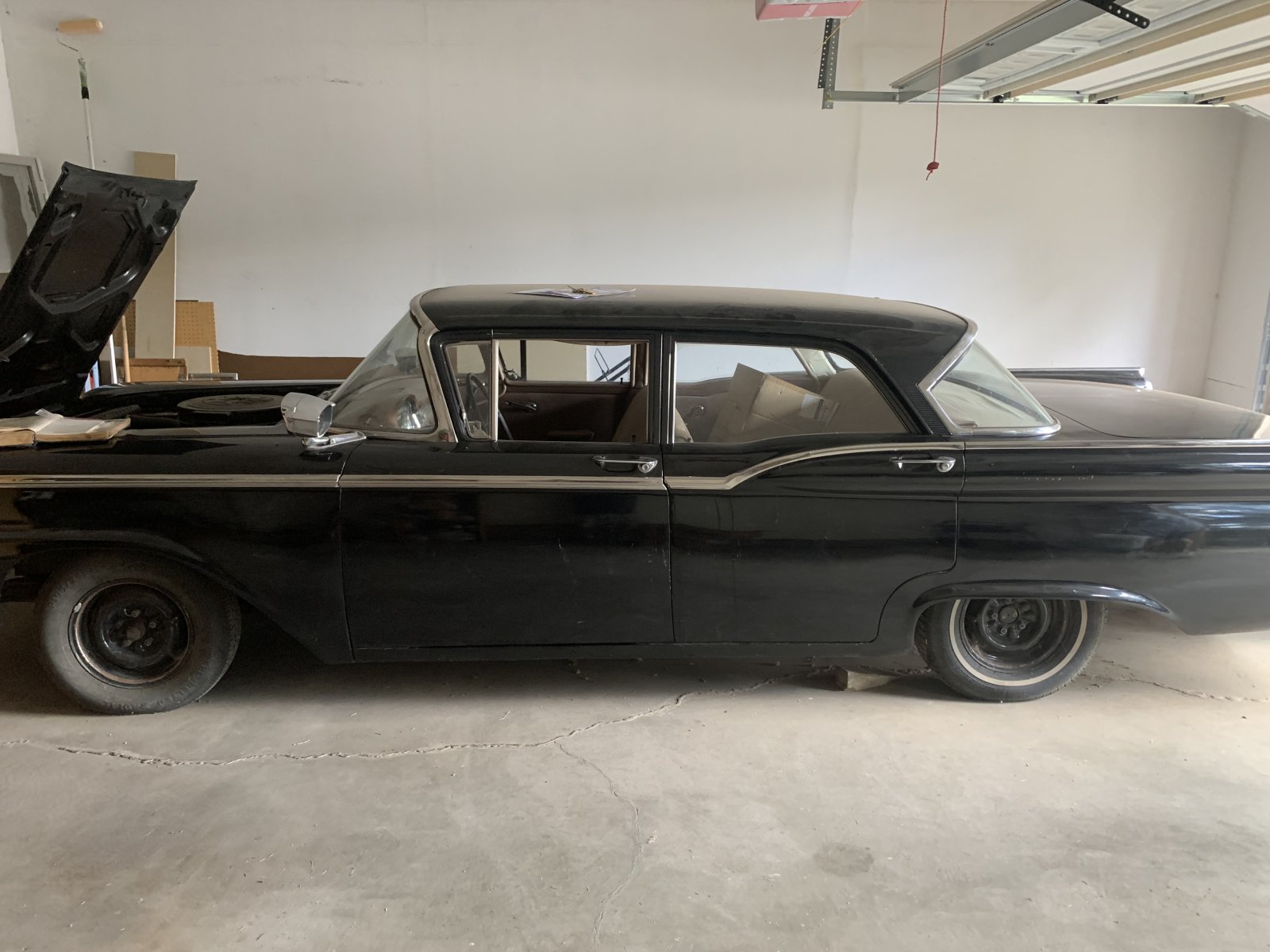

    Let your son know the 59 Oklahoma cop car is still in my buddies moms garage ;) IMG_3250.jpeg IMG_3248.jpeg

    He contacts me every once in a while, and asks me if I sold it for him yet. He is not really setting the world on fire trying to sell it himself.
