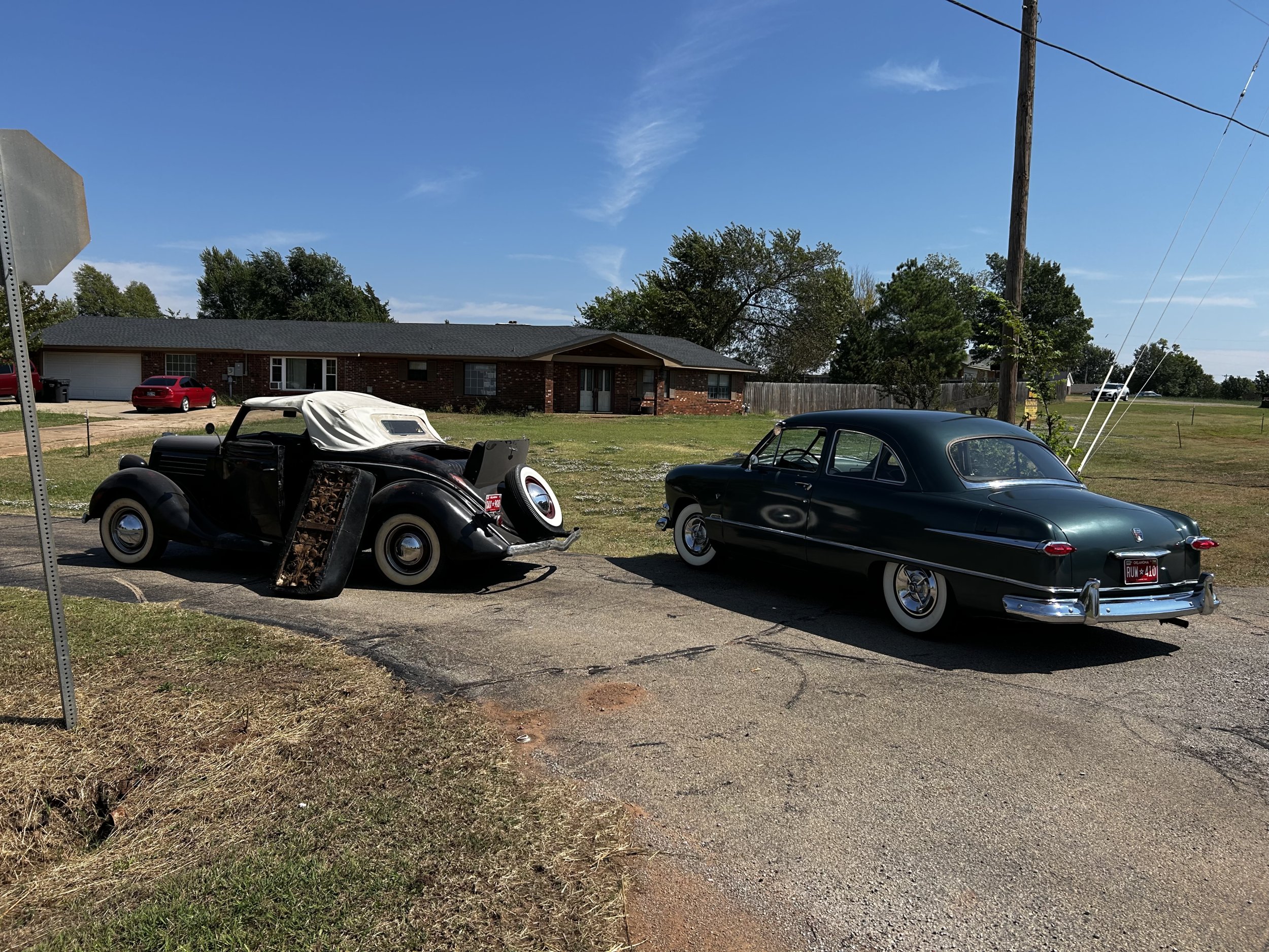

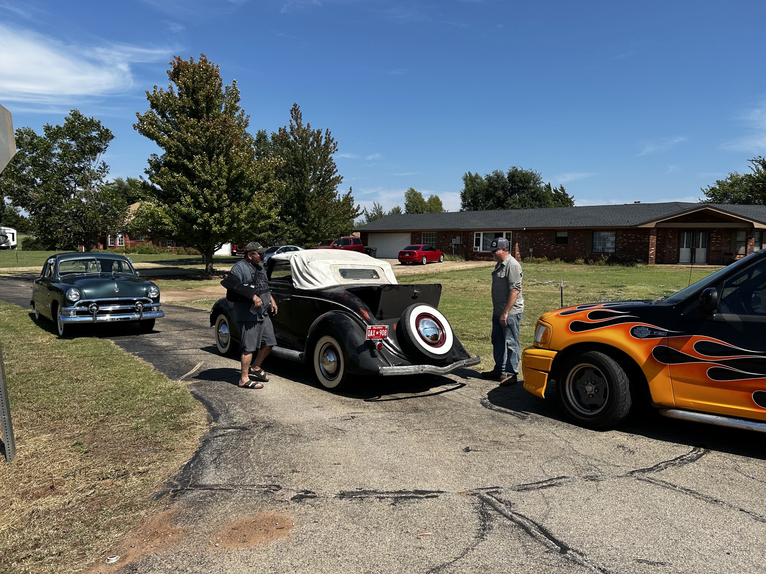

    Found an old car broke down on the road…lol. Fuel pump went out on Sid’s Cabriolet. Oh, and hiding on the edge of the pic is some flames I shot back in 2002 or so…

    Is that yellow one the one you bought at the Duncan swap meet this year? Great looking cars!
