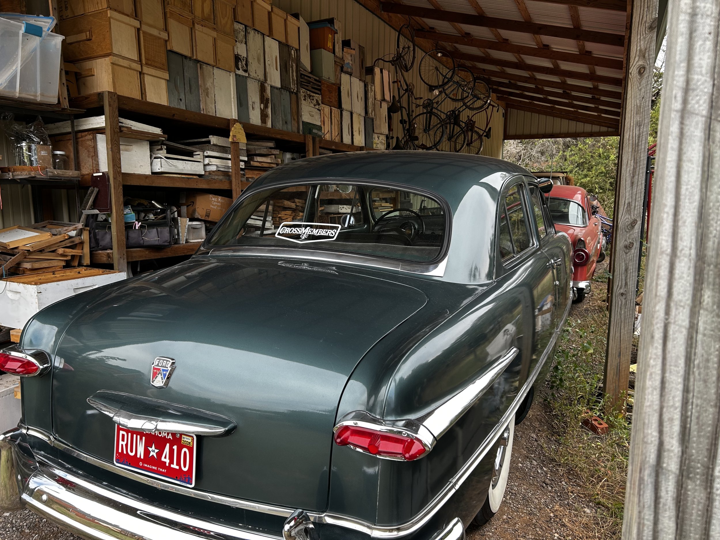

    I’ll be glad to get some late models fixed so I can get back in the shop. My cars don’t like hanging out with all the beekeeping supplies.

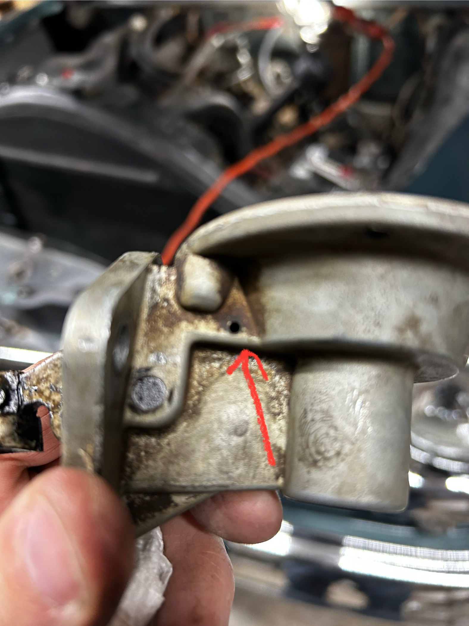

    Motivated by @lostn51 I drug my car up into the shop with the lawn mower so I can be closer to the tools and also work after dark better. :D What I found when I looked close is that gas is running out of the fuel pump on the lower half out of what I ***ume is just a vent hole?!?! The only way I see that fuel can get on that side of the pump is if it is leaking past the diaphragm…. And, that seems to be happening on three different diaphragms? Maybe I am missing something here? About ready to just block off the fuel pump hole and put the electric pump on as the only pump. o_O
    Just pulled the pump back off and apart to see what I am missing. It idled fine, but is definitely starving for fuel under any load.
  28. guthriesmith
    Joined: Aug 17, 2006
    Posts: 12,031
    guthriesmith
    Pours fuel out here where the arrow is pointing.
  29. lostn51
    Joined: Jan 24, 2008
    Posts: 3,414
    lostn51
    from Tennessee
    Yep it’s the diaphragm. Can you find a kit locally to rebuild the pump, if not I should have one here I can send you if you want.
