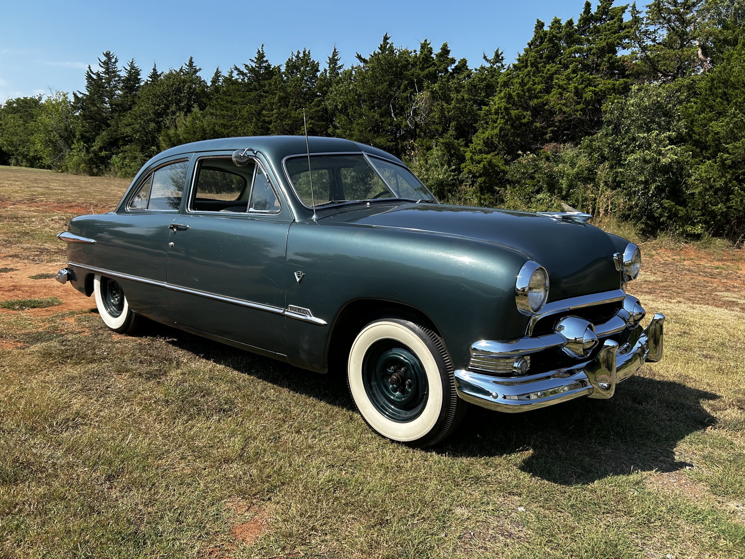

    Tried to go get the ***le swapped over and get a tag for this yesterday, but a power outage knocked out the system at the tag office. Also, didn't work on it last night since I went and picked up the next project from a friend and fellow HAMBer. I did have to move it out of the shop this morning to move the panhead in. Anyway, won’t talk about the next project here, but hope to get the front of the 51 lowered early next week. :D

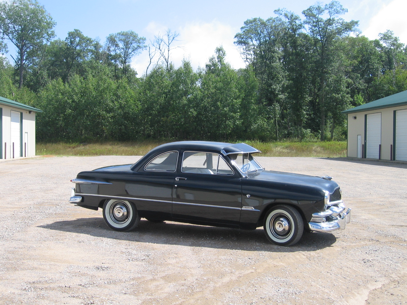

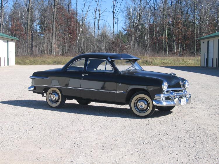

    Here's my '51 with stock springs :
    Here's my '51 with Moog Aerostar springs :
    Compare the "spear" on the front fender with the edge of the whitewall.
  3. guthriesmith
    Joined: Aug 17, 2006
    Posts: 11,941
    guthriesmith
    Looks like about 2” or so? Also looks like you flipped the shackles in the rear to change it as well?
  4. tubman
    Joined: May 16, 2007
    Posts: 8,231
    tubman
    Right.

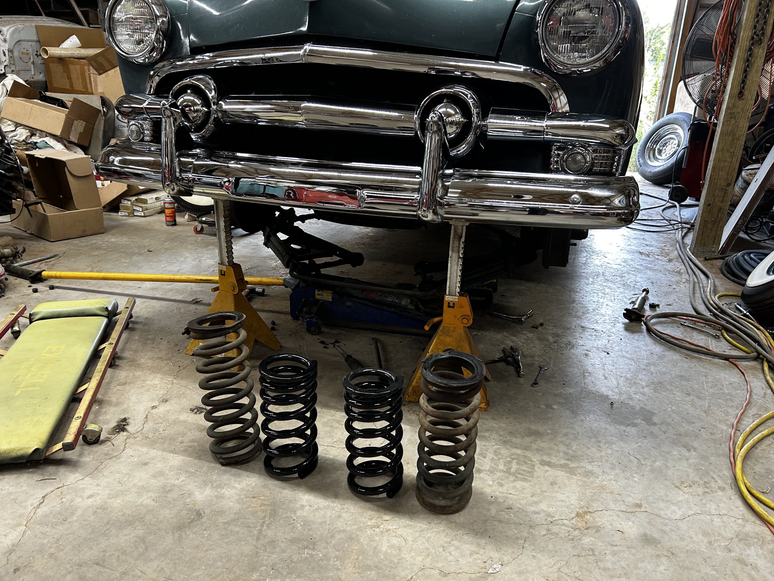

    If you swap out to the Aerostar springs you need this to be able to get the geometry back to where you need it. Also you’ll more than likely need to shim the A arms out so grab some of them. I think I needed an 1/8” to 3/16” to get mine right.

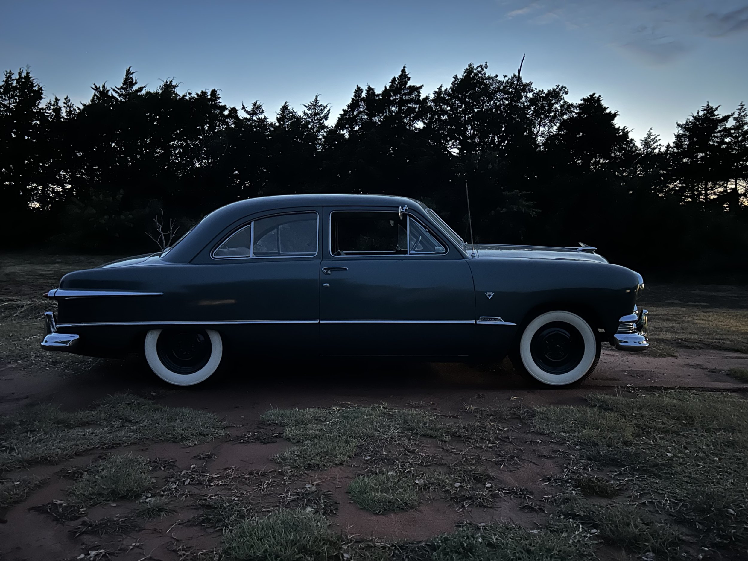

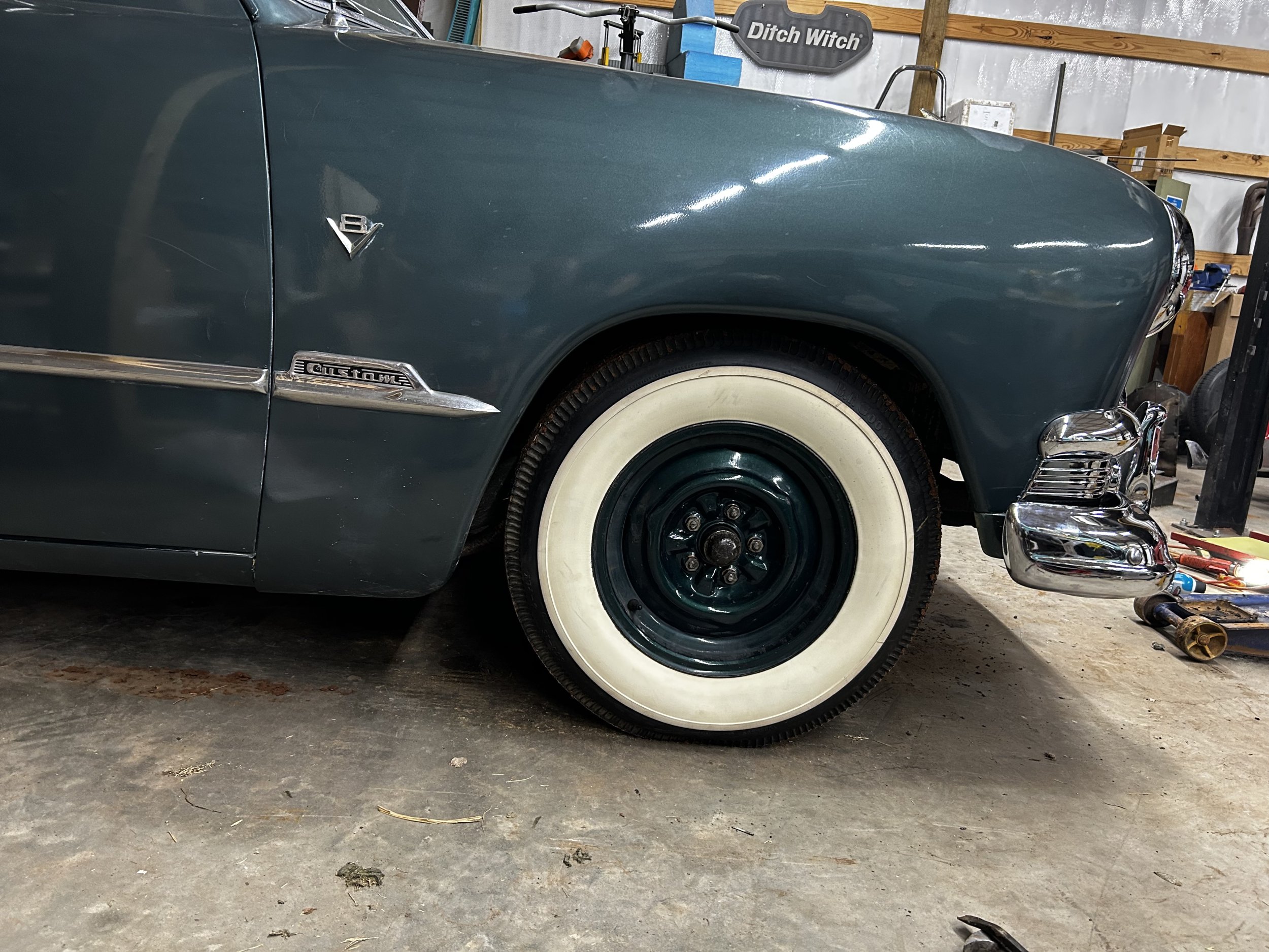

    Well, not sure it is low enough in the front yet. But, if it’s anything like my 56, it will likely still sink an inch or so over time too. About too dark to get a good pic outside. Pretty sure it came down right at 2” in the front and 3” in the rear. May be good enough for a while. I’ll see. I do need to cut the bump stops or remove them. I can bounce it off them now. I also need to put the shocks back on or see if I need shorter ones.
  13. guthriesmith
    Posts: 11,941
    guthriesmith
    Tire is not quite flush with the wheel well. Hmm…
    Also, specs on the Monroe 5821 show the collapsed length to be only 1/2” shorter than the ones that were on this car. Guessing I can get away with these same shocks at least for now. Might as well use what I have if I can. They appear fairly new.

    Also, just using a level, camber is real close on the p***enger side, but it’s in at the top on the drivers side. I think I’ll probably leave it like this for a while. I need to pull a clutch on my youngest son’s car. So, this may be on the back burner a few days now until I can get that done.

    Can you space the spring pocket part of the control arm down to lower it more???
  18. guthriesmith
    Posts: 11,941
    guthriesmith
    Yes, and I have some spacers already that I made for the 56. I’ll see after I put a few miles on it.

    I used Aerostar springs in my '51 coupe to replace cut stockers. Installed new short bumpstops and used stock shocks no problem. Lowered a touch from the cut stockers and really firmed up the cornering! Big improvment. It had 3" blocks in the rear and I'm not a big tail dragger fan so I cut them to 1.5" as the rear springs a a little flat (sag). Like it much better as with 3" the driveshaft rubbed.

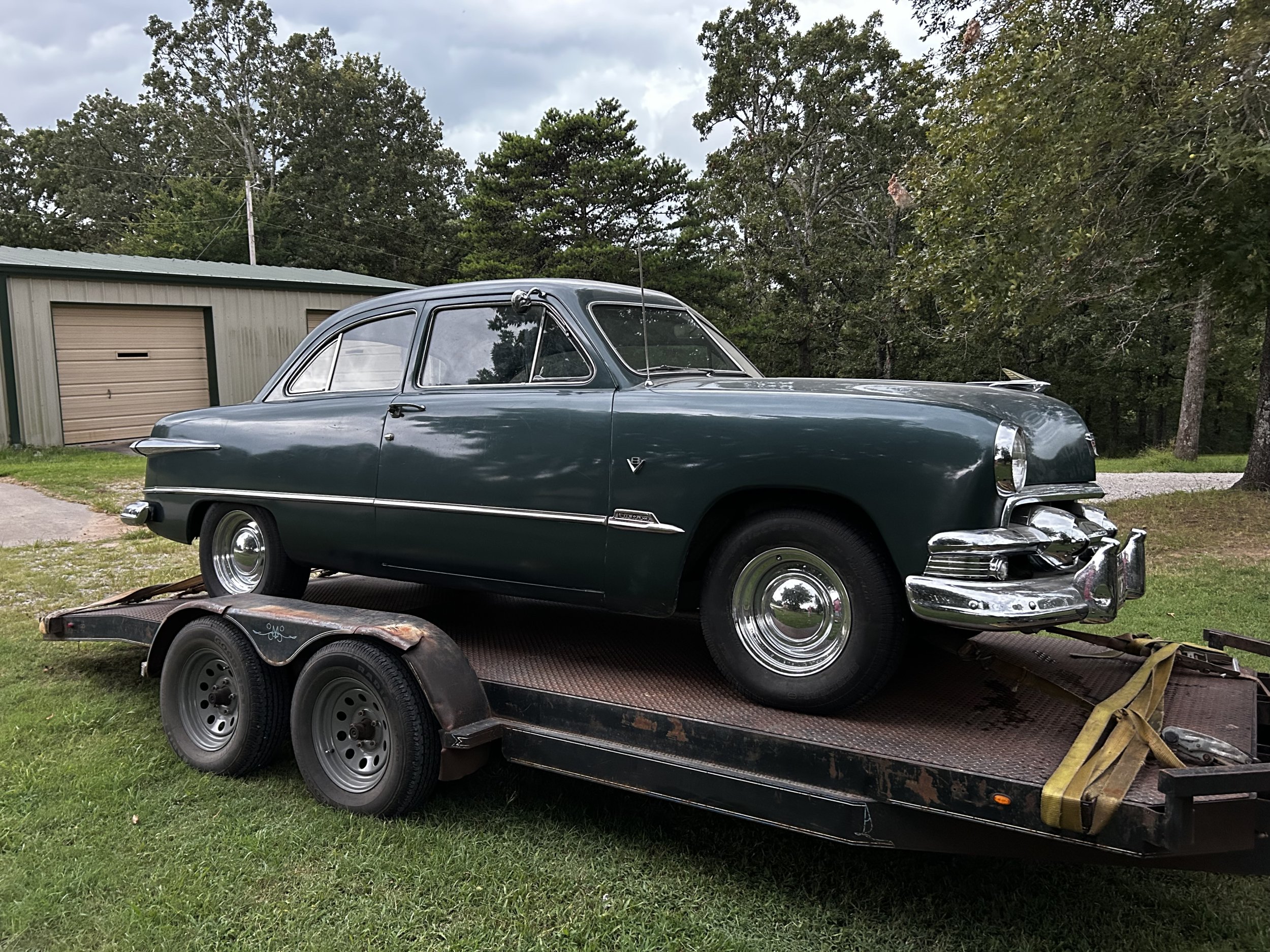

    I had to go back and do a comparison of where I started and where I am now. When I consider I have now owned it for exactly 16 days, I guess I have done ok. Not much work involved, but had to get it stopping and lowered. Bonus that I tripped across a set of wheels and tires to get the look I was going for in the last two weeks. I may try to go see what wheel covers the guy in the town where I work has today.

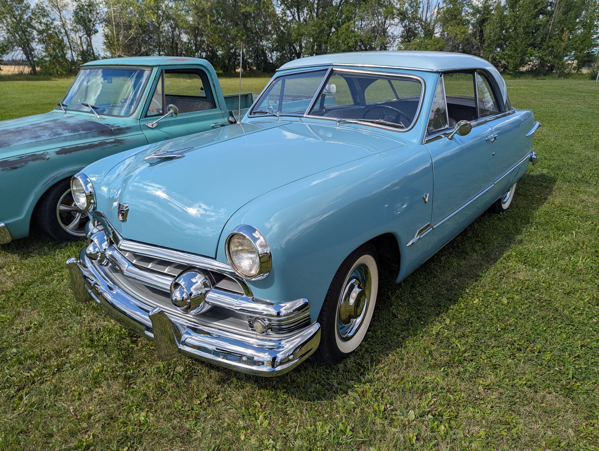

    Saw this at a little show on Saturday, reminded me of yours so I thought I'd share.
  26. tubman
    Posts: 8,231
    tubman
    The best looking of all the shoebox Fords. Out of an act of necessity.
  27. alanp561
    Joined: Oct 1, 2017
    Posts: 5,575
    alanp561
    '58 Pan?
    chryslerfan55 and porkshop like this.
  28. guthriesmith
    Posts: 11,941
    guthriesmith
    It’s actually a 54 but in a 58 or 59 frame.
