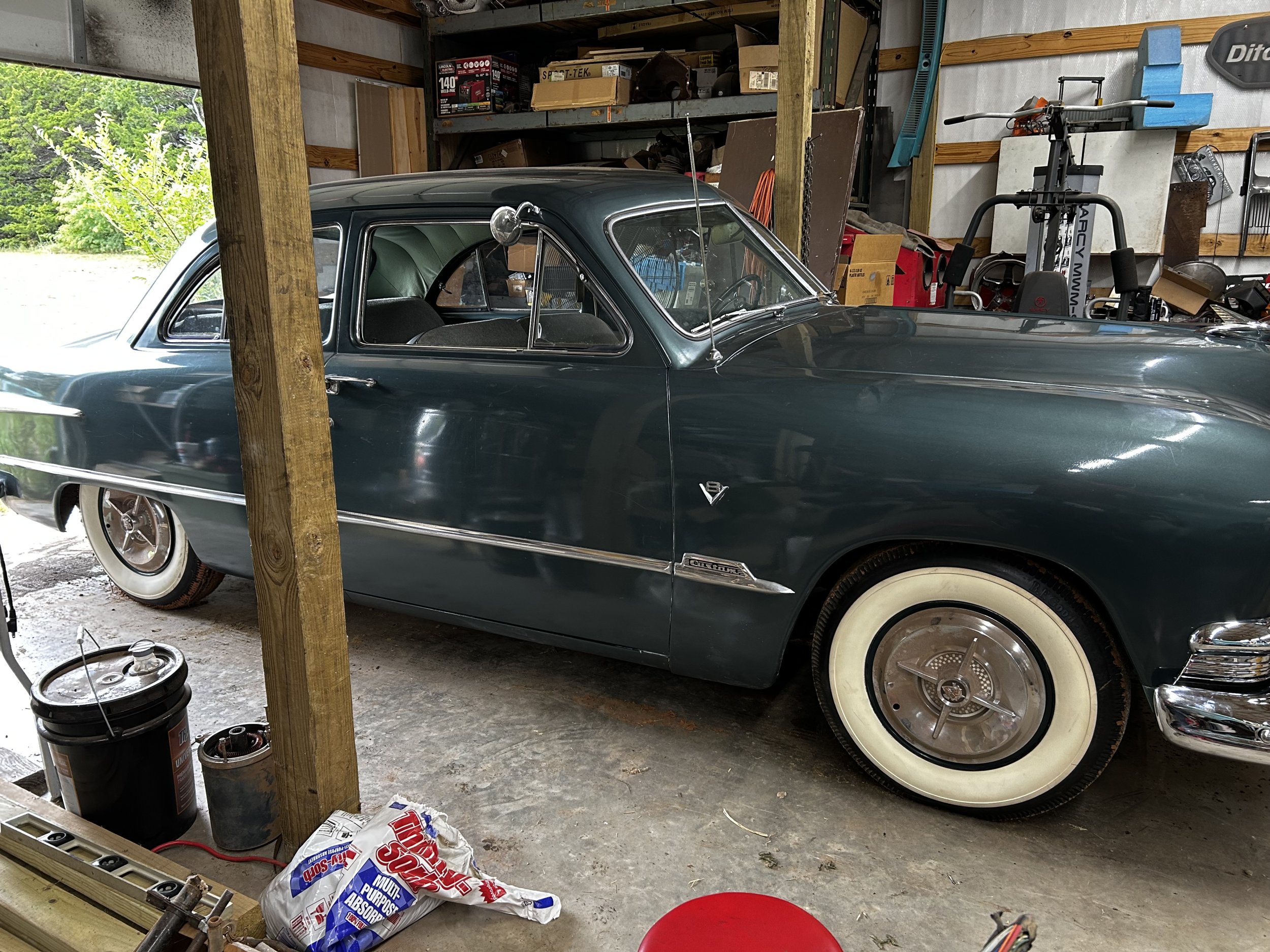

  3. lostn51
    Joined: Jan 24, 2008
    Posts: 3,351
    lostn51
    from Tennessee
    Driving definitely helps them to settle which you probably already know from your ‘56. I had mine out today running around doing errands and parked it at Lowe’s next to a newer Camaro and a Nissan maxima. Look how much lower my car sits compared to the newer factory rides…..:cool: IMG_3564.jpeg

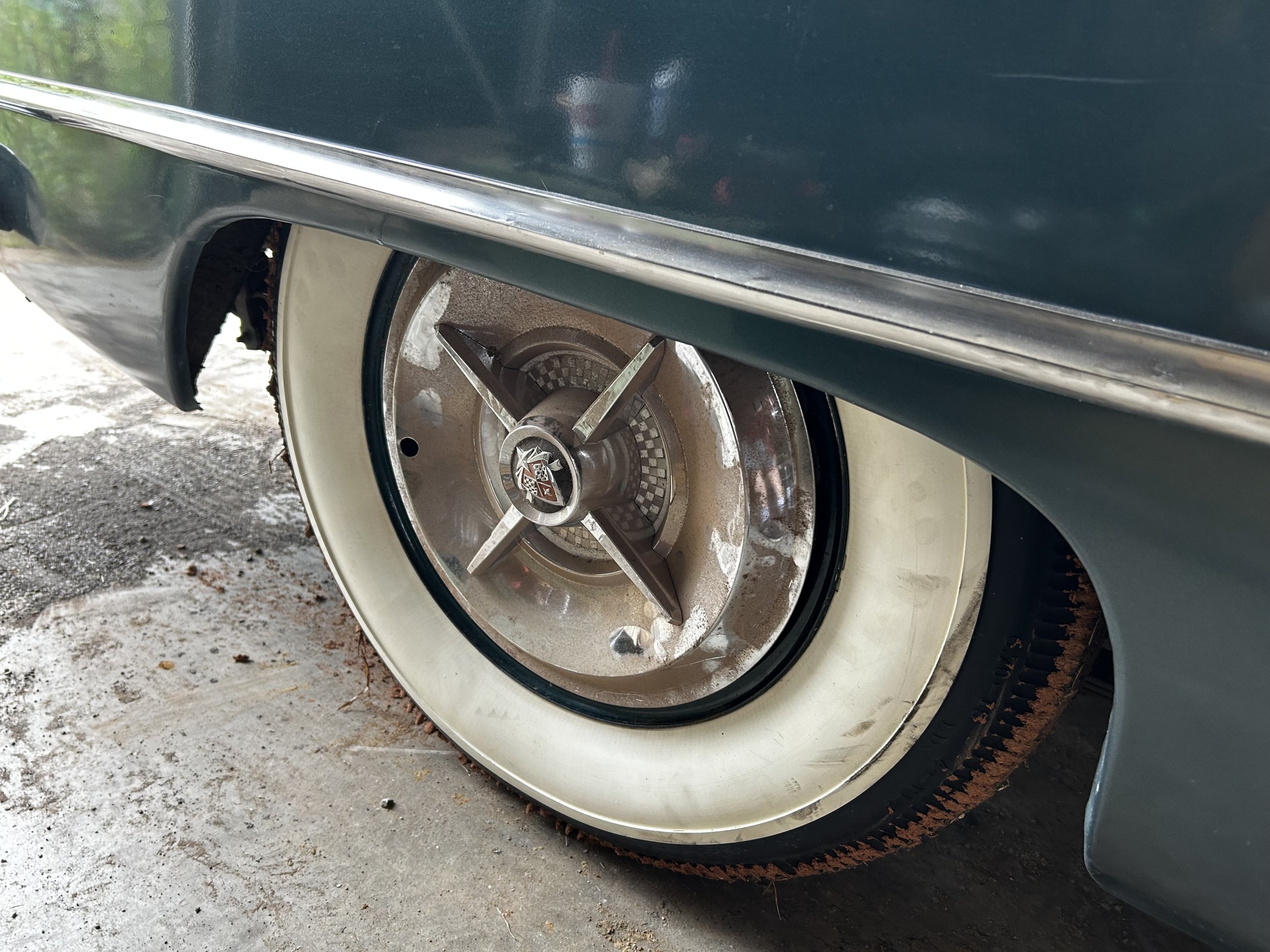

    Well, not sure I love these, but may see if they grow on me. I’ll polish up a set of four. I am sort of leaning toward some chrome lugnuts and running it nuts out. But, if I do that, I will need to paint the wheels since they are sort of rough. Or, I may break down and buy some decent Olds caps like the ones I have that are beat up.

  8. guthriesmith
    Joined: Aug 17, 2006
    Posts: 11,941
    guthriesmith
    Well, I considered running Olds covers on one side and Lancers on the other to see what I like better and may still do that. But, I just put all four Lancers on for now. There are actually two different styles if you look close. But, can’t see both sides at the same time right? I have two original Lancer spinners, but they don’t fit these aftermarket covers too well…

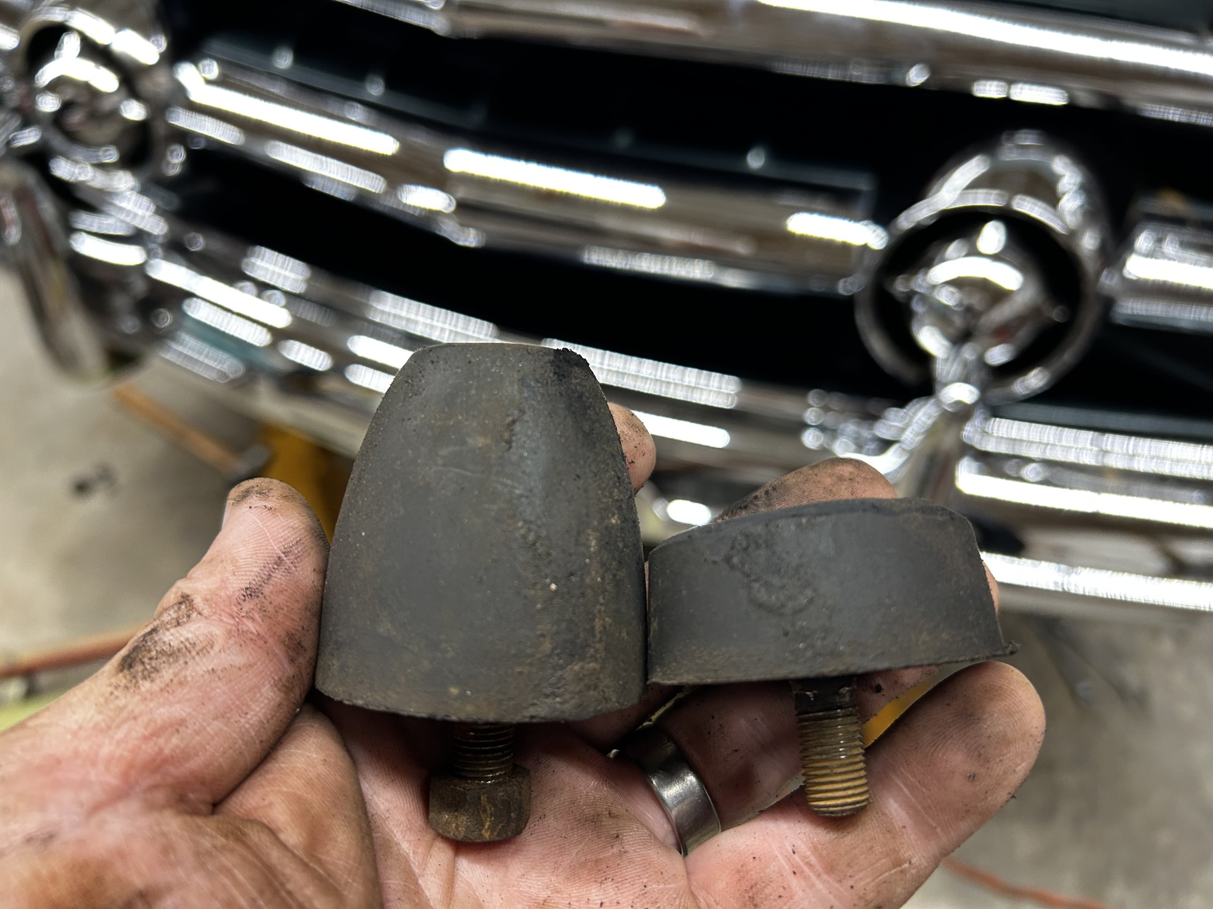

    guthriesmith
    Not sure why they make these bump stops so thick… :rolleyes:

    I had my front end aligned after I installed the Aerostar springs and they got it to factory specs with no "magic parts". Actually, the installation went as smooth as can be expected. I think if you went anymore (cut a coil or two), you would probably need the camber plates and different shocks. That's why I left mine as is. I think mine looks OK because the rear is at stock height and it has a little "rubber rake". I did replace the bump stops with shorter ones I think I got at Amazon.

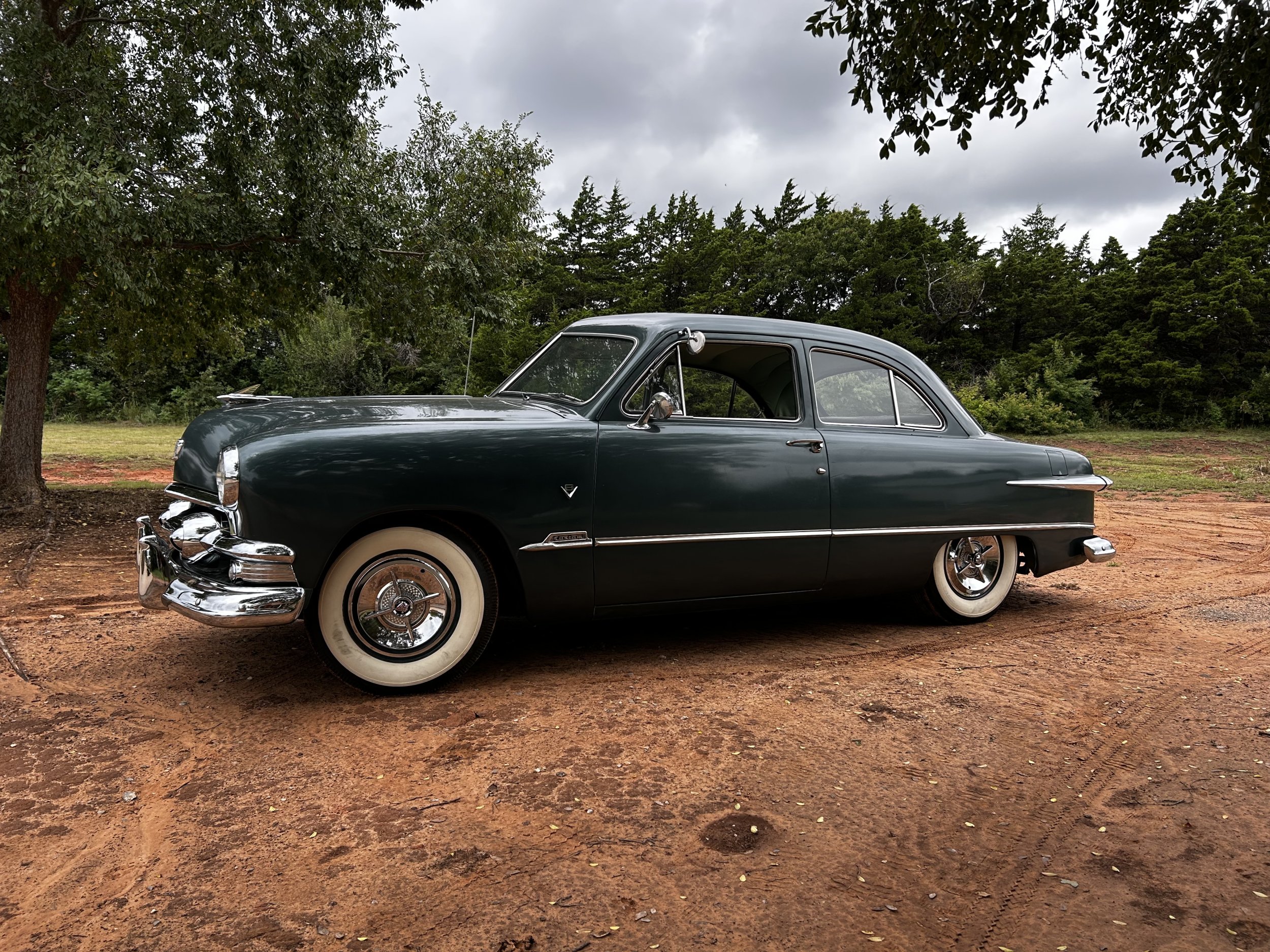

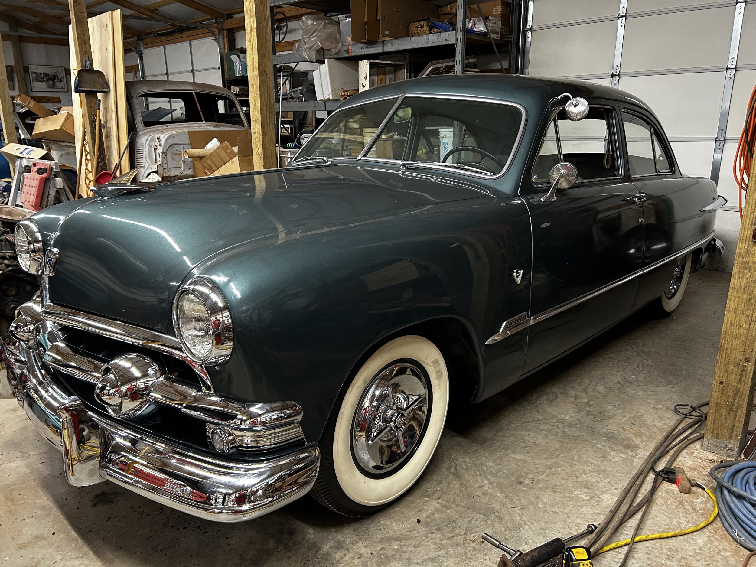

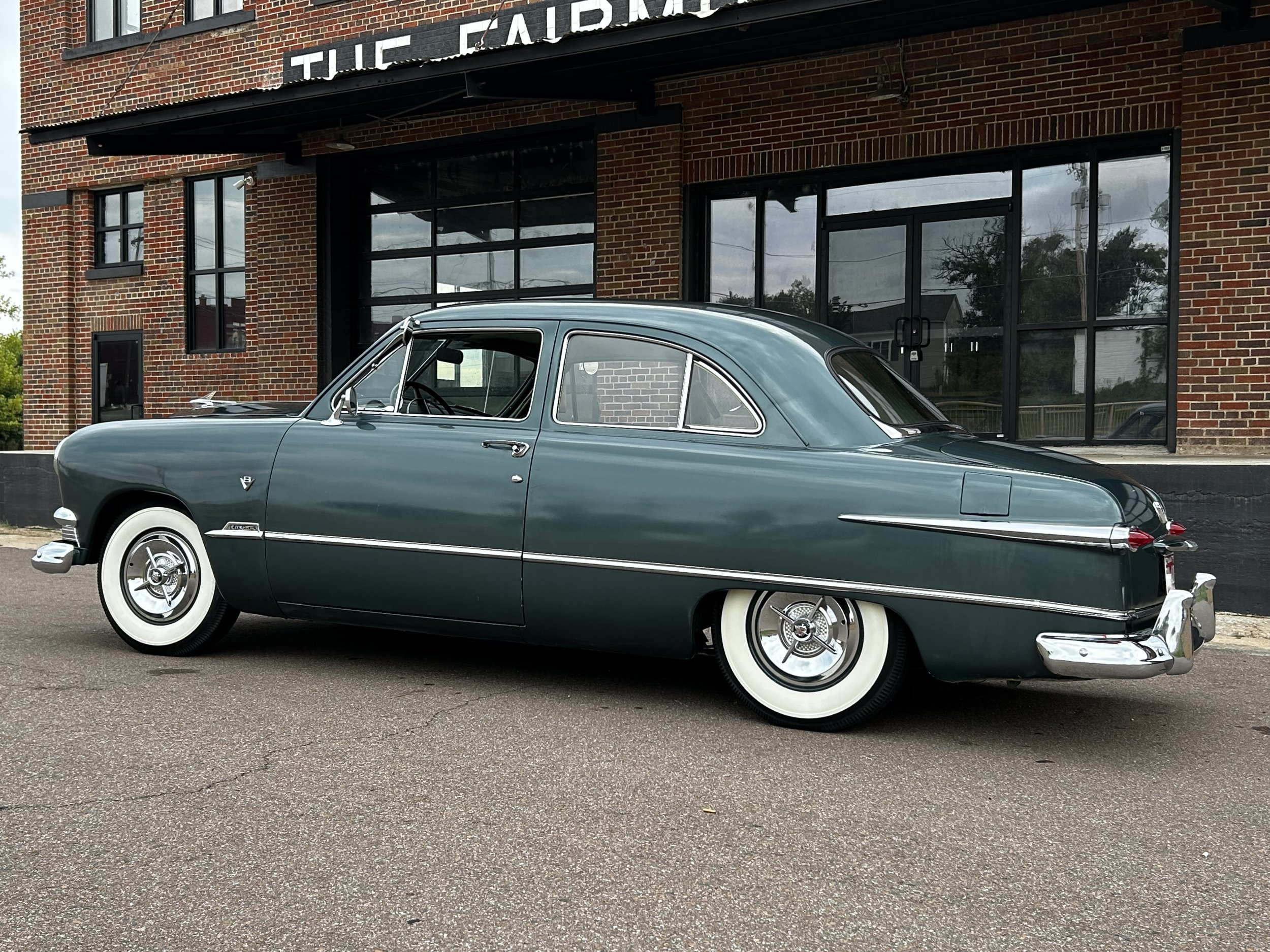

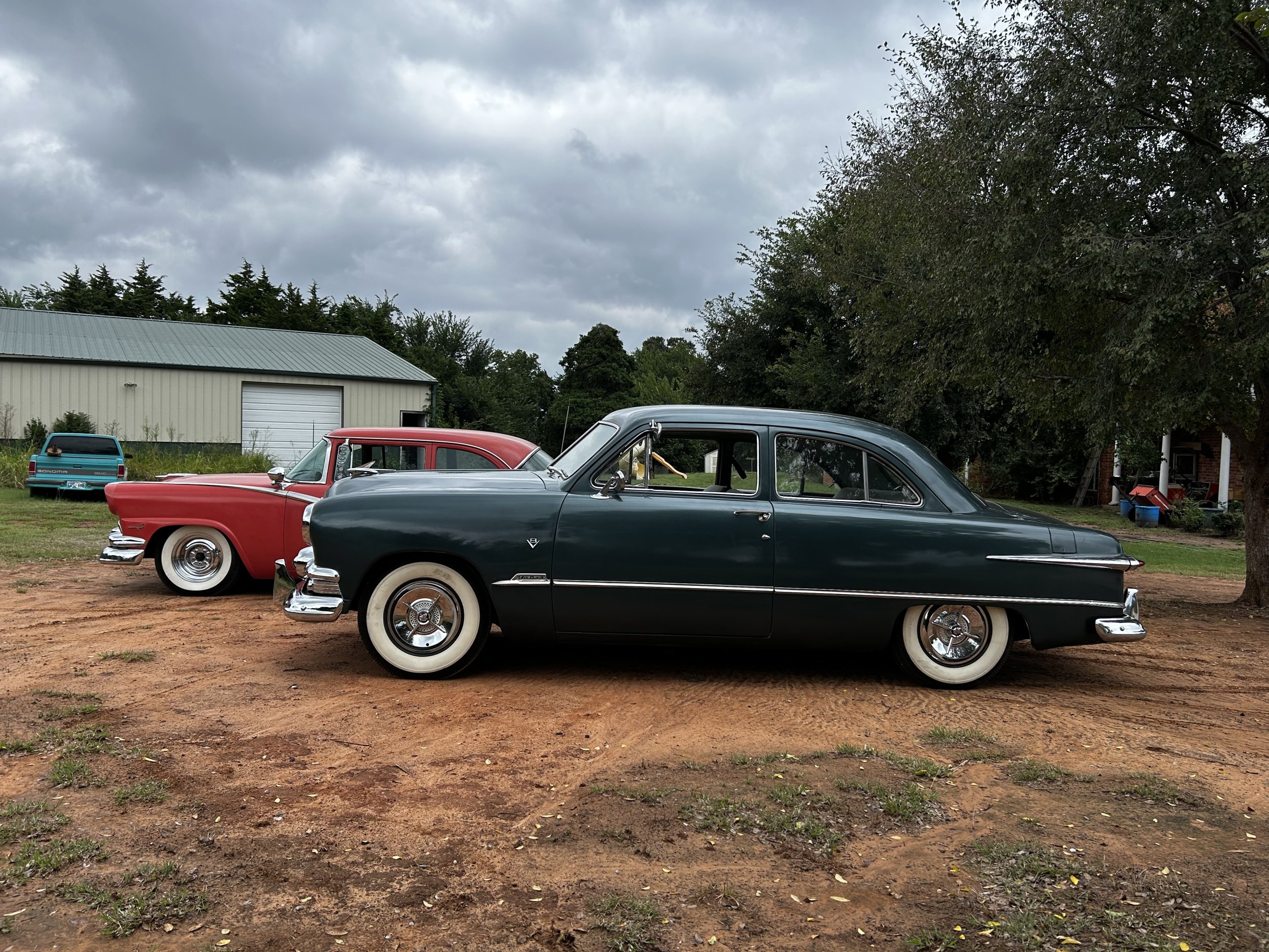

    Runs down the highway decent. Got it washed up too so took a few glamour shots.
    IMG_3464.jpeg IMG_3465.jpeg IMG_3466.jpeg IMG_3467.jpeg IMG_3468.jpeg IMG_3469.jpeg
  26. tubman
    Joined: May 16, 2007
    Posts: 8,231
    tubman
    Looks great! The whitewalls seemed to have cleaned up well, too. You never know about used tires.
    porkshop, winduptoy and guthriesmith like this.
