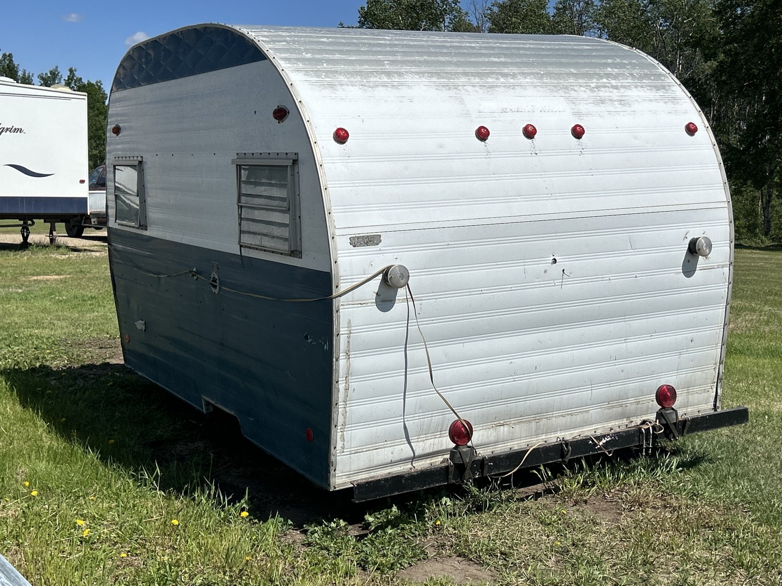

  1. I’m looking at a small rv trailer from the 50’s, a Burlington Flyer built in Burlington Ontario Canada. So far I have had little luck finding much information. Anyone know anything about them?

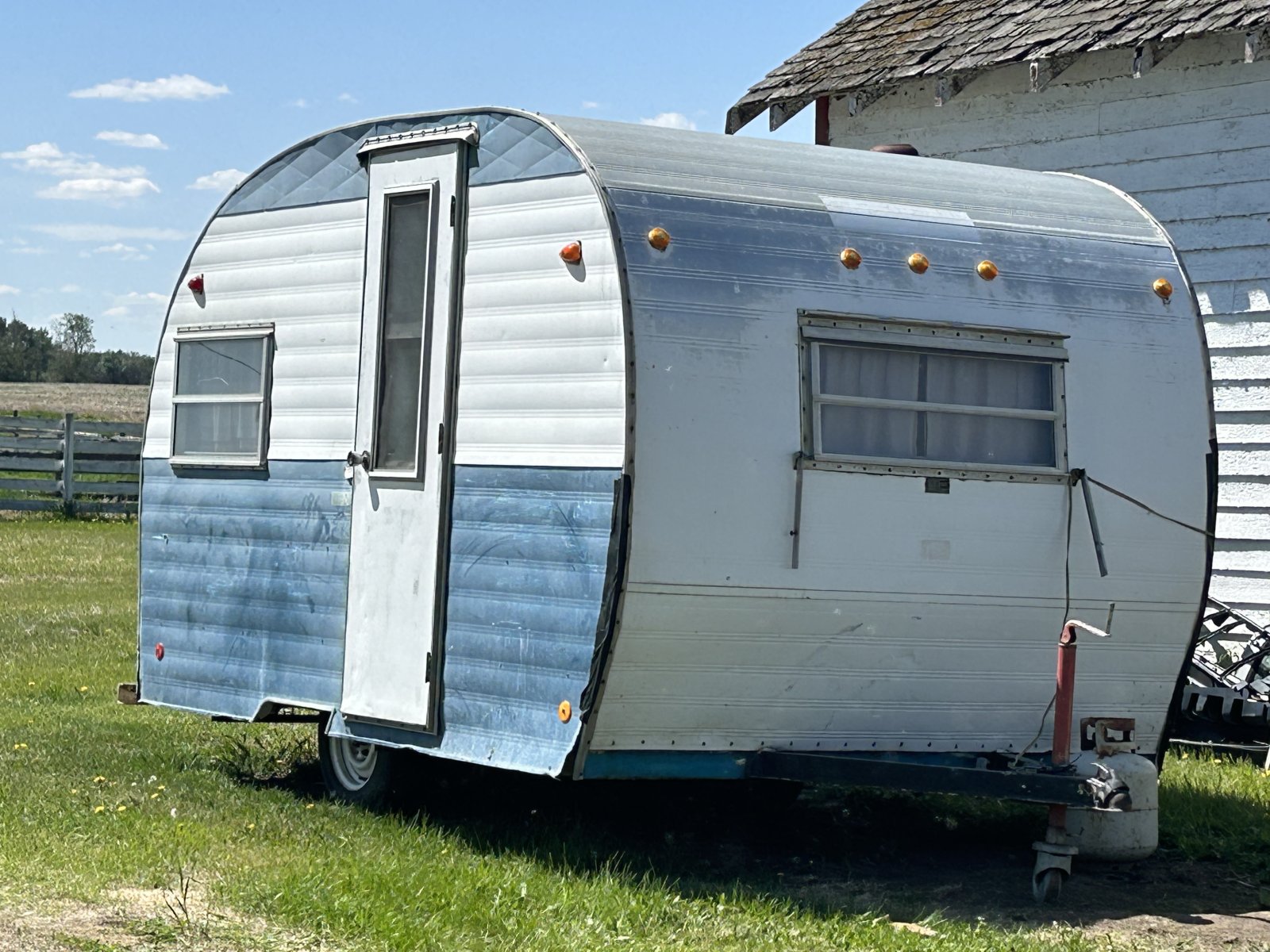

  4. My wife and I made a 1400km round trip yesterday to Reddeer Alberta to pick up a vintage trailer. The motivation is our upcoming road trip to Kentucky this fall. IMG_4438.jpeg 70699445137__BB372542-B5EE-41C7-B3E5-3180B9D13F50.jpeg
    It’ll get some paint to match the Fargo.

  13. Quick update, it’s not a Burlington flyer at all, that’s what the guy I bought it from was told, turns out it’s a Fleetwing, early ‘60’s as best I can tell in the little research I’ve done.

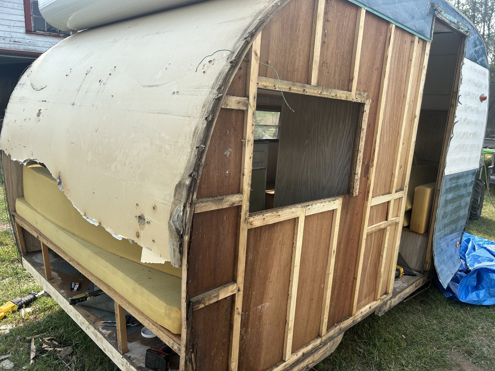

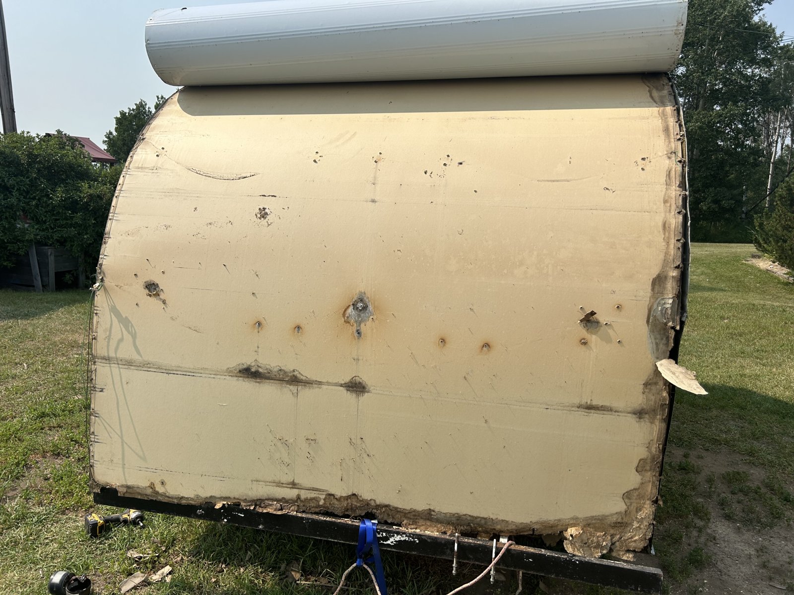

  18. Got sidetracked from my side project working on other side projects and finally started on the little trailer today. Of course I Can’t keep anything simple…. IMG_5661.jpeg

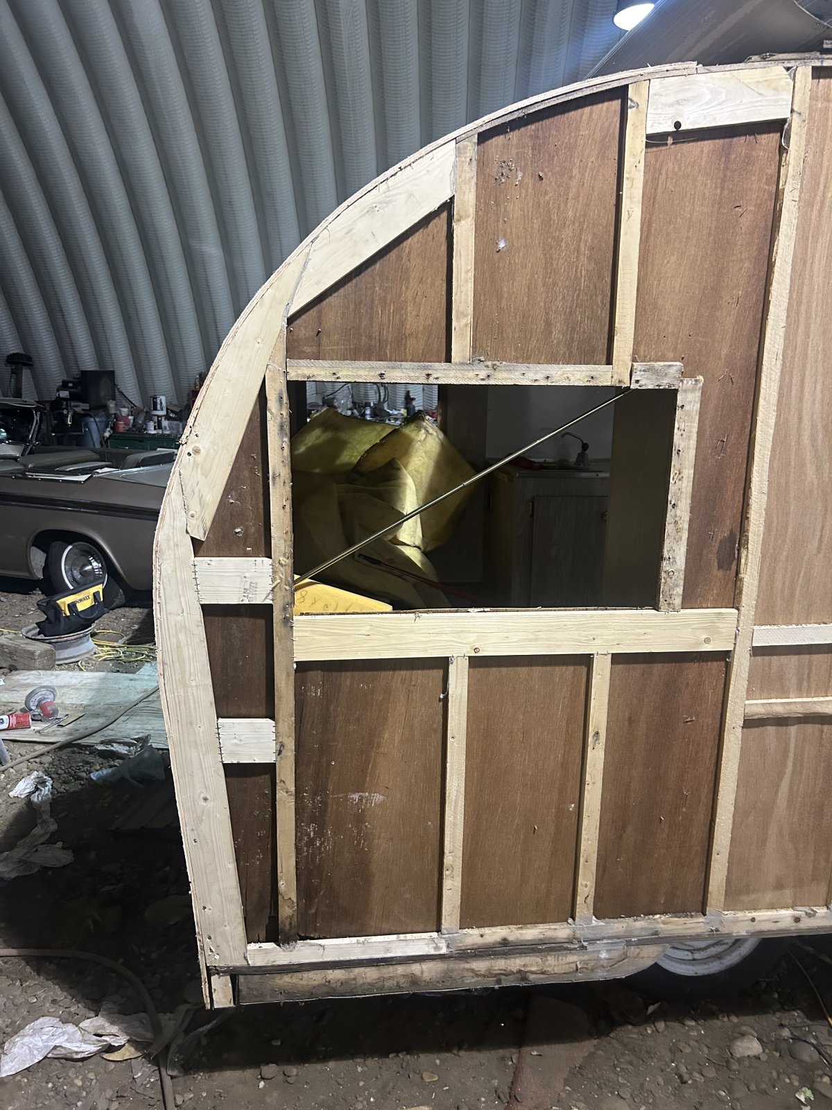

    Getting worse before it gets better…hopefully

    This is usually about the time when you realize that you should have just built your own from scratch.......
  21. That thought may have crossed my mind…

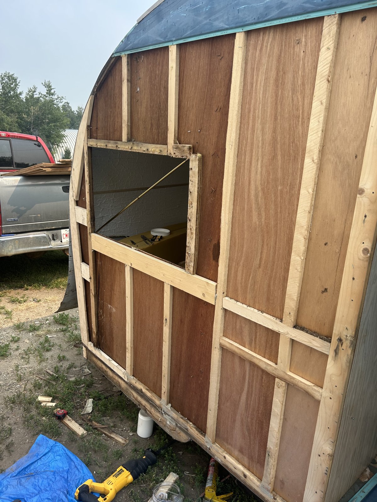

  24. Progress…I think. IMG_5665.jpeg one back corner close to finished. I’m resisting the urge to overbuild this thing. It’s made it better than half a century at this point, so I’m just rebuilding what is there with a few modifications.
    Actually most of it is decent.

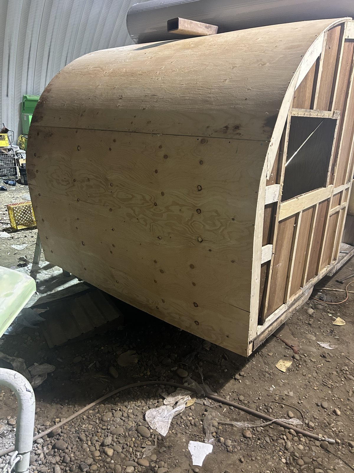

  27. Here I am updating to make myself feel like I’m getting somewhere. IMG_5671.jpeg IMG_5672.jpeg

    57; did you glue in some thin tightly-fit styrofoam or other dense insulation in the "gaps"? Should help sound-proof(at least lessen it a tad or three), & maybe help keep it warmer inside when it's cold out, & cooler in when it's hot out. Or at least that's the theory/claim... :D . Guess that's what mini A/C units are for. :D . Makin' good progress.

  29. I will insulate the walls, the roof is just the plywood no framing up there.
