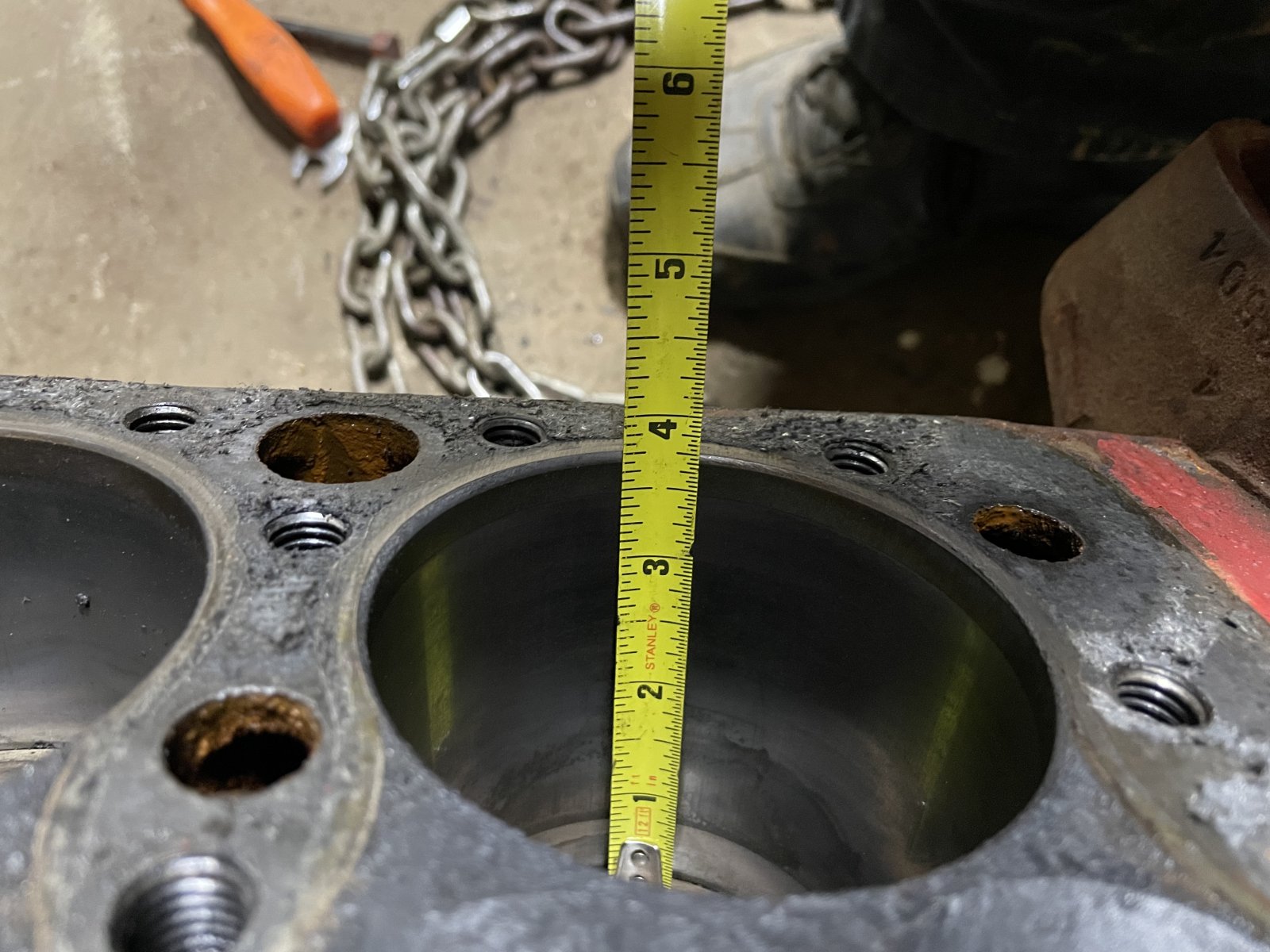

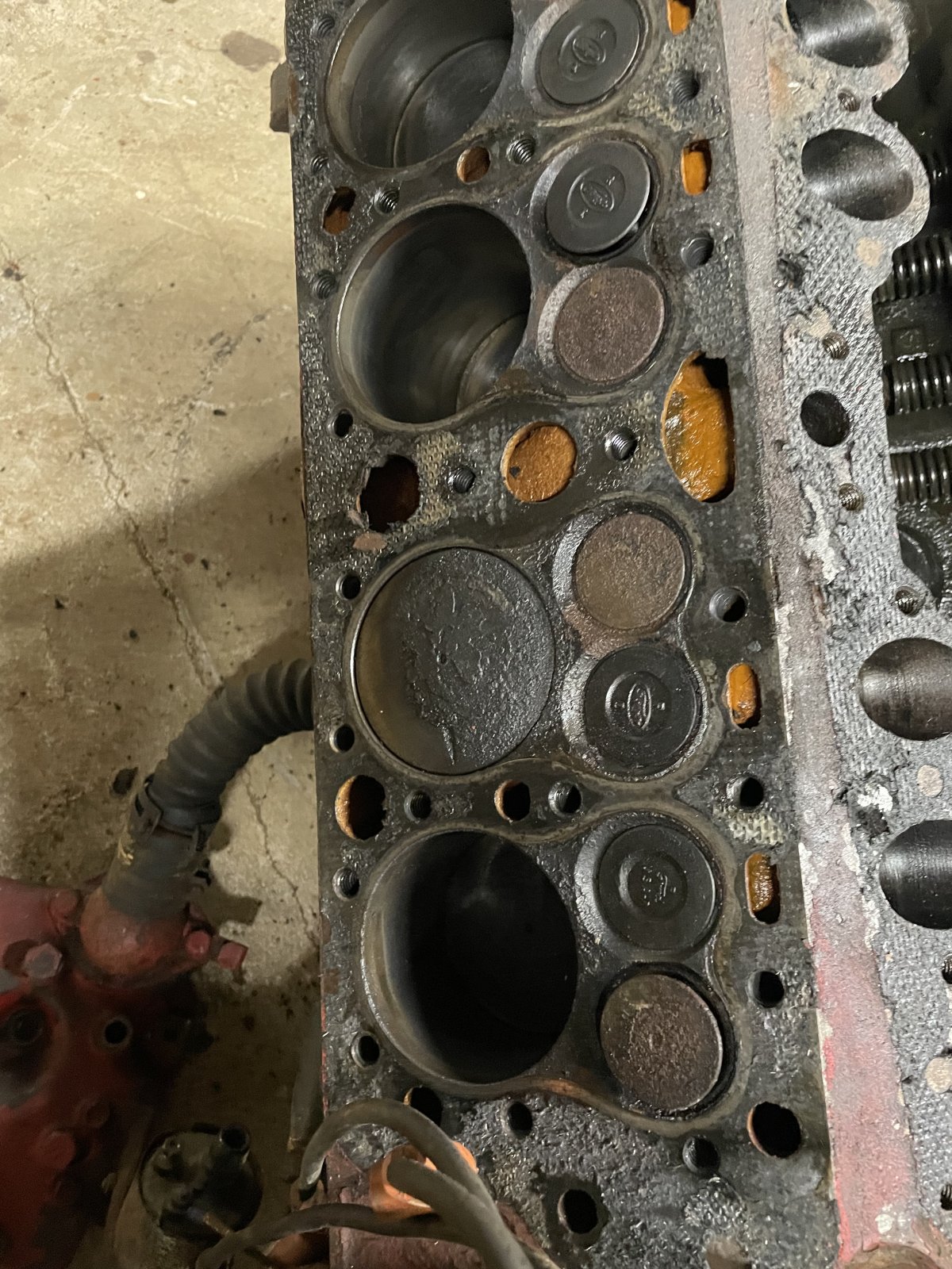

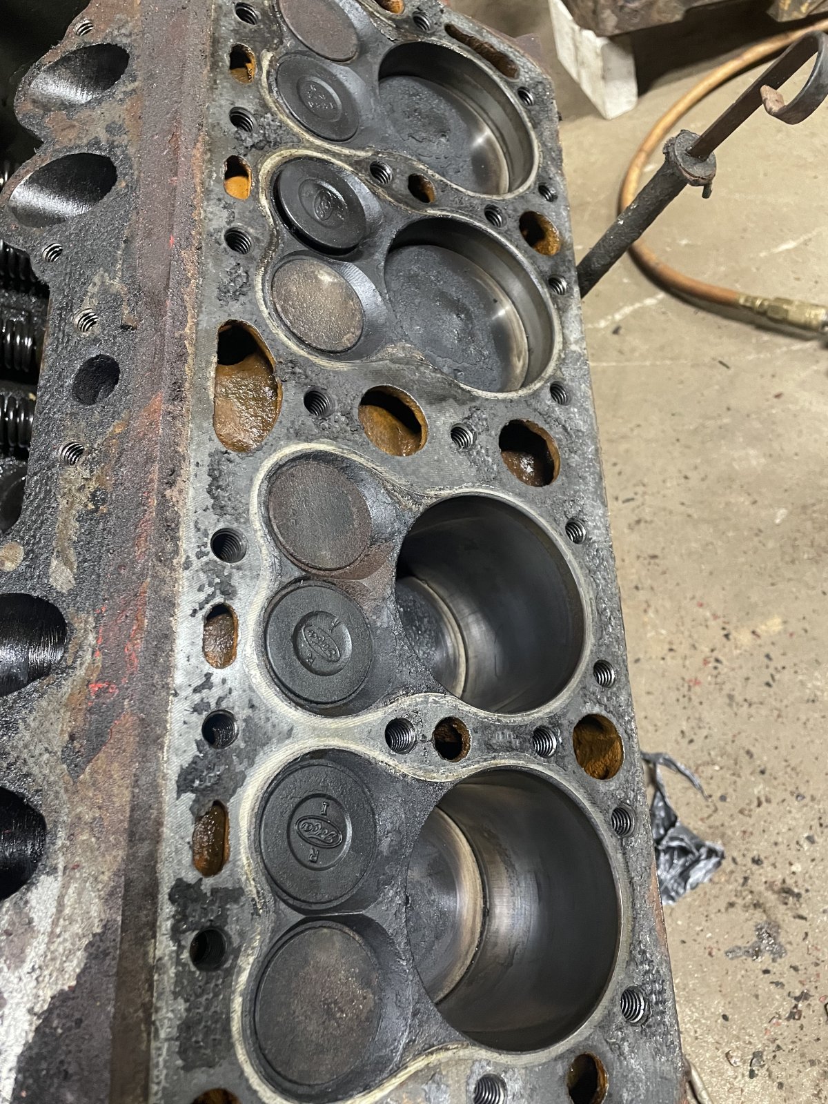

  4. Got the flathead home.
    Will get it in the stand tomorrow. Need to get some bolts.
    Yanked off the heads. Looks great. Cleanest FH ive torn down.
    1D659396-BC87-492A-B36A-87B1FA7414E6.jpeg 8B2E3B6A-A3D9-4B62-9B36-CDE181FBC333.jpeg
    Here’s a pic measuring the piston all the way down
    ford or merc engine?

    must be Ford. Merc has a 4 inch stroke, and Ford is 3 3/4
  6. If it’s ford that solves the engine choice question.
    I’ll pull the pan and look at the crank.
    Put it back together for a future hot rod maybe.
    I’ve got a 2nd flatty I pulled out of a Merc last week.
    Probably look at its crank as well.

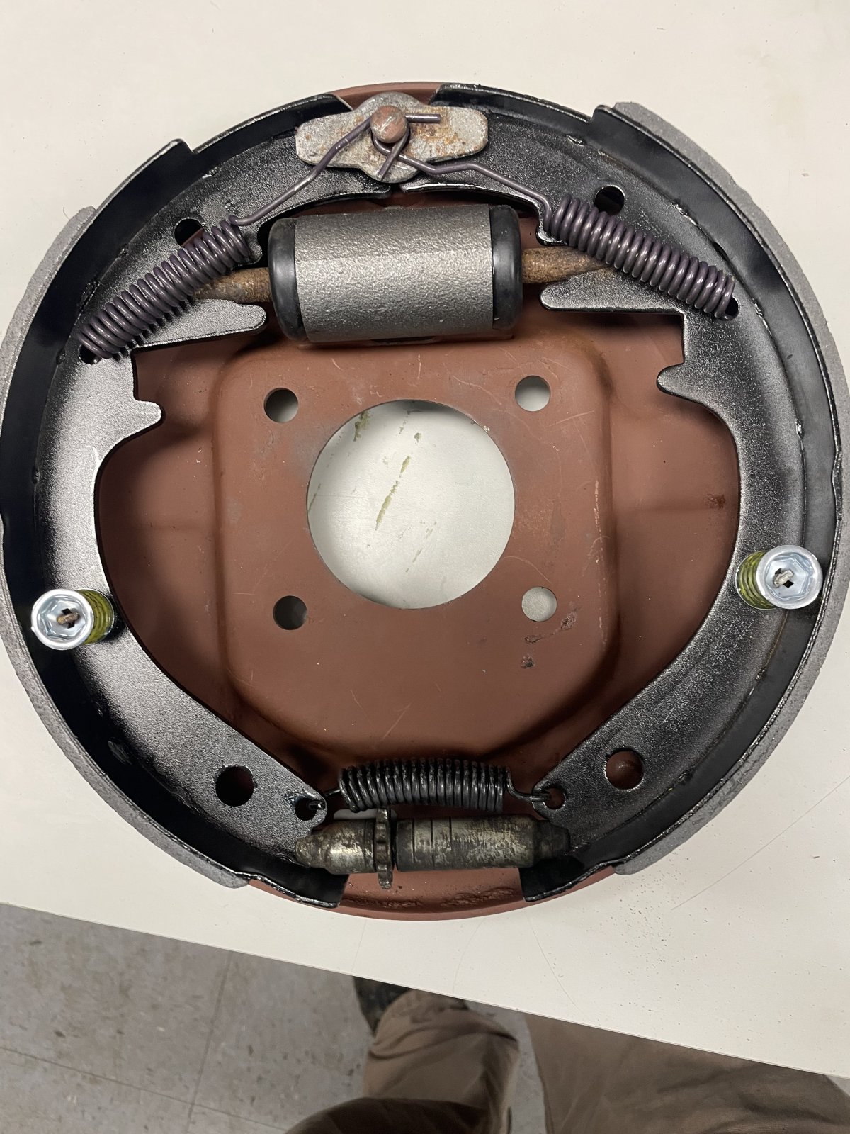

    Got my drum brake spring kit yesterday

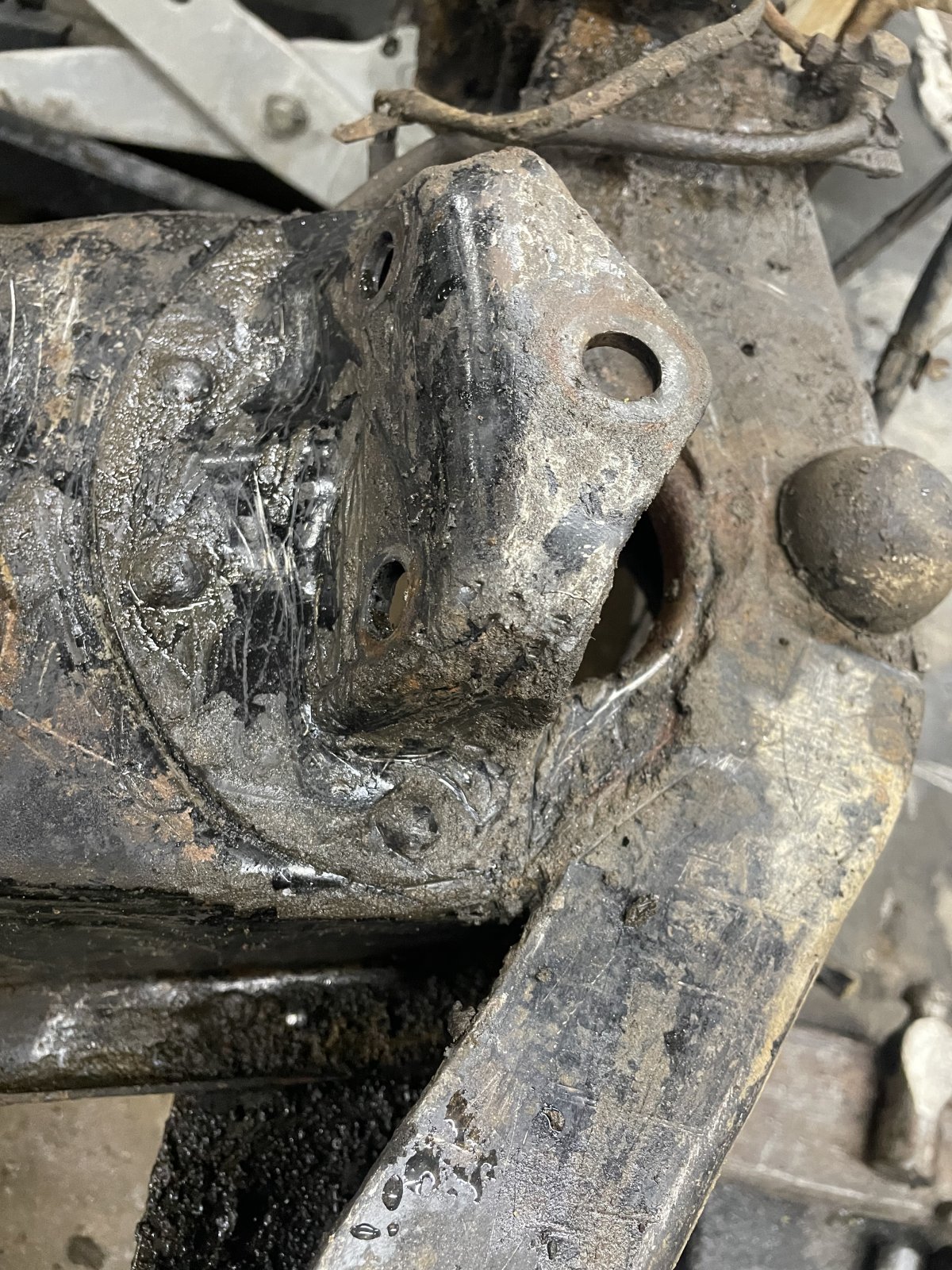

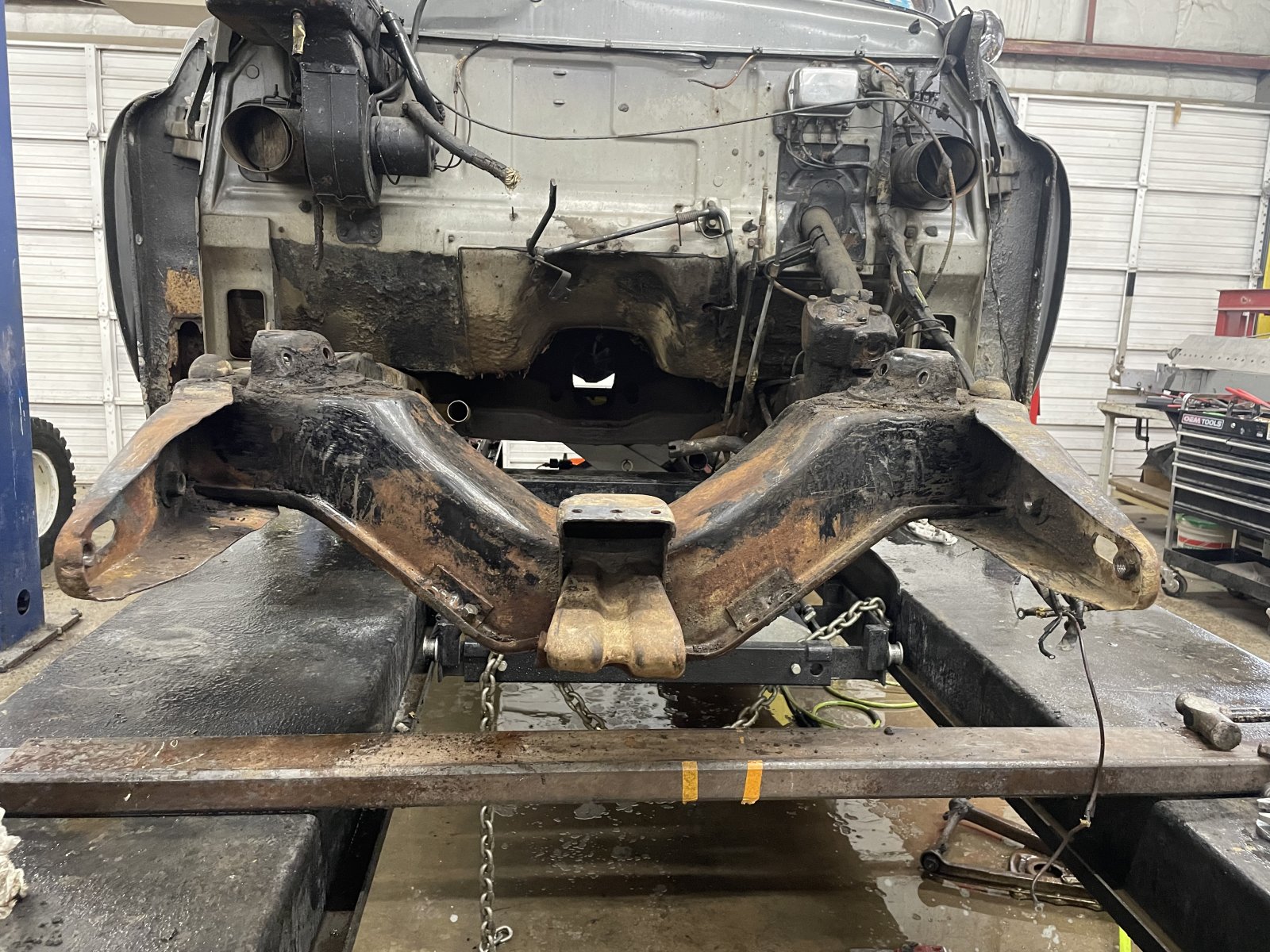

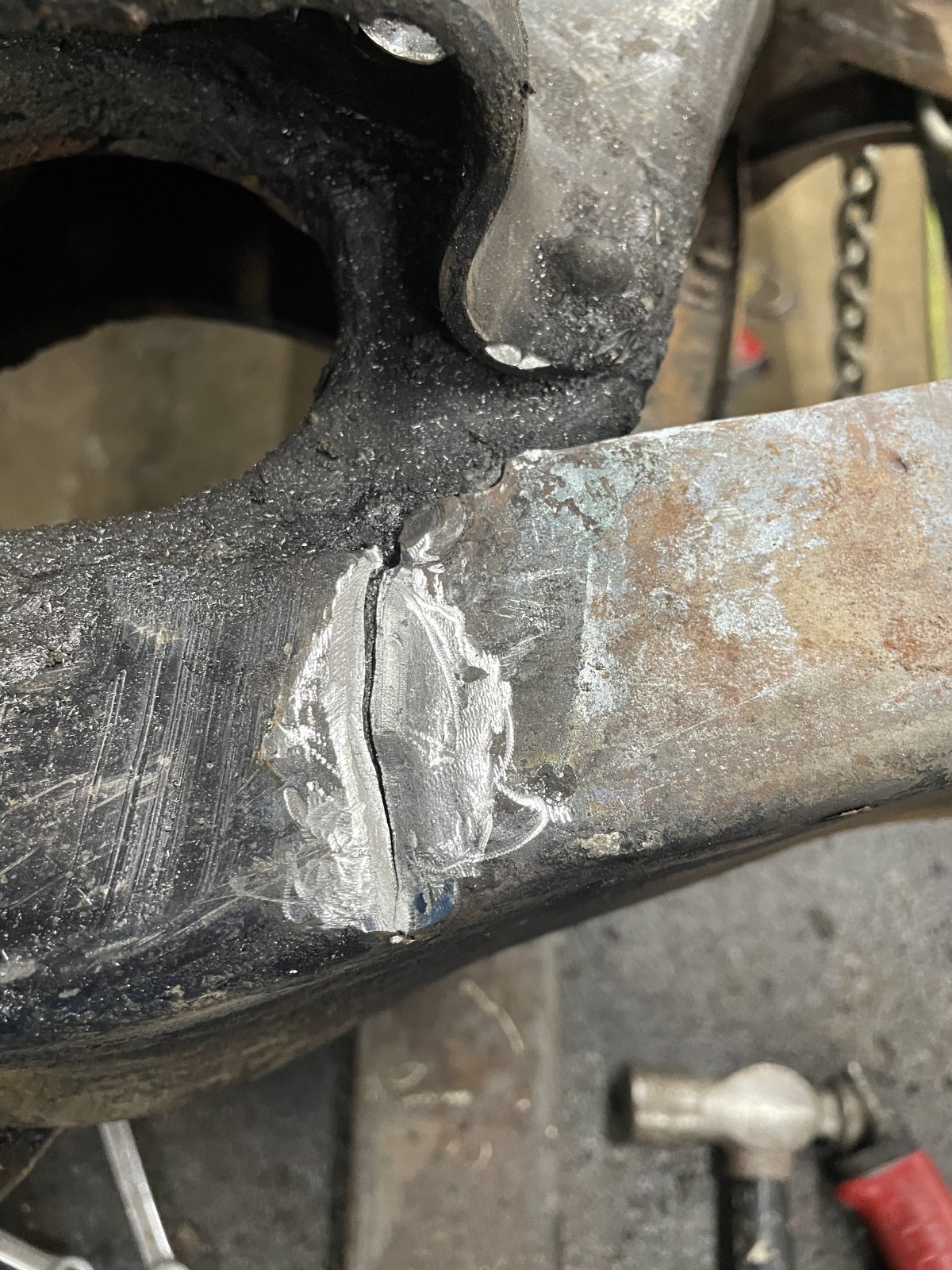

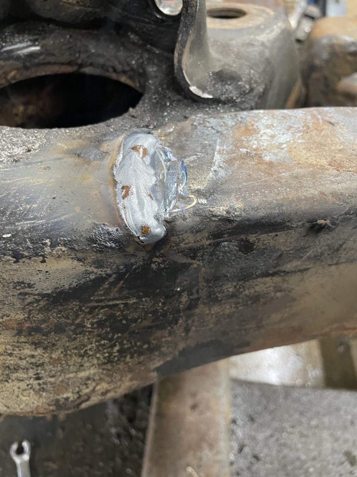

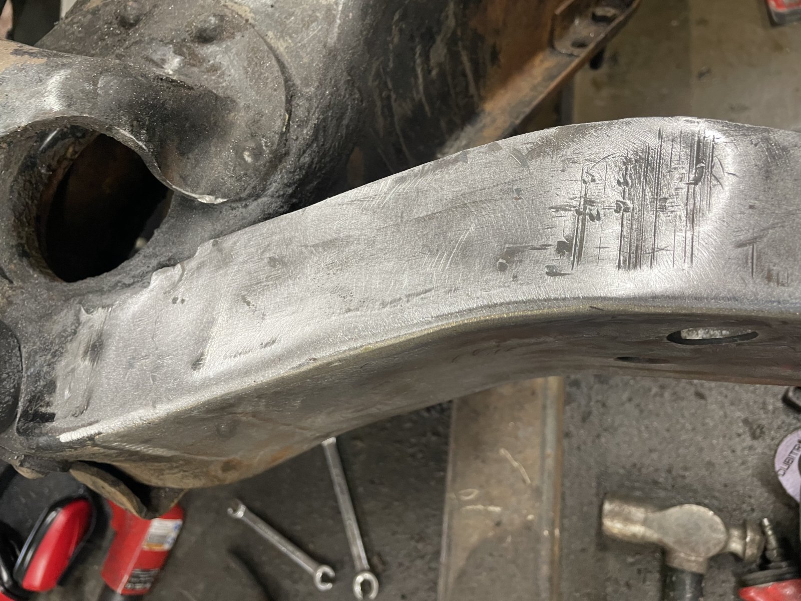

  14. Finished up the damaged frame horn

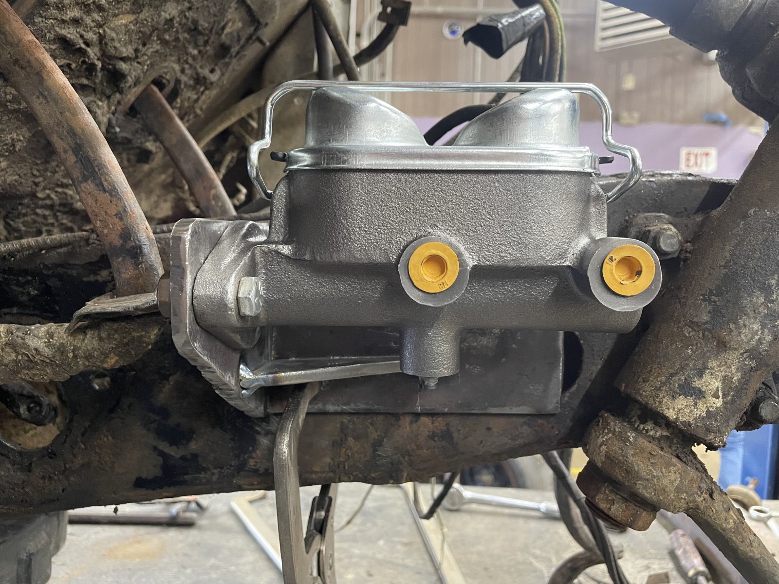

  15. Working on a MC mount. 63ish AMC master cyl
    Will probably fit the engine before finalizing.
    students made a pattern then heated a 4 inch piece of 1/4 plate. Bent 90* Drilled for the MC and tacked a gusset. Once fit we’ll trim the front to fit the large hole in the frame the rear brake line p***es through.
    The pedal might need heated and bent about 3/8 towards the inside.
    Will make that decision after fitting the engine.

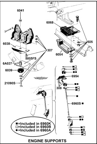

    jaracer
    That's similar to the way the engine is mounted in my 57 T-Bird. It has one mount at the very front of the engine just under the damper and one on the transmission tail shaft. However, it does have 2 "steady rests" at the center of the engine. They look a little like sway bar links with rubber cushion washers at each end. They do not hold any weight, just steady the engine from rocking. They are adjusted so that they have a bit of tension so I guess they support a small amount of weight. See 6960 on the drawing.
