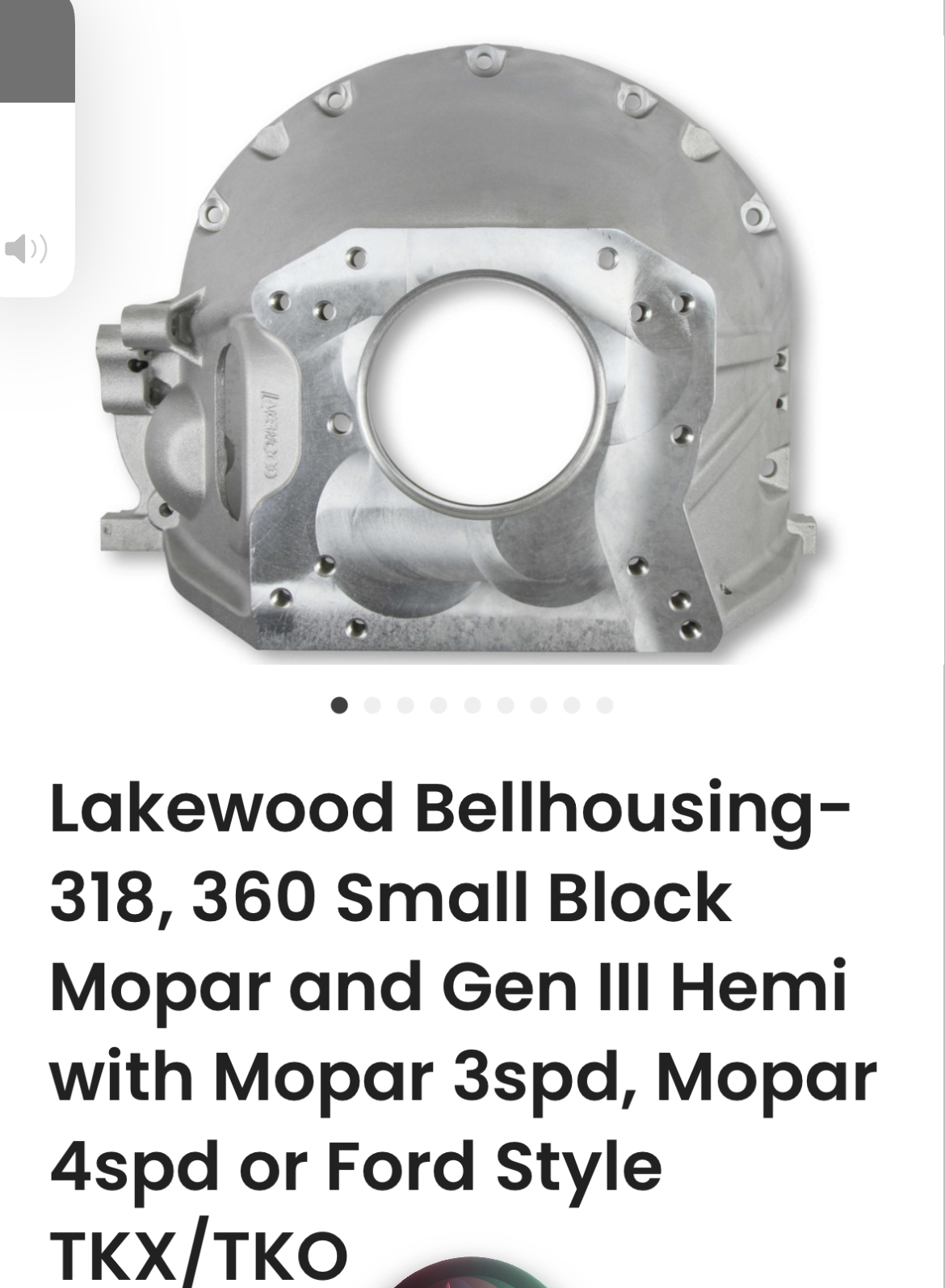

    just for spits and giggles. Possible to hook up one of the ford top loaders I have with this or an OE mopar small bell?

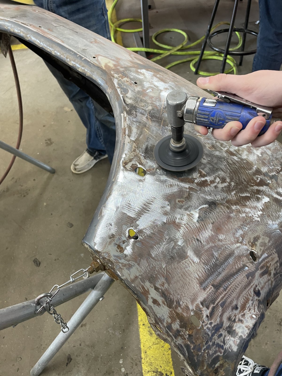

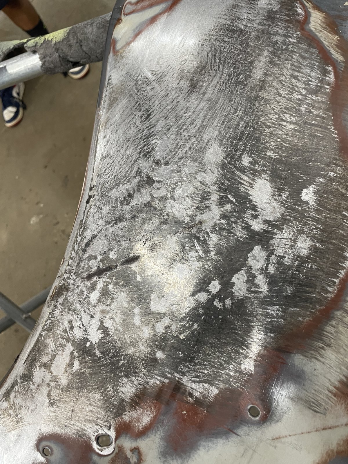

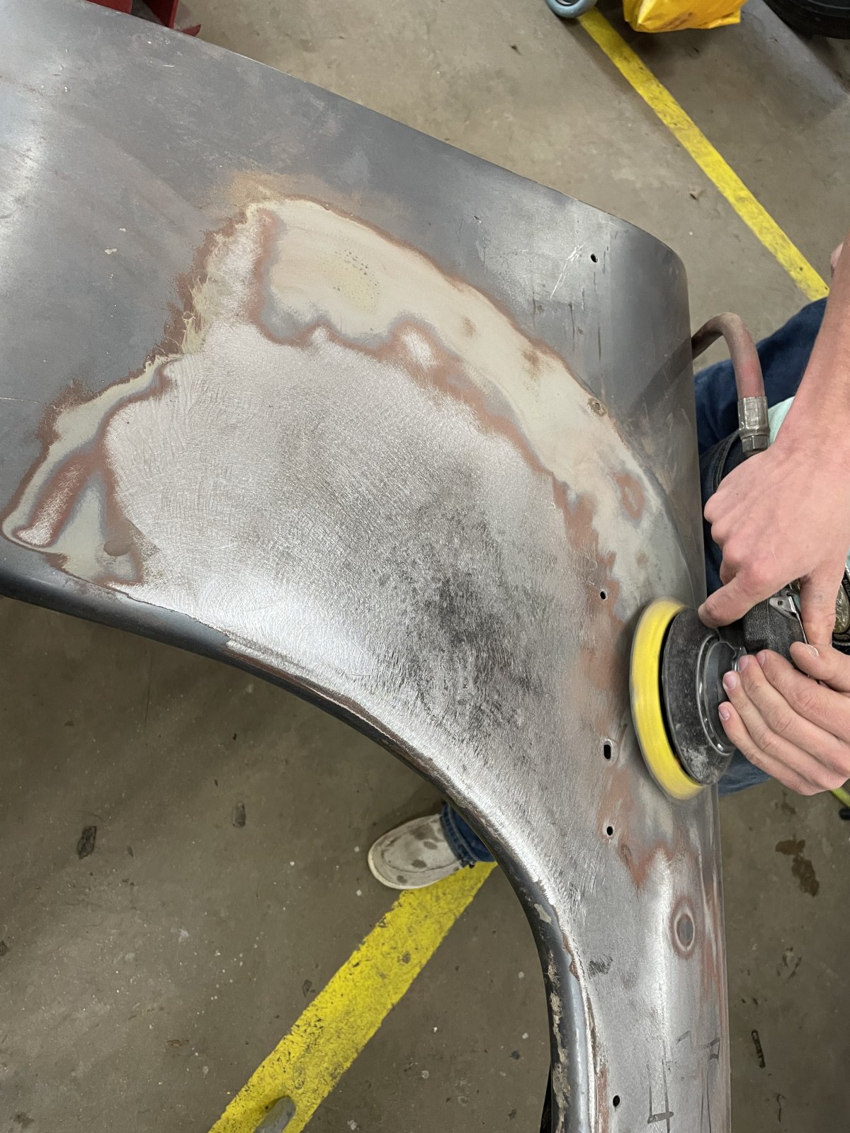

  16. Gettin there
    0CED0F88-C5AD-4FD6-B053-679A88FB71CD.jpeg Spot was about 3/16 thick on filler.
    C29E7D11-42DD-4B67-95CD-01E59F4A48B6.jpeg C73861BD-F59D-4CE4-B2E9-EC6CD81D66ED.jpeg EC41A66D-D65D-4CAC-BC48-AD7DC627A852.jpeg
    just about there. Just a little fine tuning left.

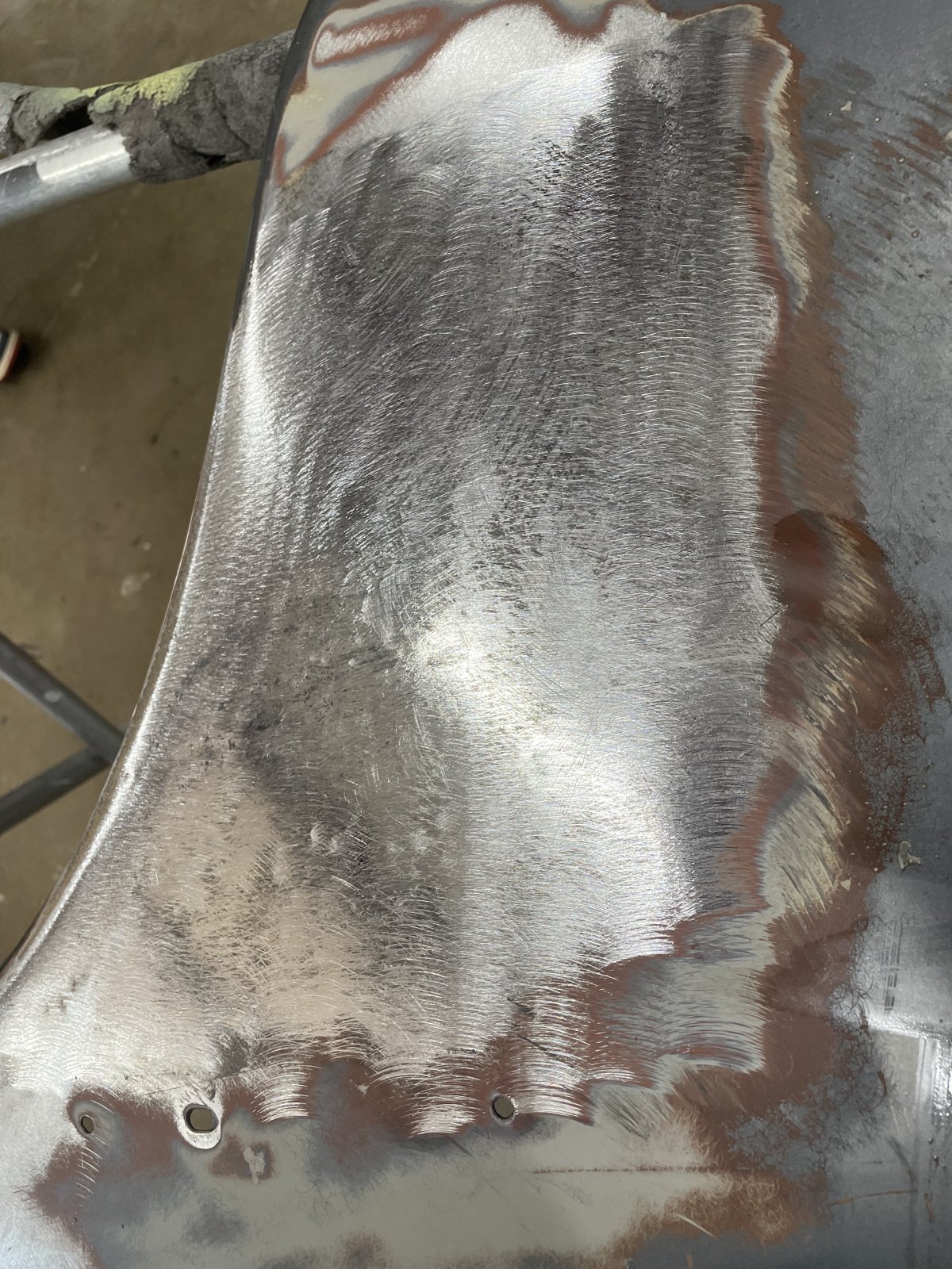

  17. 24FDD01D-B814-4485-80D3-B84367783363.jpeg D5D929AA-5387-4843-8770-FA2988EA069F.jpeg E930A062-94E7-4FEF-82F9-9ADC5317BE0D.jpeg 8FE68F3F-6E9D-48E4-9EA6-064CB7DD054B.jpeg
    roughing out the front of the fender and splash pan

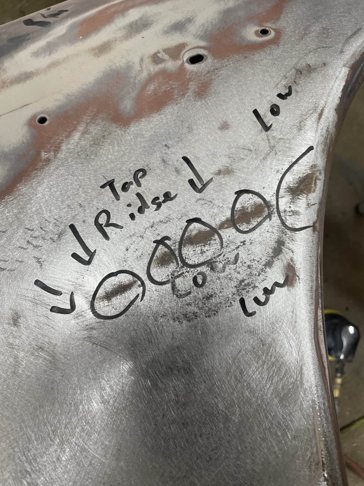

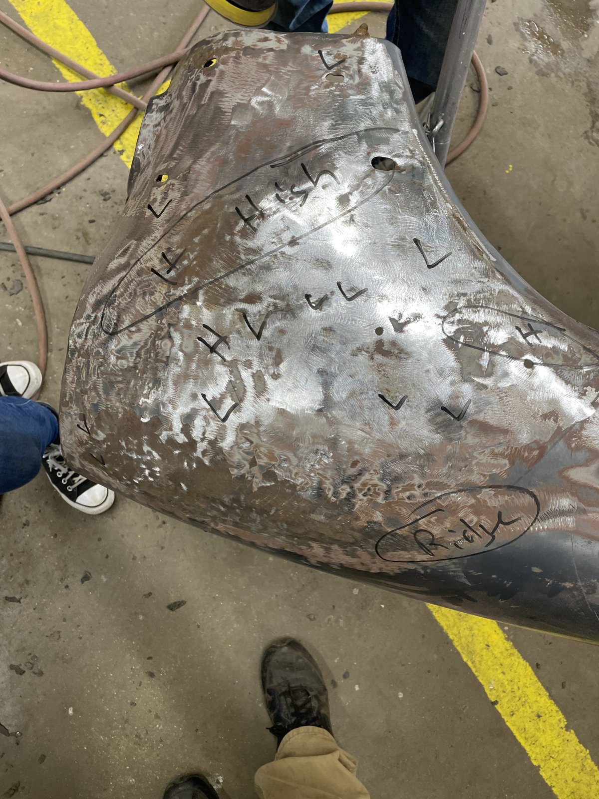

  19. Sr cl*** progress.
    I like to map out highs and lows with a marker.
    fender is ironing out
    Still got more to go
    students we’re introduced to a shrink disc

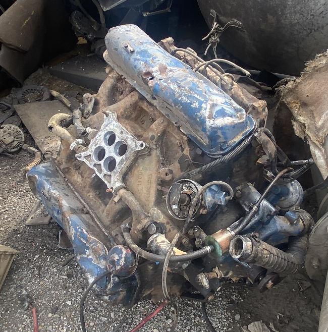

  25. Dang I’m glad a friend of mine visited the s**** yard before I did today.
    not sure if 352 or 390. 64ish. Has the breather on the intake.
    S**** yard killed everything but the block, intake and heads but at least we saved this. Word was someone dropped off a 64 galaxy. No sign of the trans was found. Was told it was a 4 speed car :mad::mad:
    I guess we should be thankful for what we saved.
    Plans are for it ending up in a chopped 50 ford coupe with a FMX
  26. If it had a 4 speed on it look for a pilot bushing in the crankshaft, however it looks like the remainder of a Kickdown linkage on the intake. I don't think 64 was throttle cable yet.
  27. Has a manual bell.
    S**** yard killed it.
    Trans was the old bolt pattern.
    The block breather tube could be what you may be referring to.
    chryslerfan55 and Algoma56 like this.
  28. s55mercury66
    Joined: Jul 6, 2009
    Posts: 4,367
    s55mercury66
    from SW Wyoming
    The blue on the FE indicates 1966 and up, I always thought, but that is not so, 352's ARE blue, 390's are gold.
  29. It’s been messed with.
    Intake casting number starts off with C4
    The heads are older
    chryslerfan55, Algoma56 and bchctybob like this.
