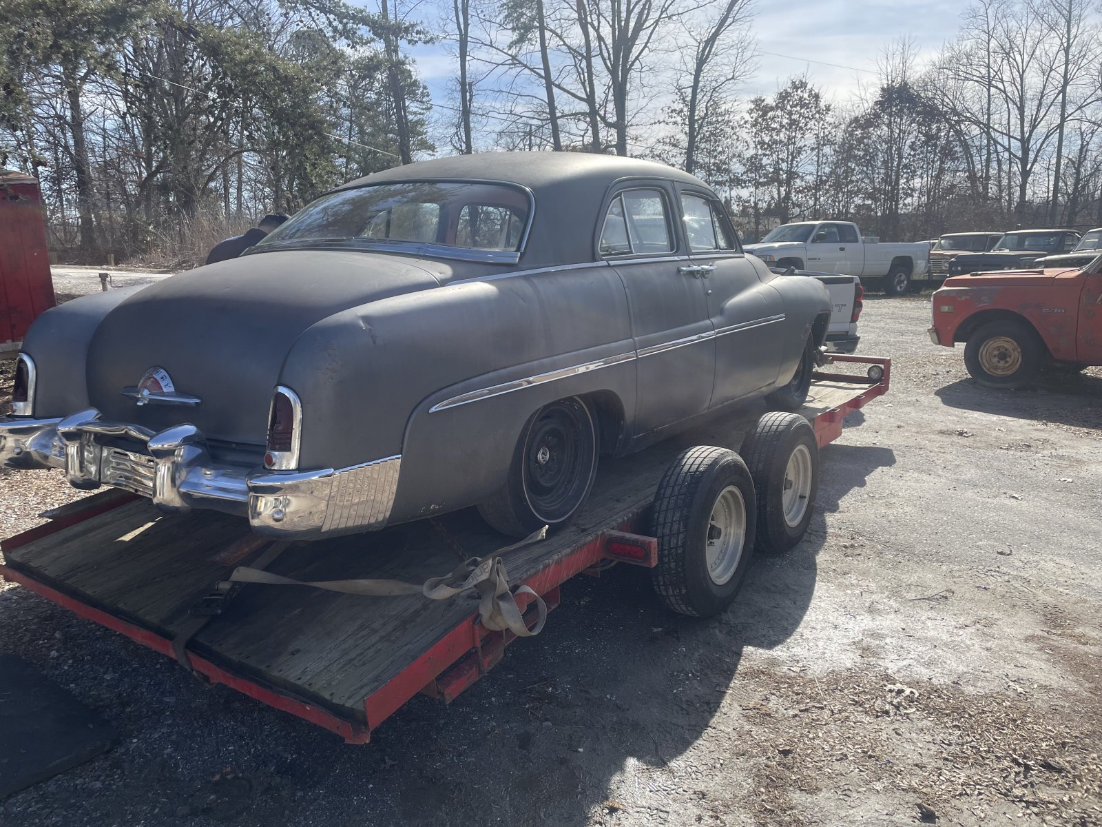

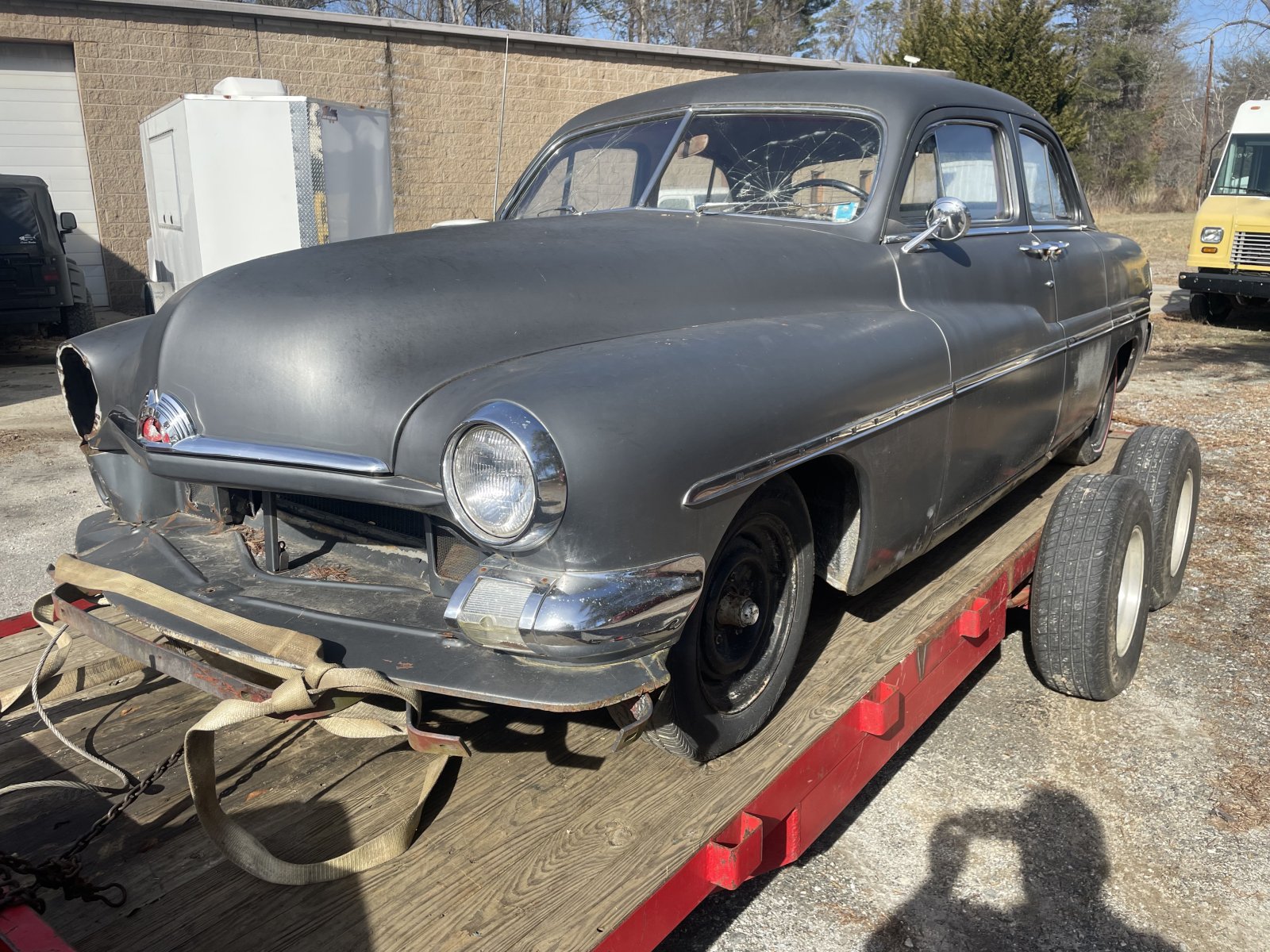

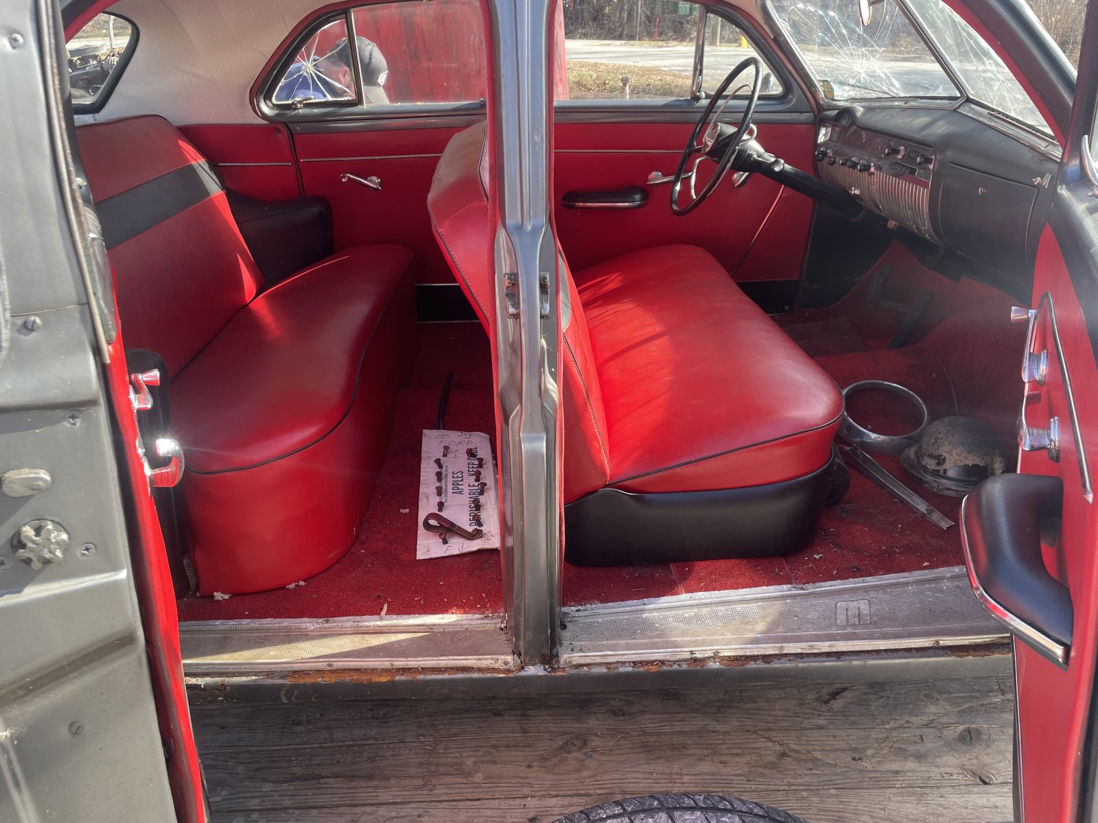

    I’m way ahead on this merc over my other one.
  2. Cleaning on the front seat.

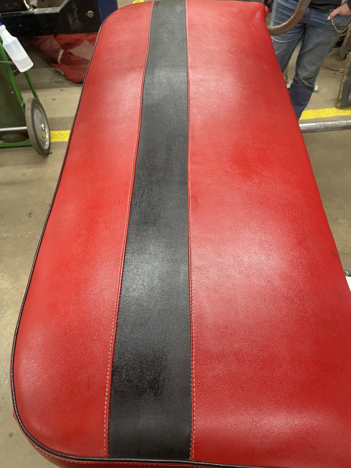

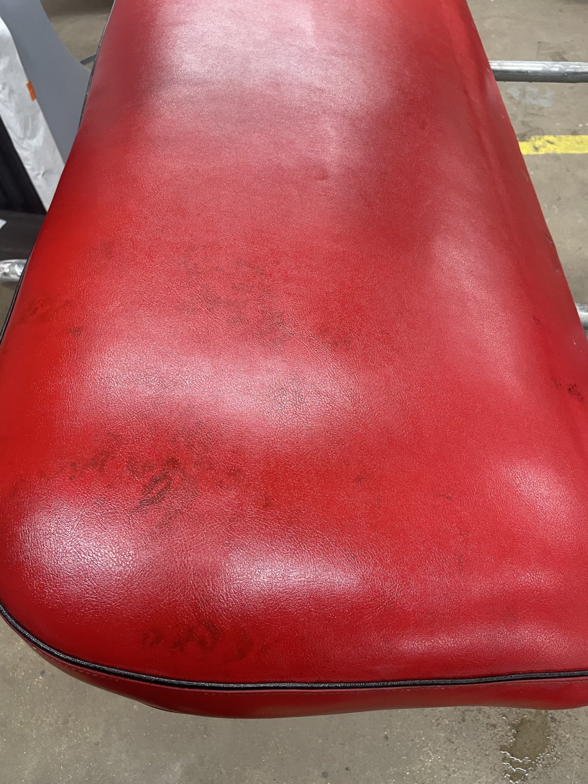

    Not bad.
    Got some dark spots on the bottom.
    E69B6FEF-B034-434F-9044-3D321B985A74.jpeg DFFFC77A-8572-4709-9A61-12FBE6D141A0.jpeg
    We’ll work on that
  3. IMO suicide doors make it cooler than any two door hardtop.
  4. bobss396
    Joined: Aug 27, 2008
    Posts: 18,752
    bobss396

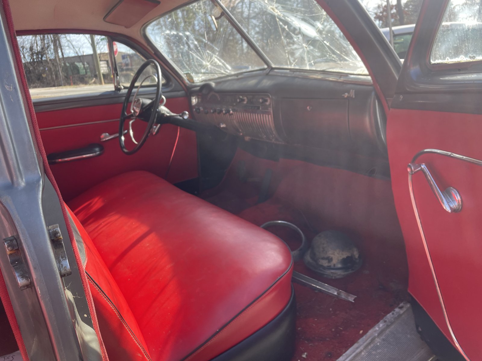

    Are those covered? Sometimes we would find NEW seats under the cover. Some dealers had a deal on covering new seats when you bought a car. It was an early 1950s thing.
  5. Yep. Looks like the original covers are under it.

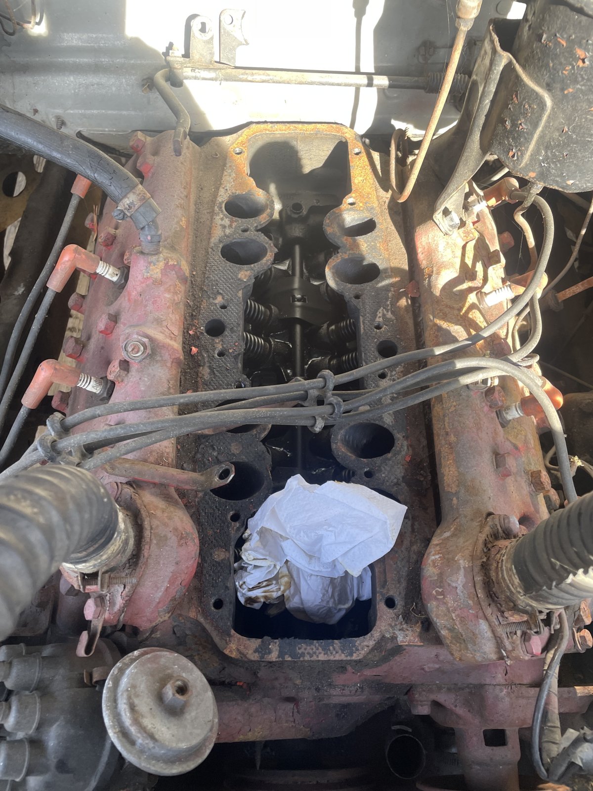

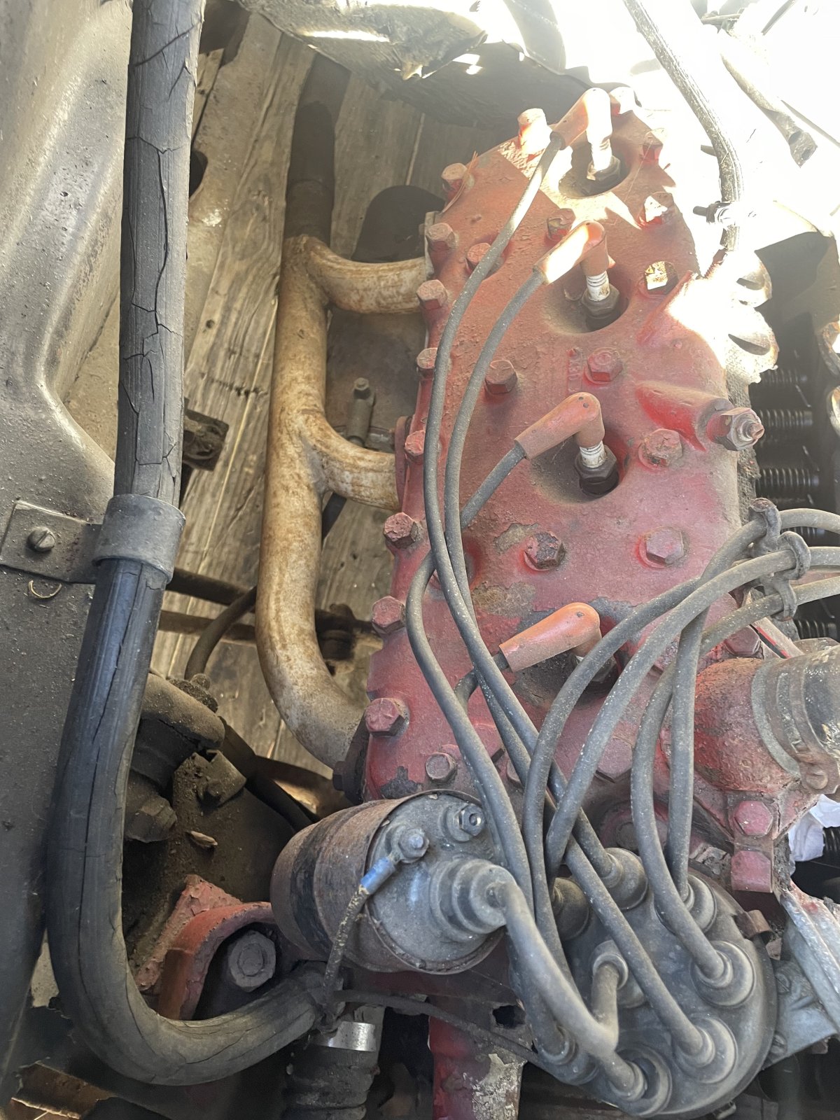

  21. Well ****. I messed with merc flathead #2.
    Pulled the other head. So far, even with heat and patience, I have 3 broke head bolts.
    Haven’t pulled the pan. But the oil was clean.
    Looks like the drivers side head is busted.
    the good news is it turns freely. Last tagged in the early 80s/late 70s.
    Bores are clean.
    4 inch stroke?
  22. No stamping for oversize on the piston I cleaned.
    I got this flatty from a good friend that recently p***ed. He was an old hot rod/custom guy.
    Owned several mercs.
    Might investigate further in this flatty.

  25. A little more investigation into merc engine #2.
    Ford bearings
    pitted from sitting a long time. Journal looks great.
    I’ve got a set of EAB heads as well
  26. Old merc FH looking ok so far.
    Got to rig up a valve spring compressor. Both flatheads have valves stuck in the guides.

    Anothony, be sure you check block #2 for pan rail/main support cracks. ^^^^ This looks like a freeze crack.
