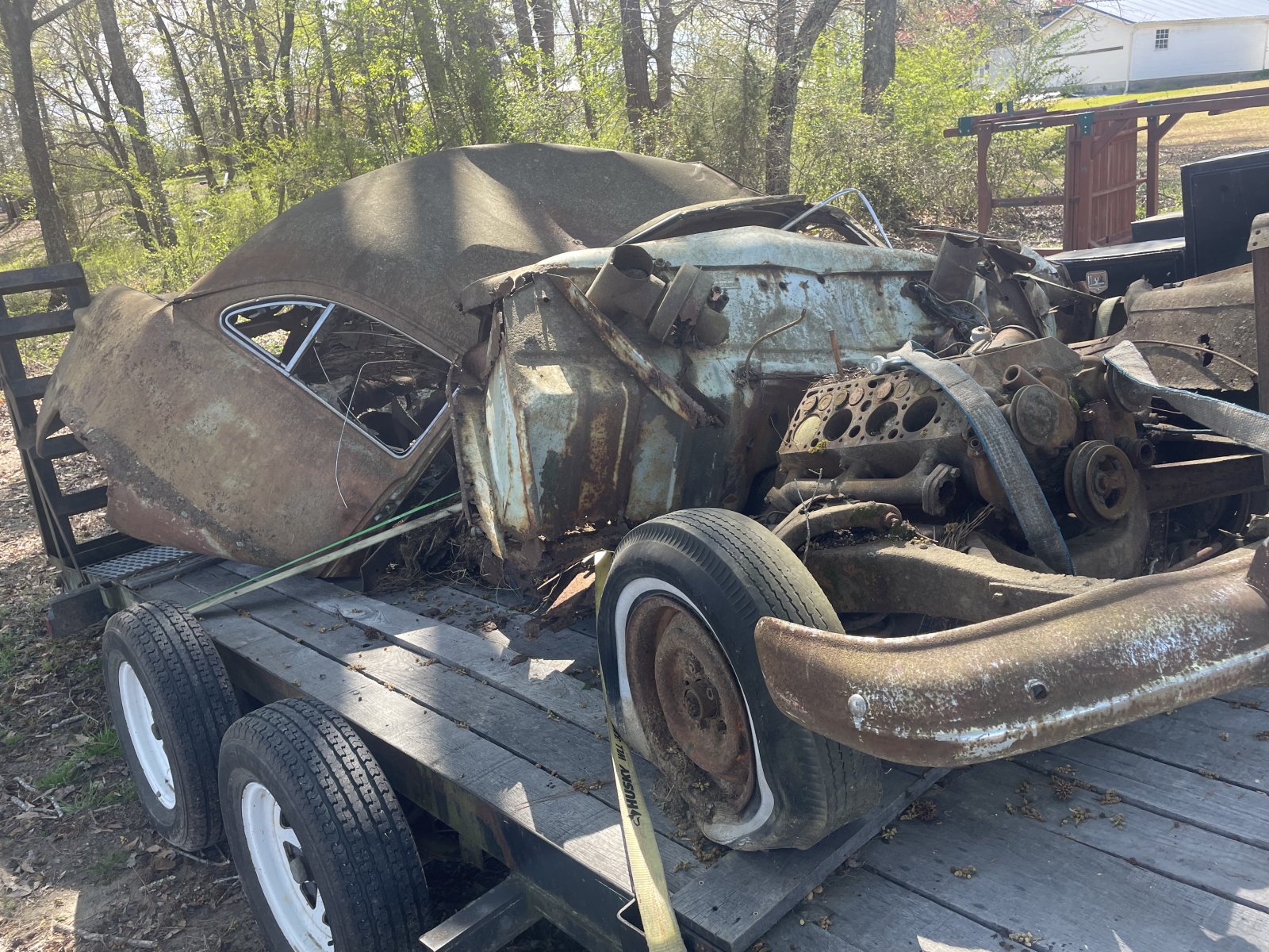

  1. So for so good.
    I was hoping it at least had a good rotating ***embly. It does. The rest is just a bonus if it’s good.
    Plus I t learned how to get the valves out.
  2. I’d like to thank @LB for hooking me up with a nice NOS skirt.
    208A0EAC-8CCB-4F4A-A632-905F4FC7BD2A.jpeg 9AC6D123-71D1-434E-8C95-5E64C2AD5E46.jpeg

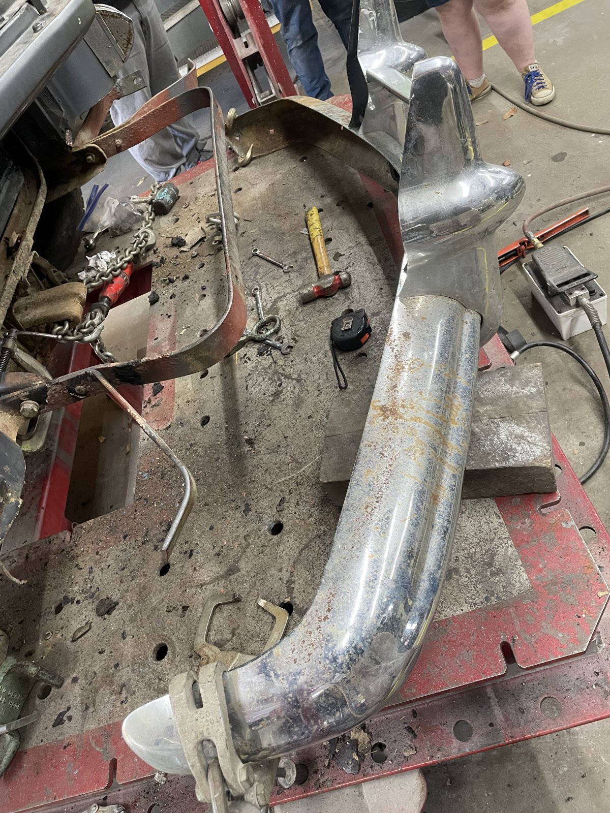

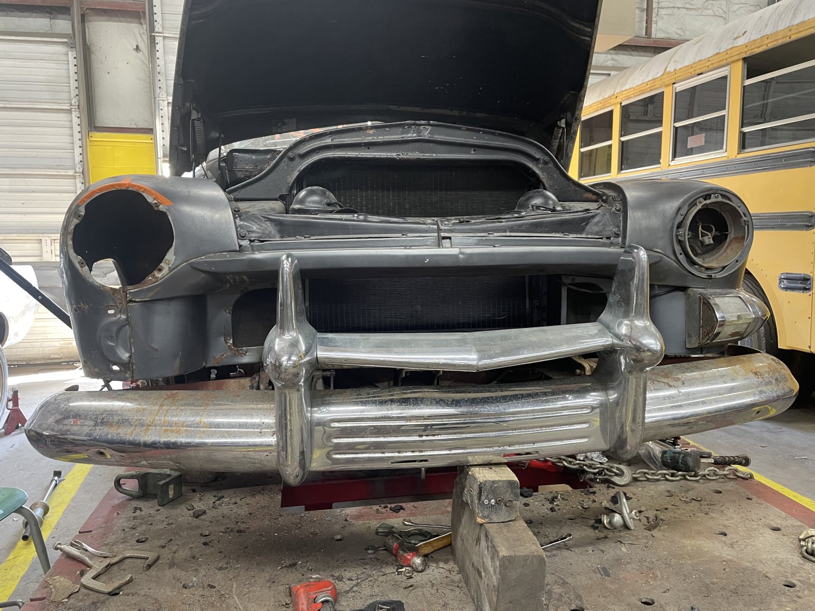

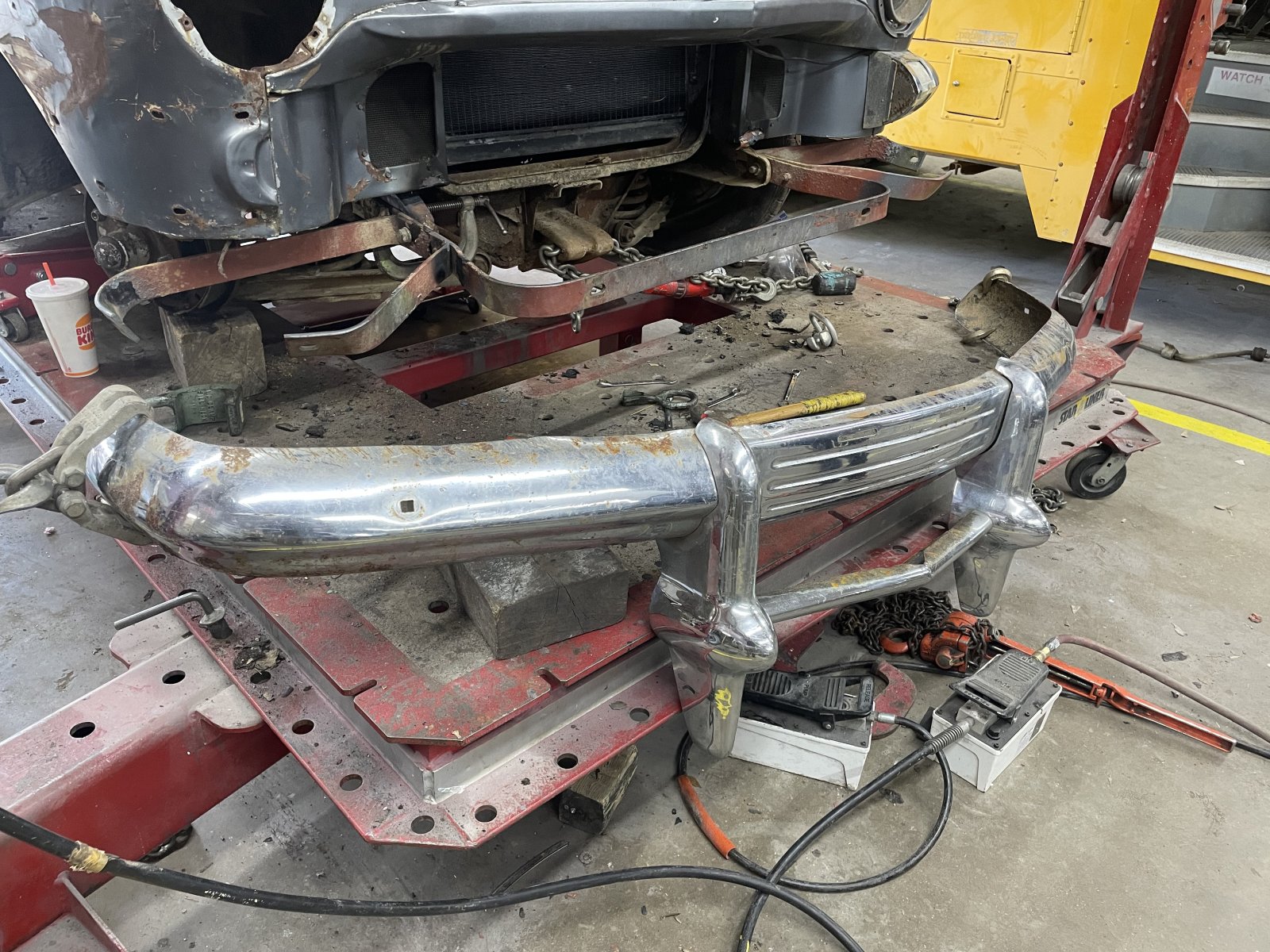

  3. Those bumper gards and center piece make a great bar grill if laid out horrizontal and welded together.
  4. I had some 49/50 bumper guards. Held em up in the grill opening.
    Looked pretty good.
