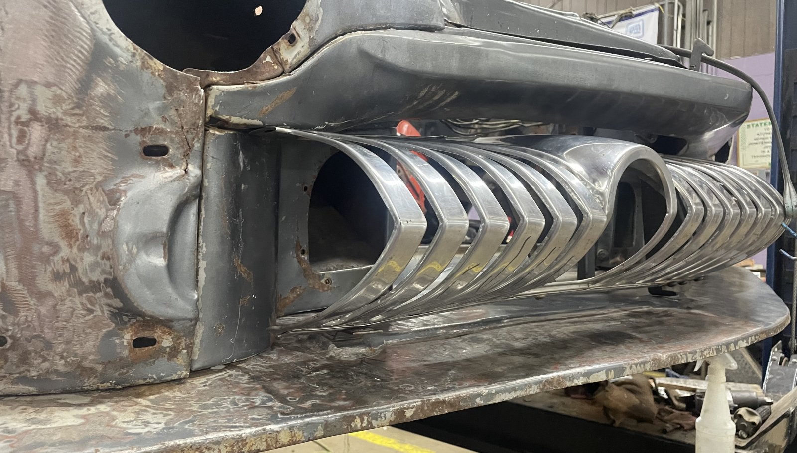

  1. Picked up this 4 row copper from a guy that wanted a polished aluminum one for his 55.
    New build he bought and thought the radiator needed replaced cause it wasn’t pretty.
    It’s a new radiator. I think I gave the guy $150.
    I’m good with an “ugly” radiator

    A little black paint and it’ll be purty again.

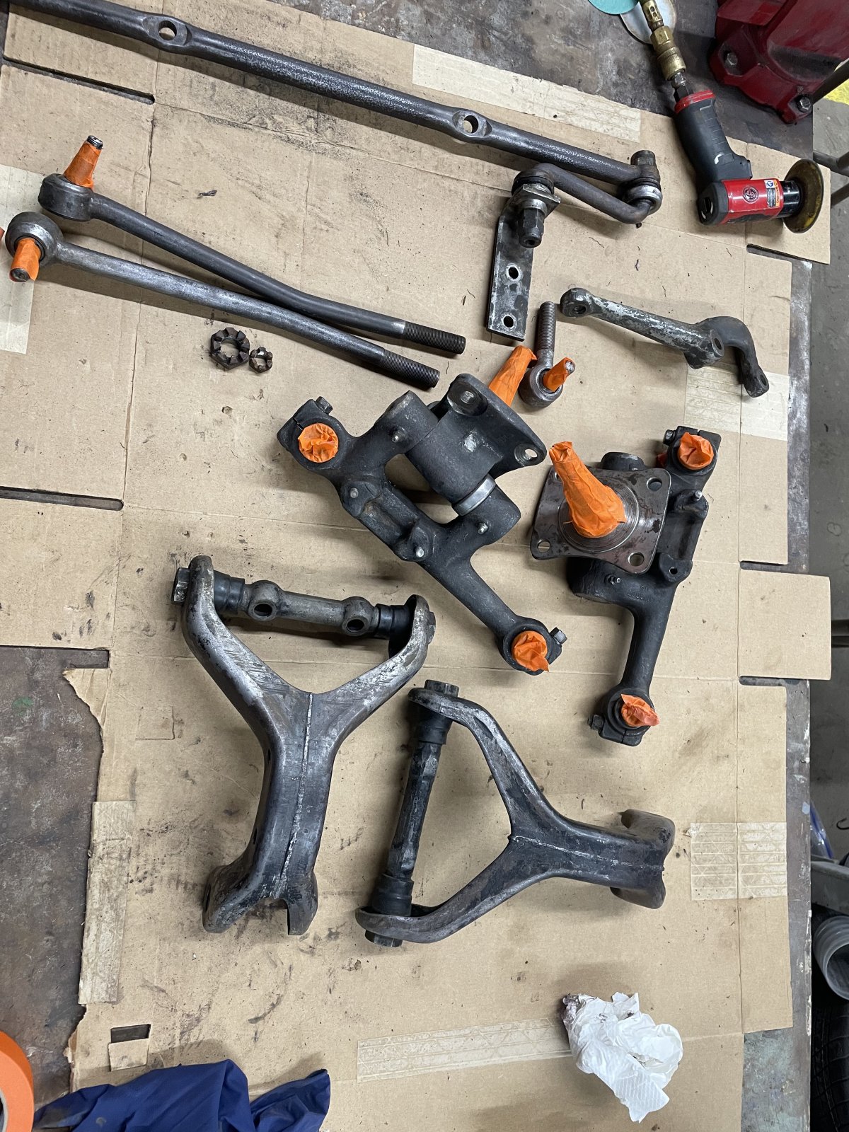

  6. Taking care of suspension issues. King pins were shot.
    I thought I’d check the parts car I have before I order some. They p***ed the tire wiggle test so I removed em. 68F5EB54-AD2A-4A34-8586-9A4A4382A70C.jpeg
    King pins have been replaced and feel great.
    Cleaned up nice

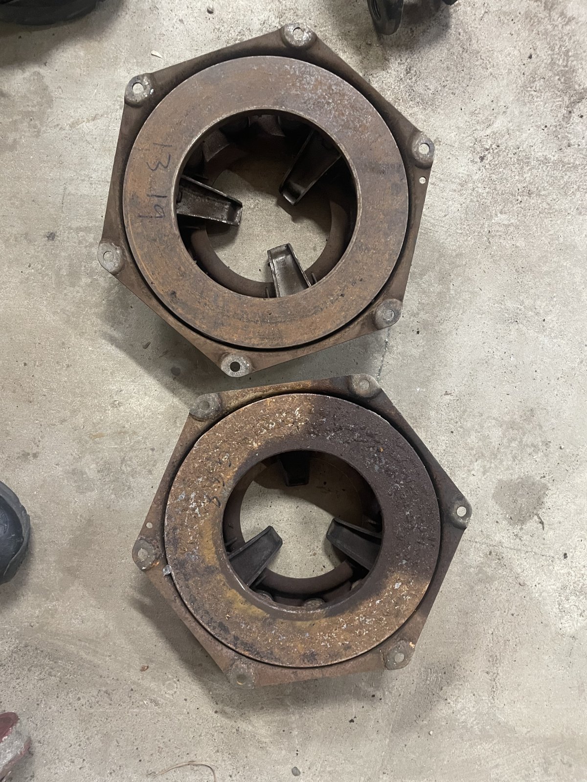

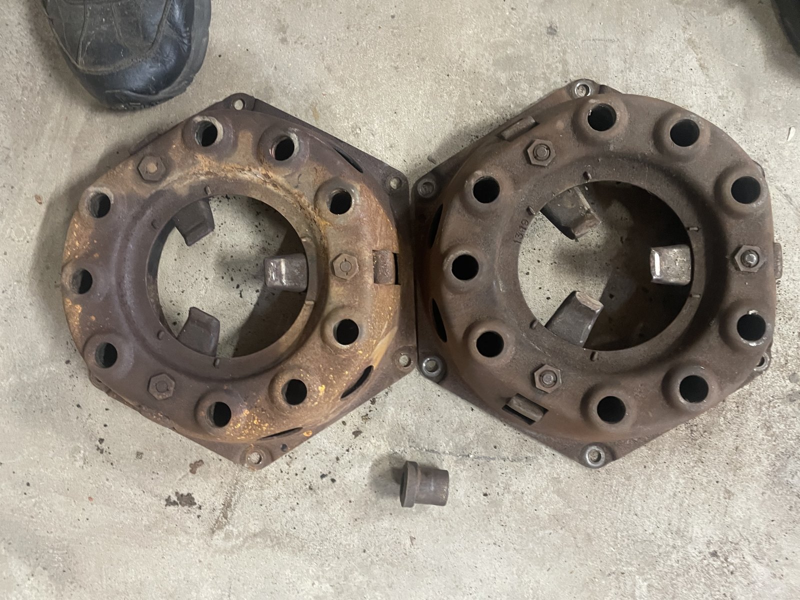

  8. 96EAC584-DD53-4916-AC34-5D2A58DD795F.jpeg Rounding up clutch pieces. looked up a few sbc to flathead threads. Got the instructions from speedway. Instructions say use the 10 inch borg and beck pressure plate.
    I’ve got 2. We have a local rebuilder. These are B&B 1319 and 988. Also had the appropriate pilot bushing and a couple 3 bolt starters in my stack of junk. 96EAC584-DD53-4916-AC34-5D2A58DD795F.jpeg E2882906-B7AF-4363-9D14-33347A1AA0CC.jpeg
    Ive got a 168 tooth FW but not drilled for a 10 inch setup. Just kinda curious why an 11 inch set up wouldn’t work since flatheads also had em.
    Not that big a deal to drill the FW but I might try to locate a 55 chevy one that had the 10inch clutch. The 55 Chevy FW casting number should be 3703870
  9. bobss396
    Joined: Aug 27, 2008
    Posts: 18,752
    bobss396
    Some Chevy truck flywheels take both clutch covers. I run an 11 inch in my car, use a '55 Chevy bellhousing and truck starter.

  11. I guess the plan is to get one of the 10 inch pressure plates rebuilt. Purchase a disc. The trans I’m using has the larger input. 1 3/8.
    The depth of the speed gems adapter would be the only issue fitting the larger set up.
    No reason to waste time trying to make an 11 inch set up work. I’m not racing or towing. Just cruising.
    So the only thing to get handled will be either finding a 55/56 gm flywheel with the 10 inch clutch or drill the one I have.
    We ain’t skeered drilling new holes

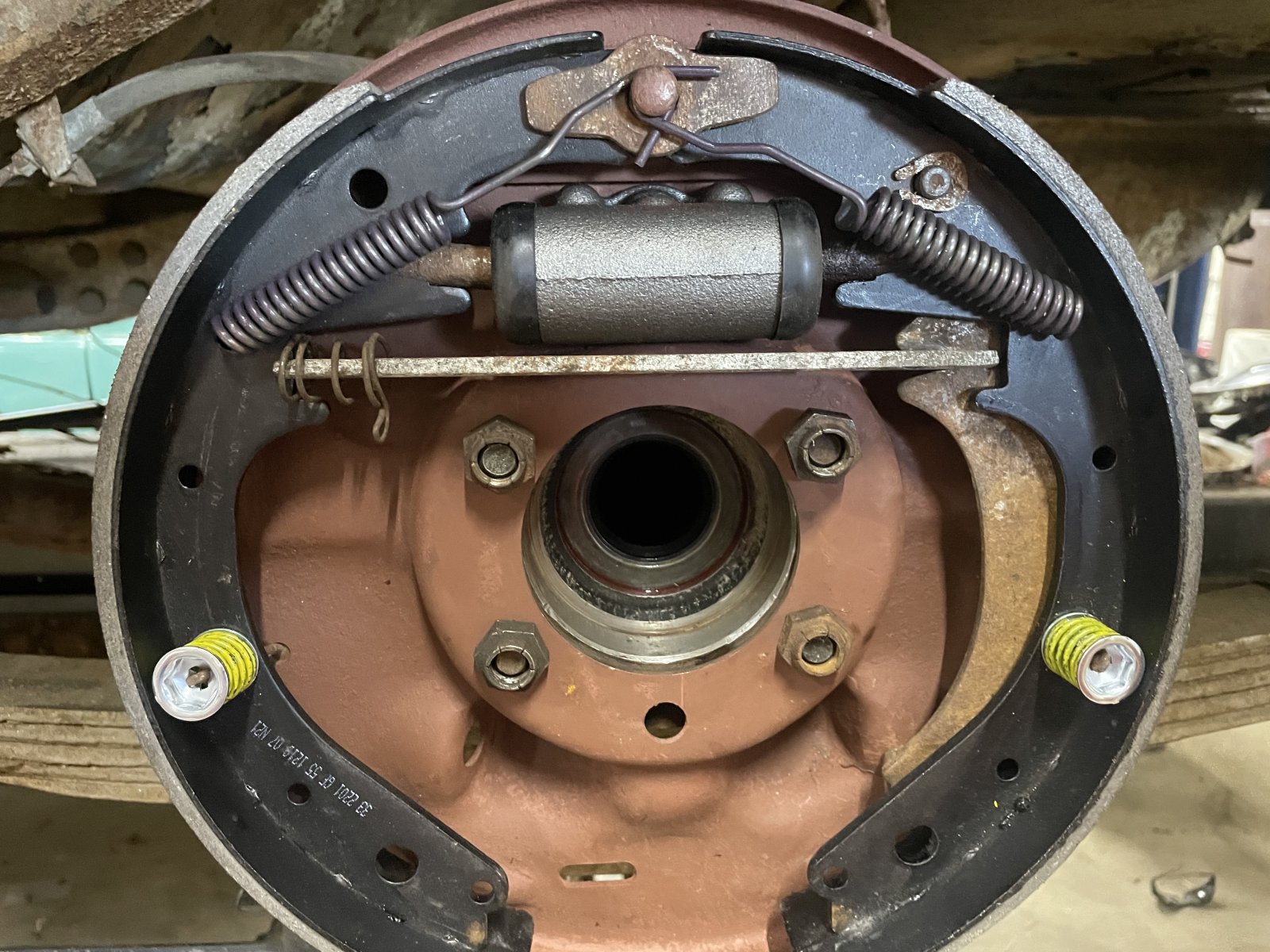

  12. Students started ***embling the rear brakes. The brake hold down pins were wrong. Correct ones will be here tomorrow along with parking brake spreader bar springs
    Parking brake cables have been installed. Adjusters cleaned and oiled.
    new seals installed.
    Got the front suspension cleaned up ready for some paint. We ain’t overthinking this one.
    All of it was in great shape except the king pins.

  22. Bearings cleaned and repacked. New inner seals.
    Got the rest of the brake hardware installed
    nothing fancy. Just cleaning, rattle canning and replacing what’s needed.

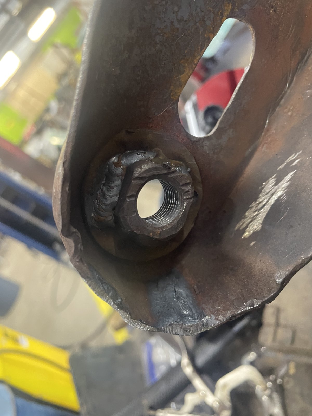

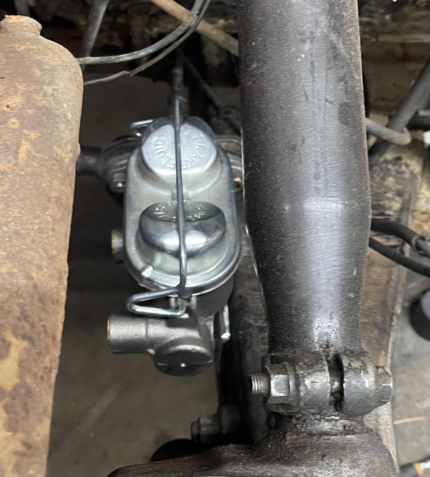

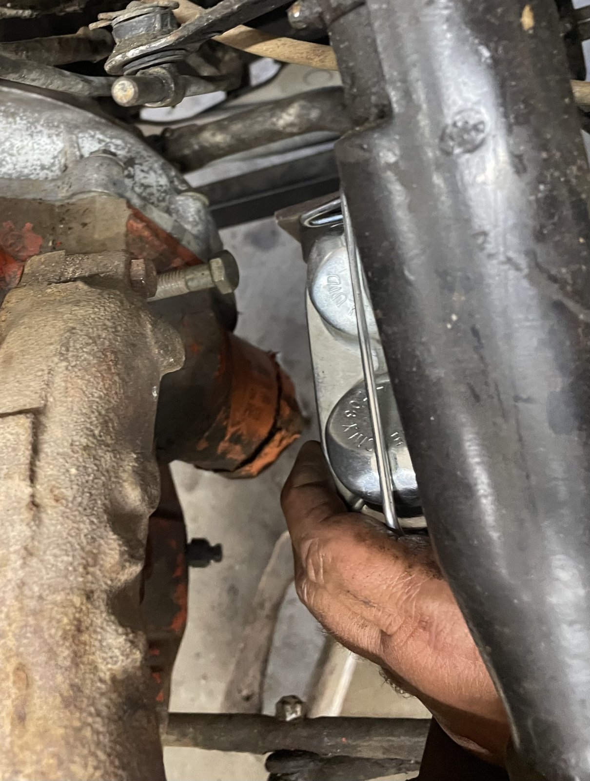

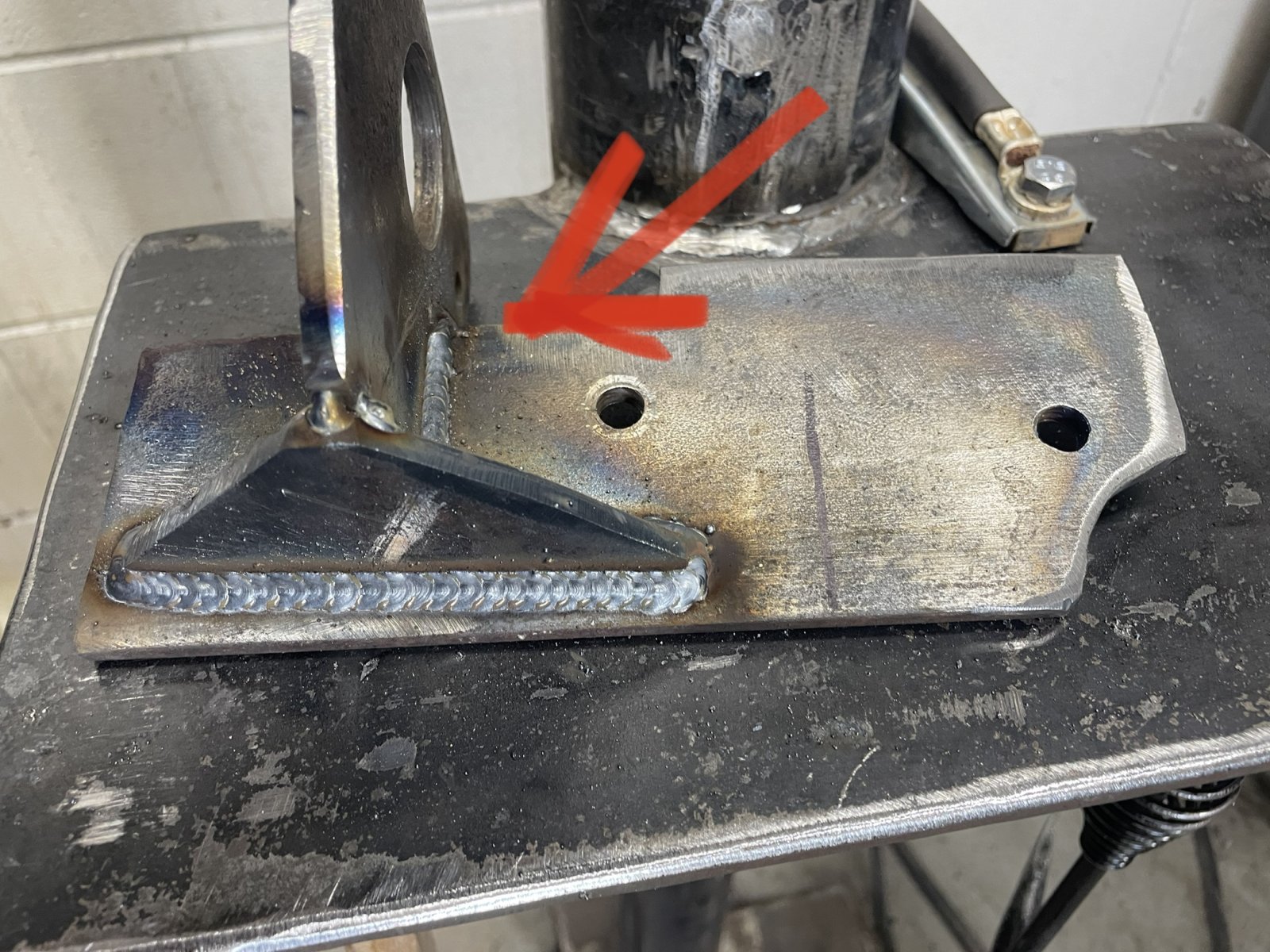

  23. Master cyl mount fab. Welding student doing his thing.
    IMG_1466.jpeg IMG_1467.jpeg IMG_1468.jpeg IMG_1471.jpeg IMG_1472.jpeg IMG_1473.jpeg IMG_1474.jpeg
    plan to add a brace probably here. Or the other side.

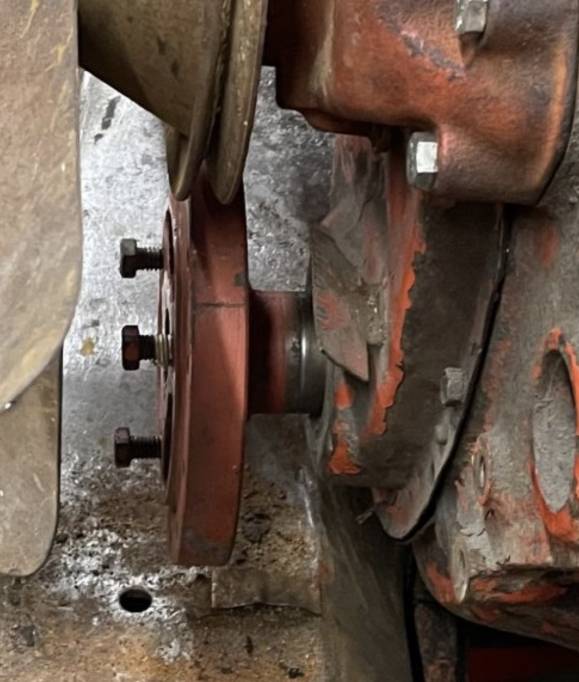

  24. Dumb 283 question.
    I’ve got a couple 283s. One has this small “dampener”
    the other has this one
    I need to get the short pump lower pulley.
    What’s the difference between these two set ups and pulleys.
    I’ve got the timing cover that matches both.
