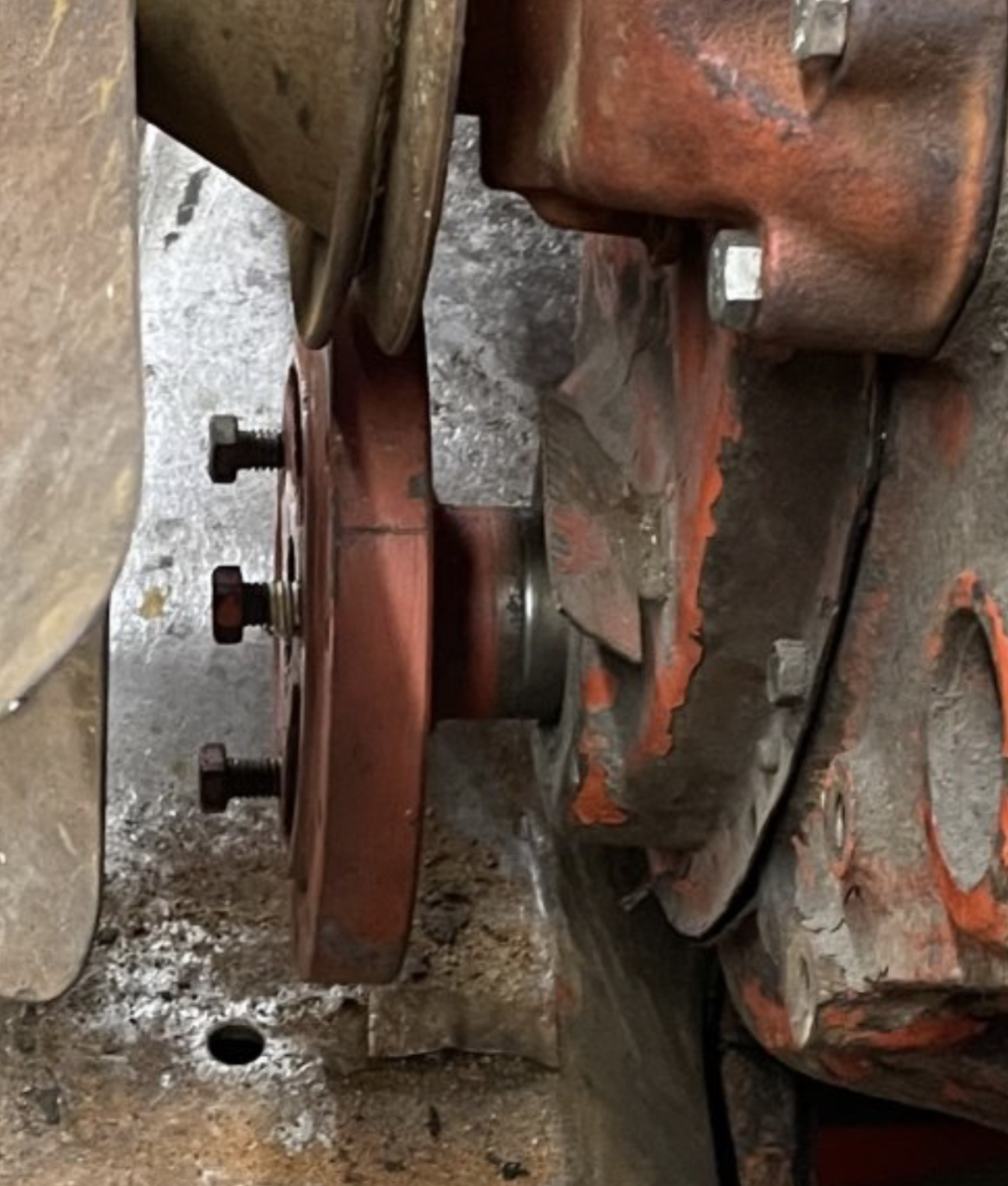

  7. Dropping the core support helped center the radiator and now have plenty of fan clearance. The fan was hitting it. Might have to notch the x-member a tad for a hose.
    the inner fender bolts will be raised the same amount it was lowered. The latch doesn’t bolt to it

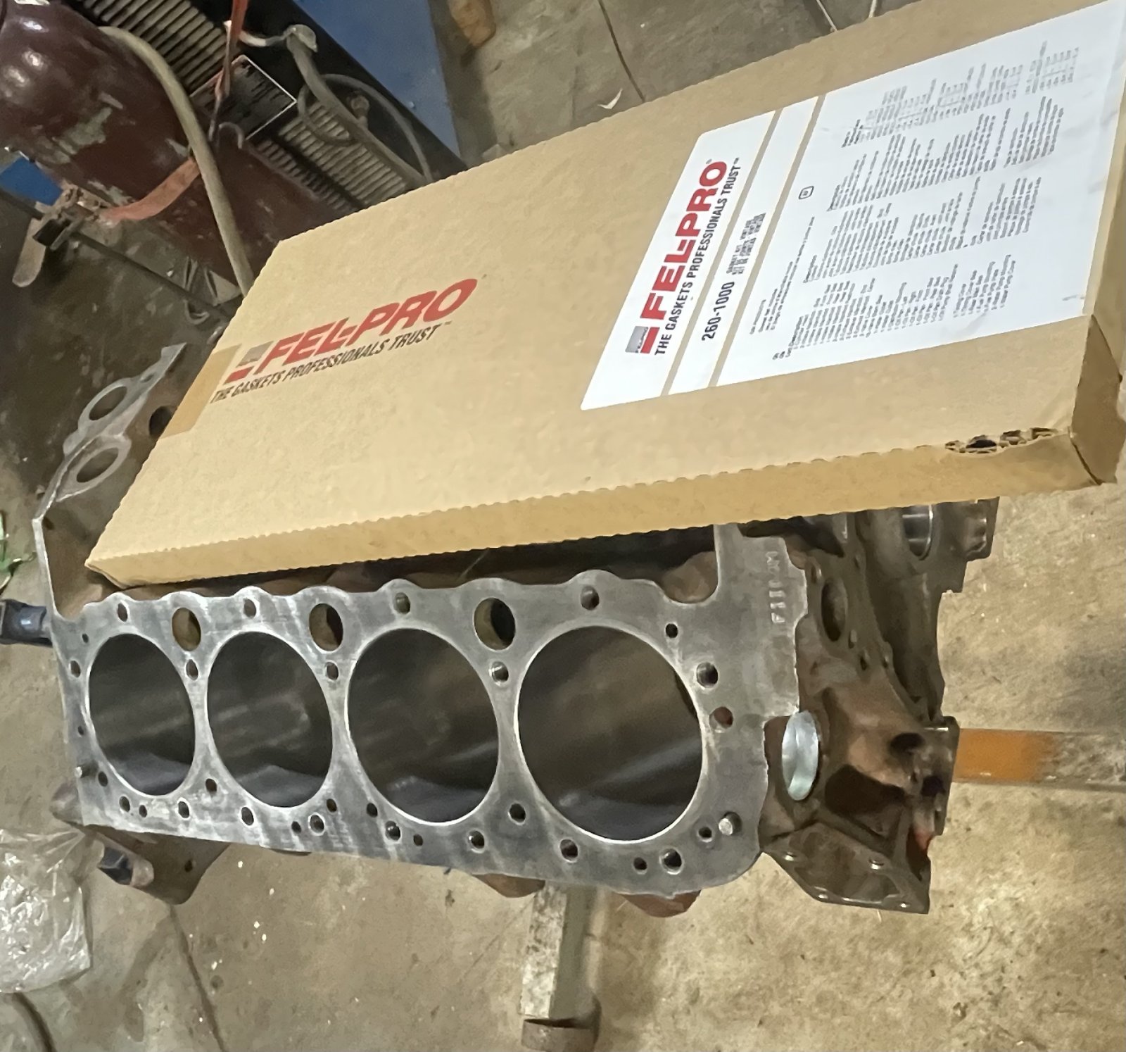

  10. Block and heads back. Just a simple clean and bore. New cam bearings.
    New guides, worked the valves.
    he said he had a better set of PP heads and gave em to me and worked those. Same casting numbers.
    Has a mild port polishing on em. Should be worth .03 hp

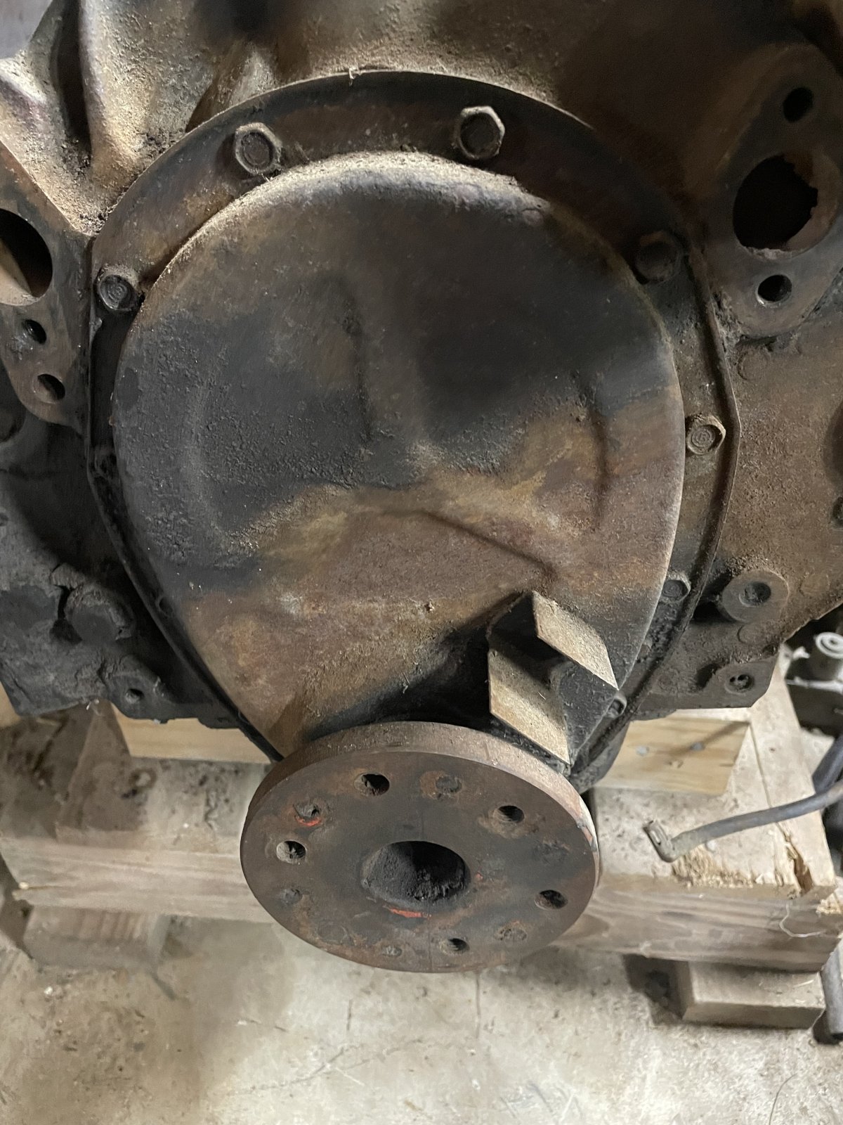

  11. School me on these timing covers.
    I’ve got the dampener that came with the top one.
    Doesn’t mean it’s the correct one though.
  12. Moriarity
    Joined: Apr 11, 2001
    Posts: 37,630
    Moriarity
    SUPER MODERATOR
    the top one is for the long water pump.
  13. Thanks.
    Wont be needing it then.
    Moriarity likes this.
  14. Moriarity
    Posts: 37,630
    Moriarity
    SUPER MODERATOR
    yup with the long pump there is room between the pump and timing cover to shoot the timing light straight down. with the short pump, the back of the pump is right up against the timing cover
    anthony myrick and guthriesmith like this.
  15. guthriesmith
    Joined: Aug 17, 2006
    Posts: 11,971
    guthriesmith
    Pretty sure the one on top is 70’s or 80’s as well? I went through this a while back and think I remember two different TDC locations. I ended up with a mismatch between cover and balancer, but just used a bolt on marker and timing tape on the balancer to correct it. They all work interchangeably...sort of.

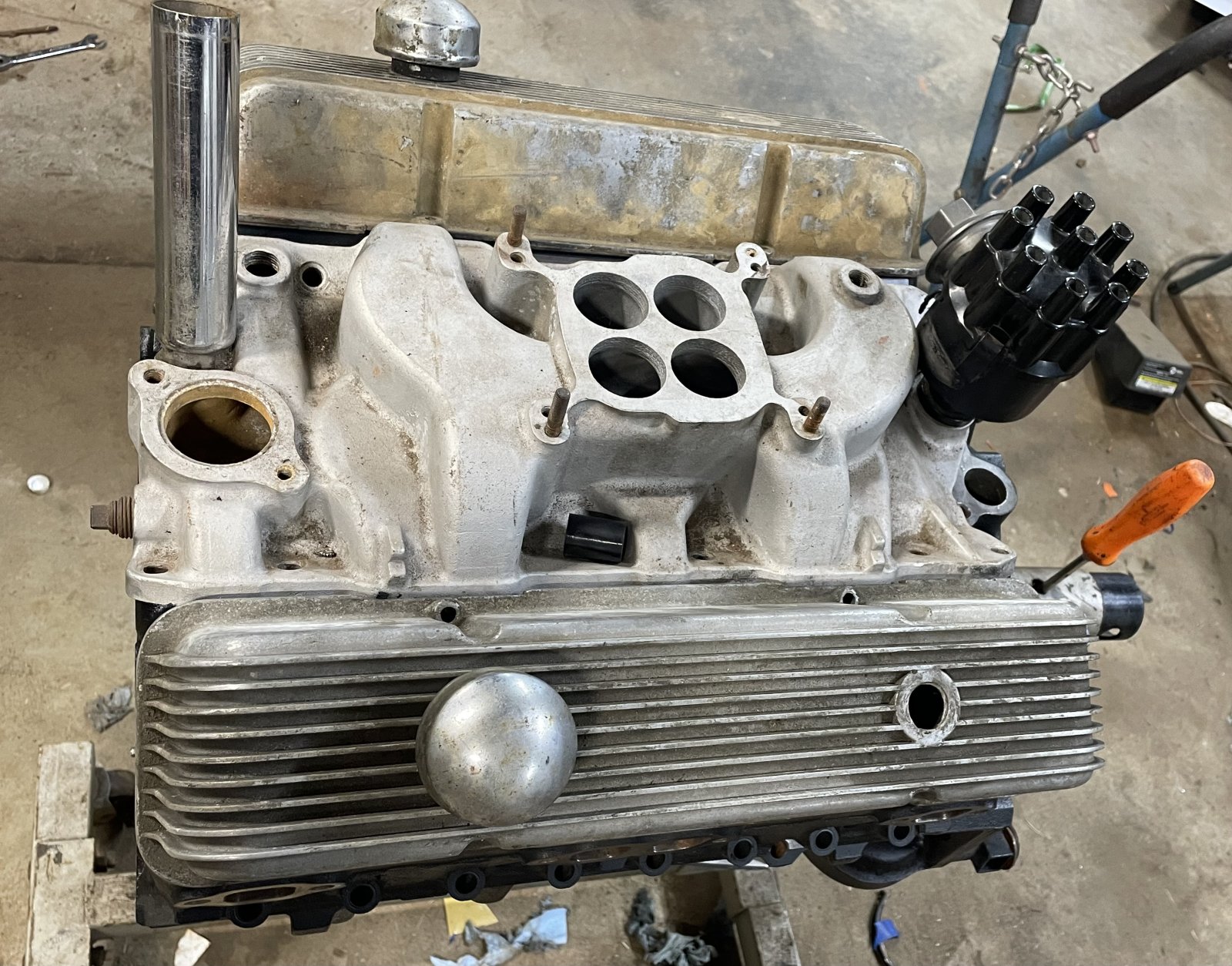

  17. Been busy/slacking lately. Or spinning my wheels in other places.
    About to ***emble this thing. Got to figure out which pieces to clean up and use.
    Script, Cal Custom or Edelbrock covers
    Tri power or single. We ain’t worried which one makes more power.
    that 56 dizzy looks great.
    the flatty in the merc was red.
    Might go that color with this

  21. s55mercury66
    Joined: Jul 6, 2009
    Posts: 4,367
    s55mercury66
    from SW Wyoming
    Cal Custom and the 3x2, is my vote. You could run off the center carb only, if desired.

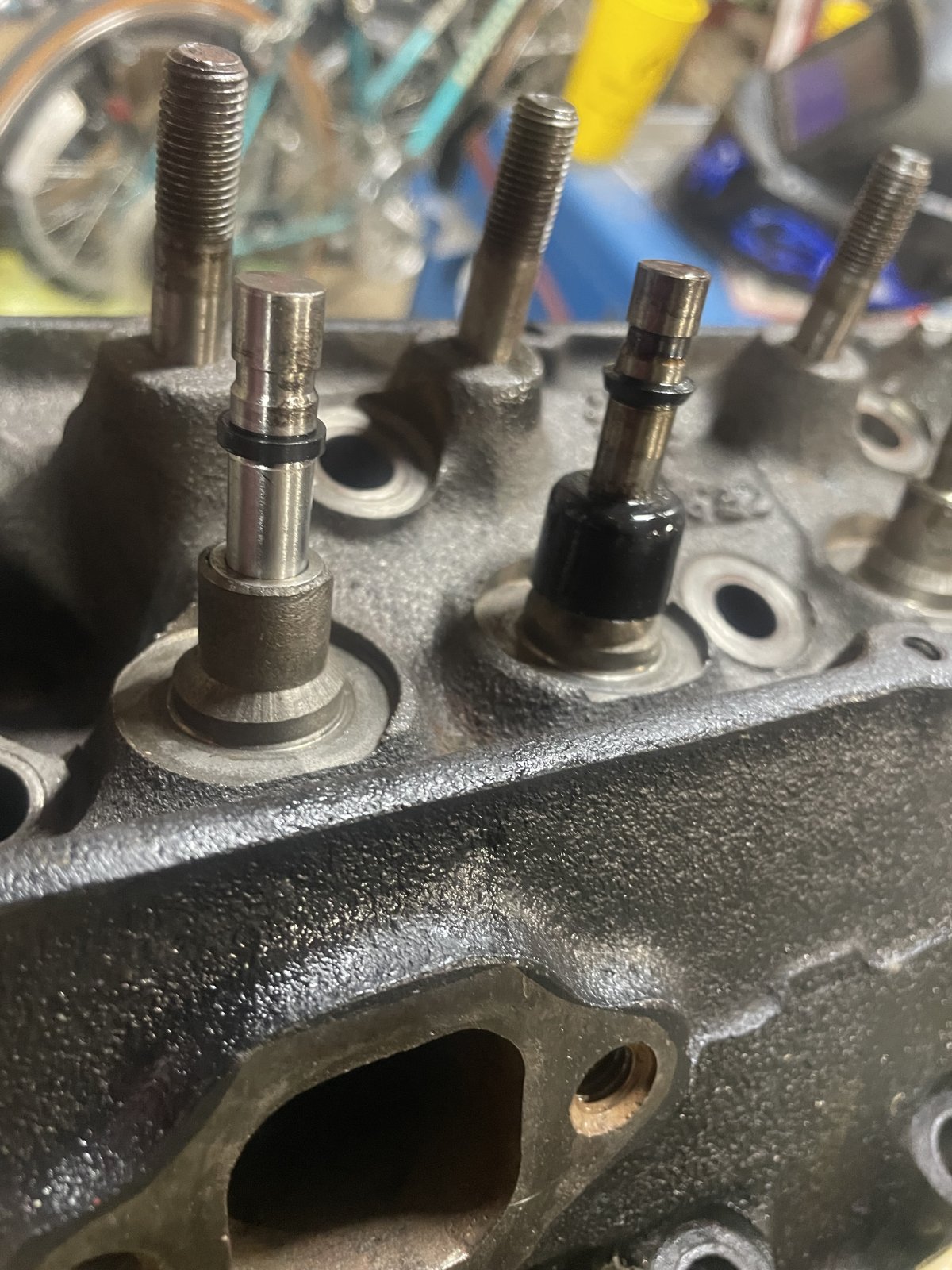

  22. Stupid sbc question of the day
    O-rings with the cups over the springs
    O-rings and umbrella seals no spring cups
    Just umbrella seals if not using the spring cup
    The age old question.
    Or does it really matter.
    Heads were originally o-rings with spring cups
    My other set is no o-rings with umbrellas and no spring cups (single grove valves)
    does it really matter as long as it’s got a seal that goes with or without the spring cup
  23. guthriesmith
    Posts: 11,971
    guthriesmith
    I would say good question... I typically use umbrella seals although the ones for intake and exhaust have been different styles. I don’t think I have ever had the spring cups on anything other than stock stuff that I took apart. Curious what others do.
    Okie Pete and Truckdoctor Andy like this.
  24. Looked up the question
    Read a couple different opinions.
    Same with you on the cups. They’ve only been on older stock engines.
    My 462s don’t have em. They had umbrella or clamp on seals
    Picking up new springs tomorrow and going to ****on these up.
    the umbrella seals I have appear to be the same
    bchctybob, guthriesmith and Okie Pete like this.
  25. I have always used the o’rings only, but I don’t see why you couldn’t use the umbrella seals. It seems like they might do a better job? If my feeble brain remembers correctly, I don’t think I’ve seen a Chevy with umbrella seals. Wasn’t that a Ford thing?
  26. I guess.
    I’m a Ford guy building chevys
    My caddy came with em with the spring kit. The clamp on style caddy used wouldn’t clear the heavy duty springs
    Truckdoctor Andy, SS327 and Okie Pete like this.
  27. SS327
    Joined: Sep 11, 2017
    Posts: 3,926
    SS327
    If the valve stems are groves for o rings then use them only. If no, then use the umbrella seals. I was a Buick heavy duty mechanic.
    bchctybob and anthony myrick like this.
  28. Moriarity
    Posts: 37,630
    Moriarity
    SUPER MODERATOR
    Many people make the mistake of putting the o rings on the valve and then installing the spring and retainer etc. most of the time the o ring gets cut when the spring gets pushed over it. first install the spring and retainer, compress until the o ring groove is visible, install the o ring and keepers and release the compressor....
