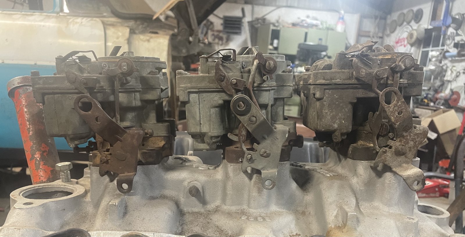

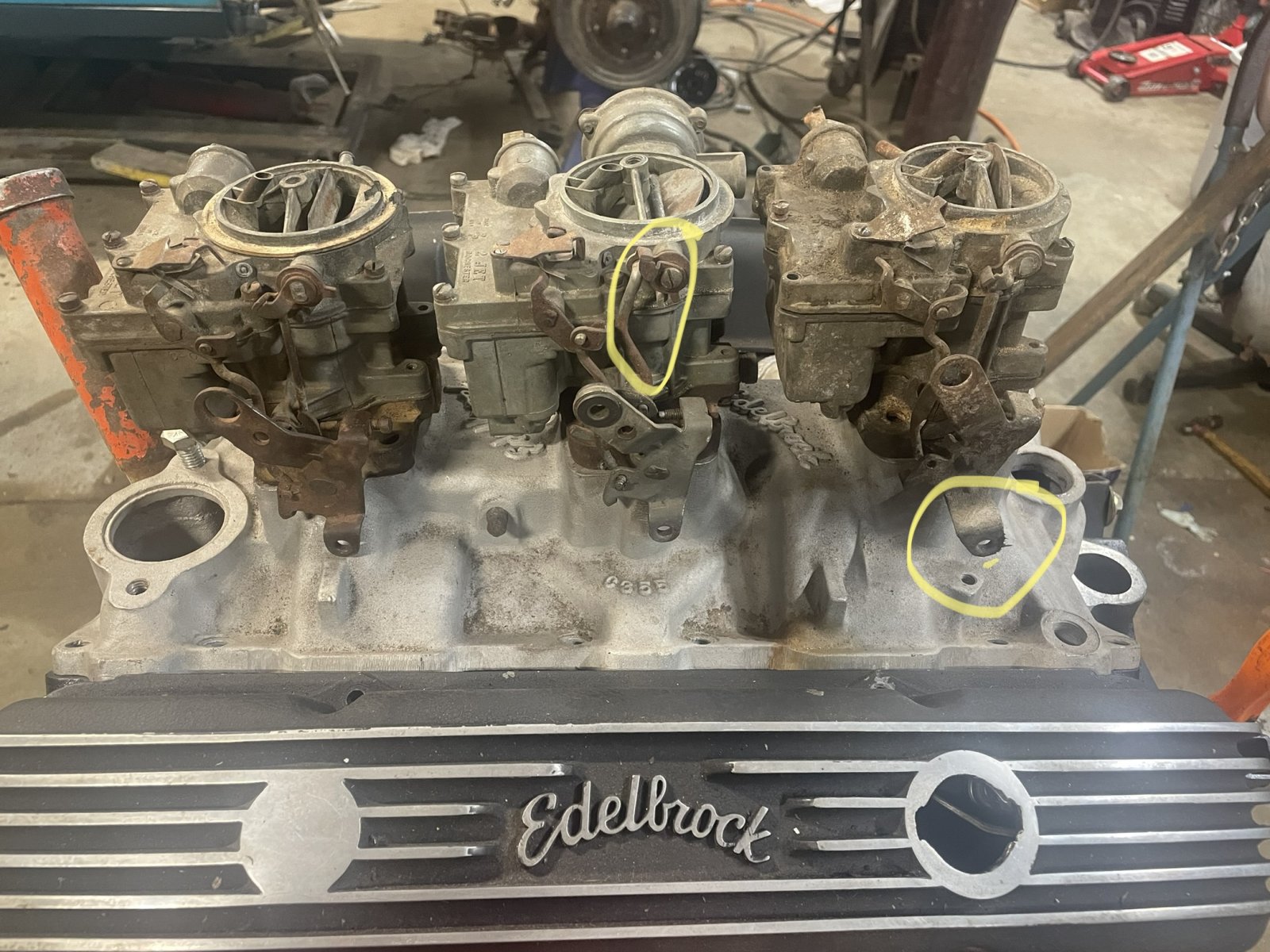

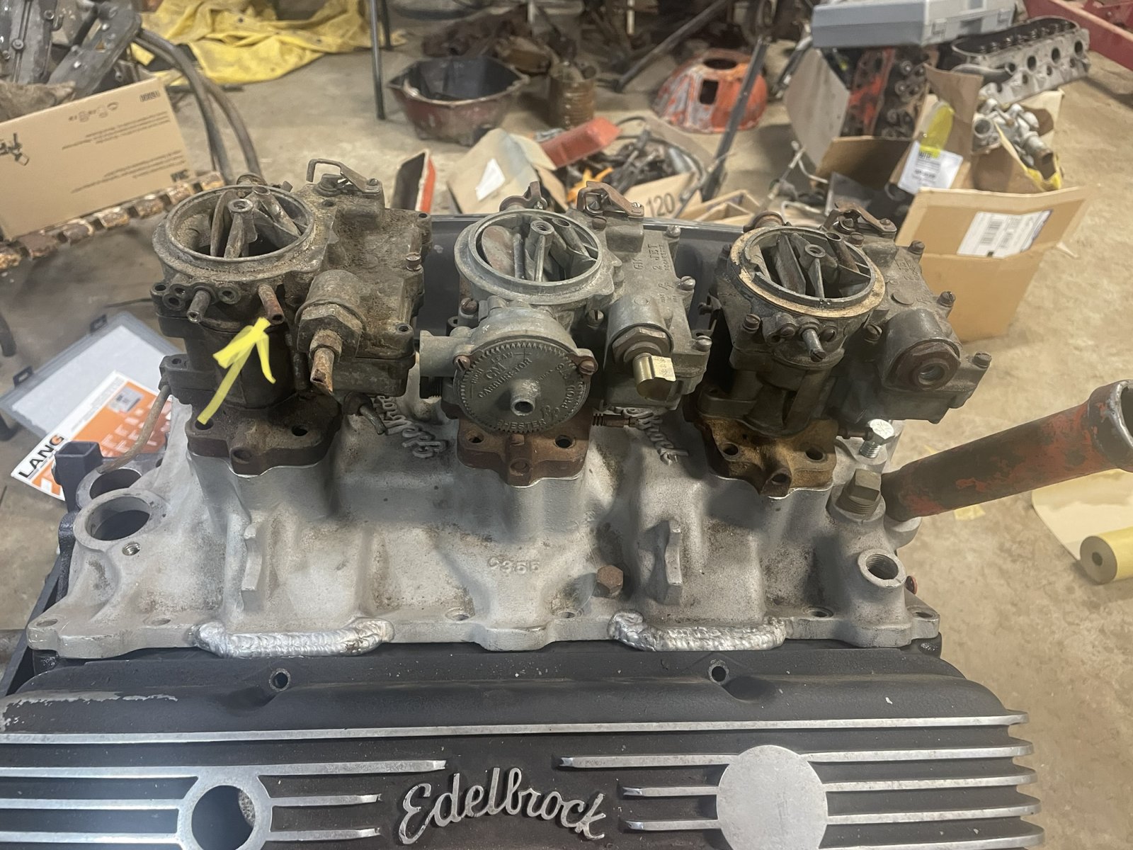

  7. Picked up a couple carbs at lloydfest.
    The center one seems to be in the best shape.
    There are some linkage differences.
    the rear carb linkage is an ez fix.
    The center one shouldn’t affect a thing.

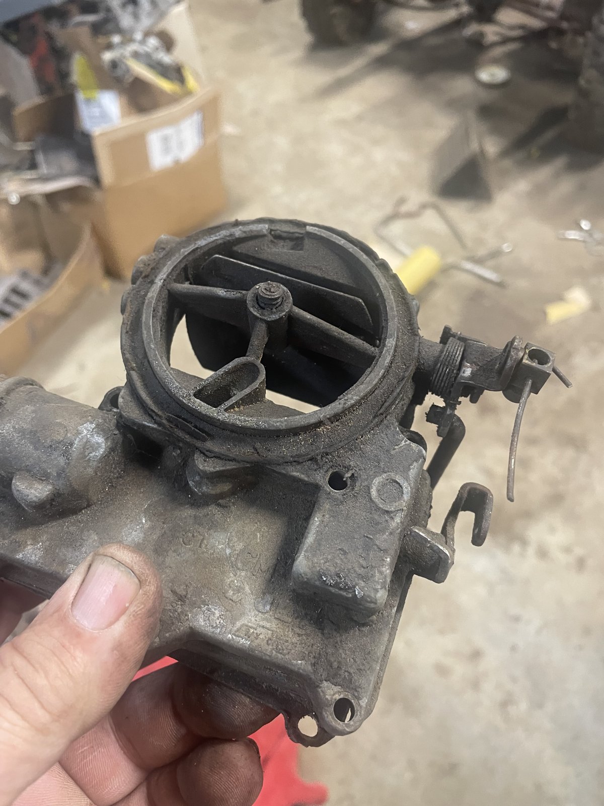

    I can remove and plug this vacuum port
    Ive got this manual choke top. I’ve got all the pieces with it.
    shouldn’t make a difference, should it?
    Other than the visual

  9. Yep.
    Closest I’ve got to a “matched” set

    For some stupid reason I think it may not work. Bowl venting or accelerator pump?
  11. The manual top does have a hole
    I’ll clean em all up and check

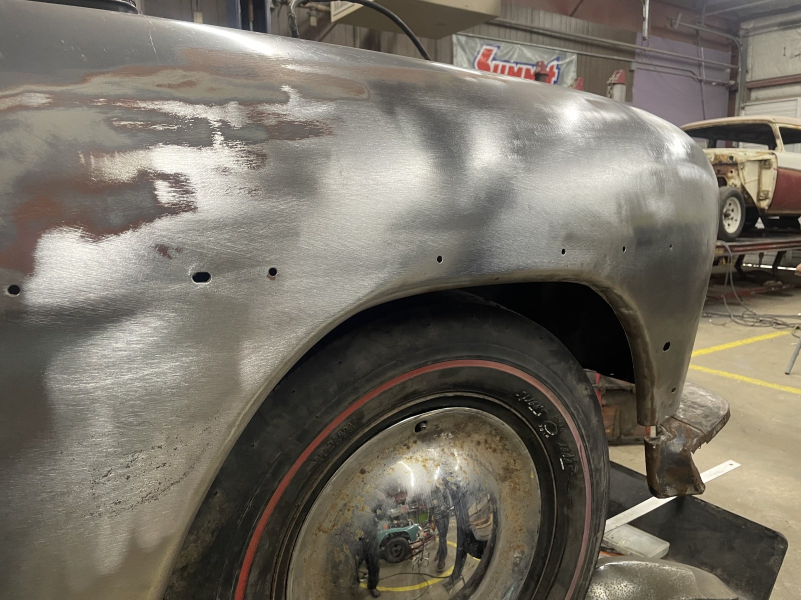

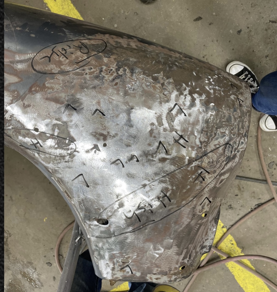

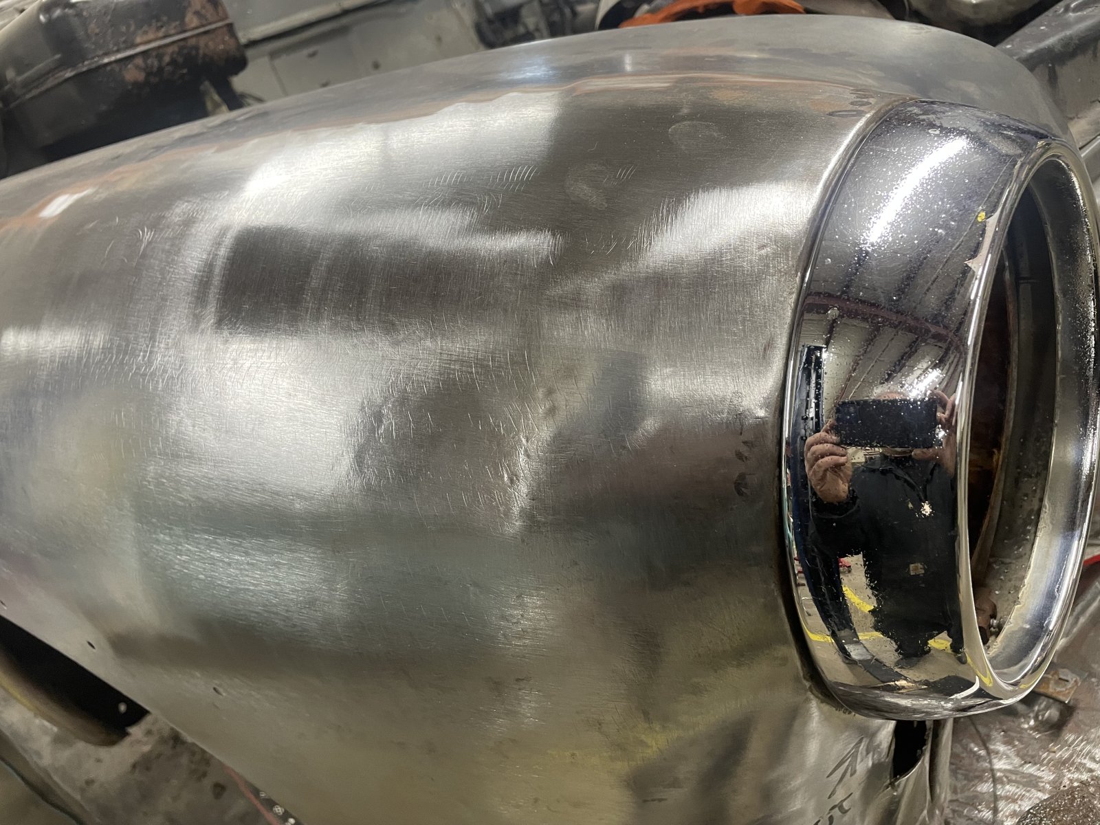

  18. Wish I had a good before pic on the fender. Previous owner pounded on it with a ball peen and the headlight area was pushed in. Plus some previous filler work.
    This was during the straightening and pulling
    This is after being roughed out

    That is amazing!
    ffr1222k and anthony myrick like this.

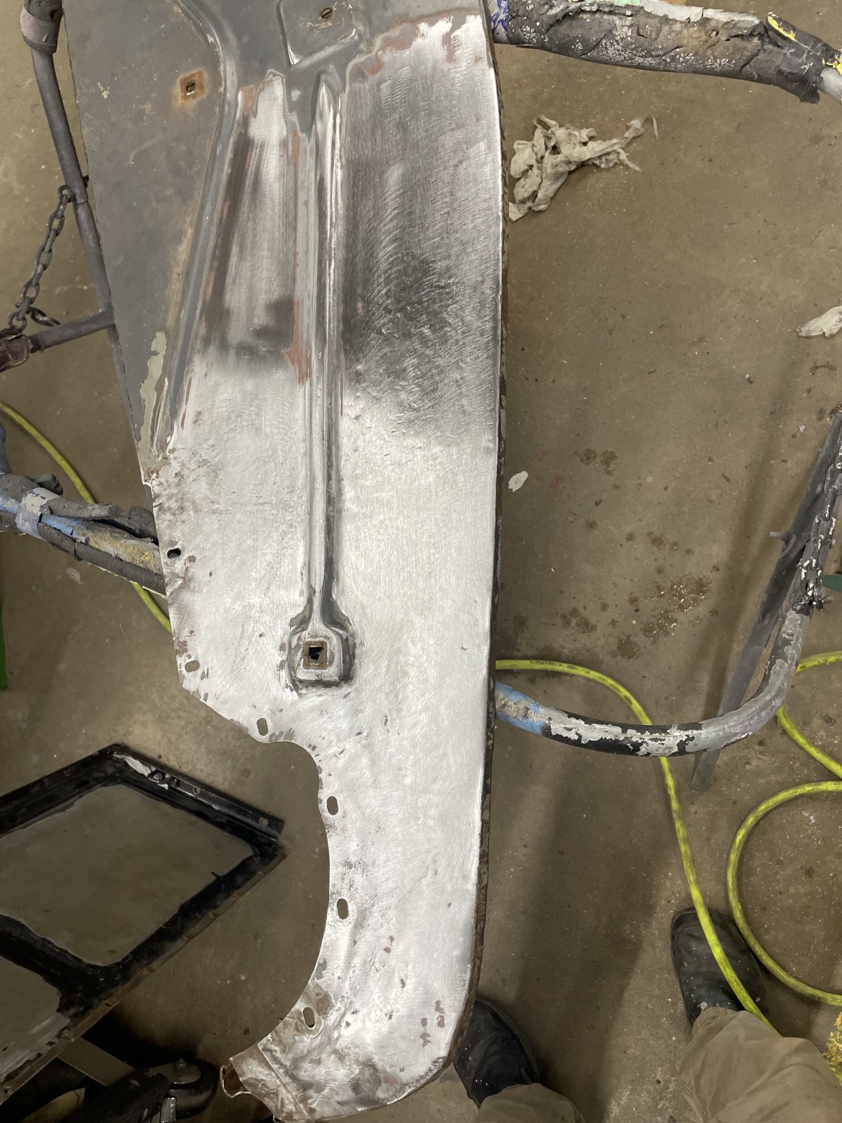

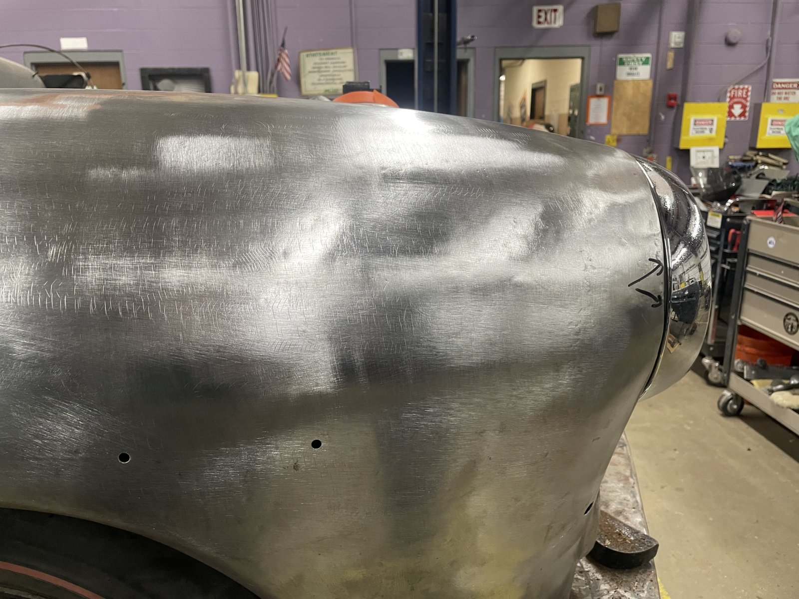

  20. Before-after. Still haven’t touched it with a file. Has a couple areas that might get it. The grinding marks are from the previous repair. All hammers (a small ball peen mostly) and a shrink disc.

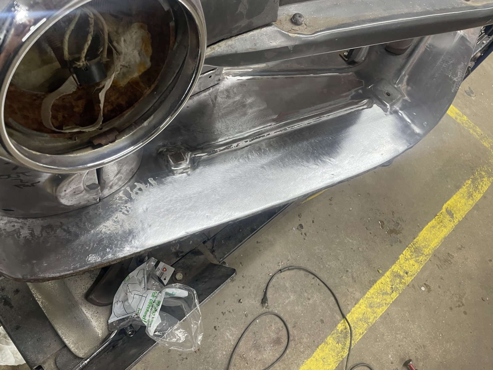

    we had it close at the end of last school year but yesterday we fine tuned and fit the headlight bucket.
    The trim under the headlight and the blinker ***embly was a job to re-shape the fender to fit.
    I’ve got a 51 parts car. I didn’t realize subtle difference between early 51s and later 51. The parts car had the early style flathead trans the other had the style used until 64. The parts car headlight buckets are aluminum with a pot metal ring. The other had steel buckets with a stamped ring.

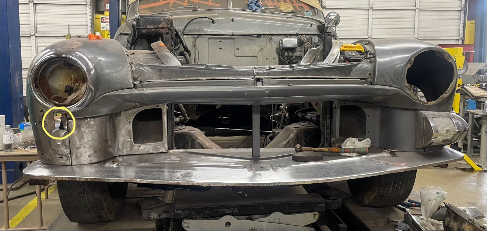

  27. We replaced a headlight bucket and trim ring. Fixed the rest. Not bad for an old wreck. Have one small piece to fab under the headlight. IMG_6422.jpeg
