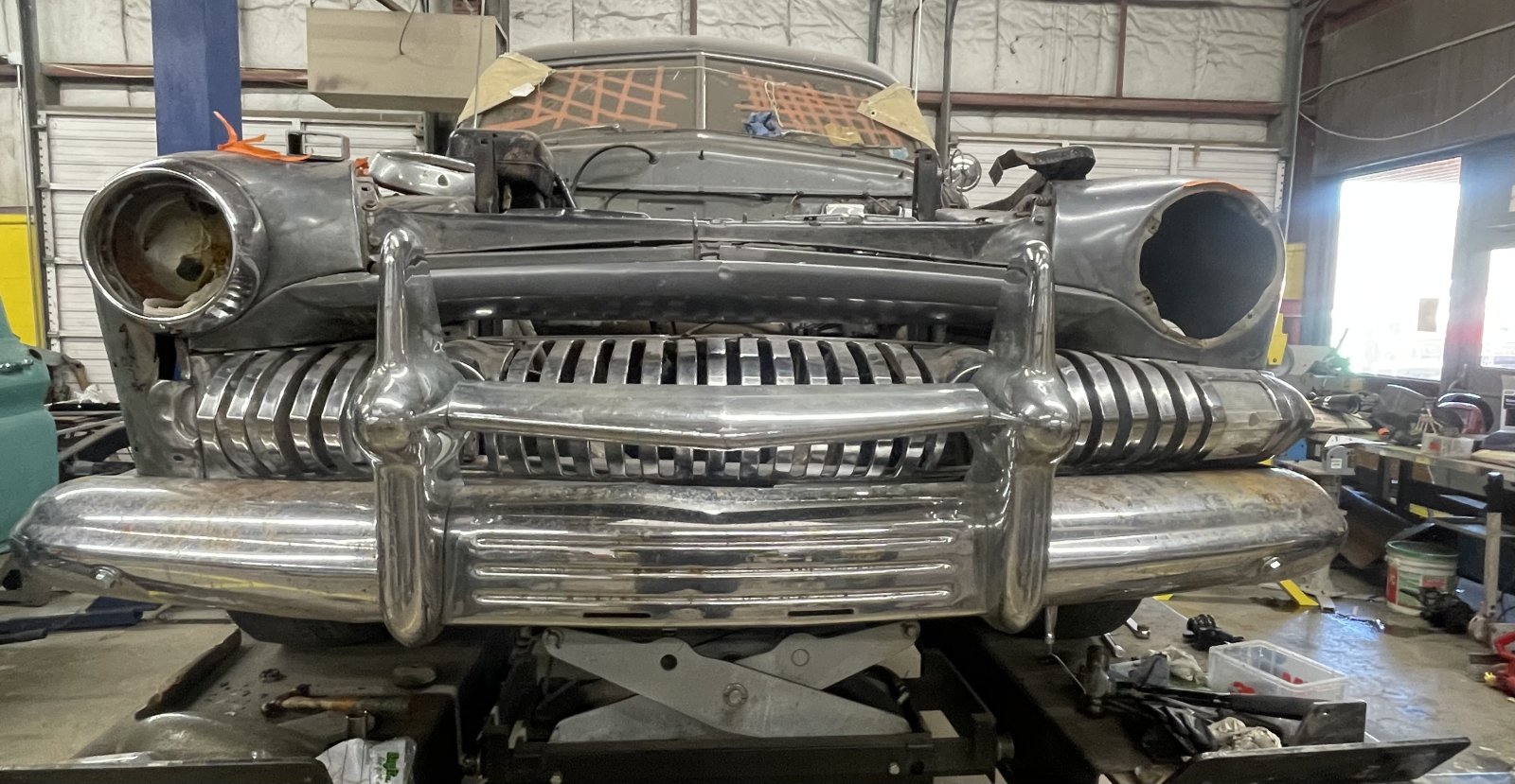

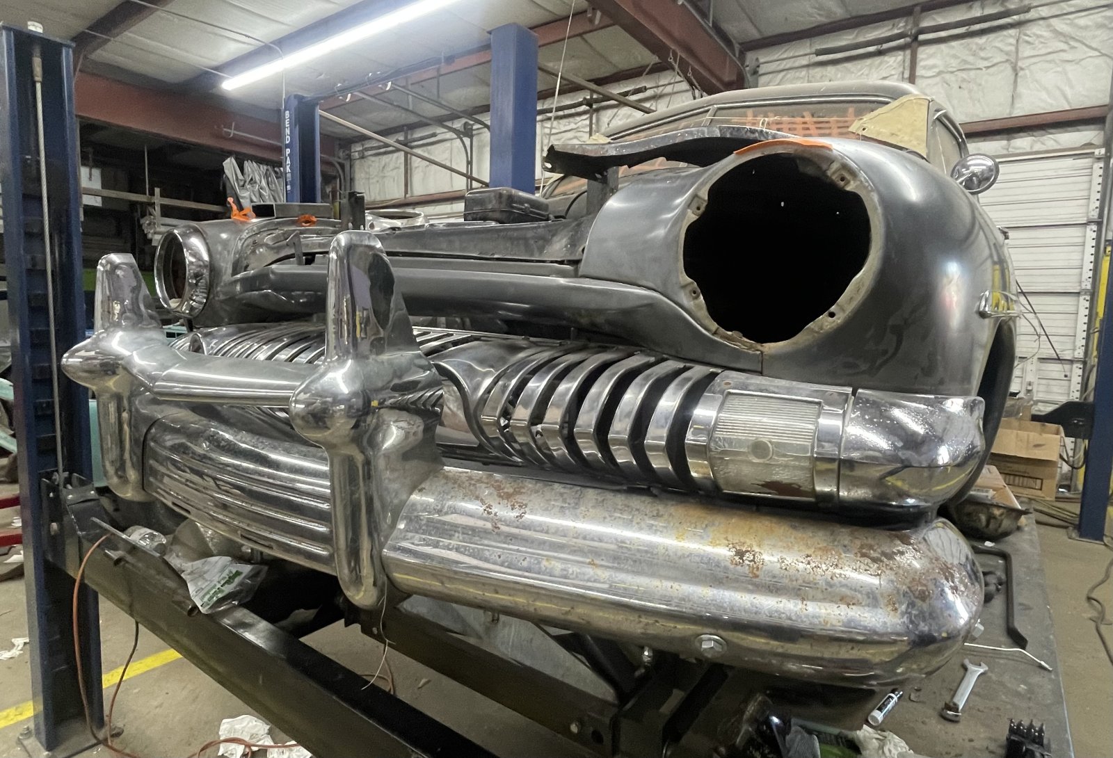

  4. I like this ugly bumper set up
    got to work out a twist on the p***enger side

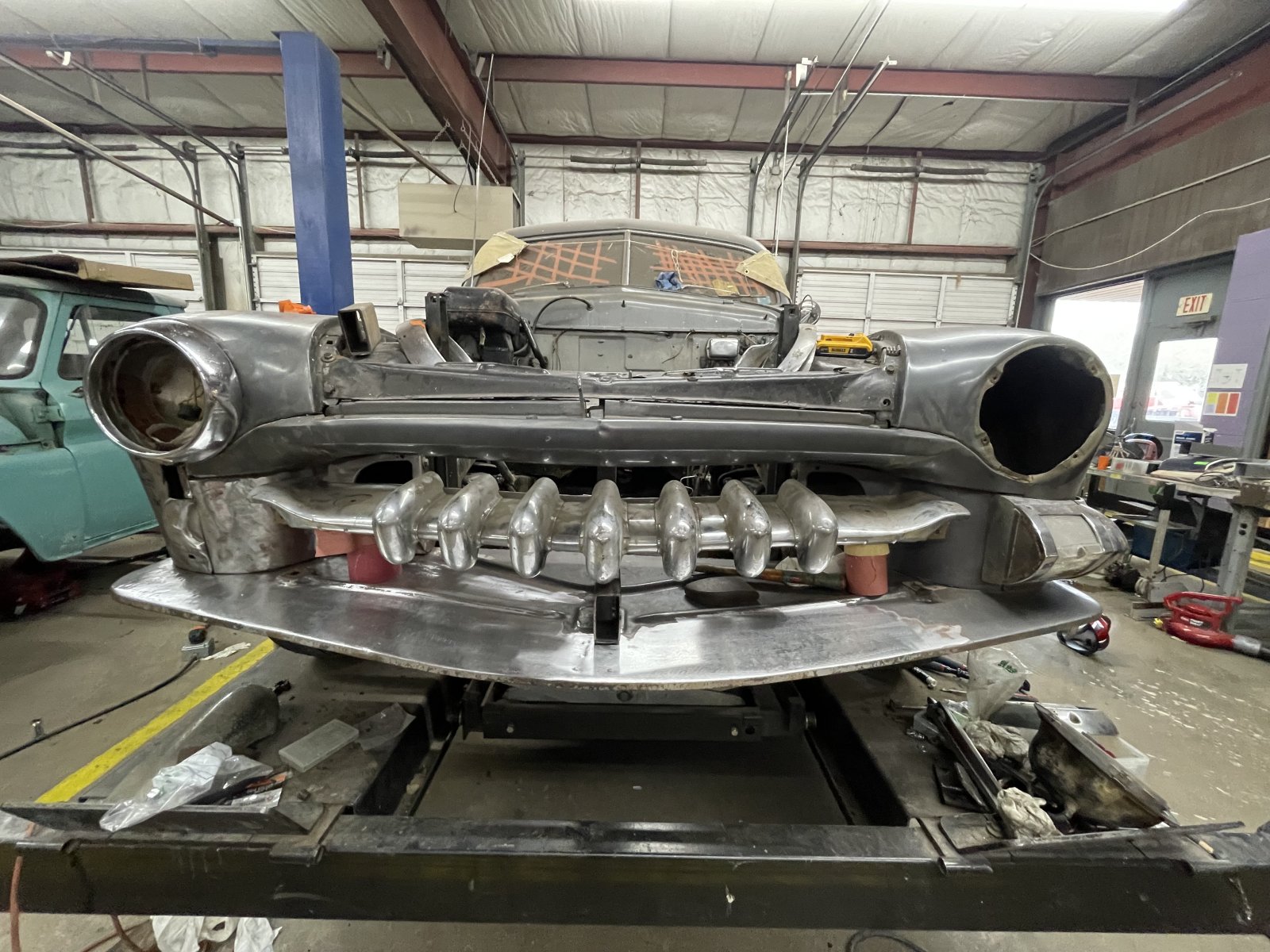

  7. The original one we had to straighten from the wreck.
    The other bumper donated it’s brackets.
    We just about got it straightened.
    One small patch for the fender under the headlight and we’re gonna body work and prime the fender and apron.
    A small repair on the rear body as well.
    Probably straighten the rear bumper in our press next week
    the grill was bent and twisted. It’s getting closer as well

  8. Oh, and wanted to see what the other, less gaudy bumper looked like.
    I guess I’m leaving this one with the ugly bumper.

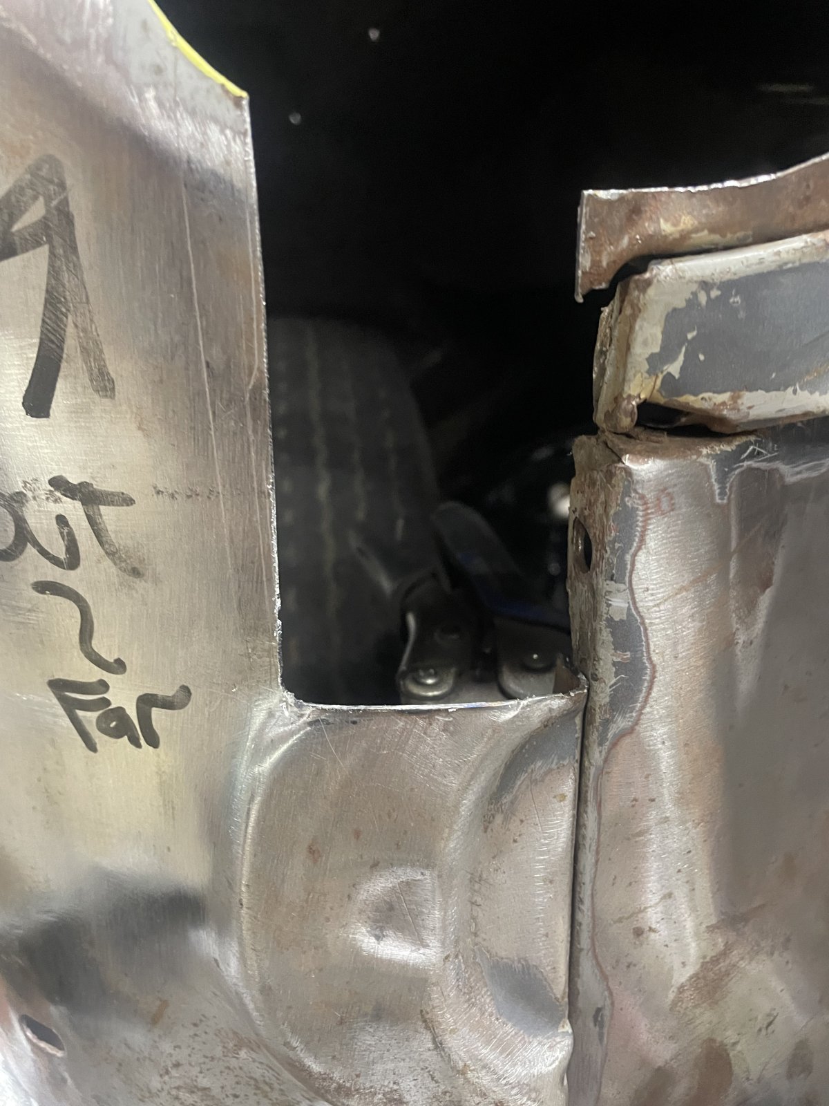

  10. Had a rotted spot under the headlight on the damaged fender.
    Students made a template then we made a patch

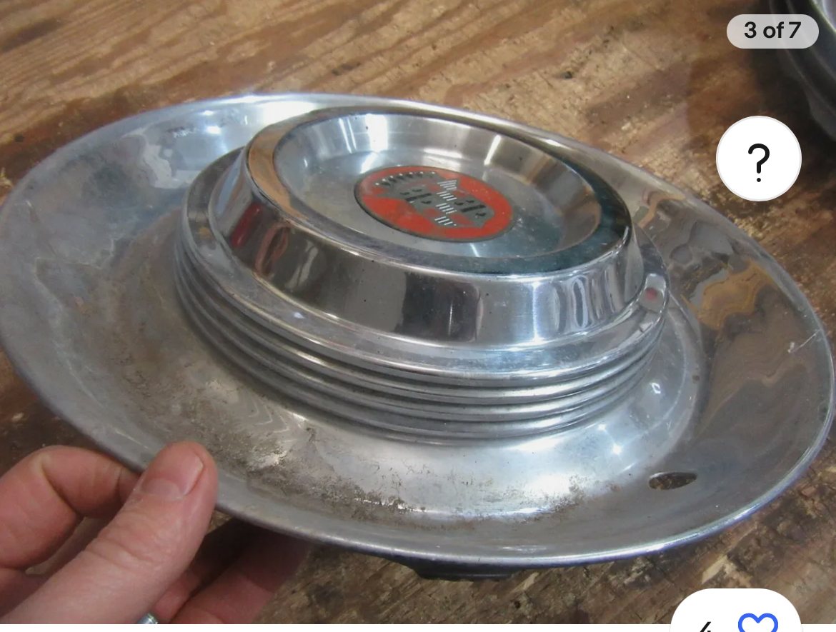

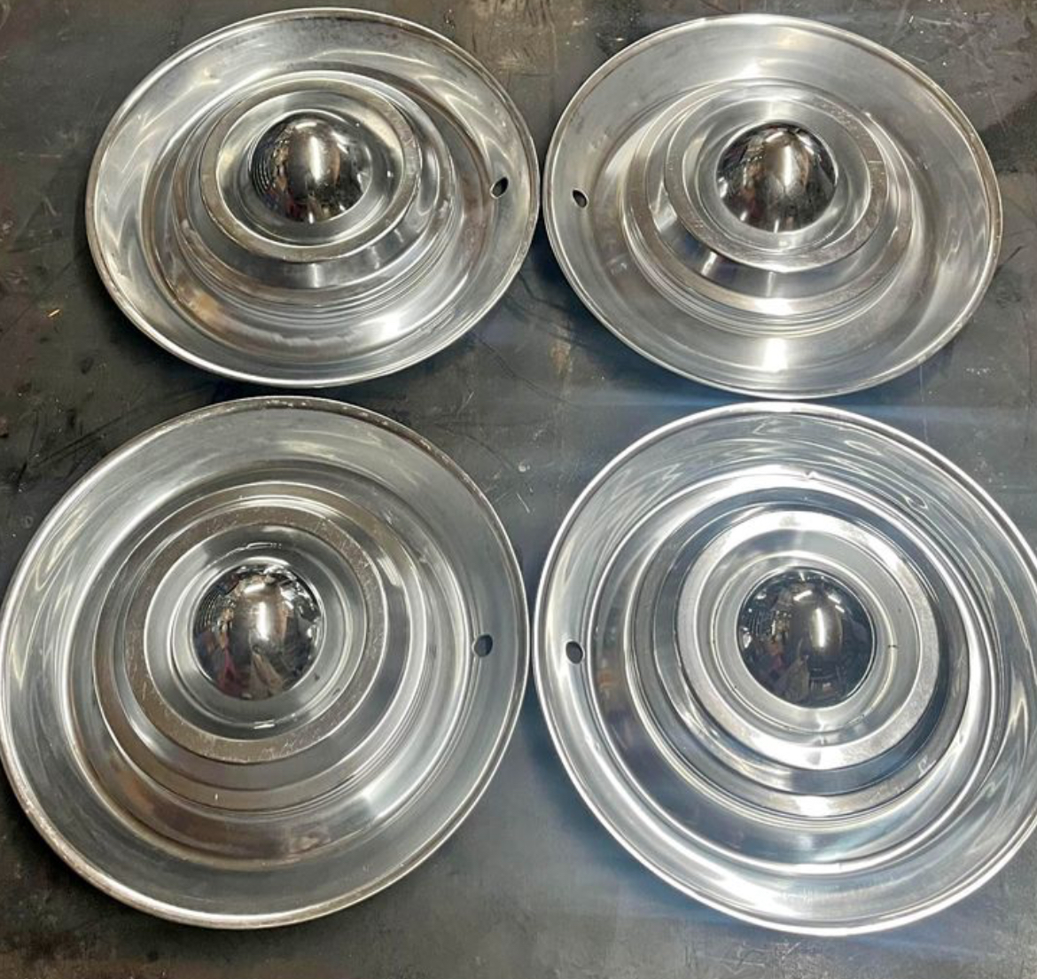

  18. These hubcaps popped up. 15s look kinda cool
    might pull the trigger

    Those hubcaps are neat, but I wonder how deep your wheel needs to be for them to seat? That base cap looks really familiar, I'm trying to place it. I know I've had issues with hubcaps that wouldn't fit on certain steel wheels because the caps would bottom out on the center of the wheel before seating on the outer rim.
    If they're local, I'd bring one of your intended wheels over and snap it on first, to make sure they'll go.
    ffr1222k likes this.

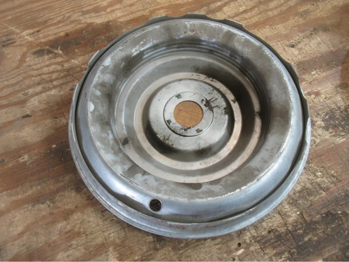

  21. Mine has OE merc wheels. A regular caddy sombrero fits with the dog dish looking mount removed. Looks like these mount on the outer rim instead of like the other ones I have.
    Internet pic
    This HAMB pic has them on a standard Chevy wheel

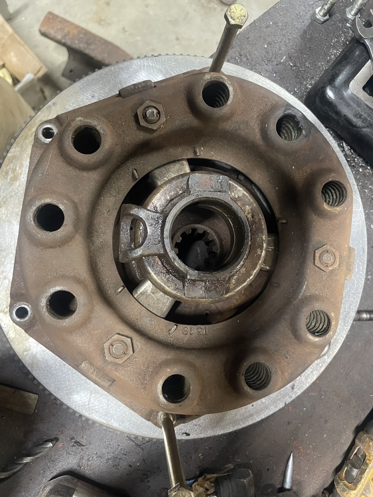

  22. Acquired a truck load of old transmission junk. There was a very nice Chevy FW with the Borg and Beck bolt pattern
    SBC FW with the merc clutch.
    The merc input has some wear on it
    need a new pilot bushing for the adapter. No big deal.
    the pile of transmission parts should yield 2 gm OD 3 speeds.
    One Muncie and one Saginaw.
    Also had a new pressure plate and disc for a gm trans in the parts pile.
    I’ve got a bell bor both small and large gm FW.
    Was kinda thinking about using a gm trans. It’s already set up for the Merc trans. Would have to add a slave cyl set up and handle the drive shaft.
    Hmmmmmmm

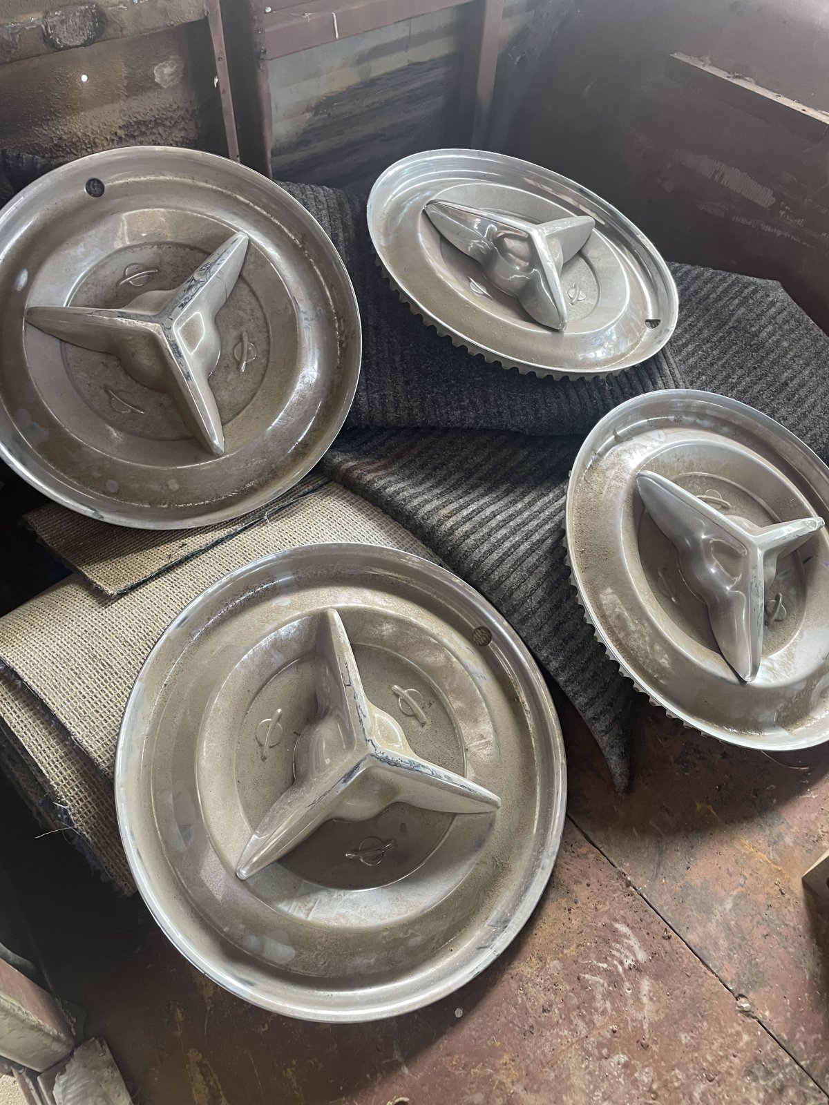

  26. Not sure
    Washed em off.
    15s. Not perfect.
    Fine for me
  27. I'm sure I'll get corrected if I'm wrong, but I believe the Saturn was only on true Olds hubcaps. I'd run them!
