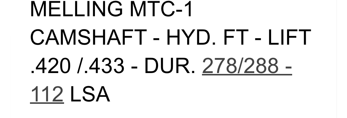

  3. Is the cam for your 283? What are the specs?
    nothing special. Just a simple cam.

  7. That’s the same cam I put in my 350. I like it very much, it really woke up the engine. I believe it’s the same specs as the Edelbrock Performer Cam. I wouldn’t be surprised if Melling made it for Edelbrock.

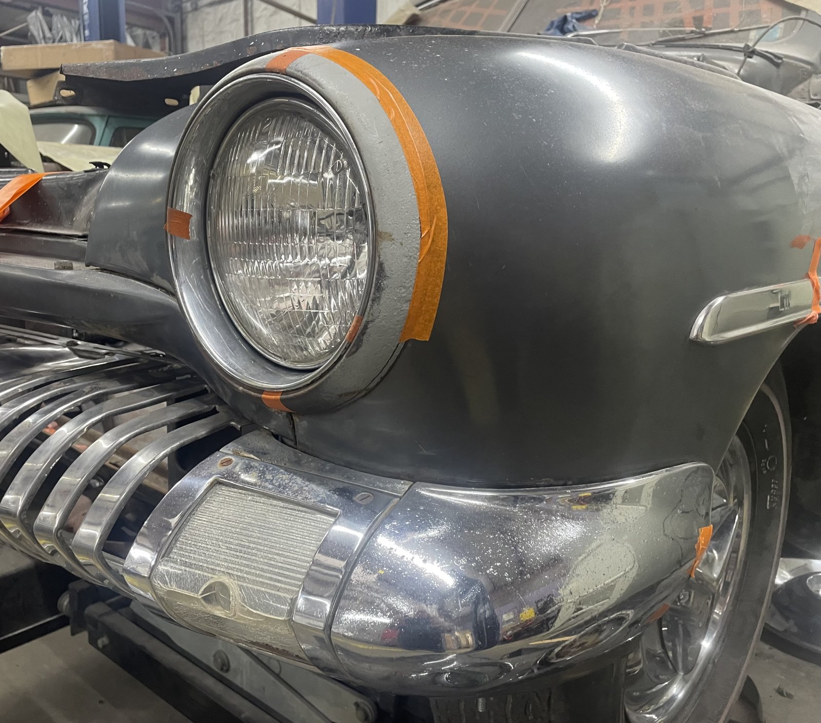

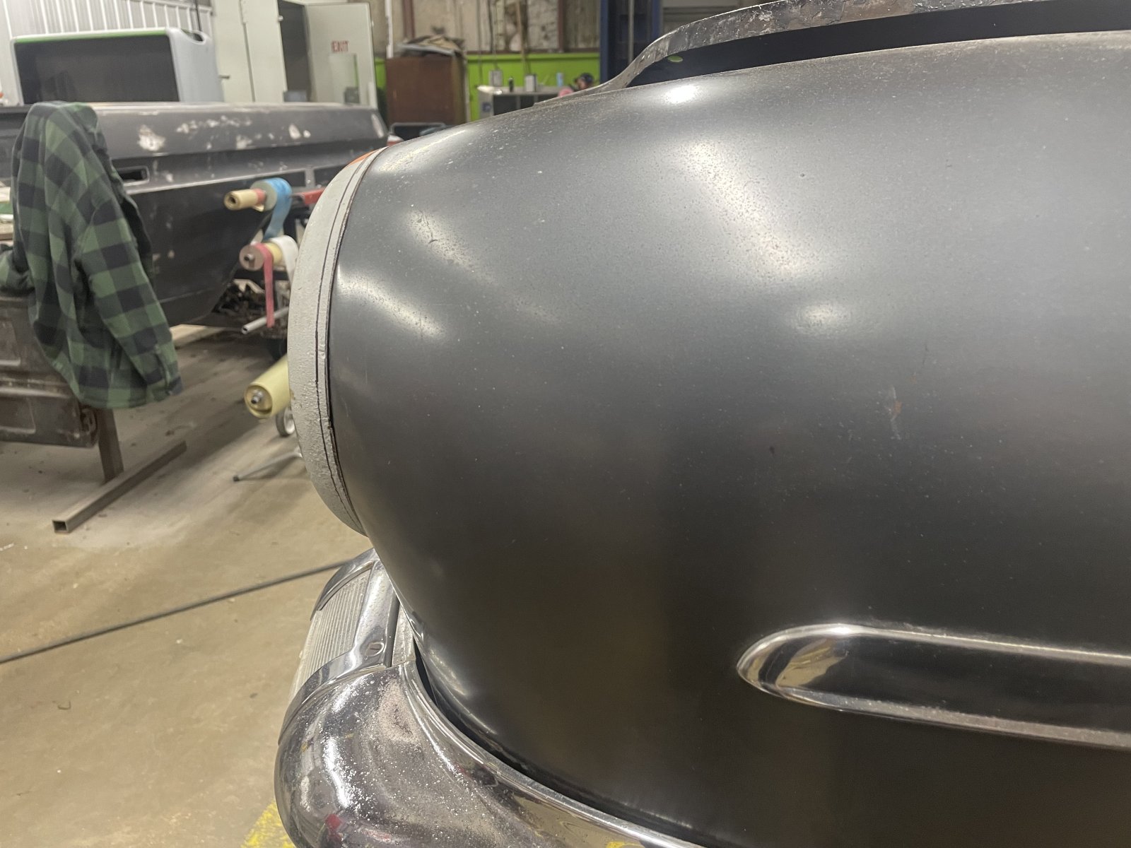

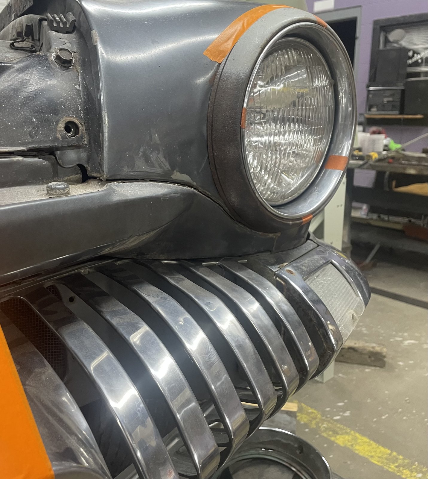

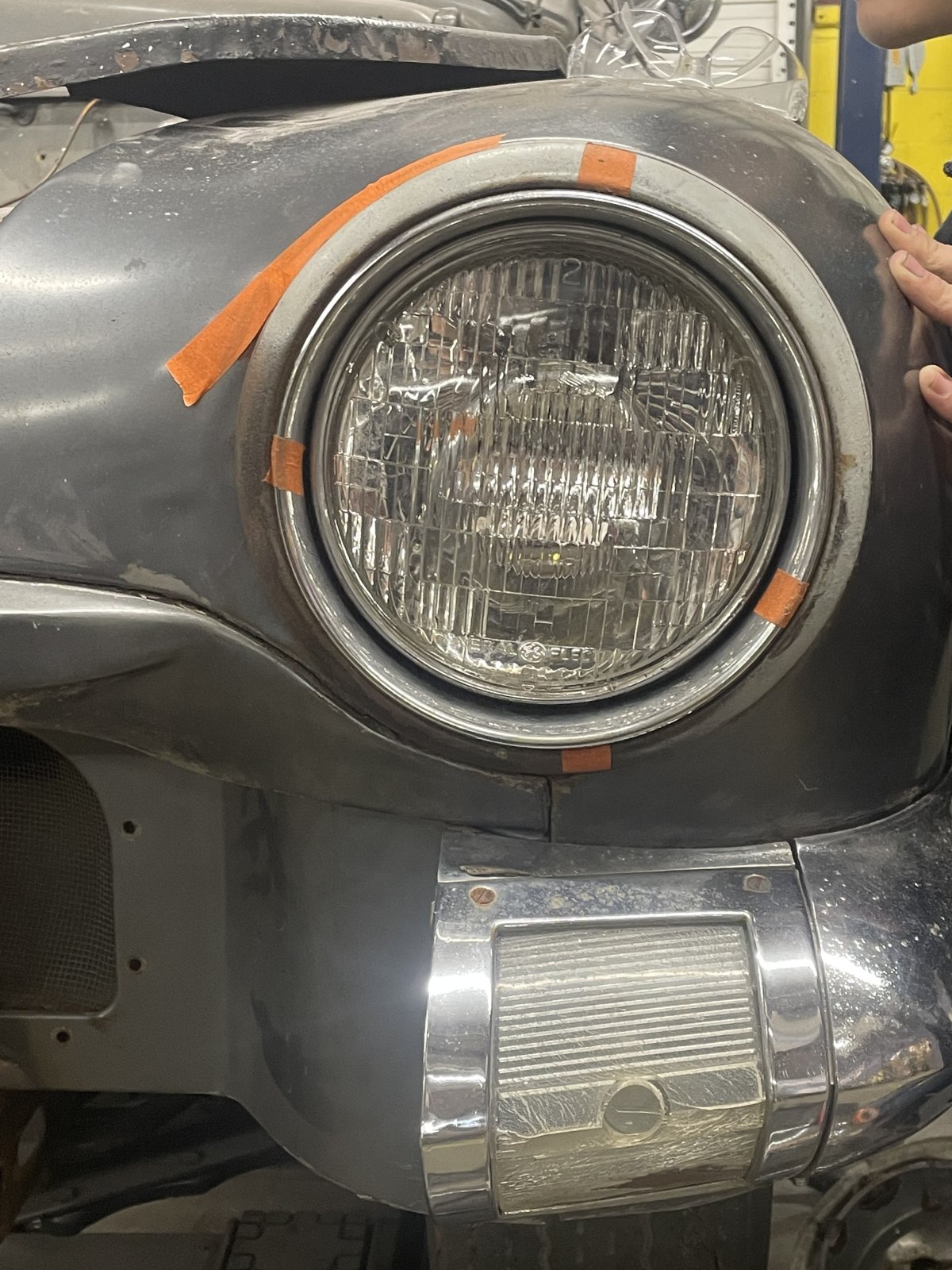

  8. 3/4 removed. Next mark is a 1 inch

  10. guthriesmith
    Joined: Aug 17, 2006
    Posts: 11,970
    guthriesmith
    Looks good to me where it is and is SO much better than when it was 3/4” longer.
  11. J. A. Miller
    Joined: Dec 30, 2010
    Posts: 2,347
    J. A. Miller
    from Central NY
    Looks good with the 3/4 off.
    1" might make look too thin.
    anthony myrick likes this.
  12. The joint profile at the top is much better. The outside radi needs a filler piece to smoothly blend from the widest part of the fender at 3:00 to the leading edge of new ring. You probably want to be really careful not to weld the ring to the upper grill surround.
  13. It clears the grill surround.
    The 3:00 position isn’t great.
    A lot better than it was
  14. Squablow
    Joined: Apr 26, 2005
    Posts: 18,523
    Squablow
    I think you're at optimal depth now. The '51 grille really sticks out a long way, as does the front bumper with the accessory guard, so I think if you take any more off, it'll be out of proportion. A filler panel, or a couple of relief cuts to blend it into the fender seems like it's usually necessary to keep the amount of filler to a minimum, but that's normal.
    It looks good, this is the way.

  15. I hear ya.
    I’ve seen the relief cuts. Friend had one leaded. I’m not stretching plastic fantastic that far.
    Might have a slight “****** look” mentioned at 3:00.
    I’m ok with that for now.

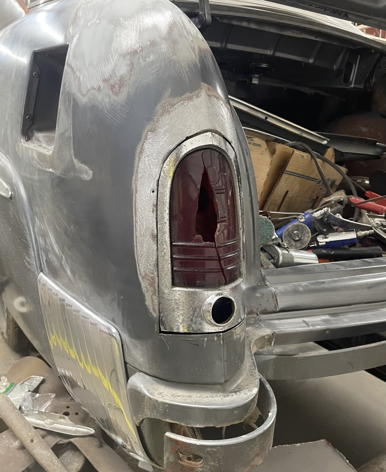

    Removed the trunk trim and considering decking it.
    We started t******* the stock tail lights to see what they look like. Frenched, thinned down stock tail light bezels, flush with the body. I’ve seen the stock lense frenched but would like to see how the housing looks with the edges thinned.
    I’ll probably cruise it with primered spots as we continue messing with it.
    Heavily considering losing the door handles and install 2 Lincoln push ****ons.

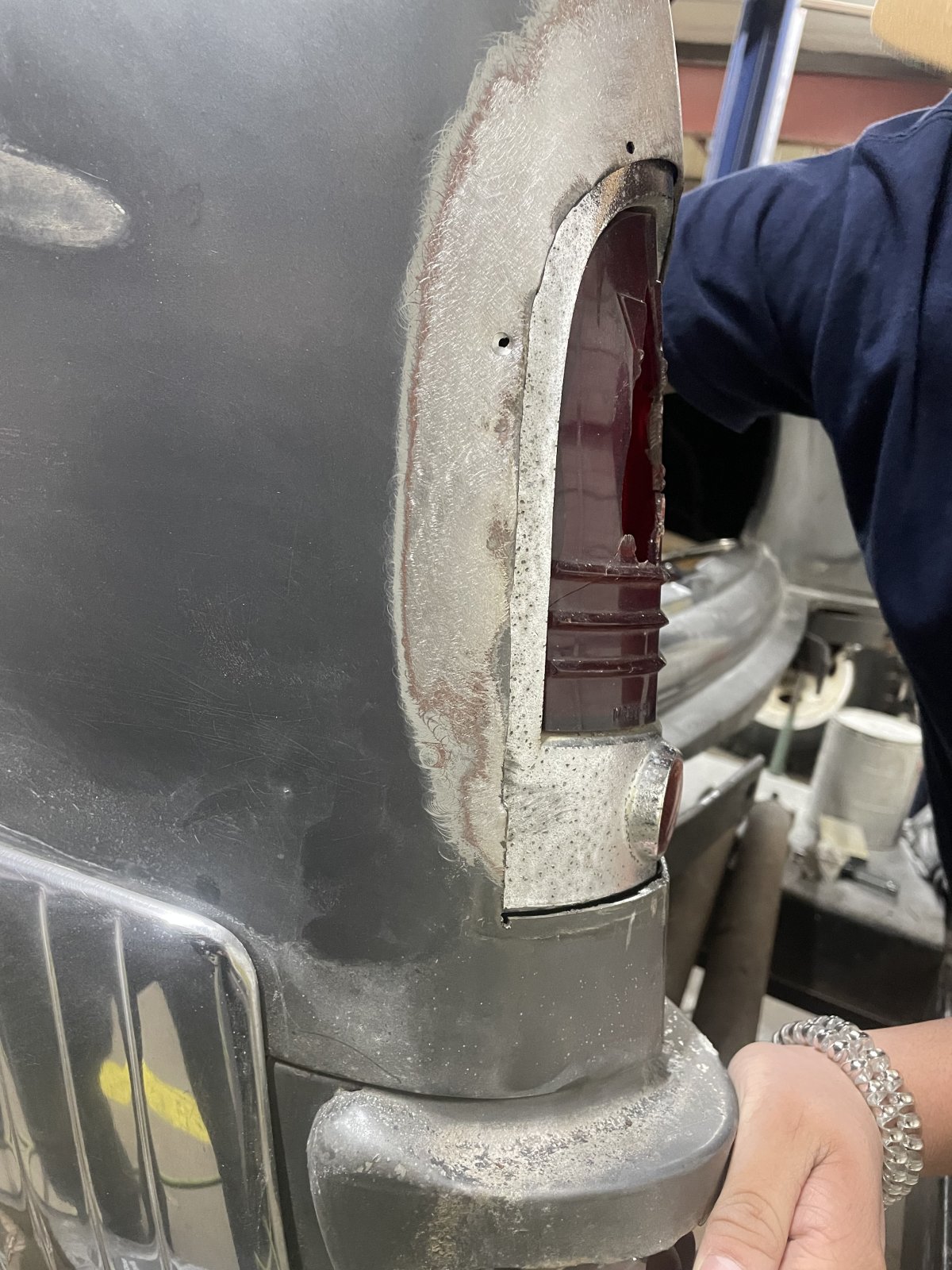

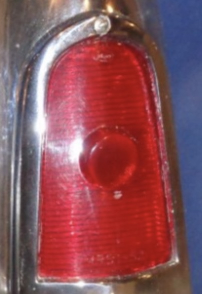

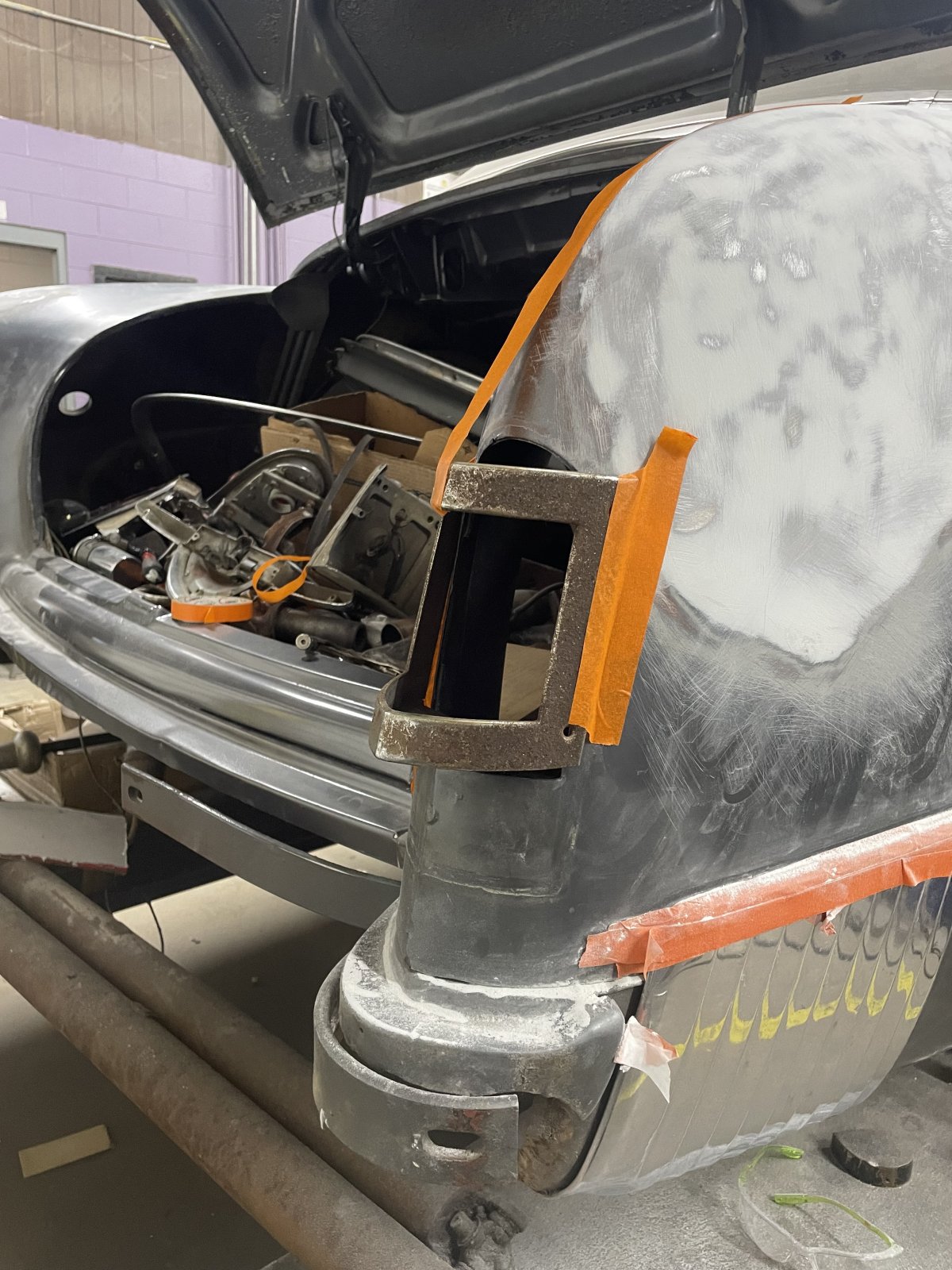

  16. Trimmed 51 tail light. Factory inner brace removed.
    just pushed sorta in place.
    Undecided on chopping off the reflector.
    But needed to see it.
    Considering a flush or slight frenched installment with the stock chrome bezel.

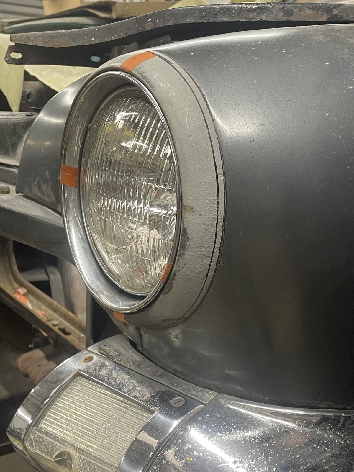

  17. Goofing off and picked up a front bezel.
    Hmmmmmm
    Okie Pete, Truckdoctor Andy and Tim like this.

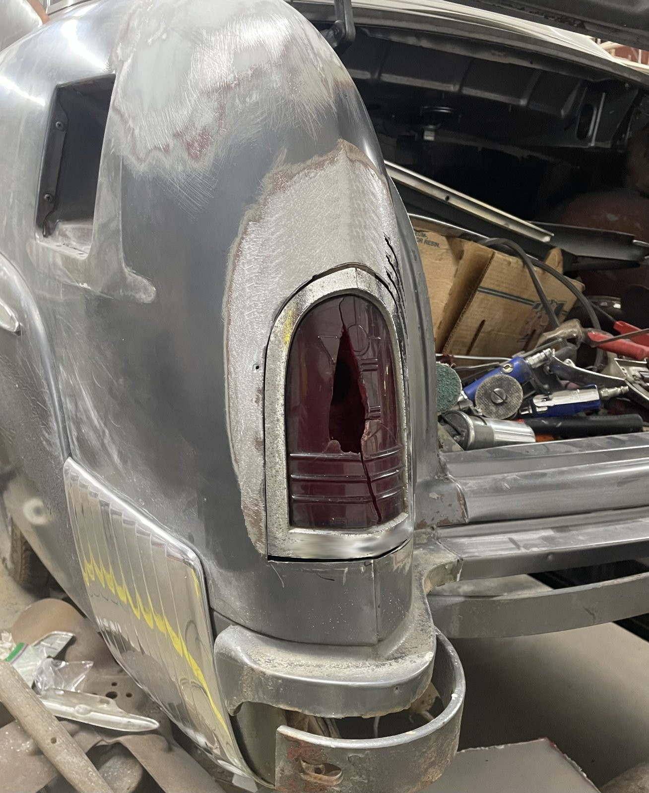

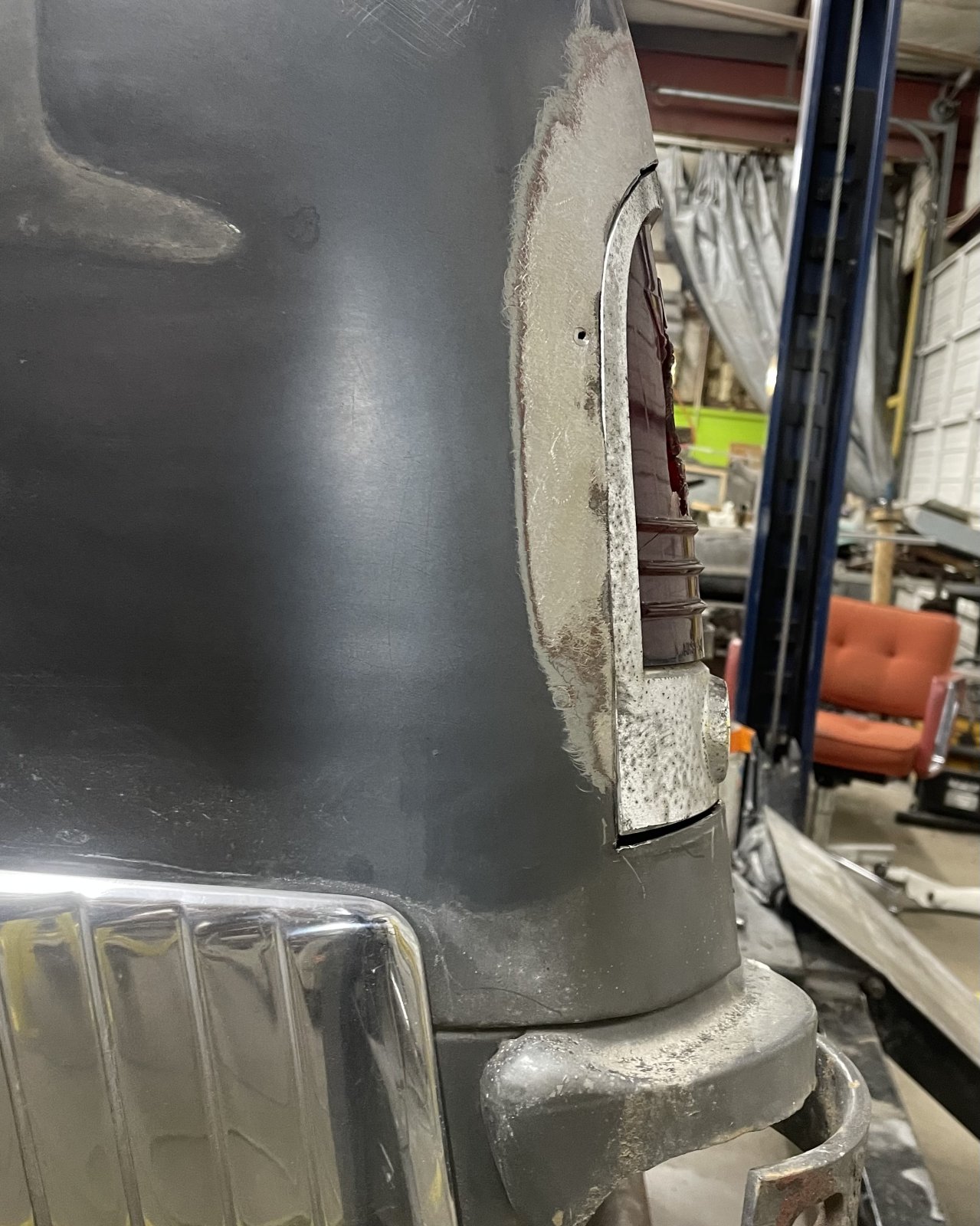

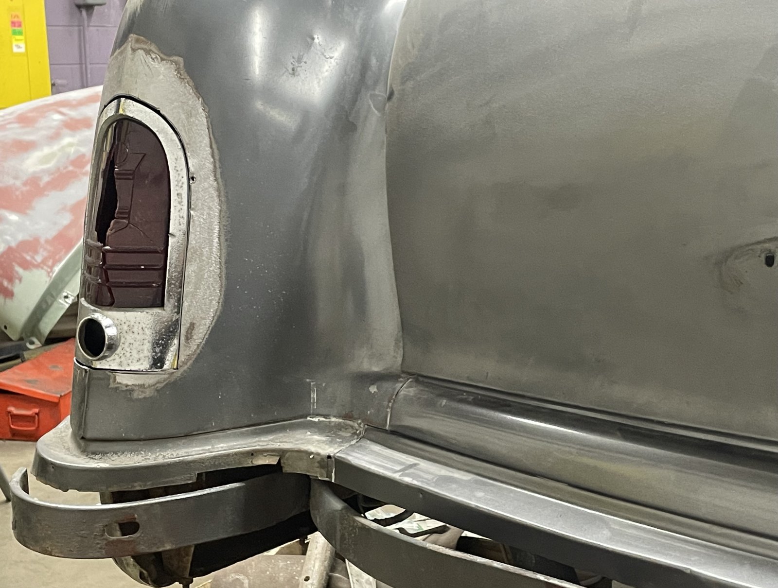

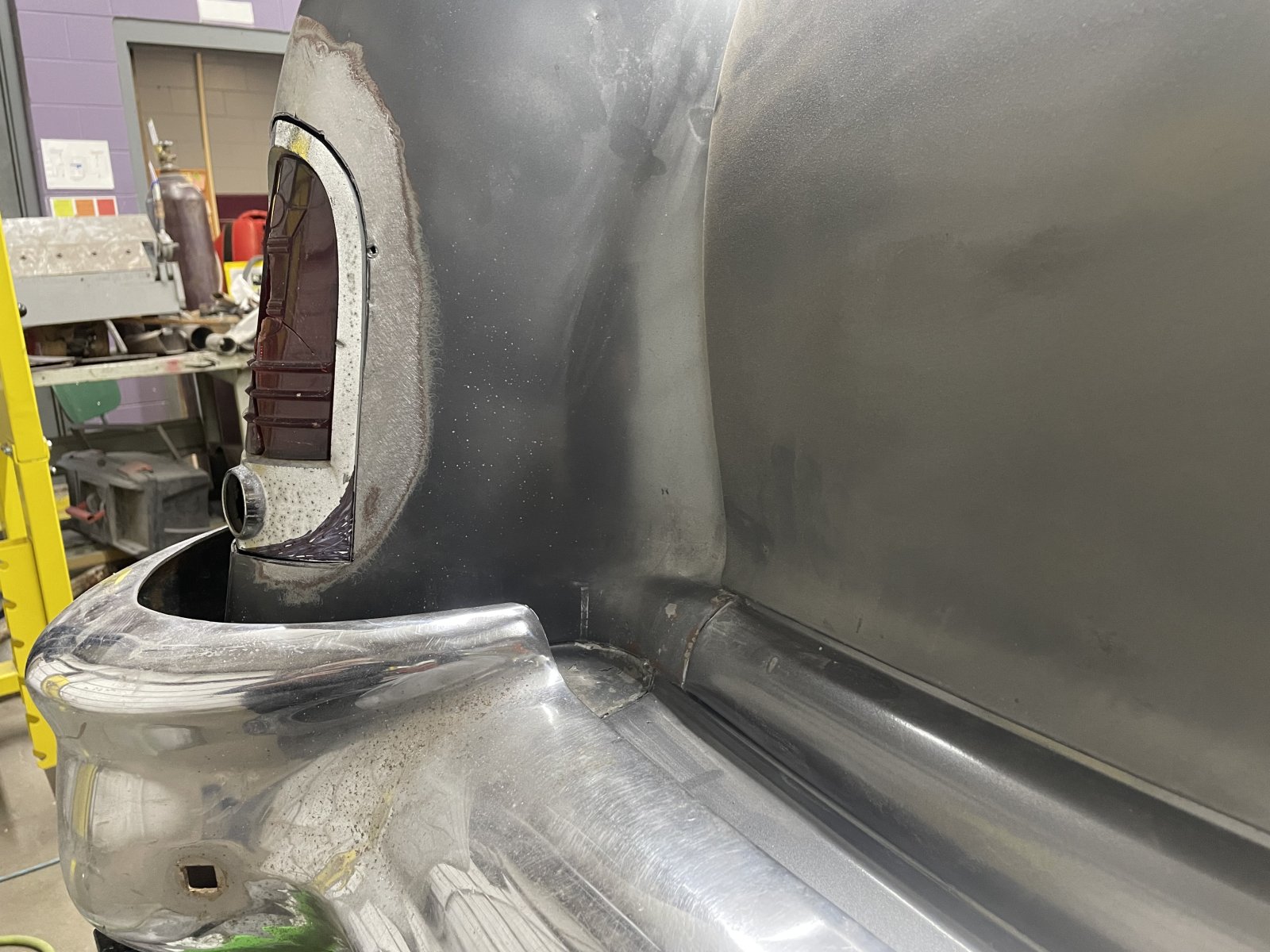

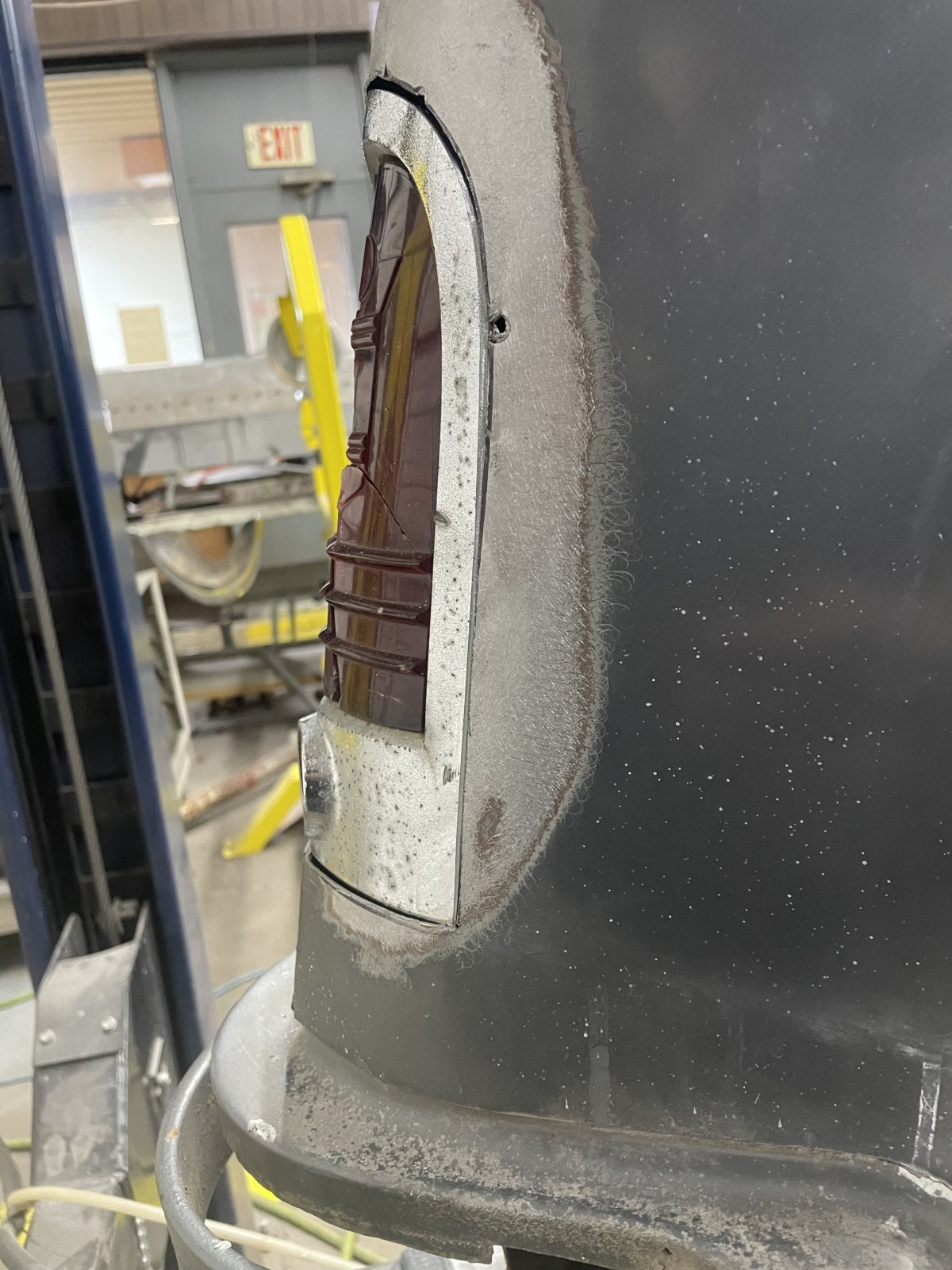

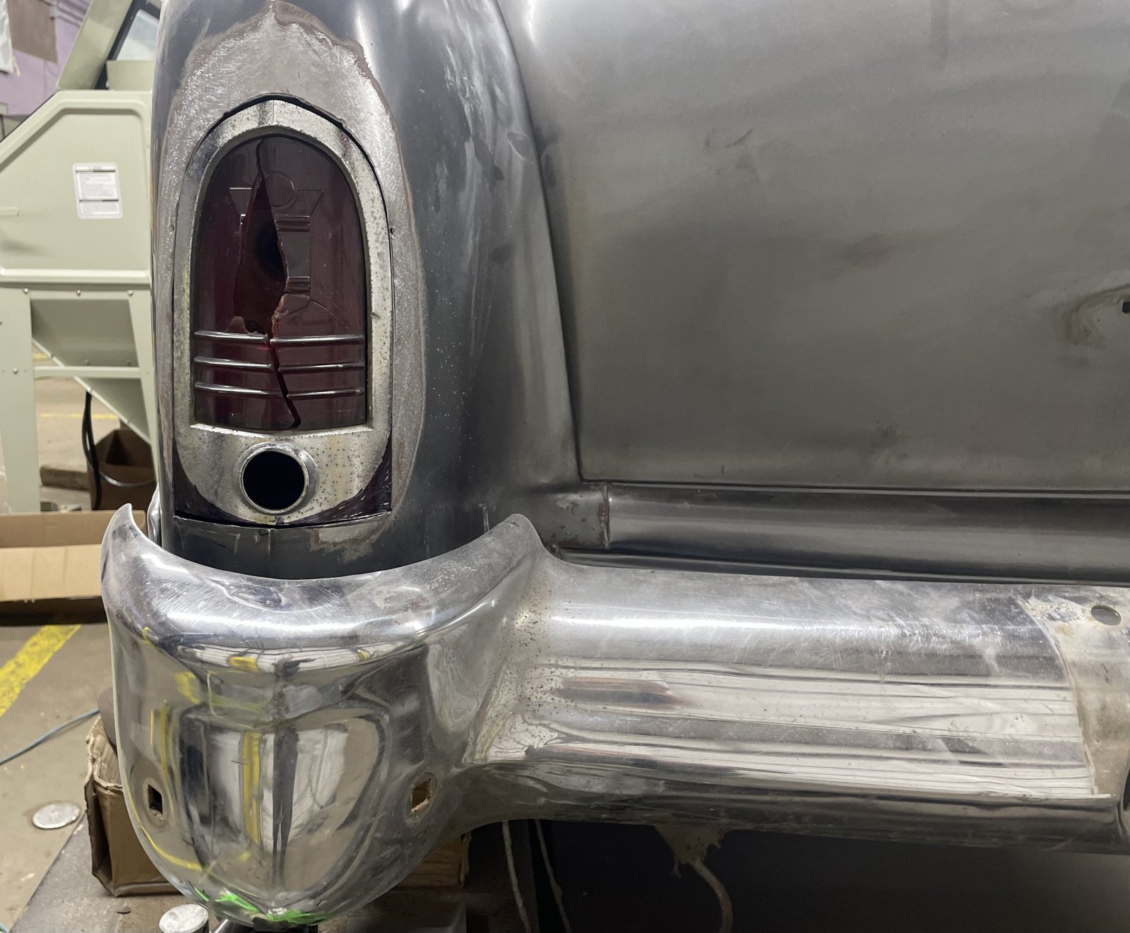

  18. Thinned down and flush fit
    drdave, Sancho, 40two and 8 others like this.

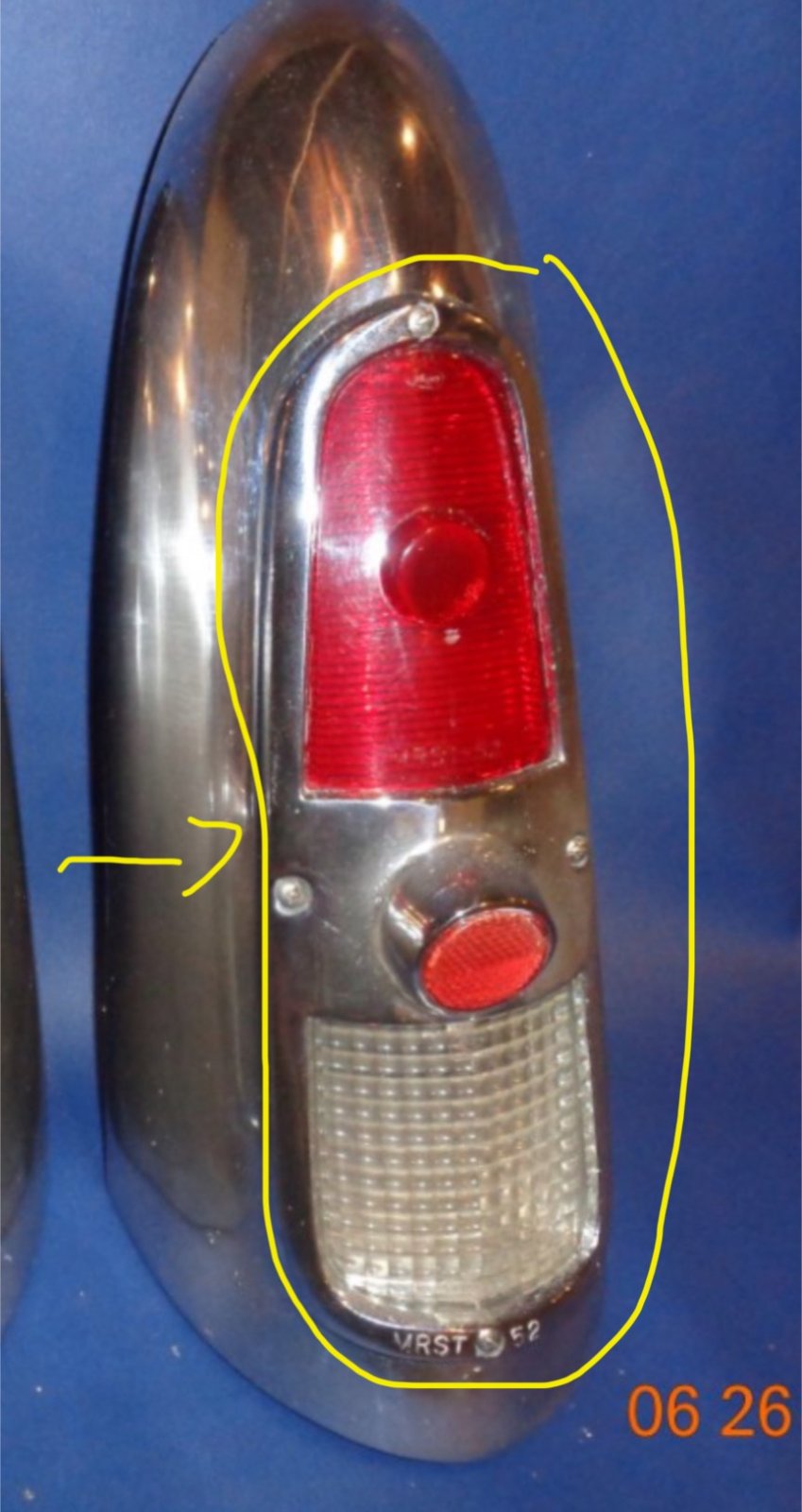

  19. Kinda wonder what the reflector section bring trimmed off would look like
    Sancho likes this.
  20. Budget36
    Joined: Nov 29, 2014
    Posts: 15,337
    Budget36
    Tape over it. Try a rattle can the tape the same as the car and step back.

  22. Radius?
    possible compromise
    Use something like this instead of the flat reflector
    hmmmm
  23. Squablow
    Posts: 18,523
    Squablow
    You'll have to cut through the reflector hole to keep the edges of the bezel all uniform, so there will be a gap at the bottom that you'll have to fill. But, it does look nice. In this example, I drop the light down toward the bumper by the same amount that was removed from the bezel. Could go down even further, maybe.
  24. Yep. Would need dropped
    Think I like the reflector end radiused the more I look at it
    bchctybob likes this.
  25. guthriesmith
    Posts: 11,970
    guthriesmith
    Yep, radiused works well. :cool:
