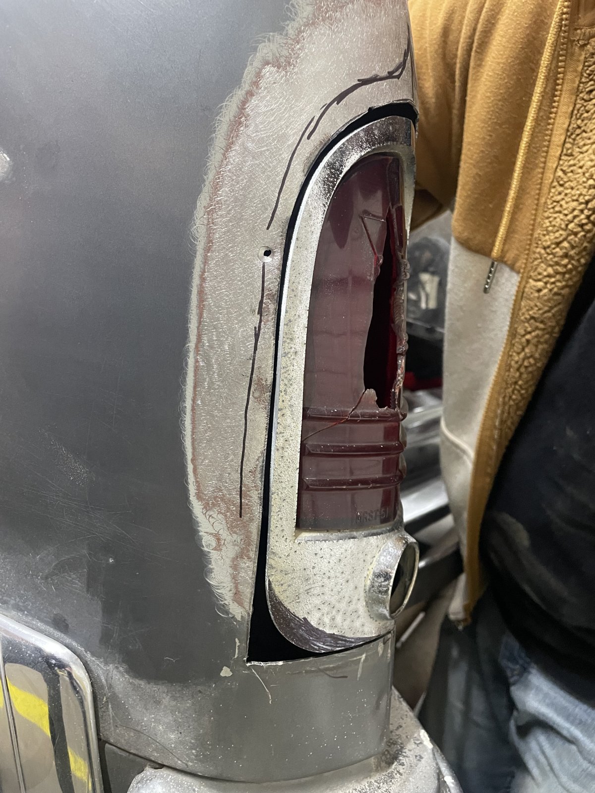

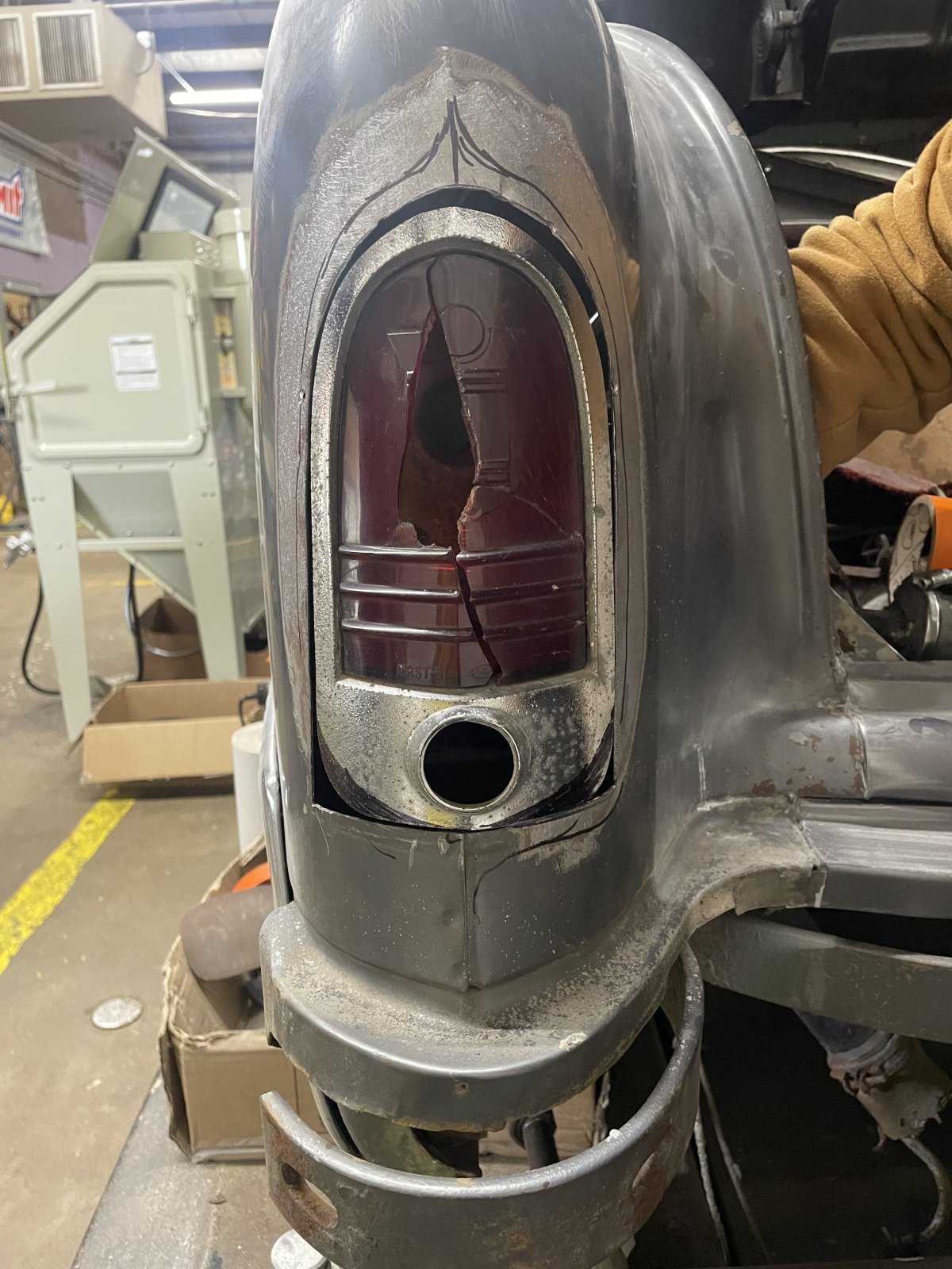

  4. This popped up on a random taillight search. No info.
    Probably a European car.
    I like the shape of the original lights.
    I don’t like the bulkiness of the bezel.
    I’m going to trim it down probably at least another 1/8.
    I like this thinner style bezel.

    Both ways look good, but I'm thinking that once you pull the bumper up closer to the body, The flat surface of the bumper will compliment the flat surface of the light.
  6. Used 3/8 tape and trimmed down the bezel some more.
    Will probably stop here and build the bucket

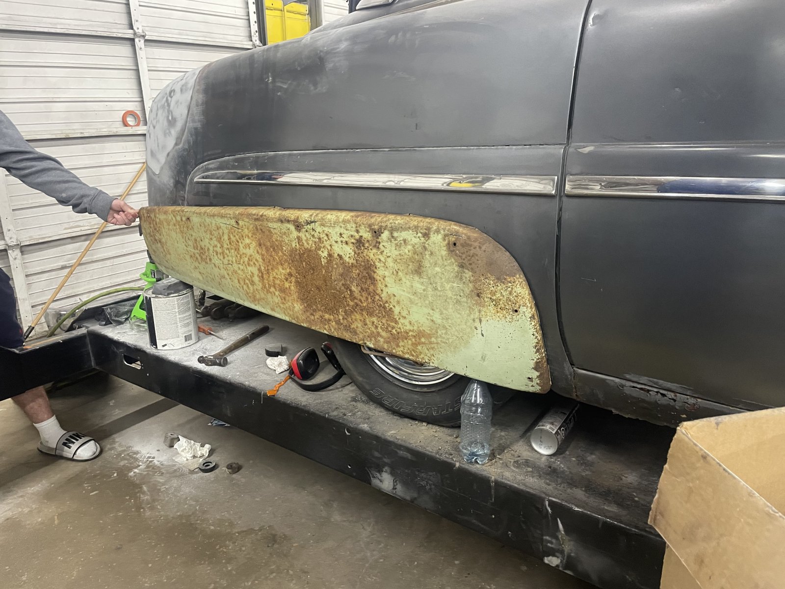

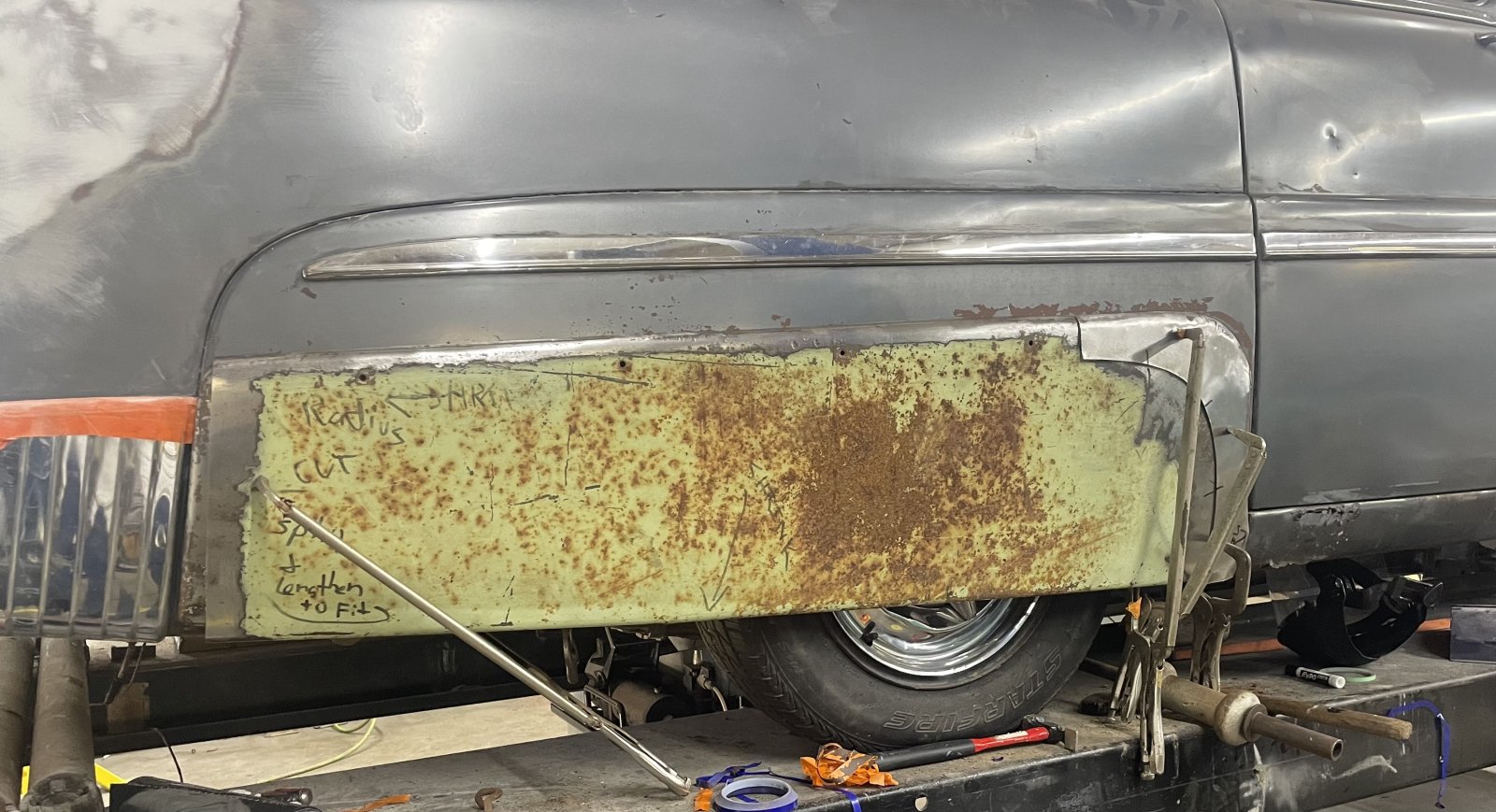

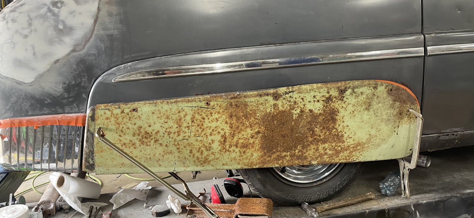

  10. If I were doing that I would terminate the Skirt right at the vertical seam where the lower quarter ends and the taillight extension come together. Then the corner radi needs to match the factory radi, not so squared off as the corner is now. You won't know if it's going to work with the rest of the package until it's done and too late to go back on the skirts.
    Okie Pete likes this.

    Sell those cruiser skirts and make some flush mount skirts. Possibly use a lower section of a Merc. door as contours should be close.
    Eddie

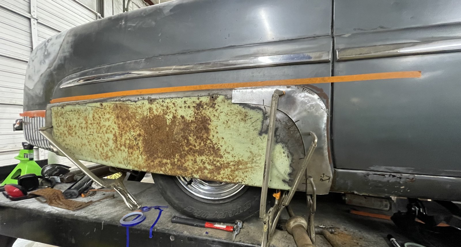

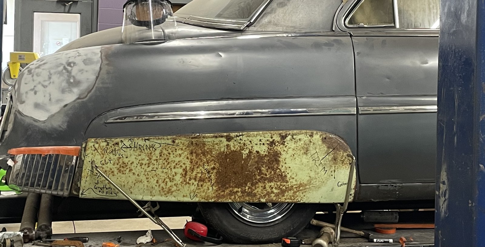

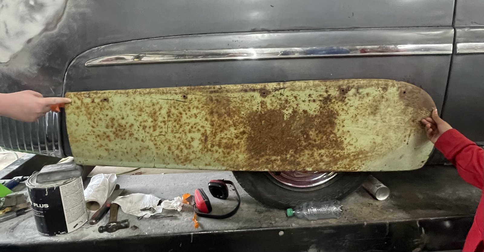

  12. Too late
    We whacked em
    I’m not a big flush mount fan.
    drdave, Okie Pete, williebill and 3 others like this.
  13. It’s just metal
    It’s never too late
    I can’t weld gl*** though
  14. Gonna thin em down a little more and tac the end on to flow with the stainless
  15. I dig em
    it’s just skirts.
    You can change em like shoes
    Moondog13, drdave, Squablow and 8 others like this.

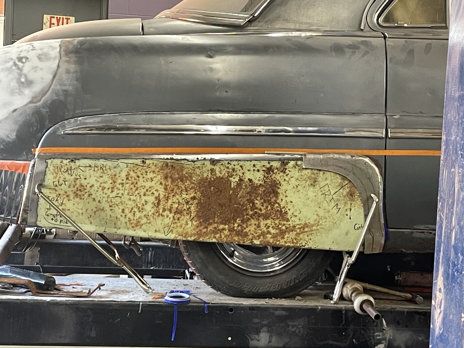

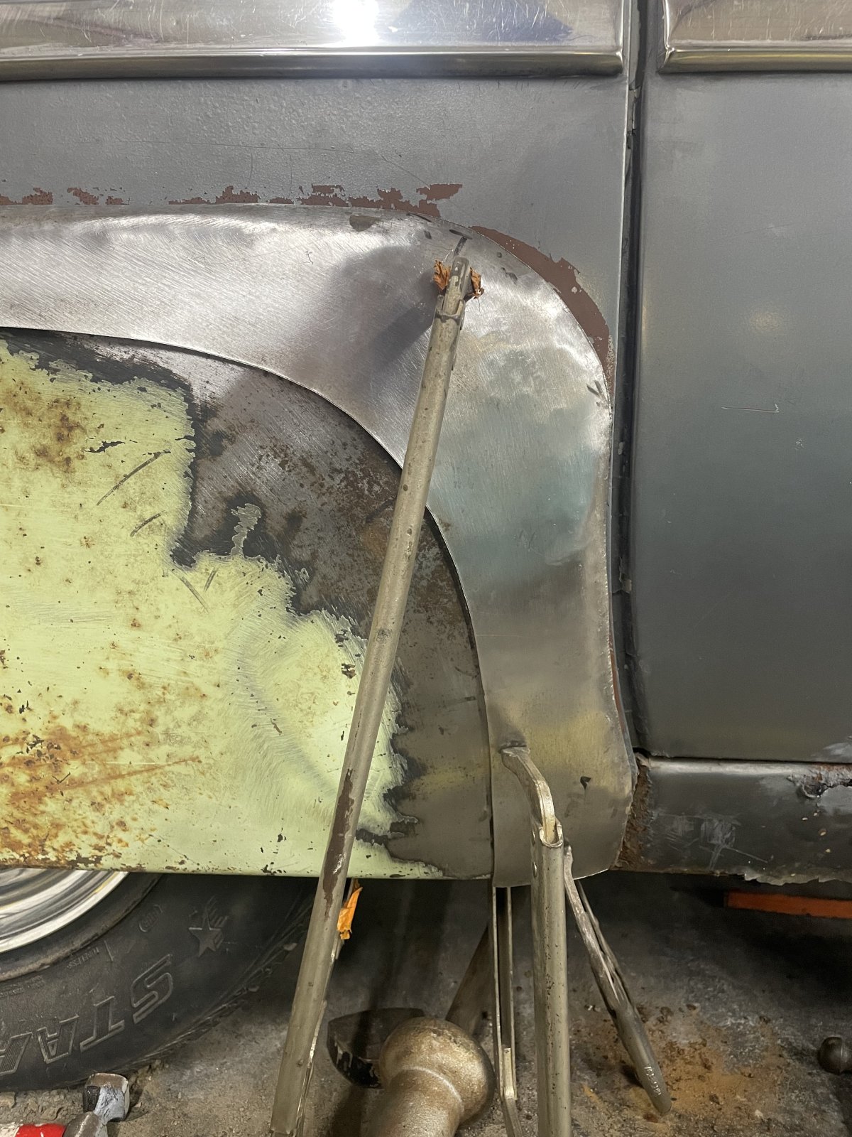

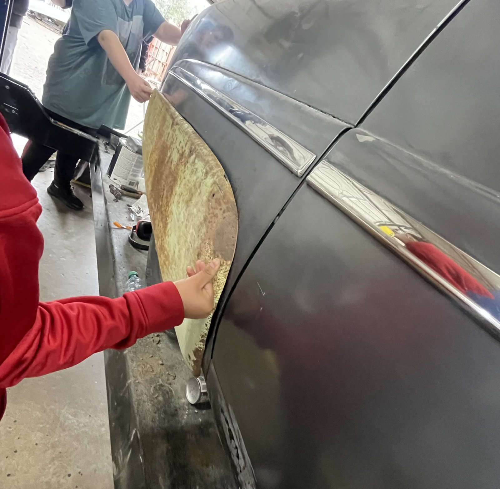

  17. More fat removed
    shrunk top and bottom edges to flow better
    We ain’t welding em in
    Just wanted something different. I’ll still paint the stock ones. Maybe change em out often.
    theses skirts were $100. The lip that held the seal was bad. Nothing lost.
    the upper portion of the top at the rear will get a slight radius.
    The foward, lower section can be shaped to flow with the door jamb. Just like the originals.

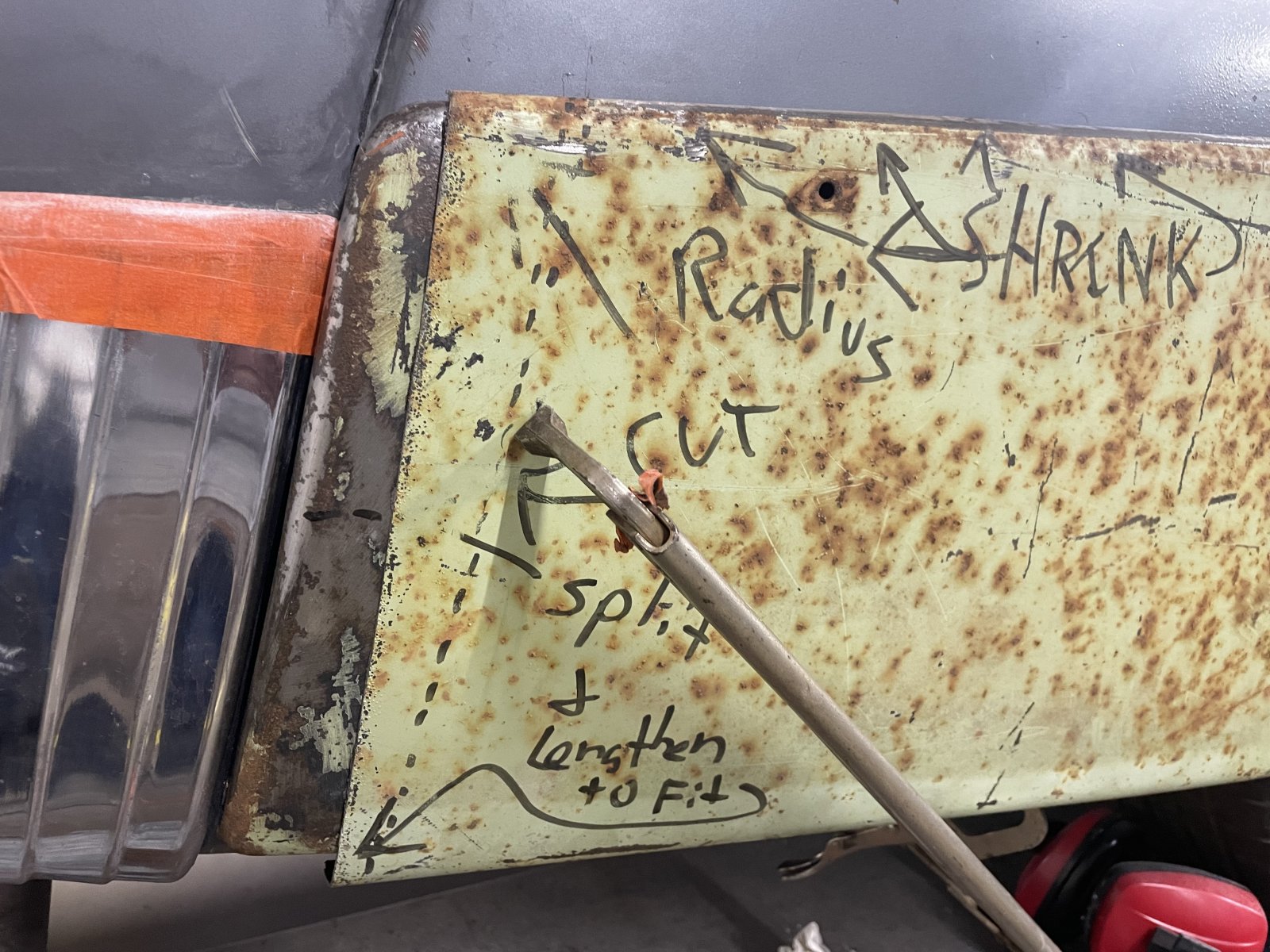

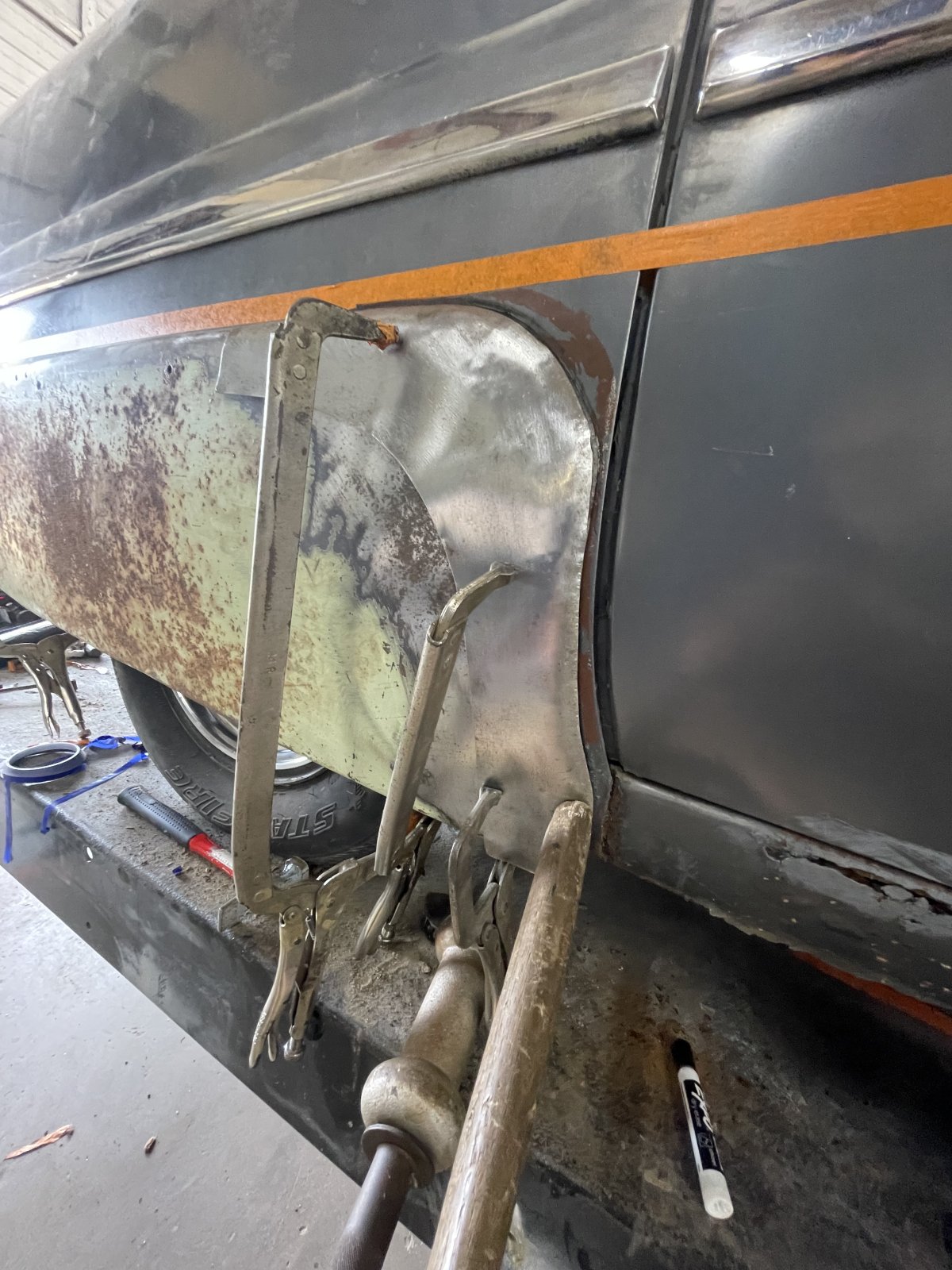

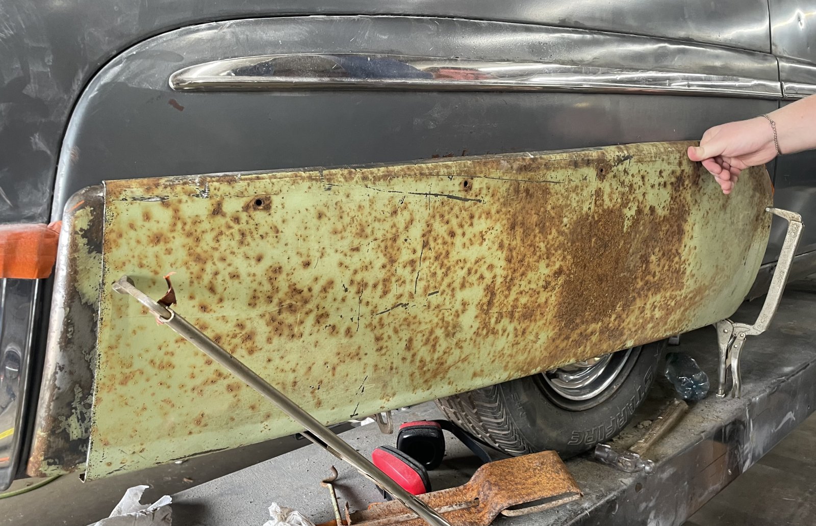

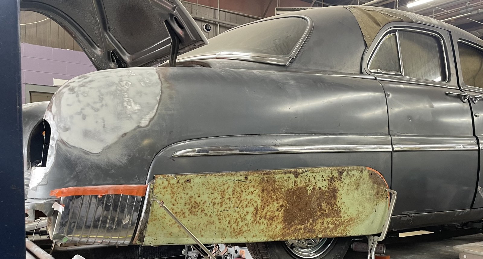

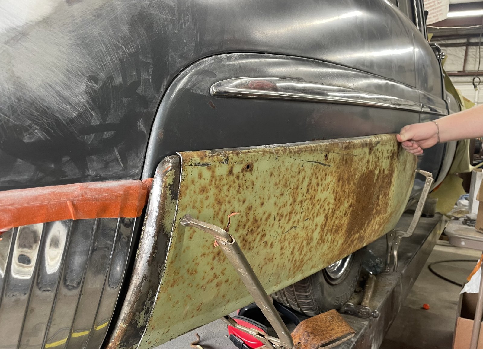

  18. Messed with em a little more. No students today, so I made some notes for them to take care of.
    Need to shrink the top edge a little more to flow with the body. Split the end we cut off and section it to fit the rear.
    Thin down a little more fat to fit the contour of the front quarter panel.
    We bowed the bottom edge to flow with the body contour. That got the skirt off the rear tire. Flows much better
    they ugly but I’m liking it.

    Nice progress. The leading edge of the skirt is definitely fighting with the rear door line.
  20. We might change that
    Well get the rear done then check out the front
    Okie Pete and bobss396 like this.

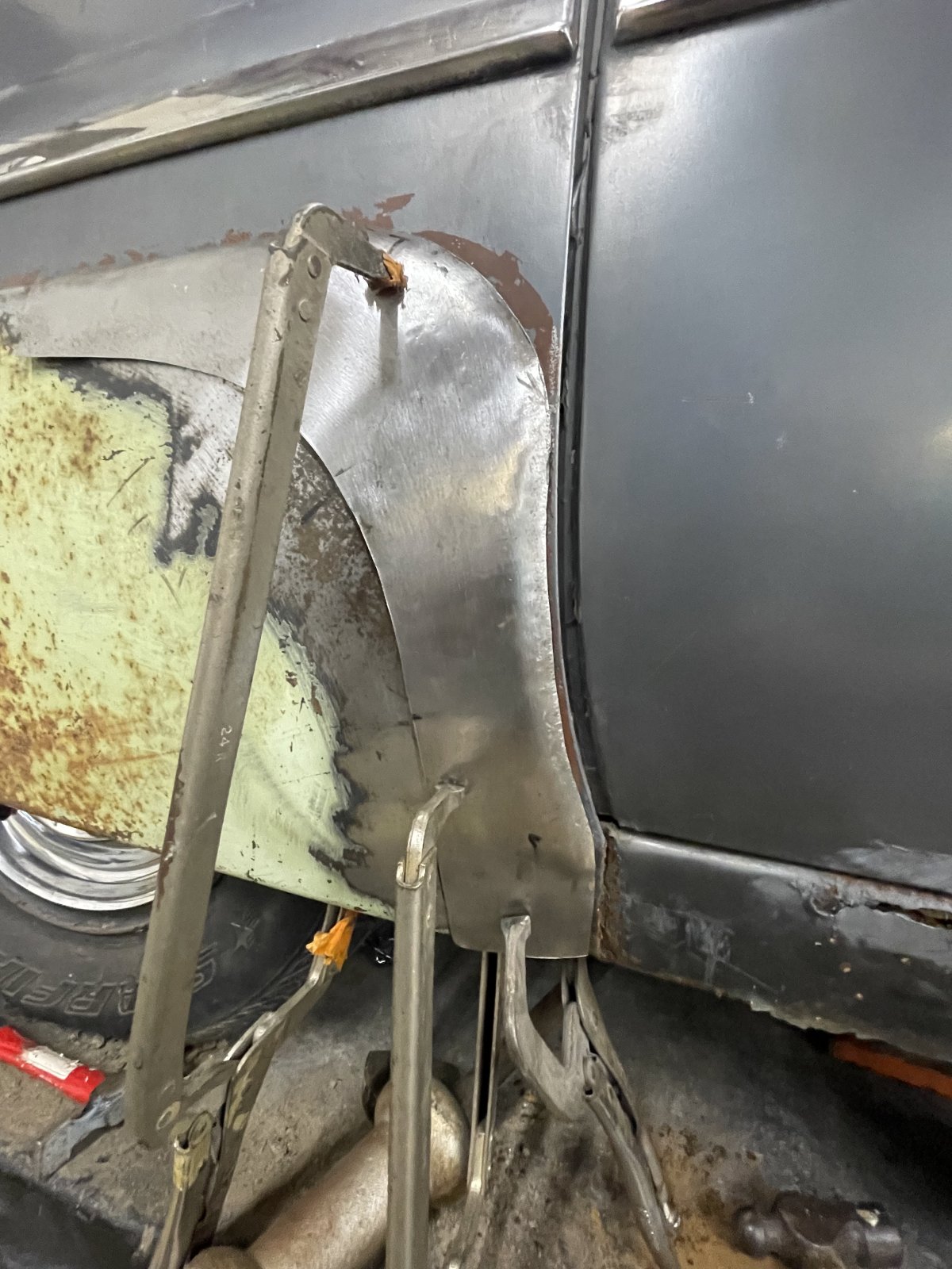

  22. Roughed out a new leading edge
    hammer, trailer hitch ball in a vice and a shrinker/stretcher.
    Just an experiment to see what could be done.
    Kinda like it
    Sancho, Okie Pete, williebill and 2 others like this.
  23. Little more work
