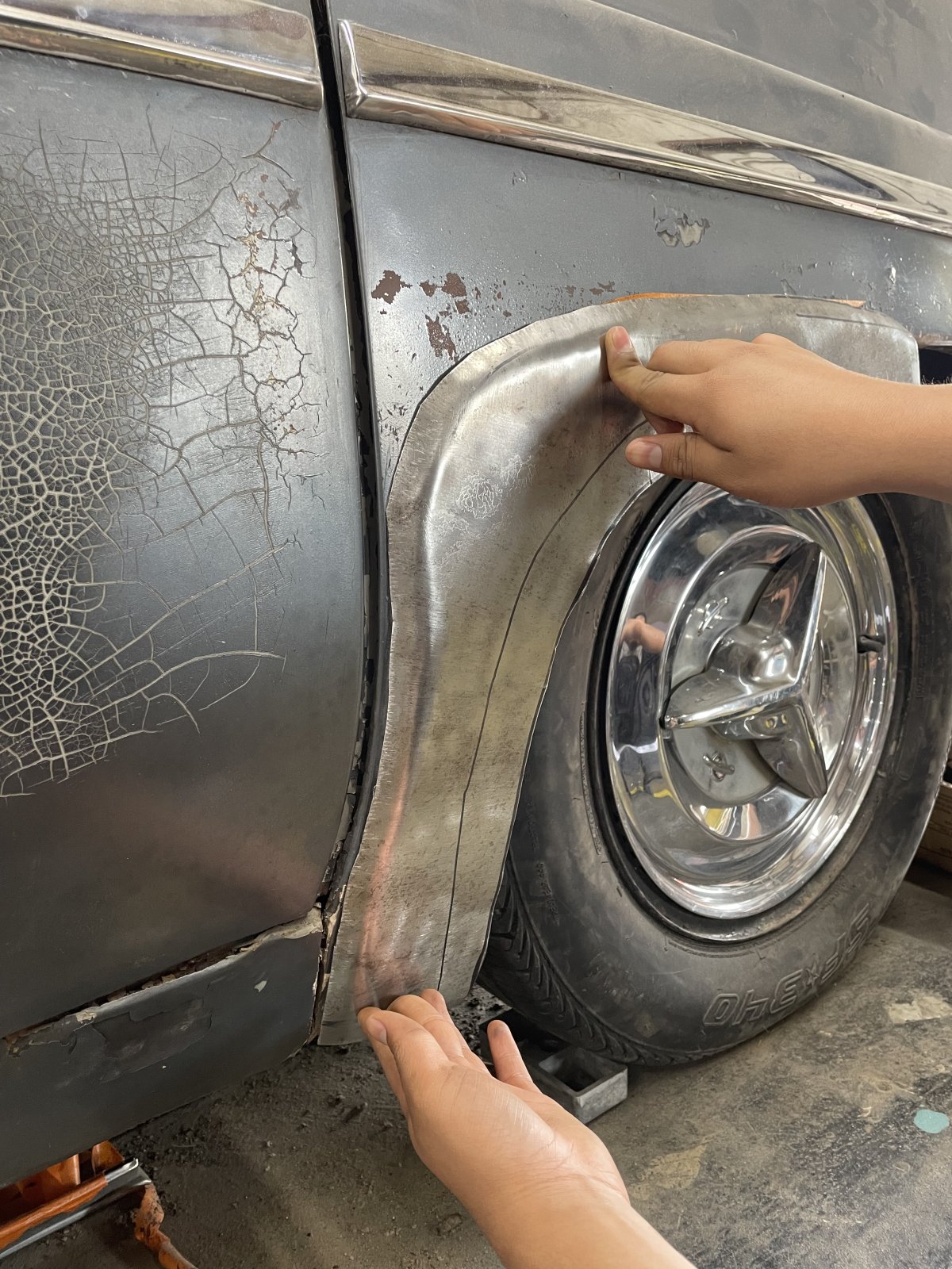

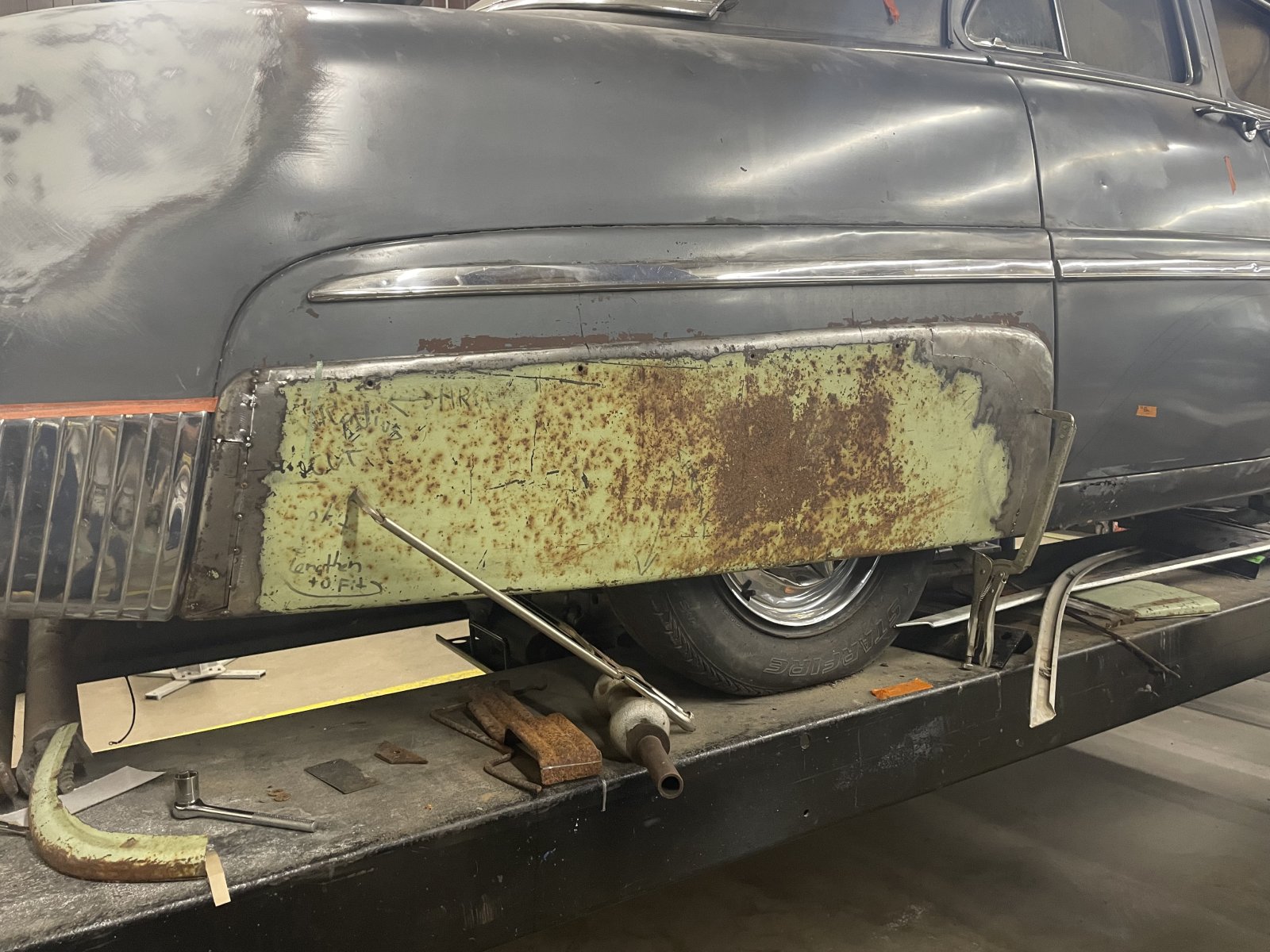

  1. Student made a tape pattern to transfer to the other side
    Okie Pete, Stogy, Sancho and 12 others like this.
  2. Student shaping the new piece for the cruiser skirt on the other side.
    Okie Pete, Stogy, Sancho and 13 others like this.

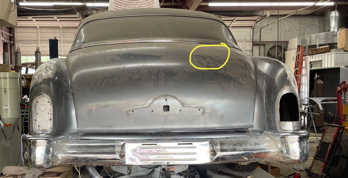

    I’m not entirely believing that this is in a school, when I was a student that dust would’ve had a least one knob drawn in it by now ;)
    Stogy, 1low52, williebill and 2 others like this.
  4. Absolutely.
    You might see the word “Buick” in the dust on the deck lid.
    Modified “F” word
    Stogy, bchctybob, Sancho and 3 others like this.
  5. Oneball
    Joined: Jul 30, 2023
    Posts: 1,652
    Oneball
    You didn’t have to modify “Ford” it really is one under the frock.
    anthony myrick likes this.
  6. Student said someone wrote a bad word
    naa, they just can’t spell Buick :)

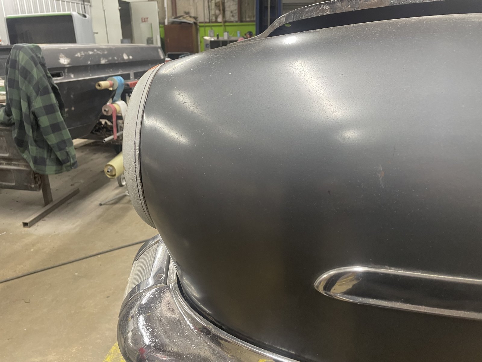

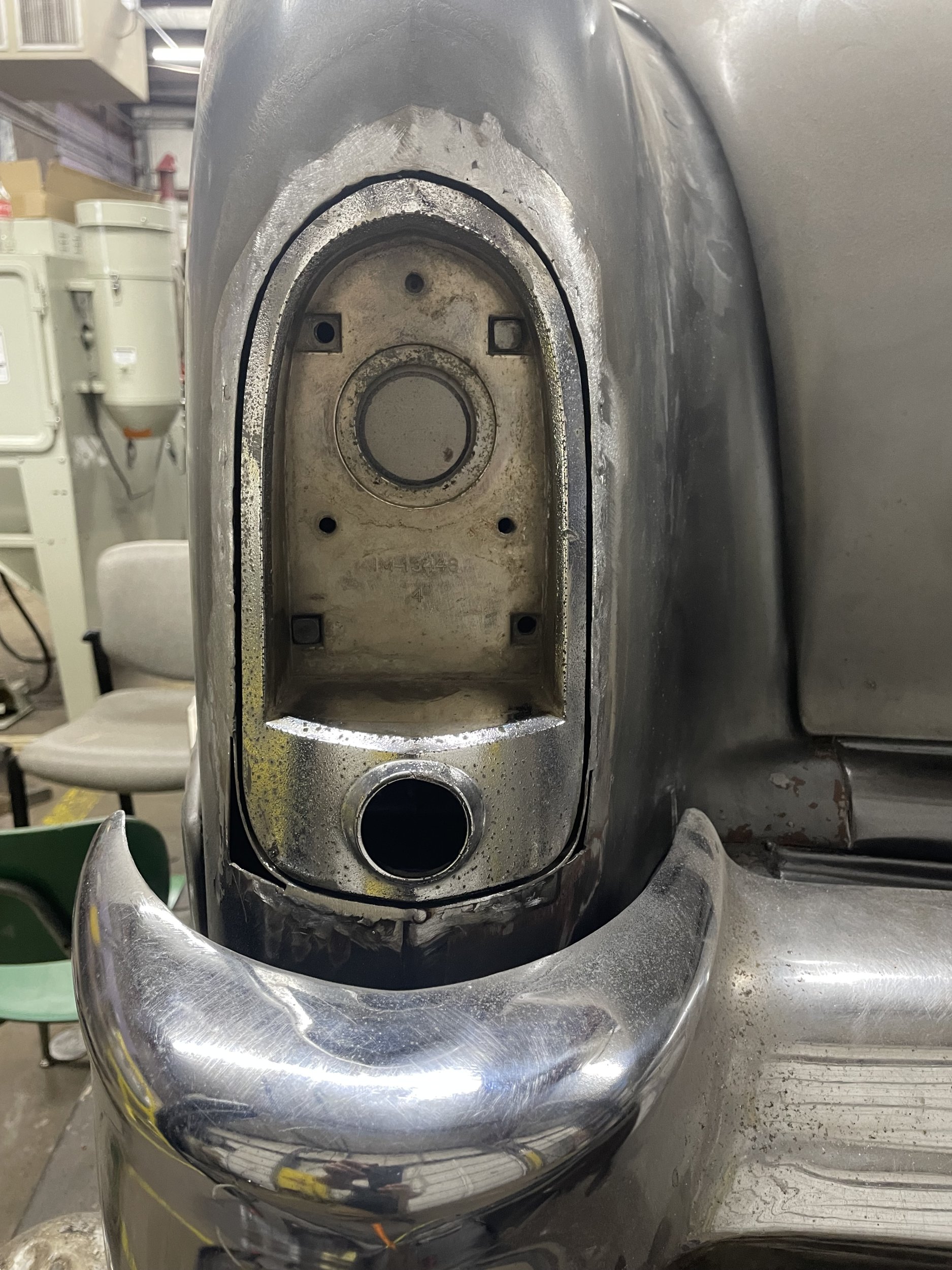

  8. Students got the other tail light bucket fit and tacked
    Moondog13, Stogy, Okie Pete and 12 others like this.

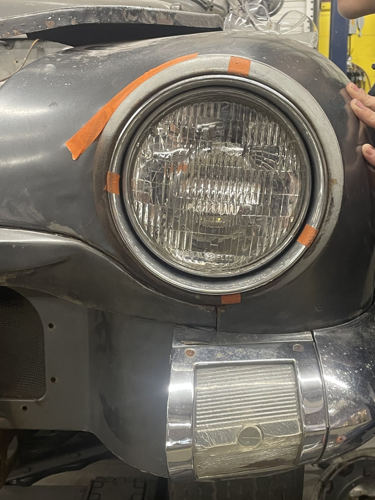

  12. I bought some headlight rings from @nickthebandit to put on my Ford, I had never thought of cutting them until I saw this post.
    Yesterday, I was in the shop, I cut one ring the same width as the factory chrome piece. Oh my god! What a game changer!
    I thought they looked good before, but now they look absolutely *****ing!!
    So glad I read this and got the idea from you.
    I really like the skirts as well!! Your kids are doing a hell of a job!

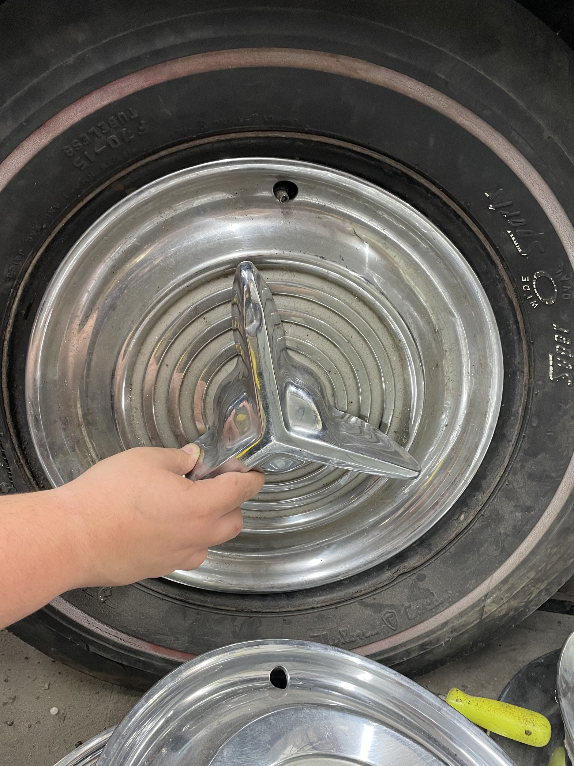

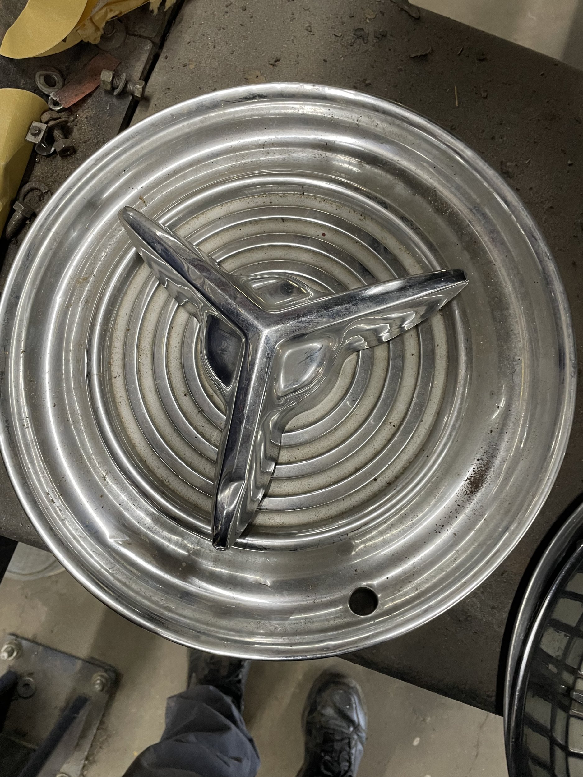

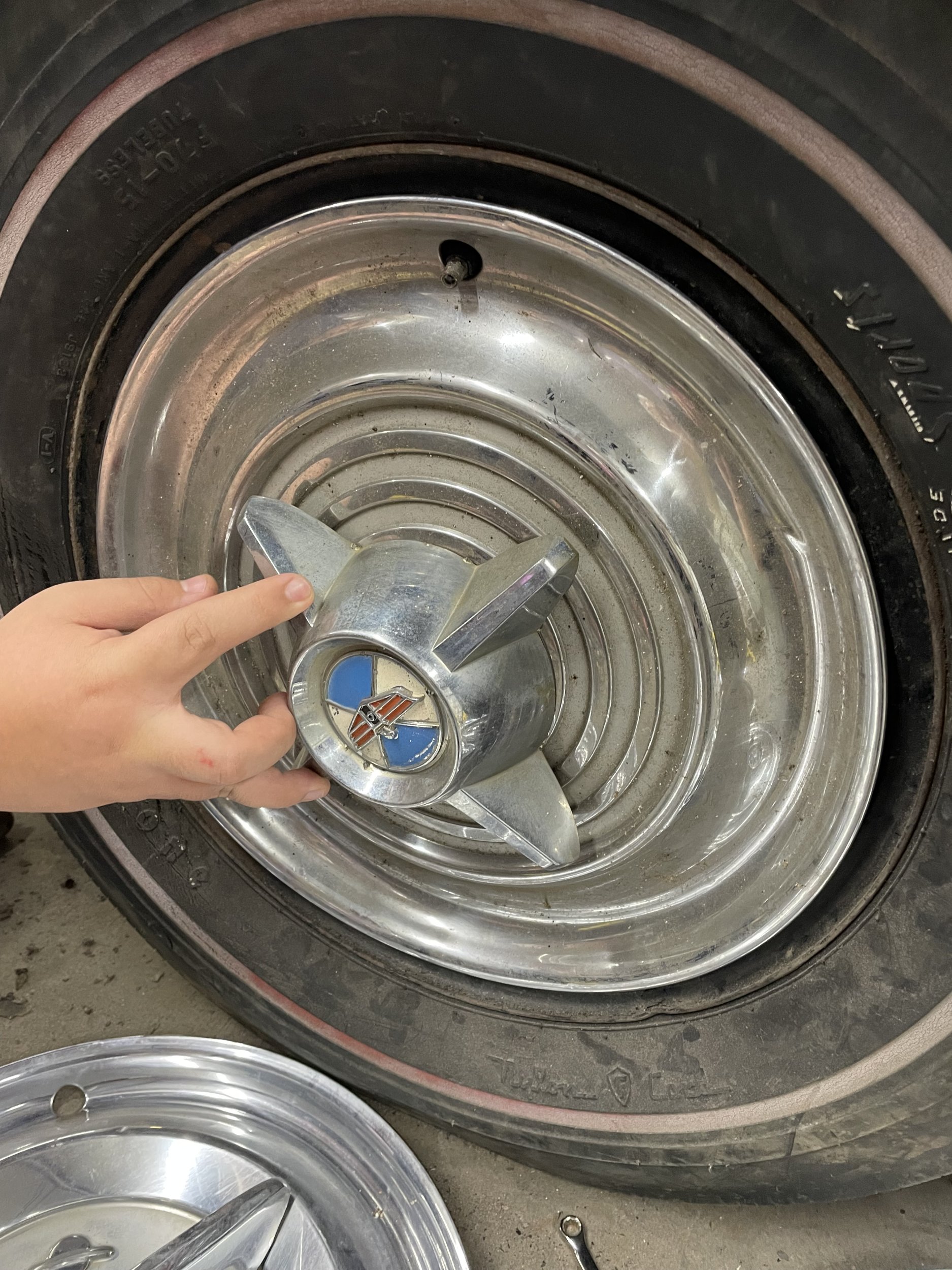

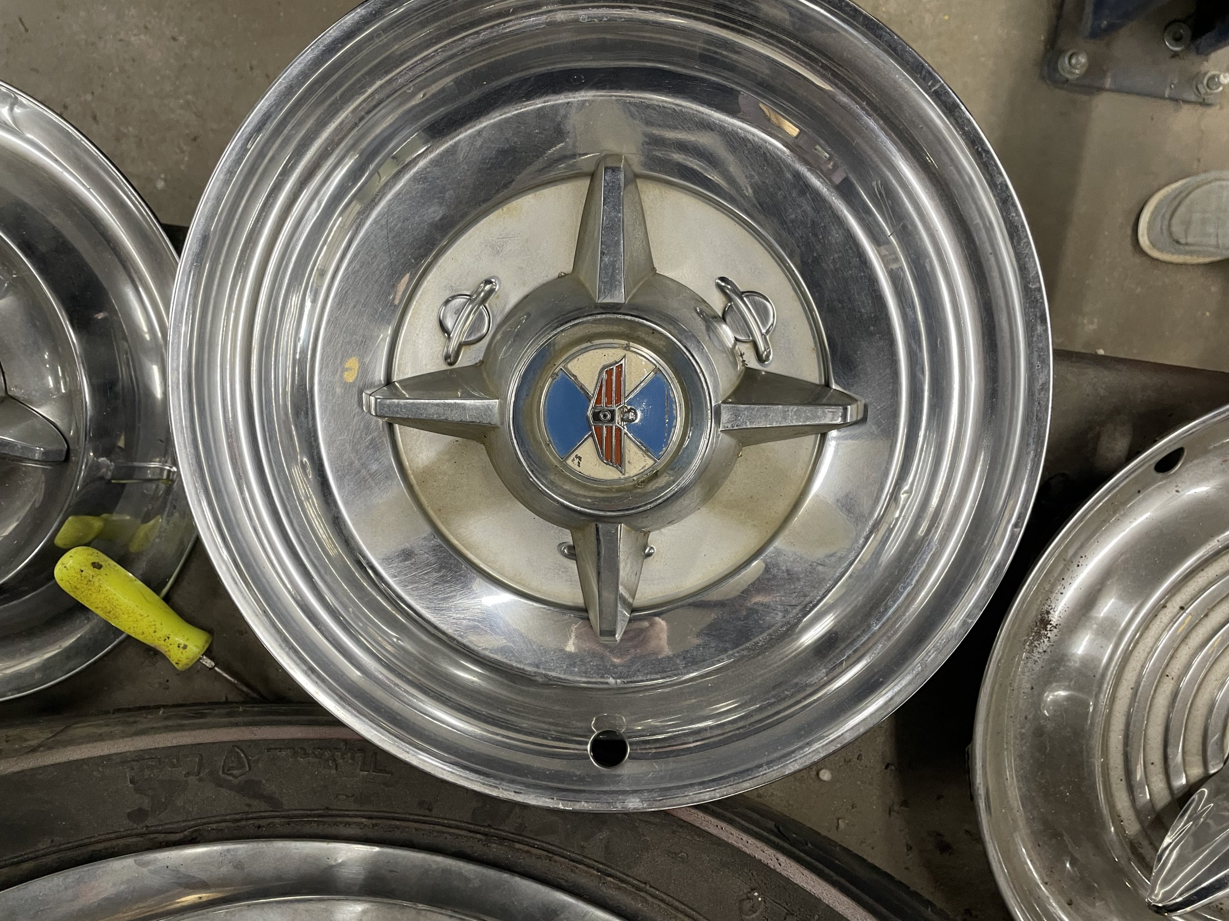

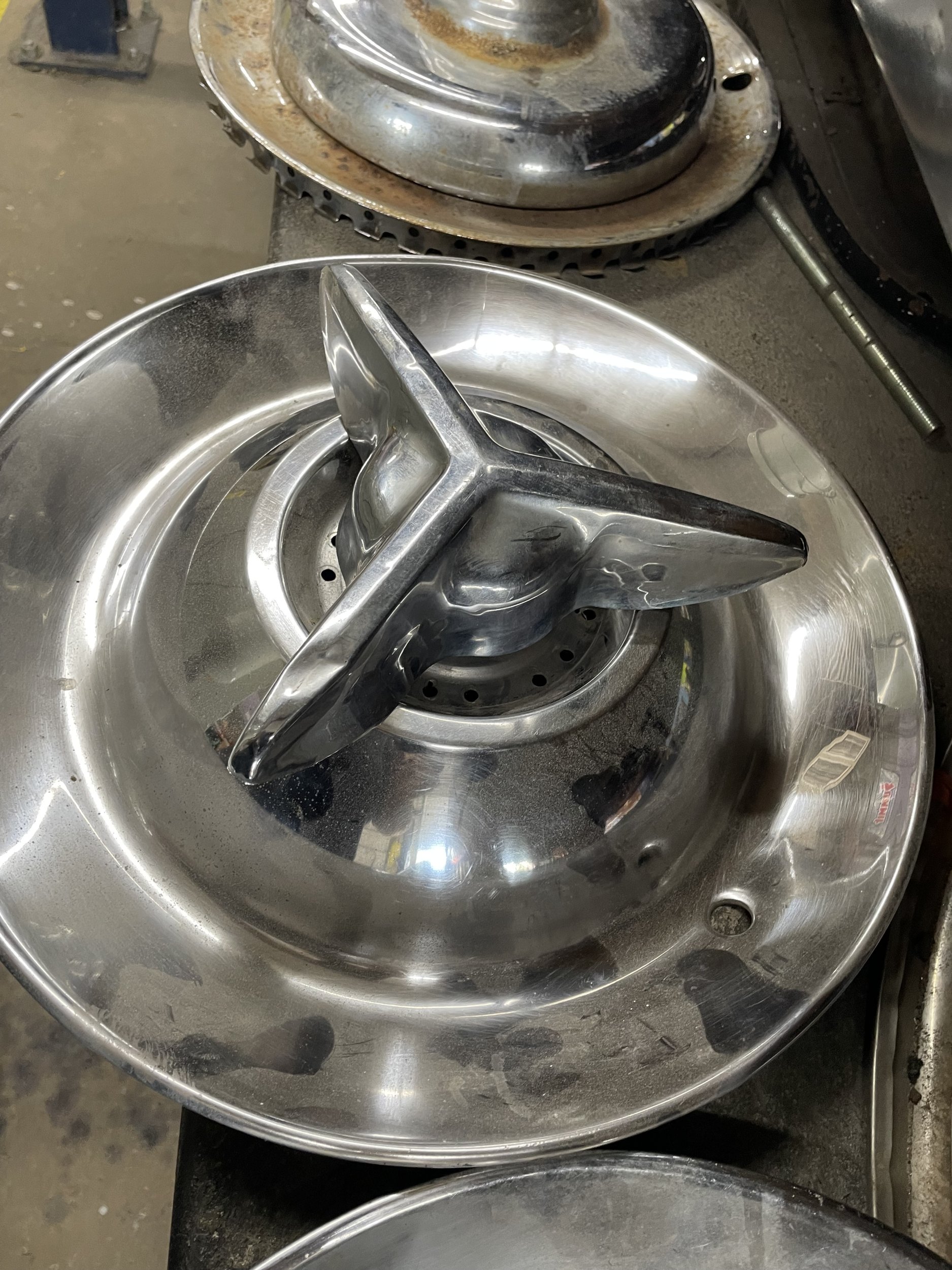

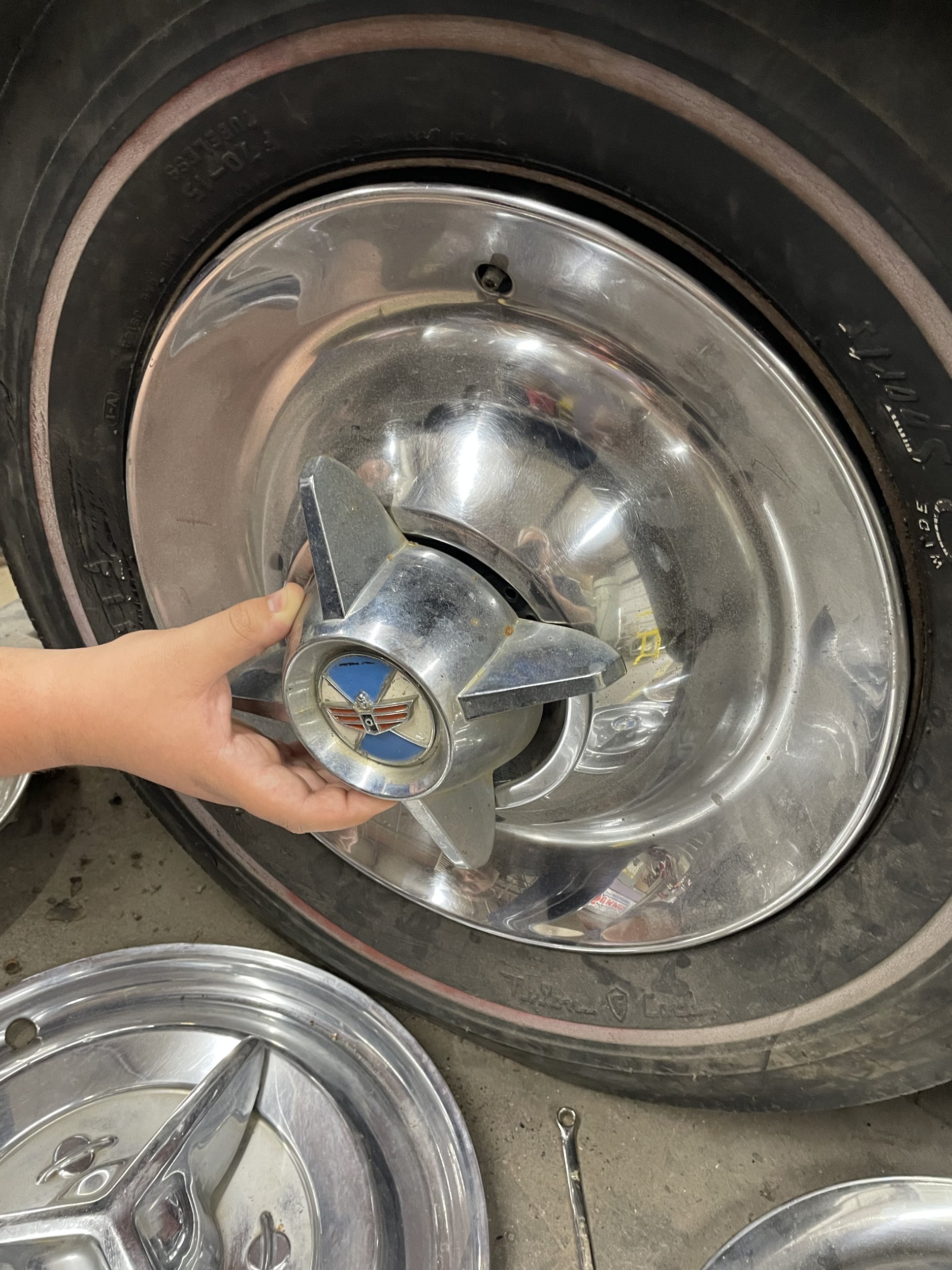

  13. Playing with hubcaps
    IMG_2867.jpeg IMG_2864.jpeg IMG_2866.jpeg IMG_2865.jpeg IMG_2863.jpeg IMG_2862.jpeg IMG_2861.jpeg IMG_2860.jpeg IMG_2857.jpeg IMG_2858.jpeg
    goofing off with the **** I bought this weekend

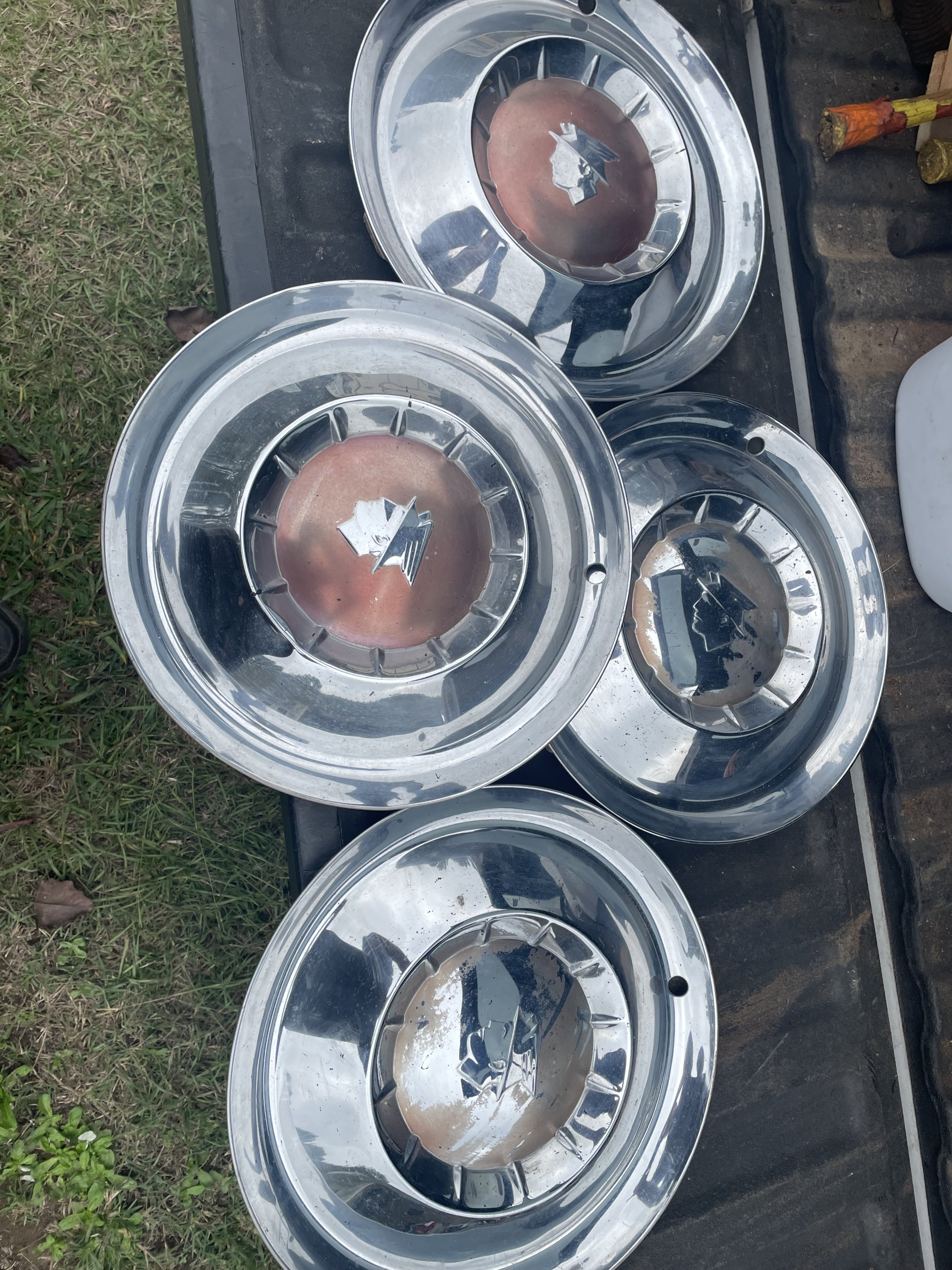

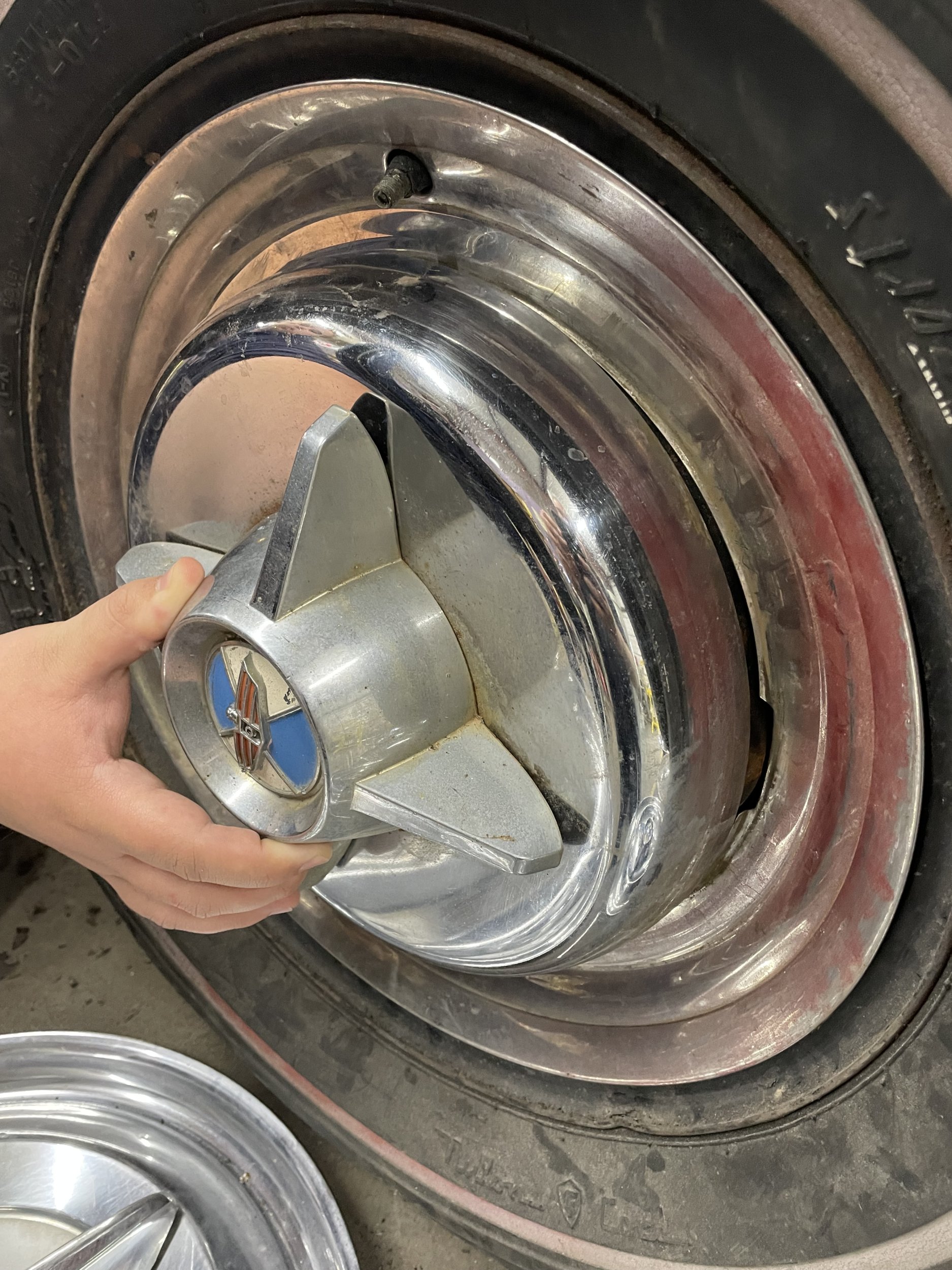

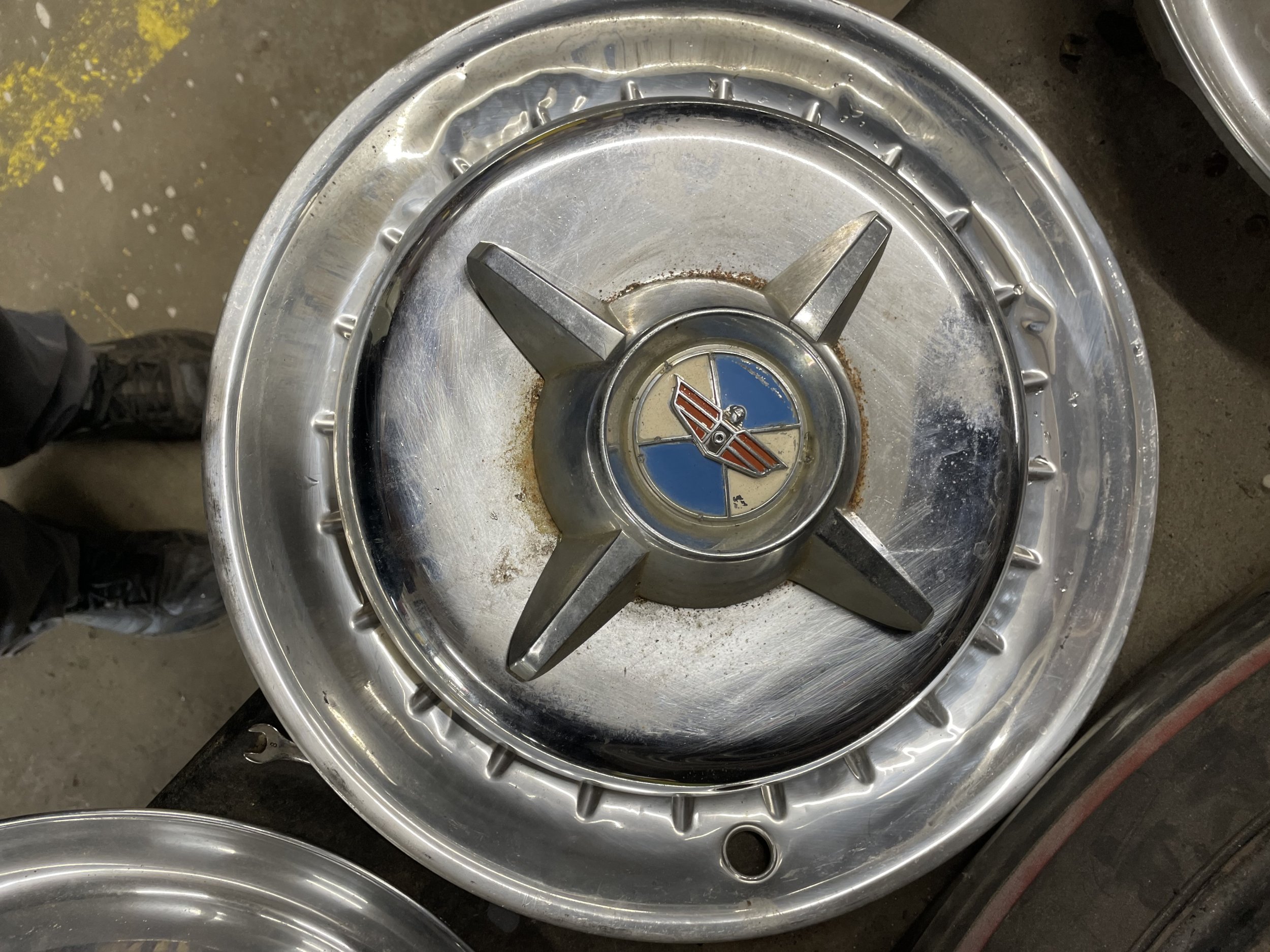

  14. Welp. Just bought these
  15. guthriesmith
    Joined: Aug 17, 2006
    Posts: 11,972
    guthriesmith
    Those are what we used on my son’s Edsel. I like them. :cool:
  16. I want the Centers out of those! I think they are 55's aren't they?
  17. 55 or 6
    Not sure
    Truckdoctor Andy and Stogy like this.
  18. Moriarity
    Joined: Apr 11, 2001
    Posts: 37,647
    Moriarity
    SUPER MODERATOR
    1954
  19. Thanks

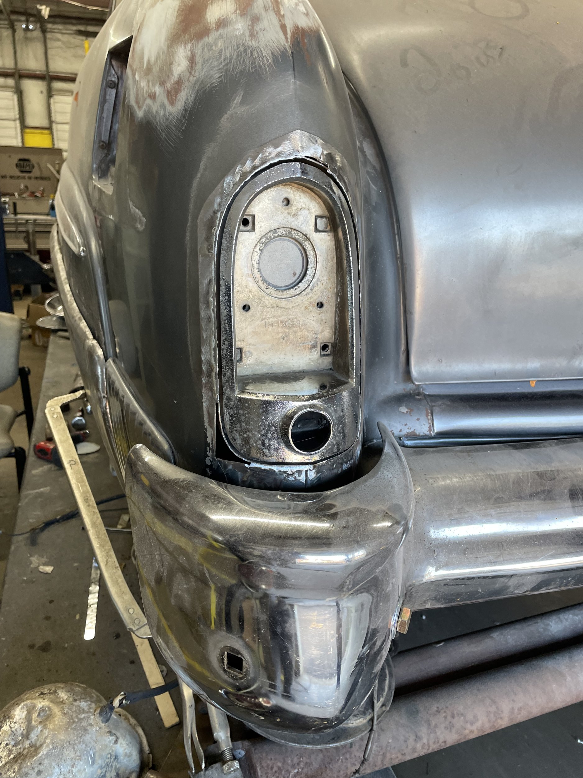

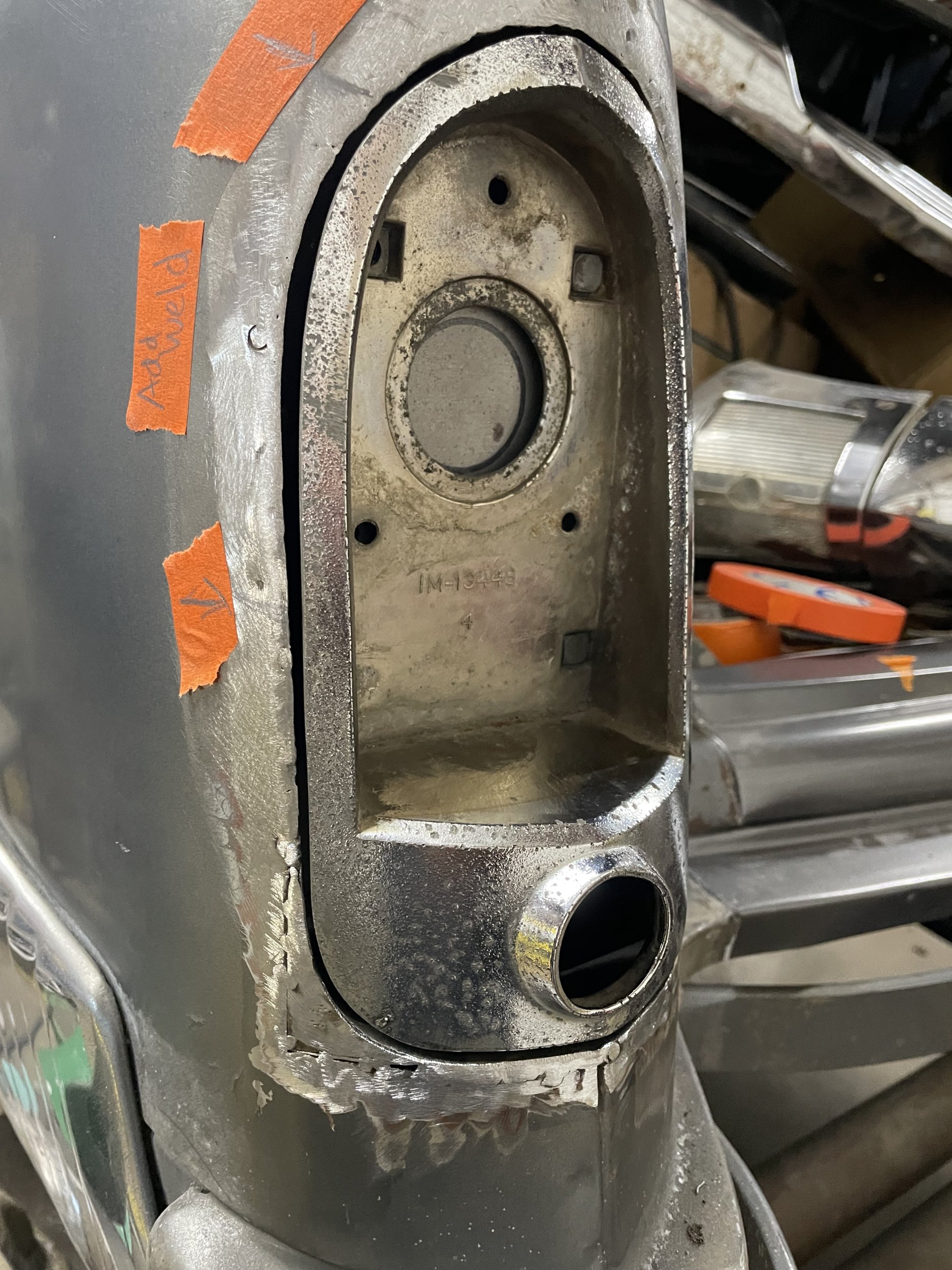

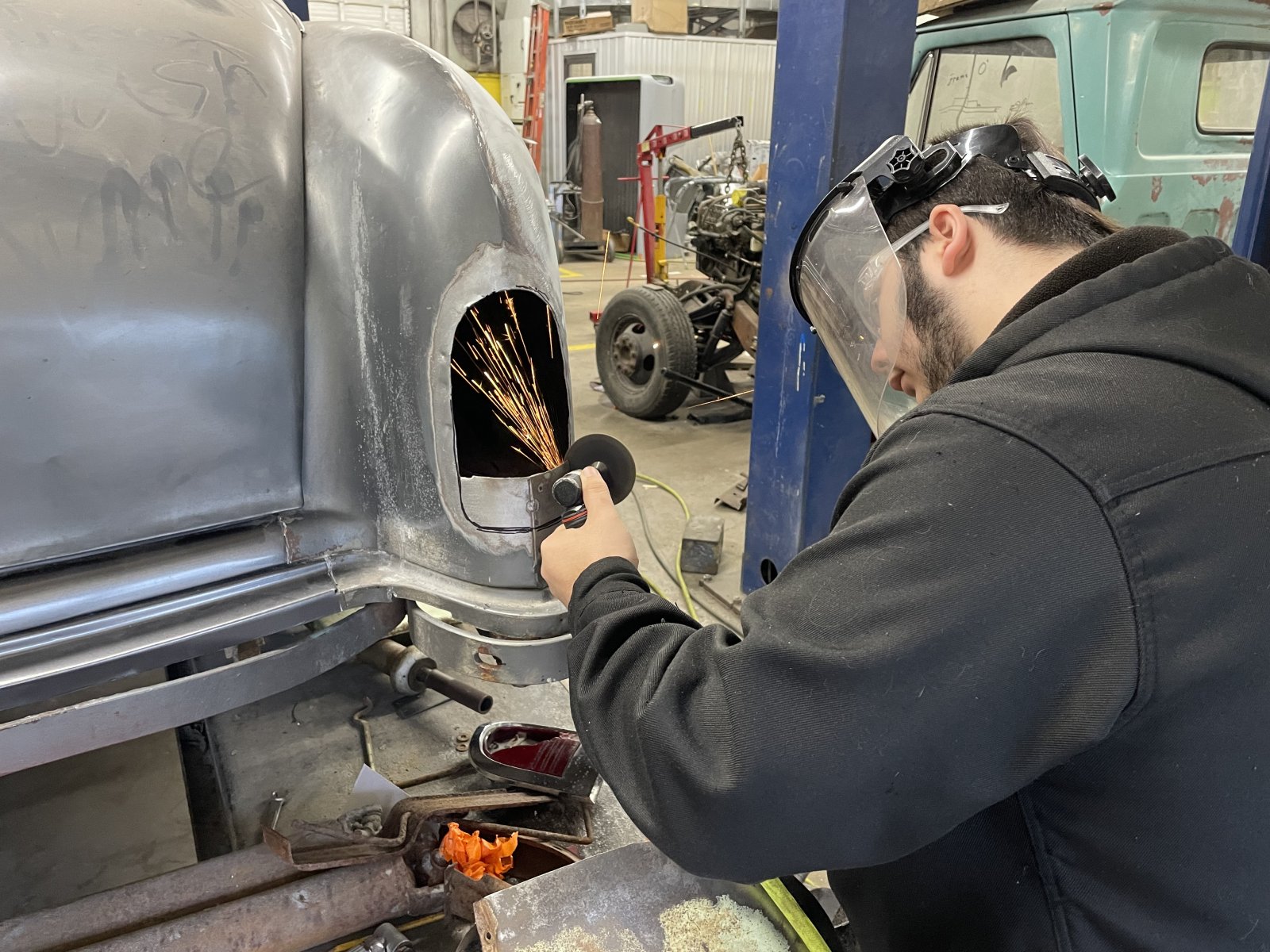

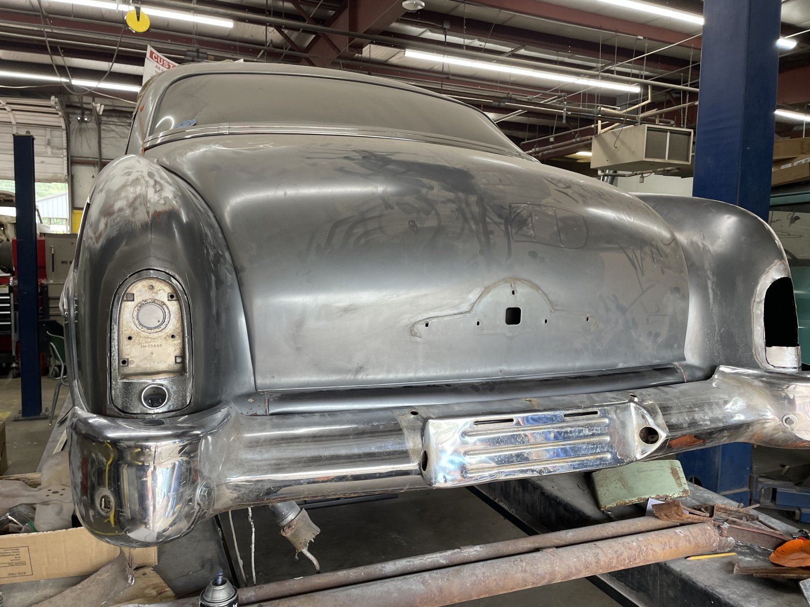

  21. Been a while. Fitting this in as it matches what we’re going over in cl***.
    A student is welding up taillight #1. The corners at the bottom was an experiment that we changed.
    Had a great fit but the upper corner was a little too wide. He’s doing great sneaking up on that.
    Student is doing super at his age and listening.he’s finally figured out to concentrate the grinding on the weld at this point.
    He understands we will work the inside gap edge after it’s welded.
    Progress is slow because I want the student to finish it with other cl***es involved as little as necessary. So he gets about 1.5 hours a day to do this.

  23. We just having fun
    I’ve got this kid one more year. Just filled out the paperwork for a miller multimatic with the TIG package.
    Hopefully I can get him some time with a TIG in his hand.
    He learns quickly and digs custom cars.
    He was building the fender skirts that’s taking forever so I got him finishing up the taillights to give him a break from the skirts.
    Im also planning to get a cheap planishing hammer with extra dies, turning in that paperwork tomorrow. I think that will definitely help him on the skirts. Plus we plan to do a custom body for our EV go carts if we can get that started back up. Kinda would like to do a mini drop tank kinda body. That would add to our English wheel, shrinker/stretcher, brake and mallets. These are the knock off tools but they’ve held up well so far. We have to use what fits the budget.
    The student that started the headlights is about to get back on em.
    Now his lazy instructor needs to ***emble the 283.
    I thought I had an OD flathead trans but it fell through. I ***embled a Muncie 319 last spring. So if I engineer a clutch fork set up I’m good.

  28. He got a little closer today
  29. He’s getting closer
    Rawrench, 4 pedals, jaracer and 11 others like this.
