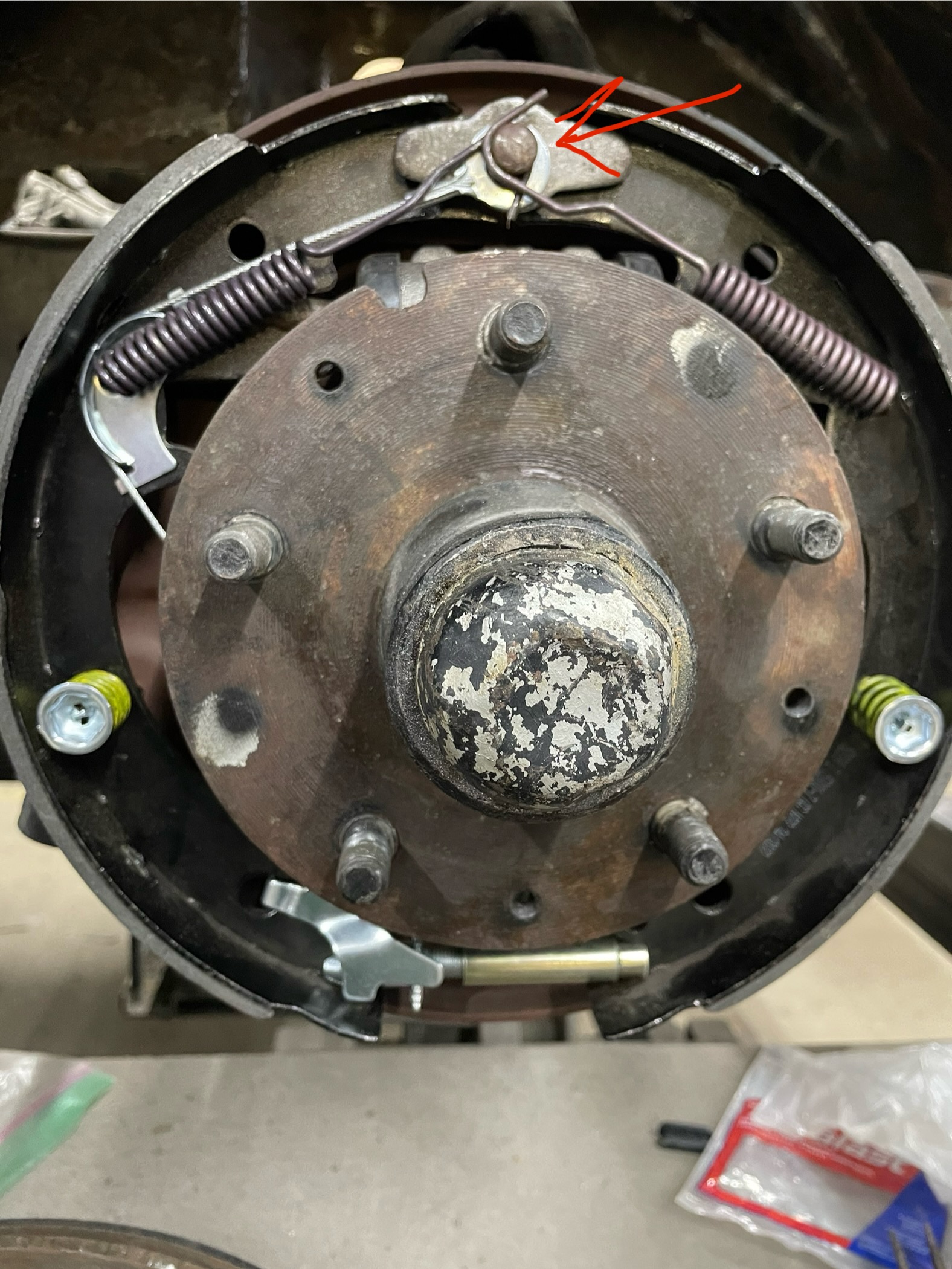

  1. I noticed when doing the brakes on the Merc that it shared shoes and other parts with f100s. Plus most of this stuff fits lot is the same era rides. So we did this
    added f100 self adjusters. Fits and works. But I need to either swap out the anchor pin (red arrow)or needs to be modified or change out.
    we”ll get it handled
  2. I have done that before and did 2 things to help the fit of the Spring. The retainer plate that keeps the Shoes on is quite thick. I took them over to my Belt Sander and removed about 20 % of the thickness. That can be some fun but got it done. I ended up using my Stud Gun and sticking 2 nails on each wing tip so I could get some pressure on the belt with it before they Flew away. Next was a Chain Saw round file and gently filed on the back side of the head of the dowel on just half of the back side where the spring makes contact. I think that was somewhere around 1975 and they are still doing the job. You just have to make sure when doing brakes to put the springs back on the same way so it drops behind the dowel head correctly.
    drdave, ffr1222k and anthony myrick like this.
  3. Our auto tech instructor just visited, said he might have some shoe retainers that are thinner.
    If not, we’ll thin the ones we have down.
    Just needs a little for that spring to hook correctly.

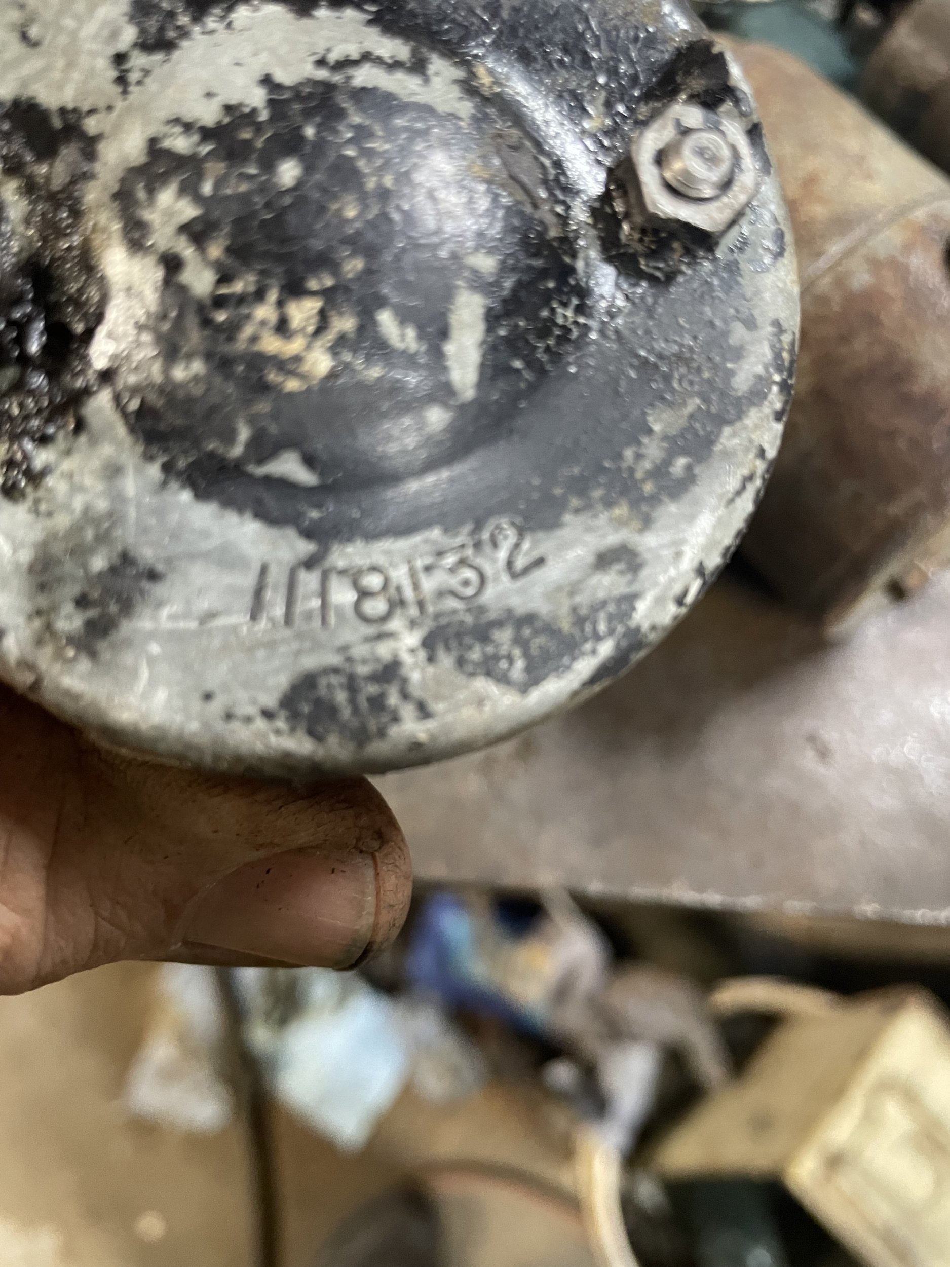

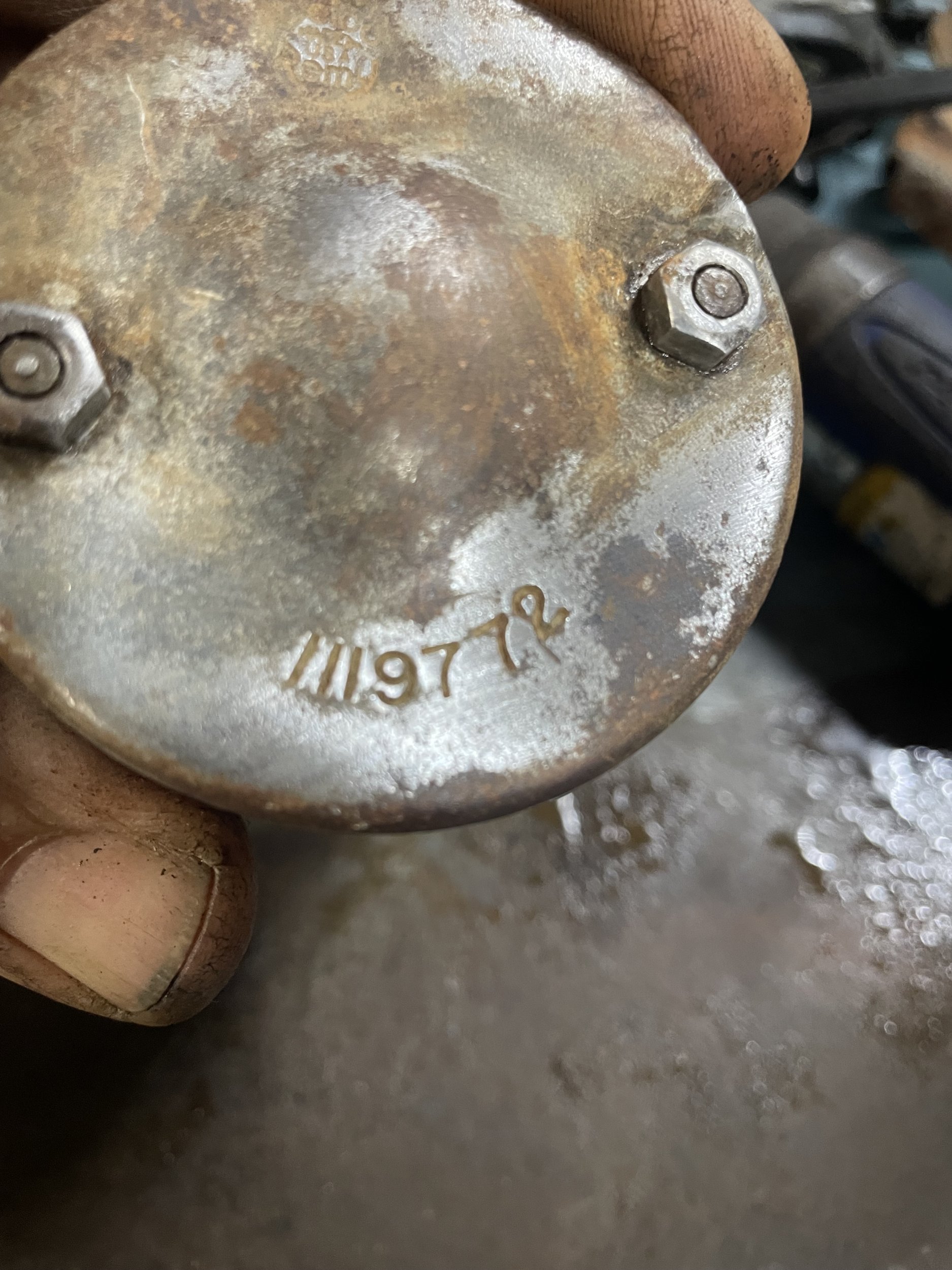

  11. Look what I found
    Okie Pete, Squablow, Oneball and 4 others like this.
  12. Got a chipped tooth or 2 on the cluster. Typical 1st /reverse non sync looking gear. The cluster and 1st/reverse look better in my no -OD trans.
    I think I’ll clean it up and use it. looks like most of all the other 3 speeds I look it
    Squablow, Okie Pete, bobss396 and 2 others like this.

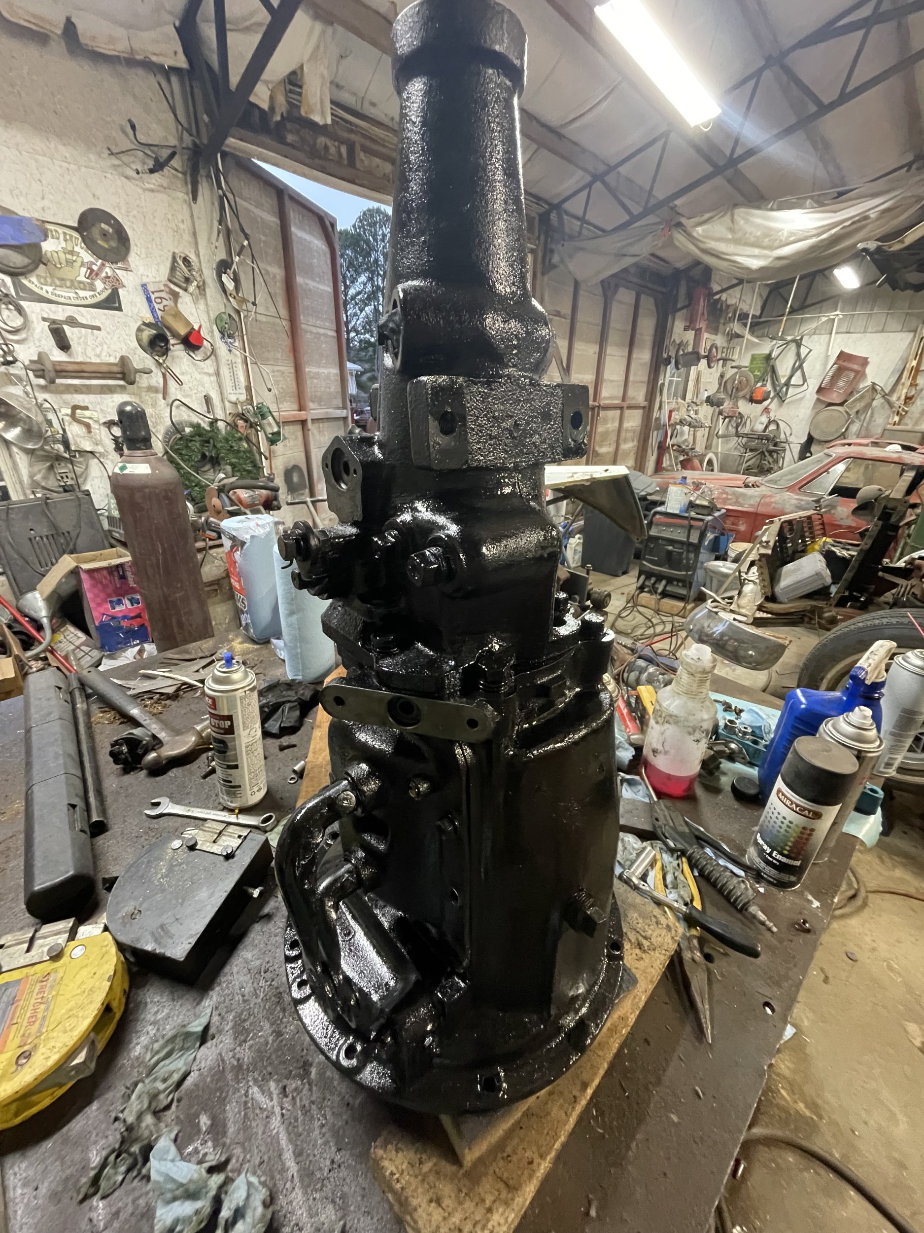

  27. Rattle can rebuild on the trans
    the solenoid with it was 6v as expected
    the one from my parts stash came up 12v on a Google search
    And works. Now to get the reverse switch figured out.
    The GM set ups I have don’t use one. All of them have internal reverse safety mechanisms.
    But the switch would also shut off the solenoid causing the OD key to disengage. I kinda like that
