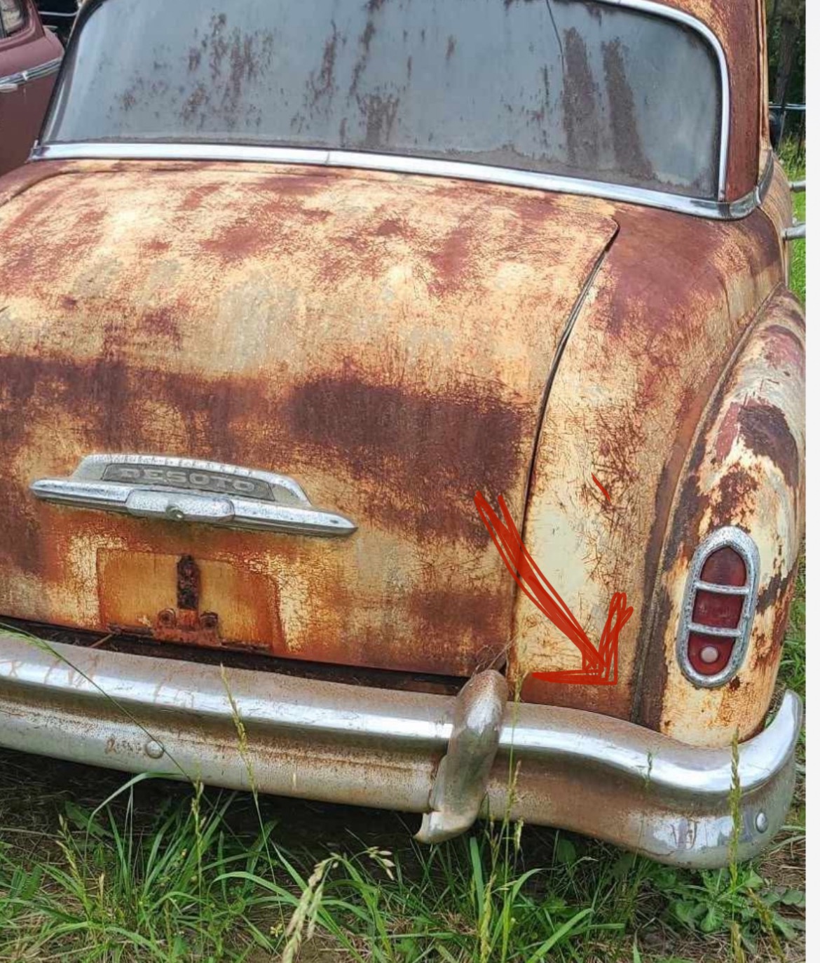

  2. That’s cool
    those tail lights and trim……. Mmmmmmm

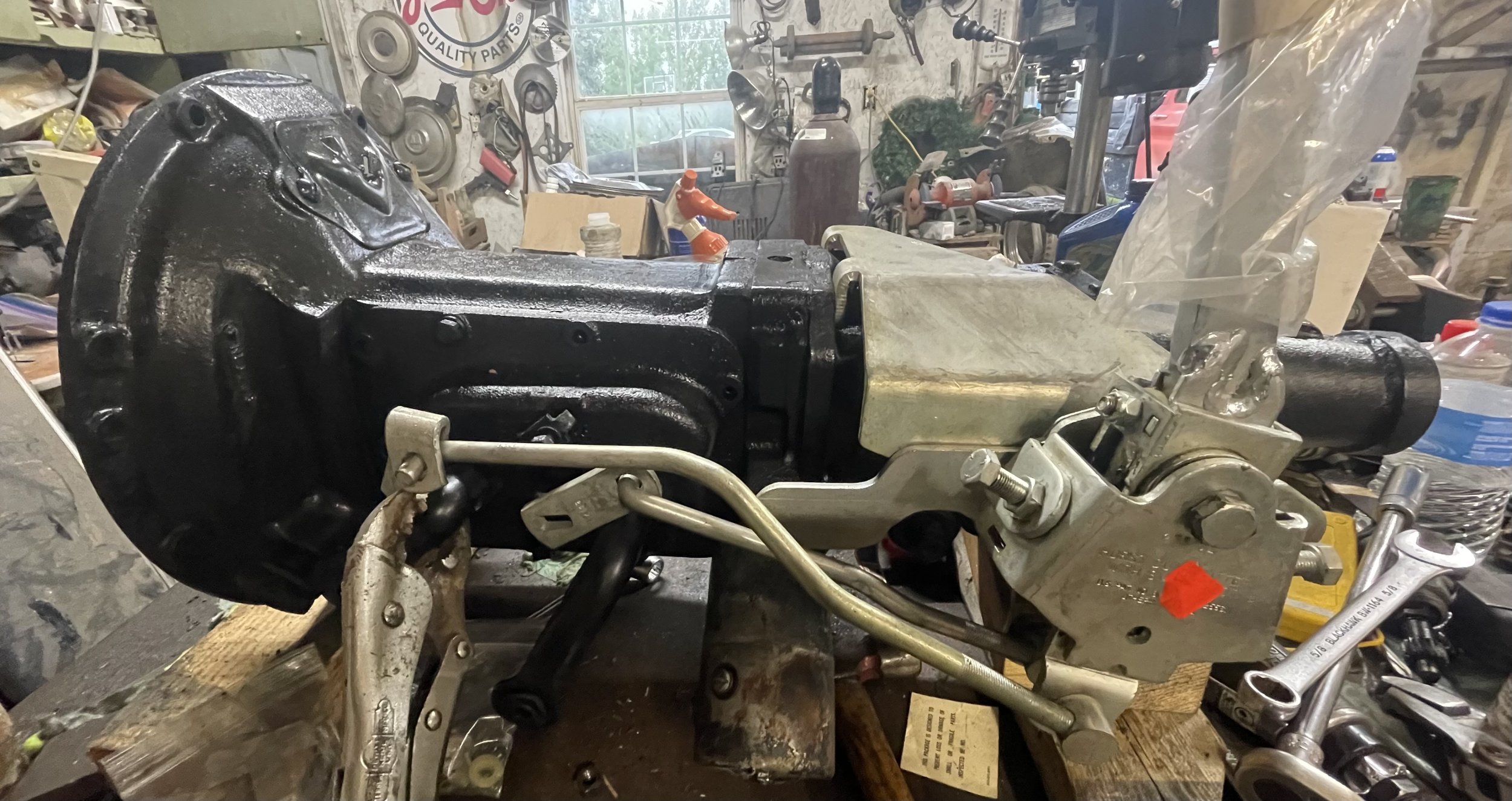

  9. Messing with this shifter

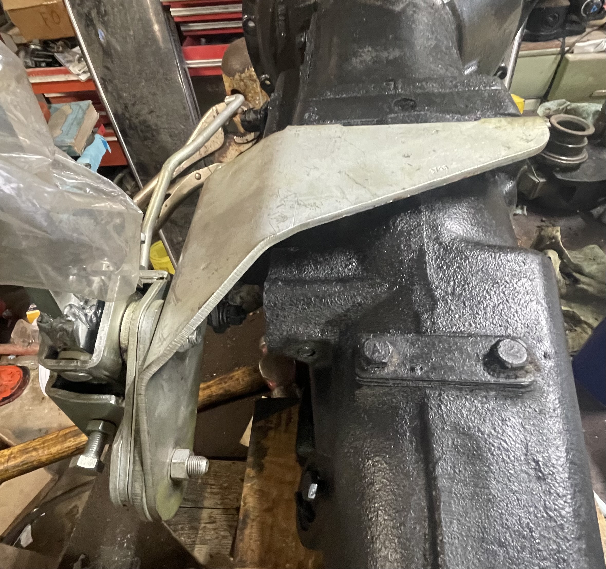

    The shifter said 52 ford with OD. Took the trans to Rocco’s and looked thru shifters and made sure the brackets were good. They fit perfect except needs a touch of clearance for the OD cable lever. The mount braces for the trans and solenoid perfect
    the rod length look good. The levers won’t work.
    If I use this, I have an extra set of merc shift levers I can cut and weld the Hurst levers to
    wonder how this set up fits inside the car?

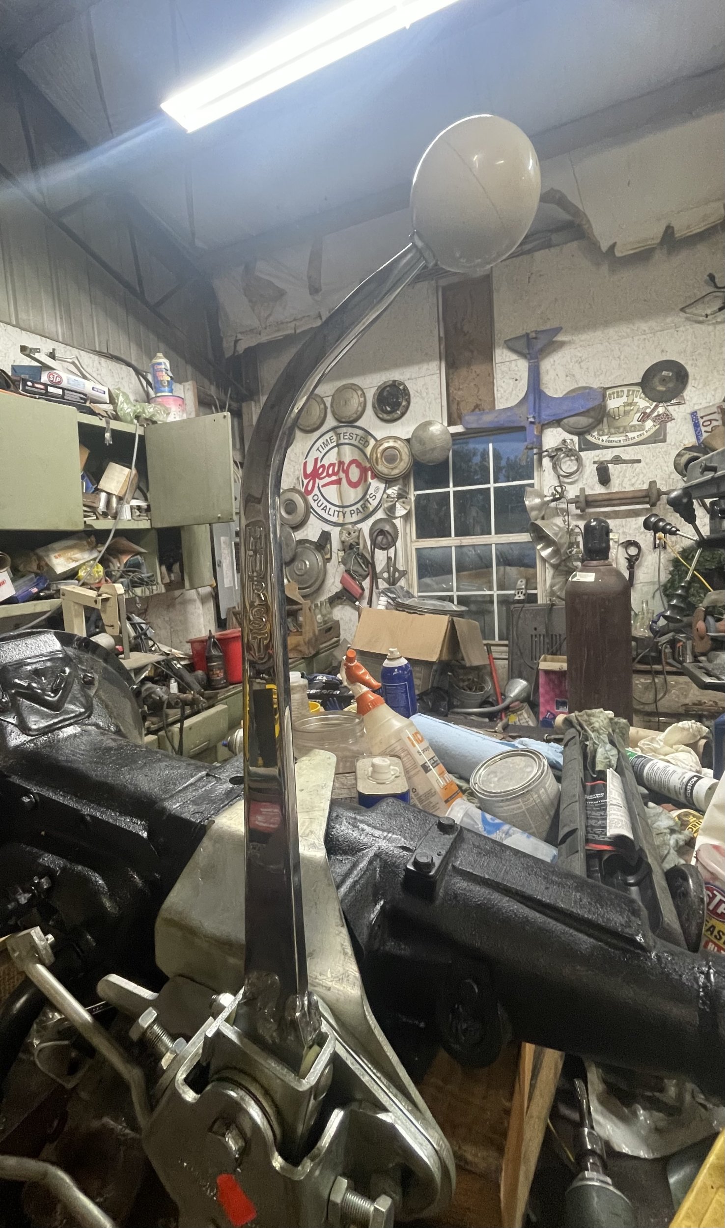

    still not convinced I’ll change from column shift but couldn’t p*** up the deal

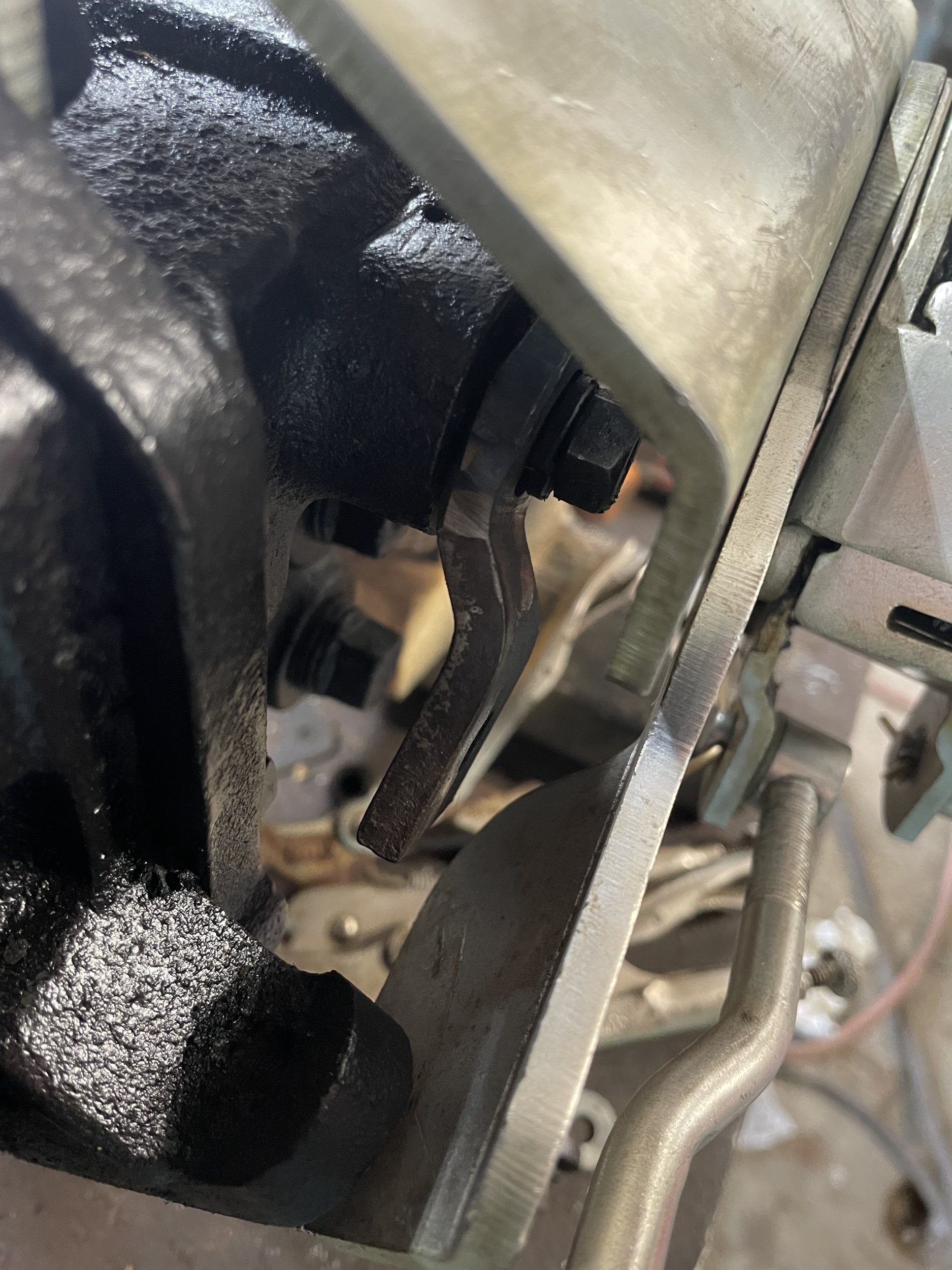

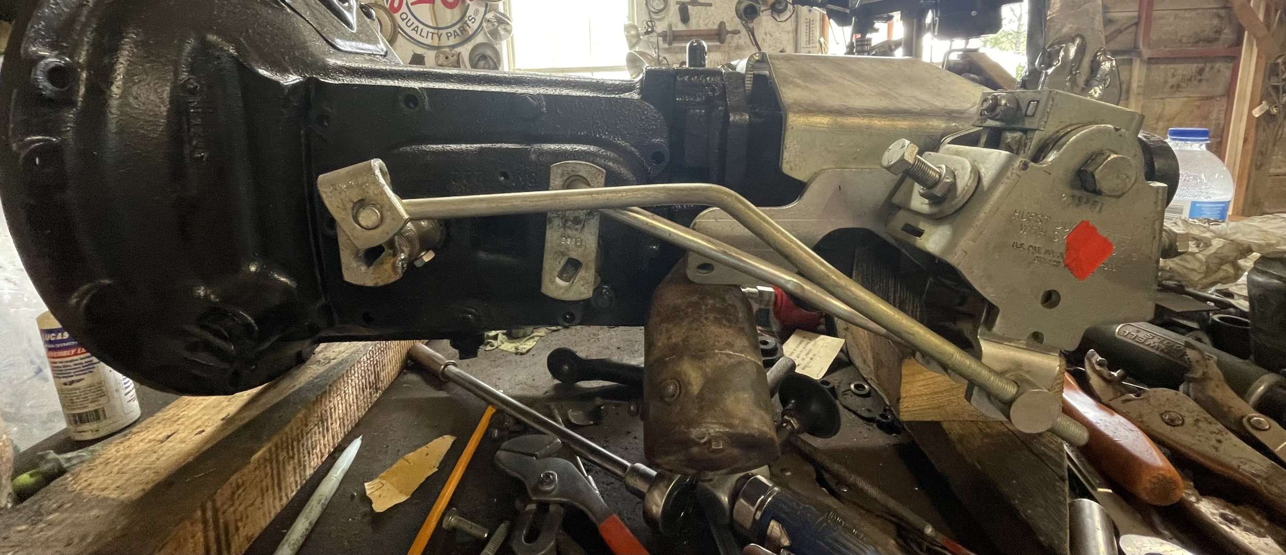

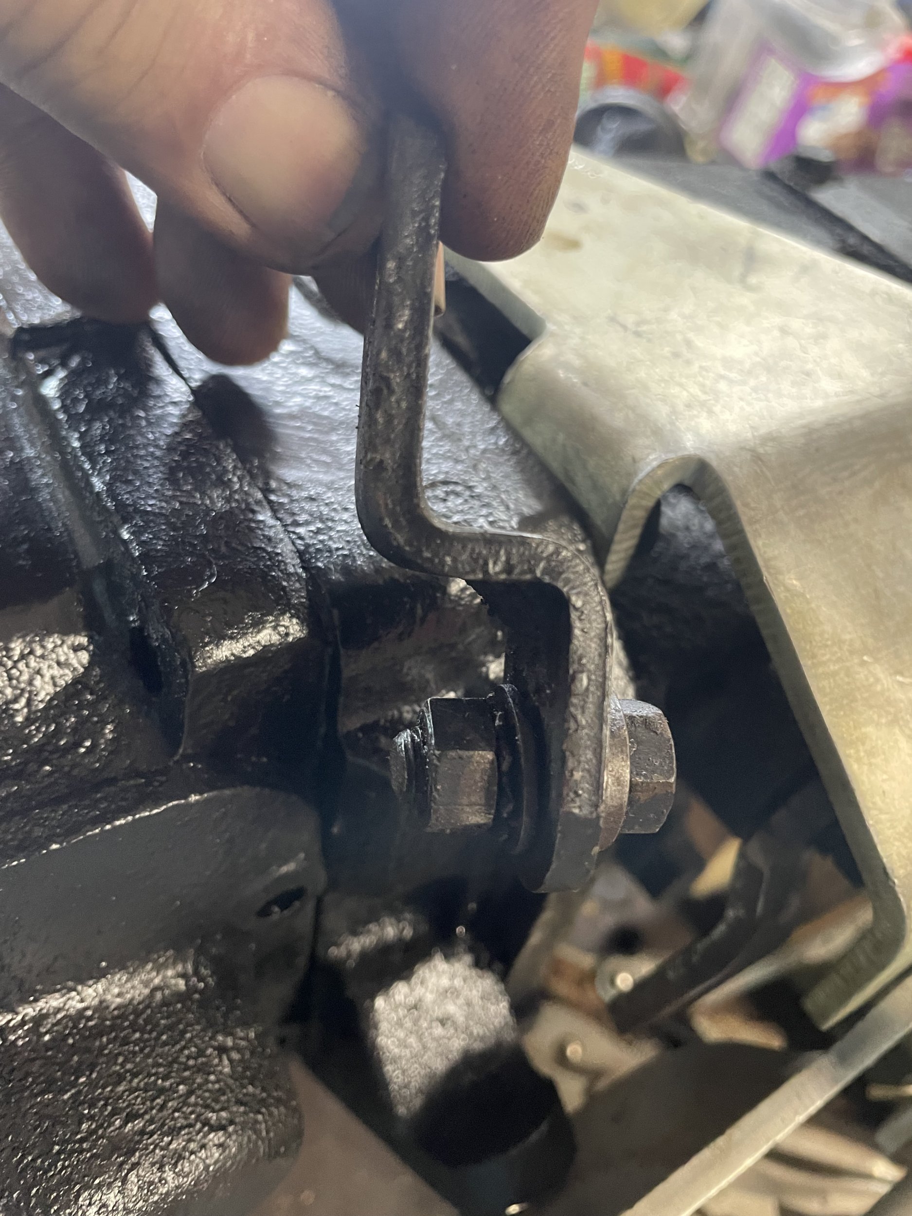

  19. Shifter arm adapters cut and tacked to the new arms.
    Found a piece of steel pipe the same ID of the shifter fork OD.
    shifts like a brand new shifter.:) :)
    The original OD cable lever hit the shifter mount.
    neighbor had a random shifter lever in pile of parts with the correct slot. Just had to round the corners. Done

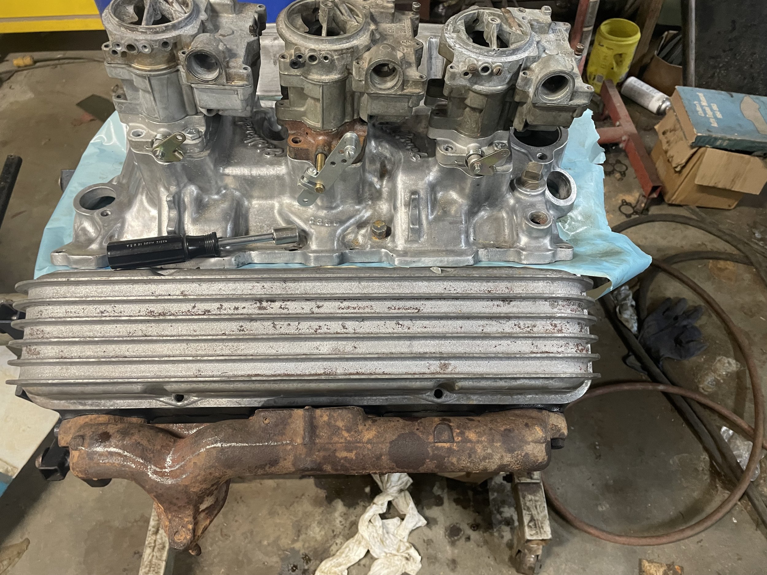

  20. Messing with carbs. Thinking I’ll go with a manual choke for the center carb. …….maybe.
    looking for a single cal custom valve cover. Can be damaged. For an experiment.
    So some not so good news. Finally swapped up all the valve springs. Good.
    But I noticed a good bit of air leaking out of cyl 8.
    You can hear and feel air around the wrist pin area. So it’s coming thru the oil ring holes in the piston. So I probably broke a ring

  24. It’s got compression. When I hooked up the air to the cyl it slung the wrench on the crank across the shop.
    bchctybob, Okie Pete, Dedsoto and 5 others like this.
  25. Put some oil in the cyls and rotated.
    Number 8 has foamy oil coming out the bottom of the piston.
    welp
    bchctybob likes this.
  26. warhorseracing
    Joined: Dec 26, 2006
    Posts: 2,811
    warhorseracing
    from cameron wv
    Could possibly be just stuck rings. Pop the piston out and check it out.
    anthony myrick likes this.
  27. I’ll get it apart next week.
    Double check all of em again. I was having an issue with my piston installer.
    Pan still off so it’s not a big deal. Just a head gasket plus whatever we find
  28. Finally yanked the head.
    Pulled the piston. No broke rings. Bore looks good. Piston looks good.
    The rings were I guess stuck in the ring lands 180 from the gap.
    Or, didn’t spring out and needed a slight twist for them to spring loose.
    Sourse for the air p***ing by I guess.
