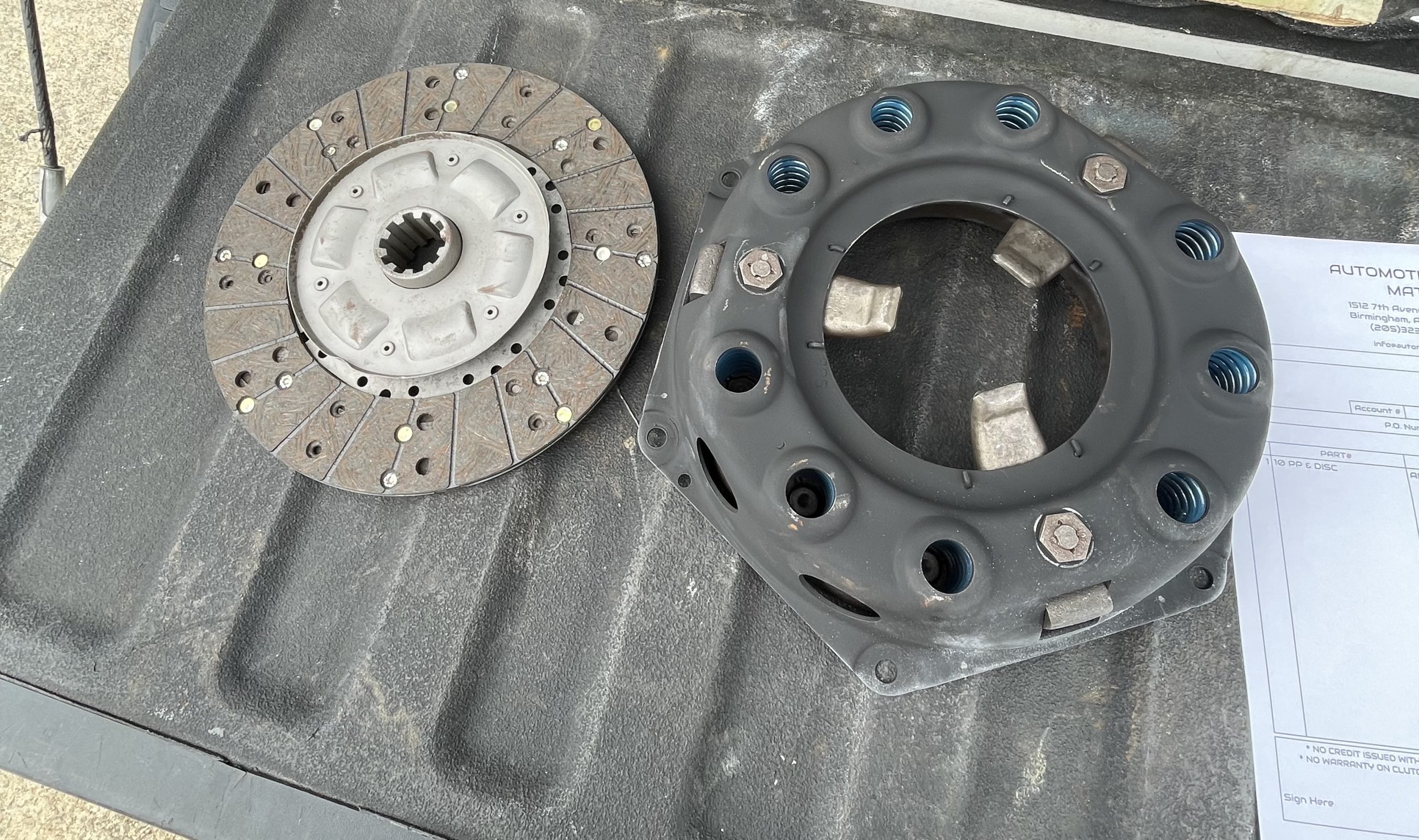

  1. Local friction shop rebuild. $105.

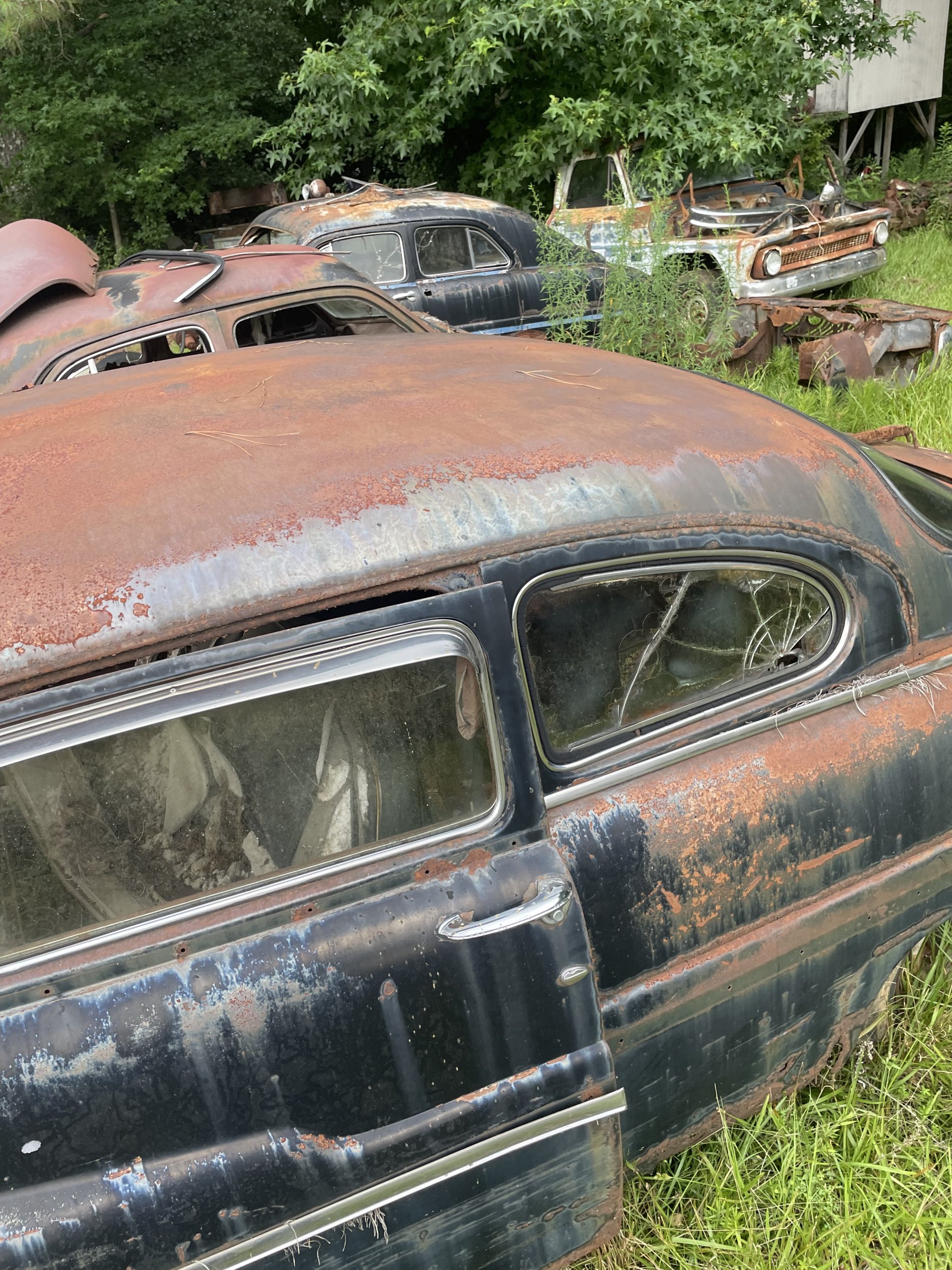

    several years ago, an older hot rod guy gave me a beater 51 merc. Rotted with the rear axle ripped out like in American Graffiti. Had the correct core clutch parts. Amd a std merc flatty

  2. I'm surmising you must have quite the Backyard collection.

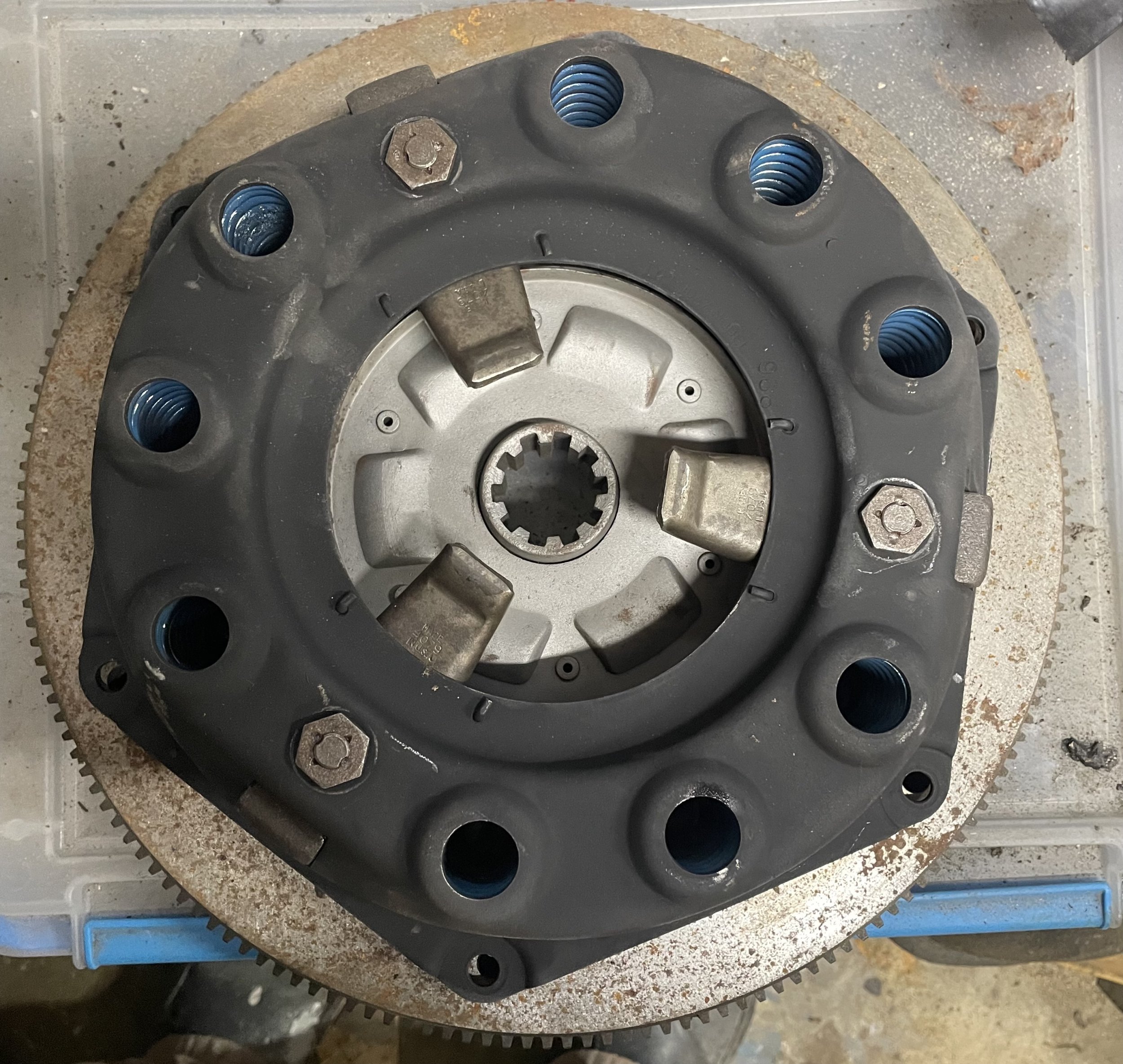

    Came in handy. For the SBC to flathead I had an adapter I bought for $50 over 10 years ago for the heck of it.
    Had the correct SBC FW and correct clutch pieces in my junk yard plus a few 3 bolt starters.
    Found a nos pilot bushing adapter for $15.
    so when I get a new TO bearing I’ll still be under $200 for the swap.
    Not bad

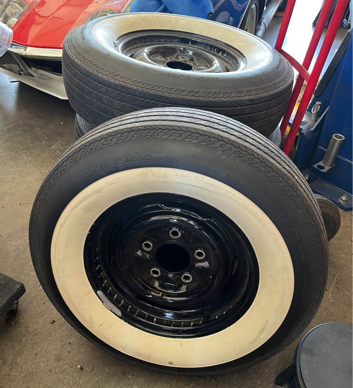

  6. Picked up some H78s last night.
    The big pattern ford wheel have been blasted and painted. So that saves a little work.
    The h78 is a tad taller but these are fine for now.
    Plus I dont need the factory merc wheels that I’ll probably sell now.

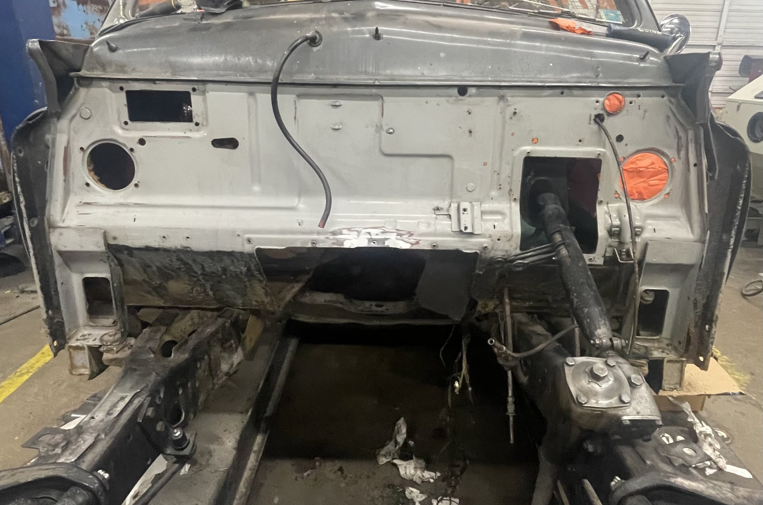

  12. Cleaning up the firewall. All the heat and ventilation pieces will probably be painted gloss black. Not sure on the firewall color. Leaning towards semi-gloss black. Not totally against the dark grey metallic that’s on the outside of the car.
    the trans adapter hit the firewall where the top center bolt is. My block doesn’t have that hole
    So we hammered a small recess for that to clear. Got it little more uniform than in the pic. Will mimic that on the trans cover Didn’t need much.
    Frame and suspension will be flat black.

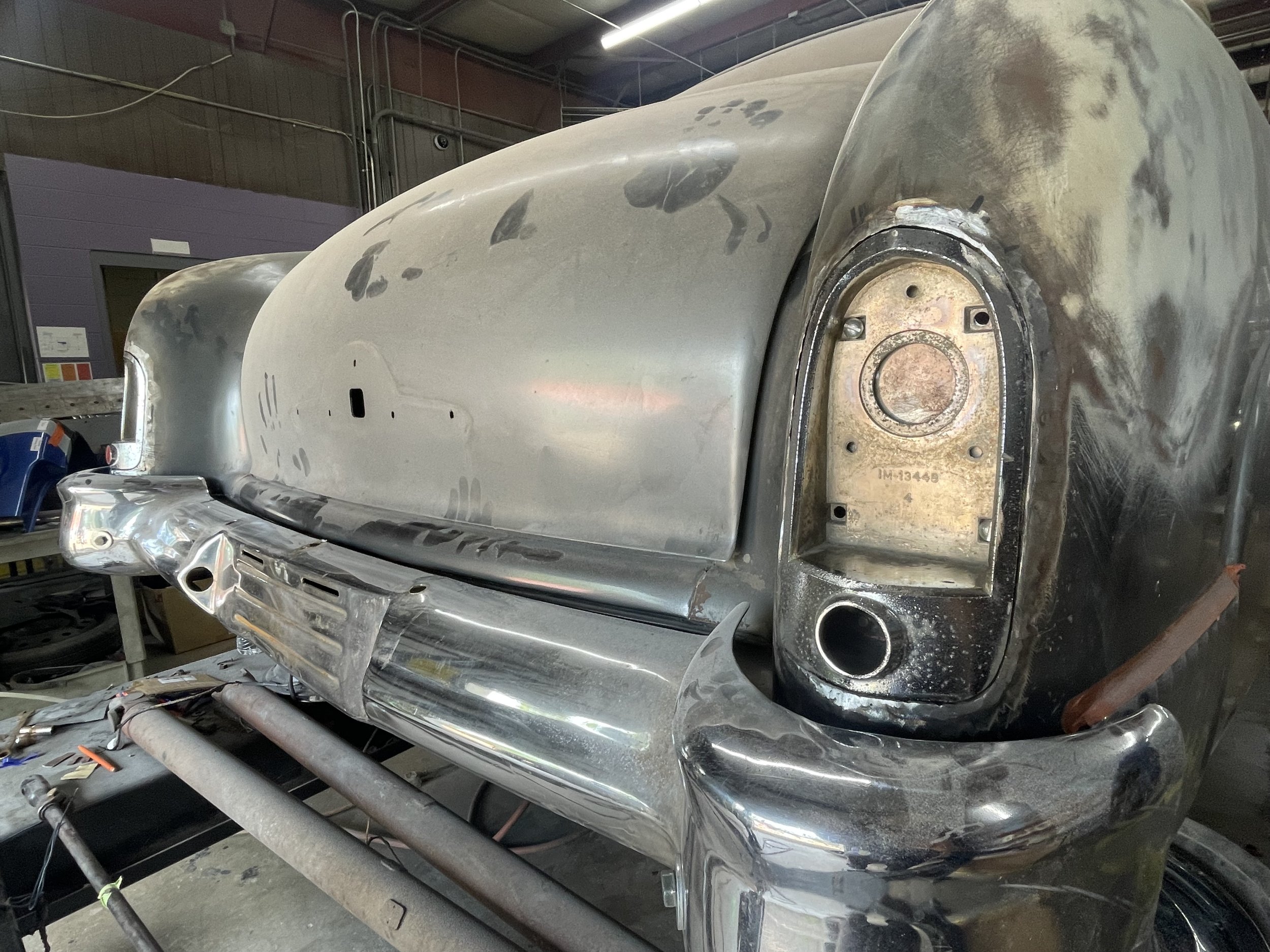

  16. Nice Fit! Good work on the edge to housing.
