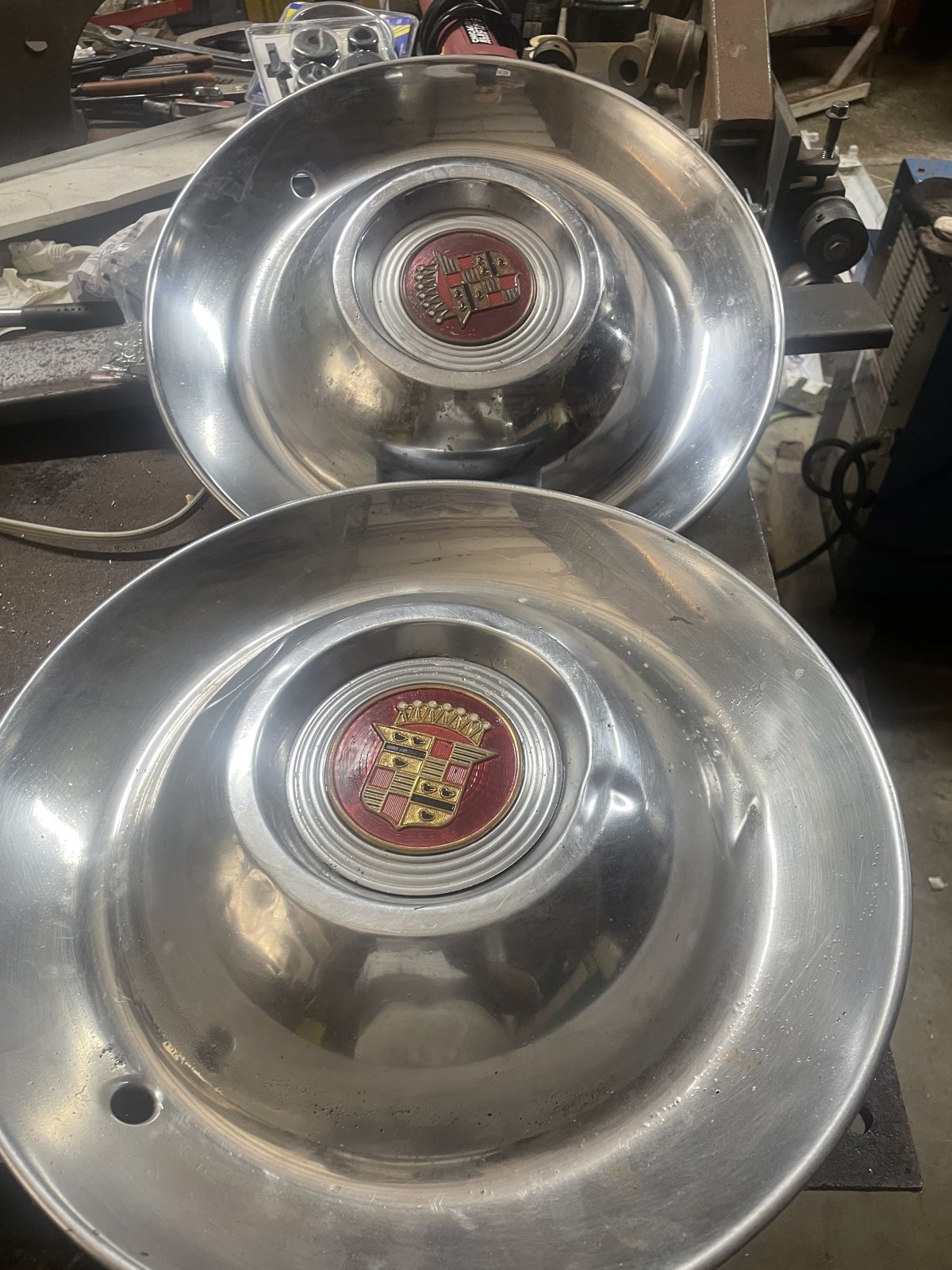

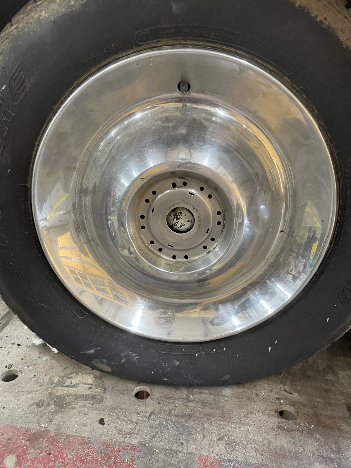

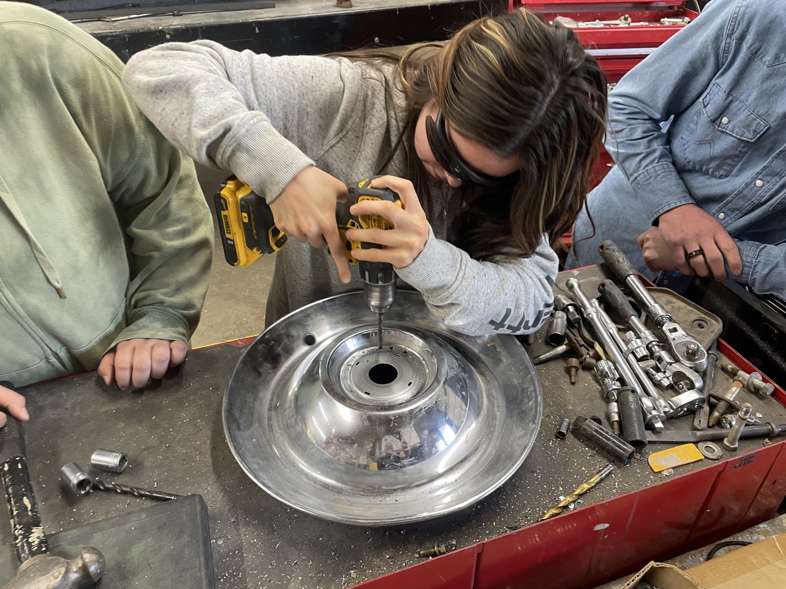

  6. Found my caddy caps. Need to find out what’s needed to mount these.
    these ford HL bezels were a birthday present from the wife

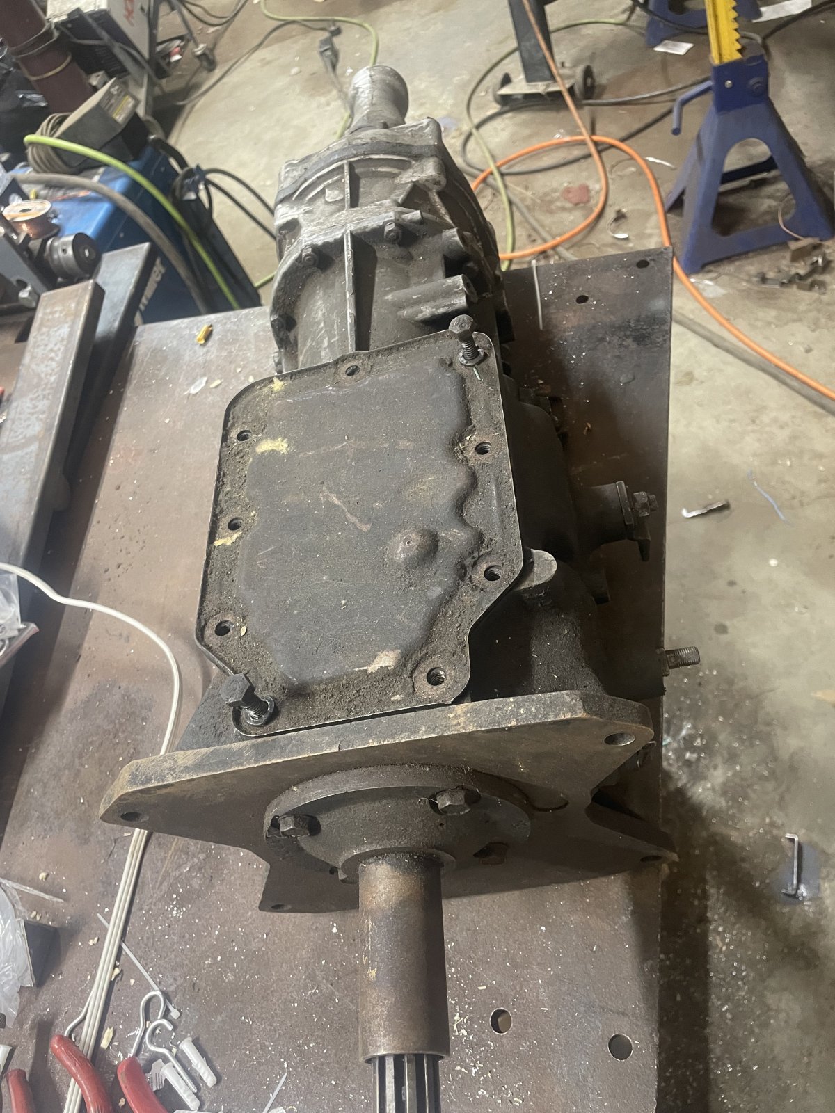

    I picked up this ford/AMC toploader with Lay**** OD
    Wonder if this can be adapted to fit the y or stamped merc bell?
    I guess I got some research to do

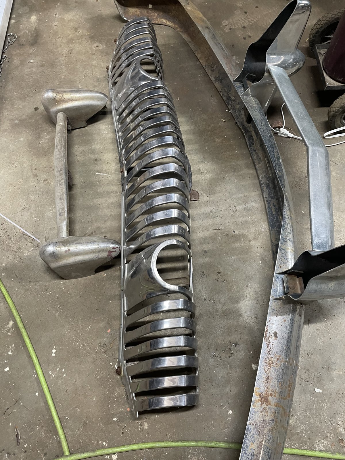

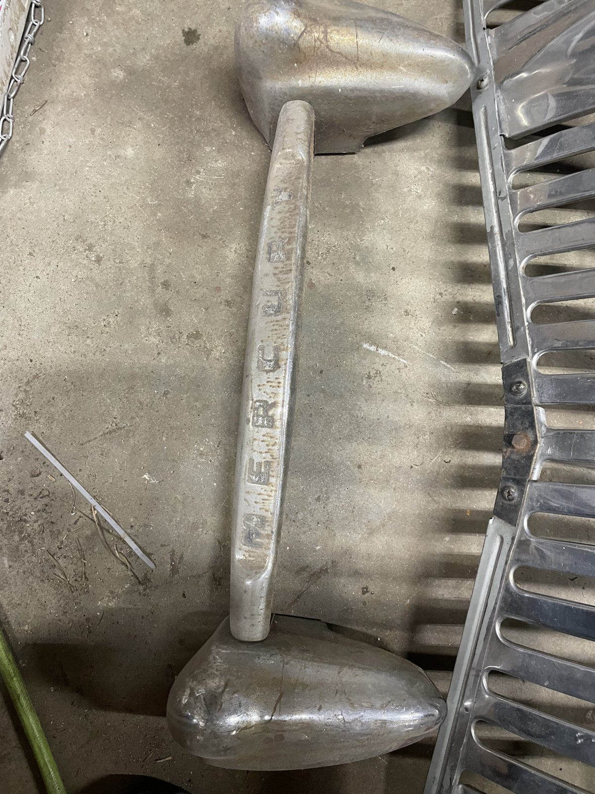

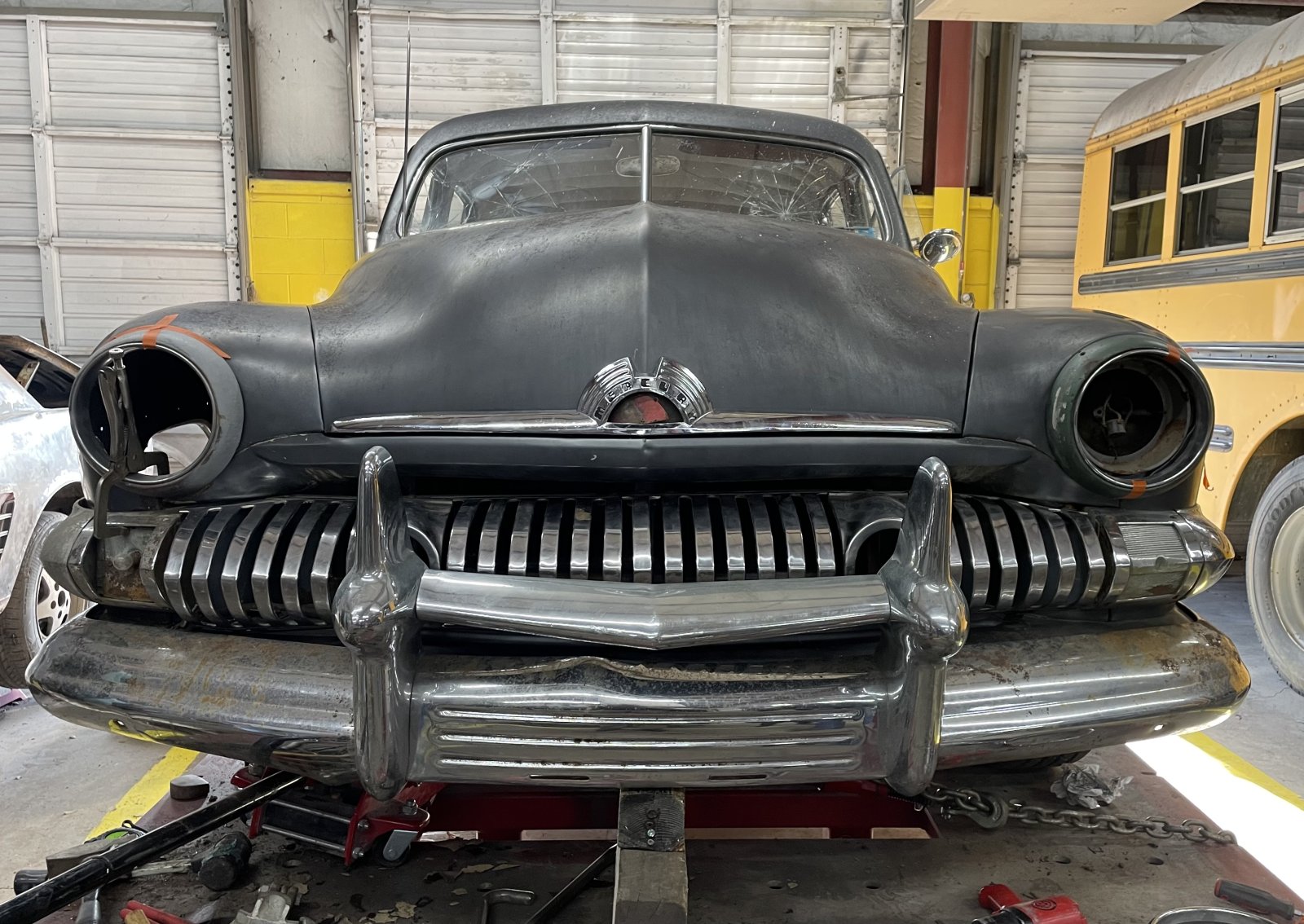

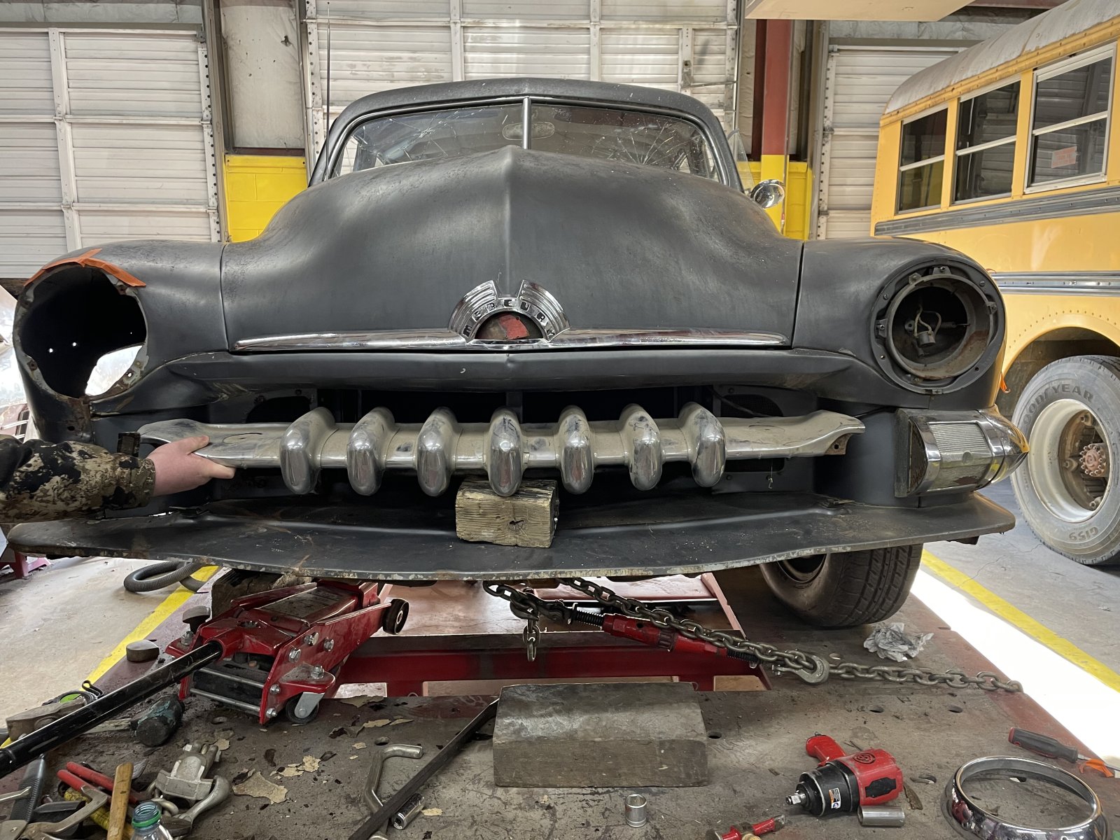

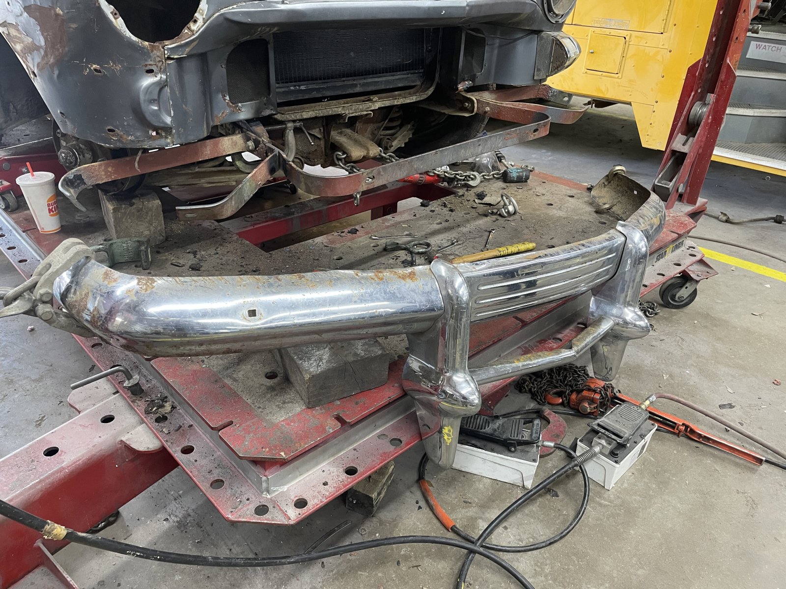

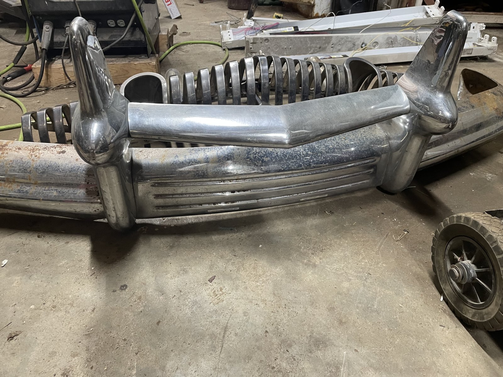

  7. The grill was tweaked. Still needs a little more work but the twist is gone. Should straighten on up fine
    49 rear bumper guard?
    We’ll mount the front bumper back on and pull it while the car is on the frame bench.
    I’m digging these m***ive bumper guards
    dang a Desoto piece

    If your Merc used the stamped steel 1/2 bell housing Model Engineering (MEC) in Ohio makes an adapter to mate a Ford top loader 4 speed with the wide bolt pattern like the AMC unit in the photo you post. Not sure about the input shaft length etc. but it might be an option. They have a web site but IMO it ****s. Best to call. You'll probably have to leave a message but you will get a call back. I had one of the MEC adapters a few years back and it was high quality.
    330-644-3450

  26. A Boner
    Joined: Dec 25, 2004
    Posts: 8,162
    A Boner

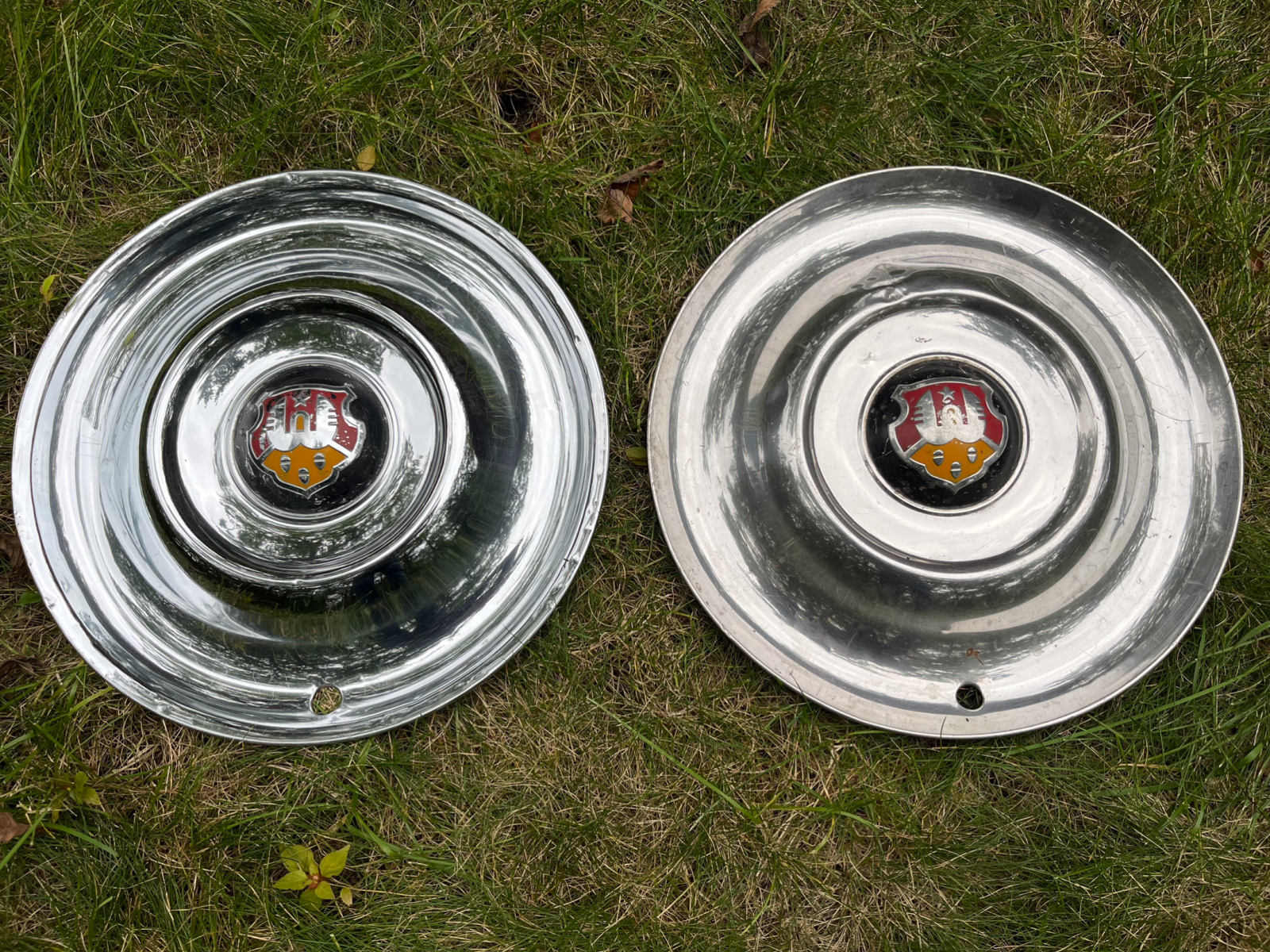

    3450E7F7-267A-4764-8ACF-D1B26F936A83.png Guess there isn’t any need to light a fire under your ****!
    Looks like the “kids”are having fun. Encourage them to take pics…if phones are legal there. Wish I had some car related pics from my youth, with cell phones there is no excuse not to.
    FYI, 1952-53 Olds wheel covers should snap right on…

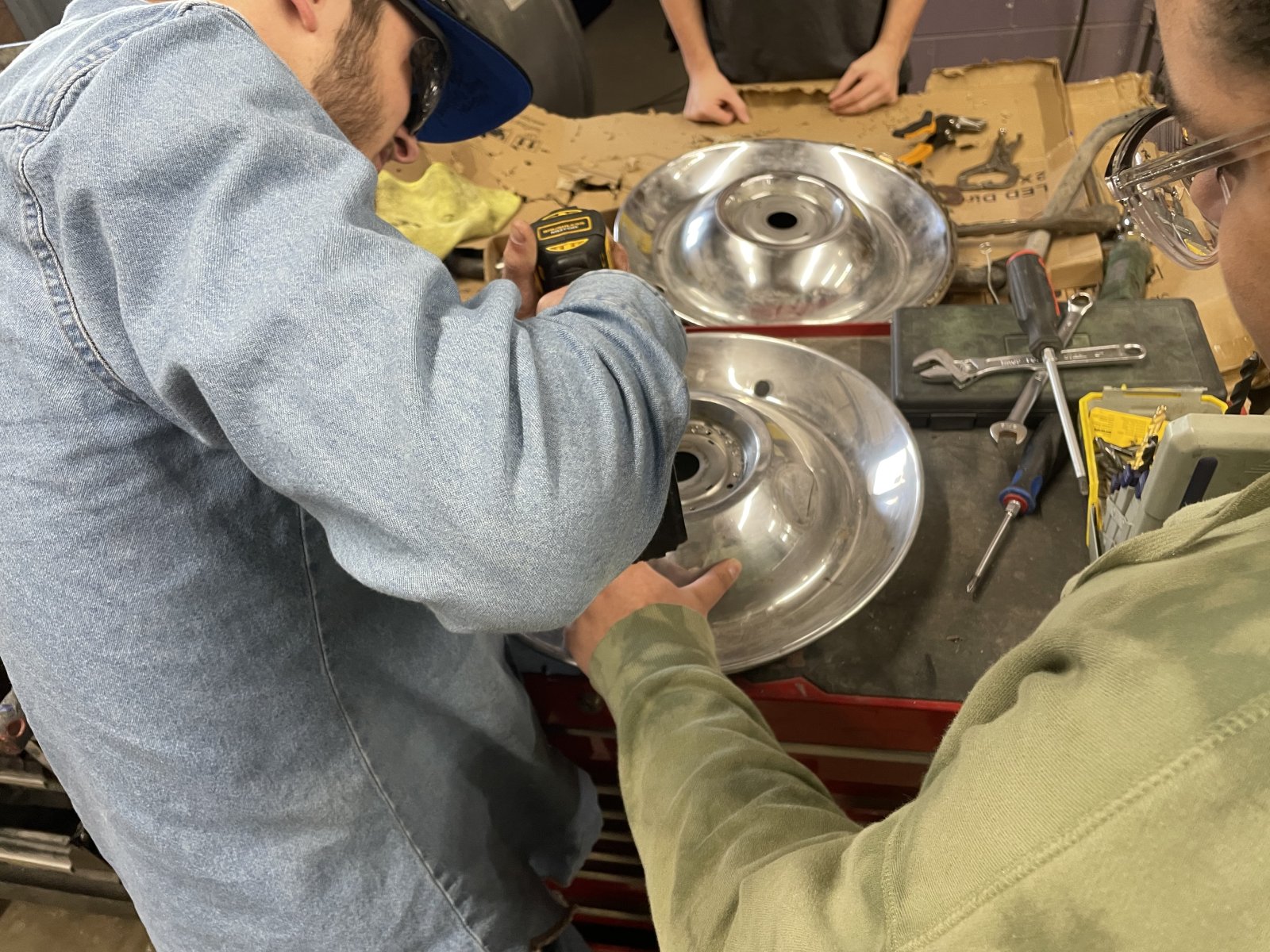

  27. CC0EC93E-E935-44F4-858F-1215E95963B1.jpeg 0687D417-3DBF-4075-81B1-E5FADB8BD864.jpeg

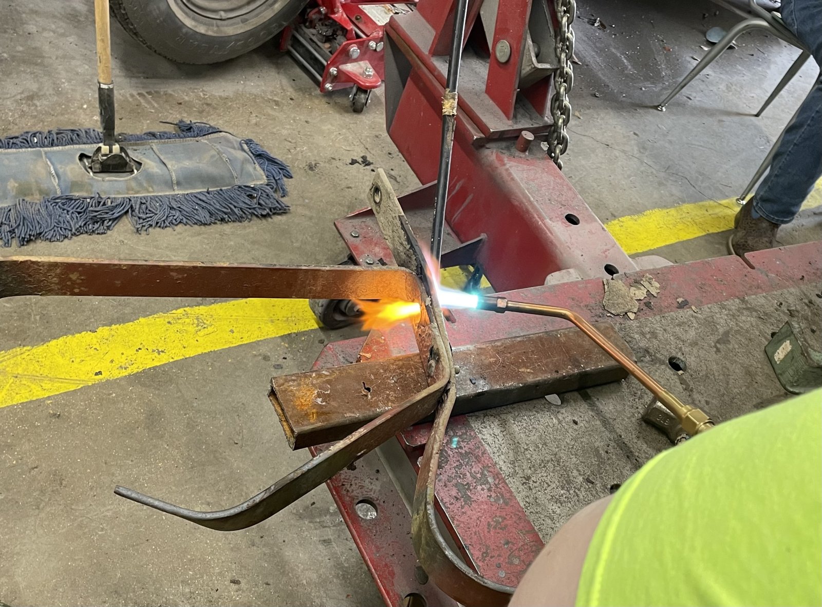

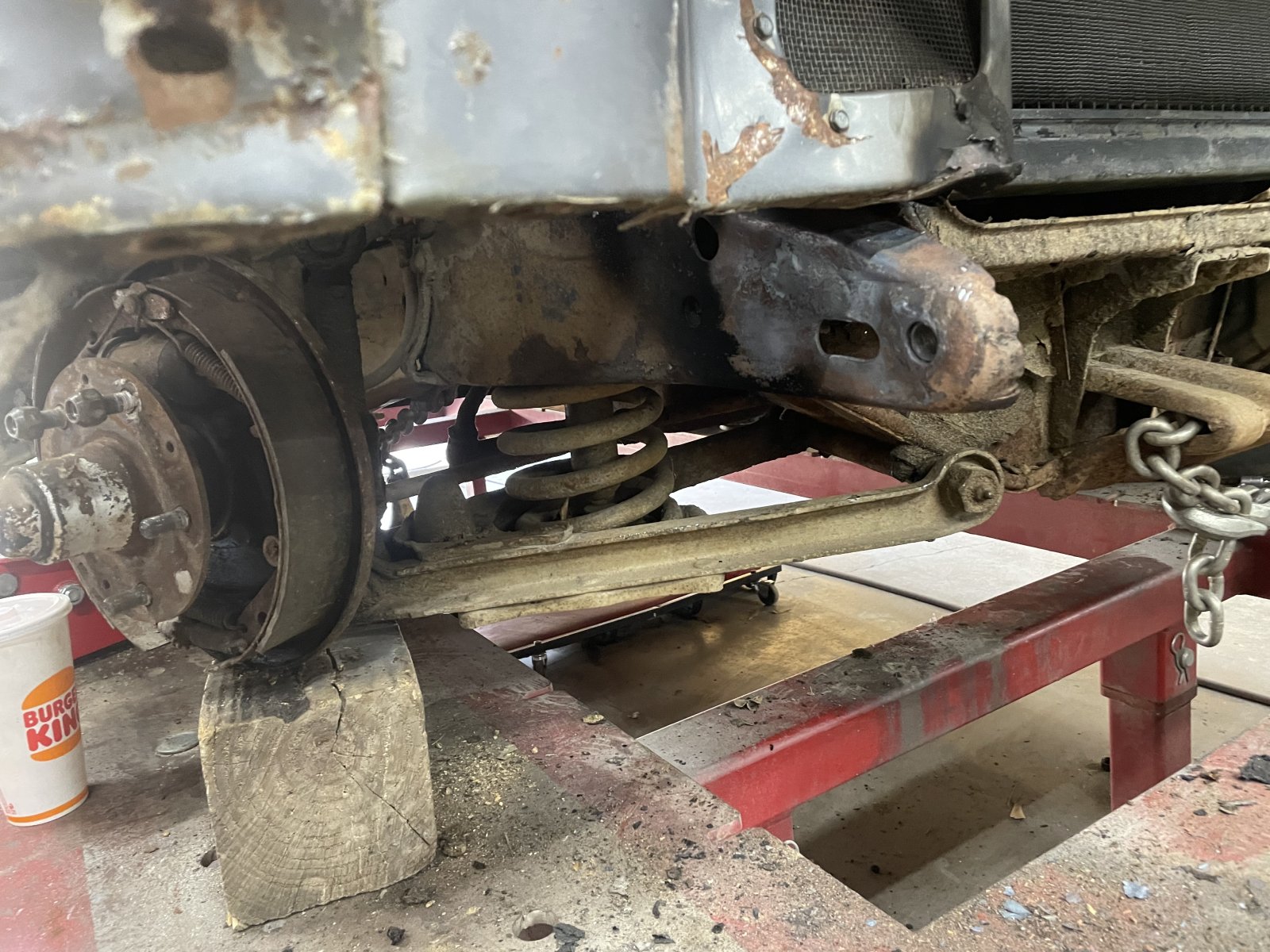

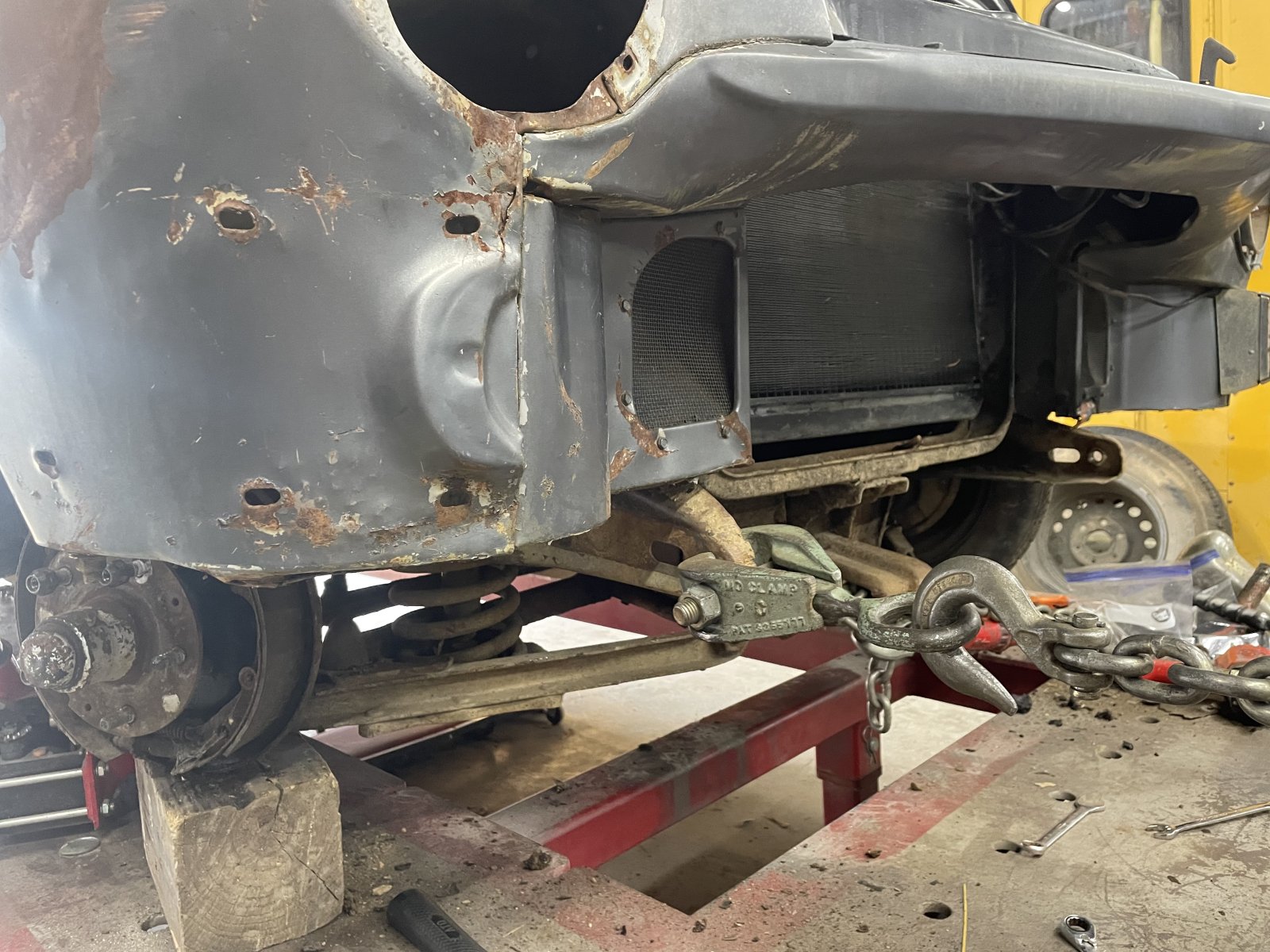

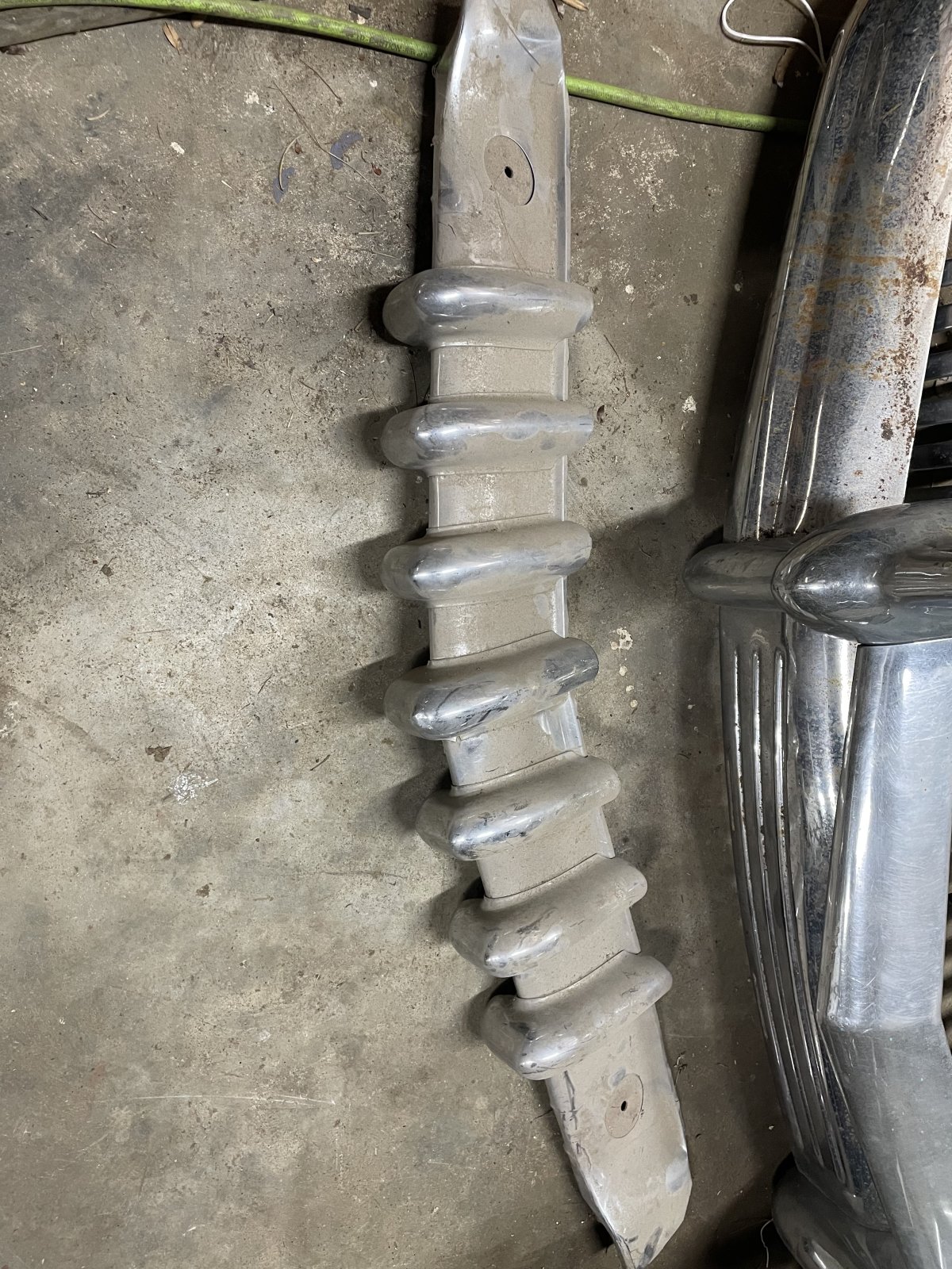

  30. Little frame horn love
    16AB7839-7905-4F6A-8794-C34261D36F40.jpeg 7527B1B7-E17C-41D8-9DEB-E6384D39B96F.jpeg
    Needs a little more cosmetic work but it’ll do for now.
    bumper bracket m***age

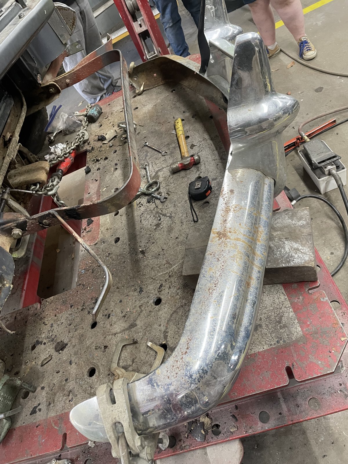

    E88245F1-C91E-470C-97E7-E020F14D4167.jpeg 3D7BB531-93F2-4AF9-AE02-B87F4B52EDED.jpeg

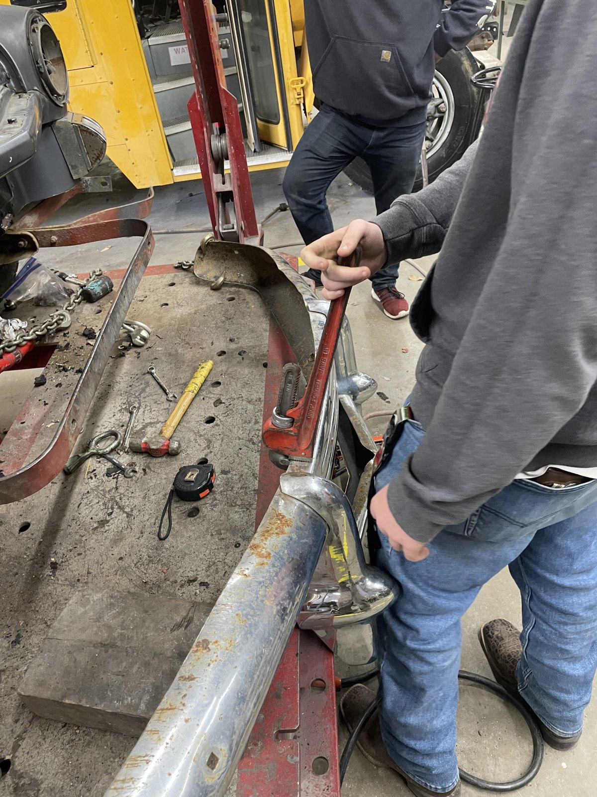

    Front bumper needed a little stretch
    1EEEDCE1-E91E-4C70-A6DE-EE40D6F1F943.jpeg 7858FF2D-9131-4985-8E2A-FE503BCF5614.jpeg 56F1BFF6-F86D-400C-80A0-C08FC2C77B72.jpeg 0DDF2D75-5D8F-4FF8-A252-5550F9D86315.jpeg
    Stretched the bumper using the bench and a tower. Worked out kinks with a pipe wrench. The slight twist will be removed after it’s all bolted together.
