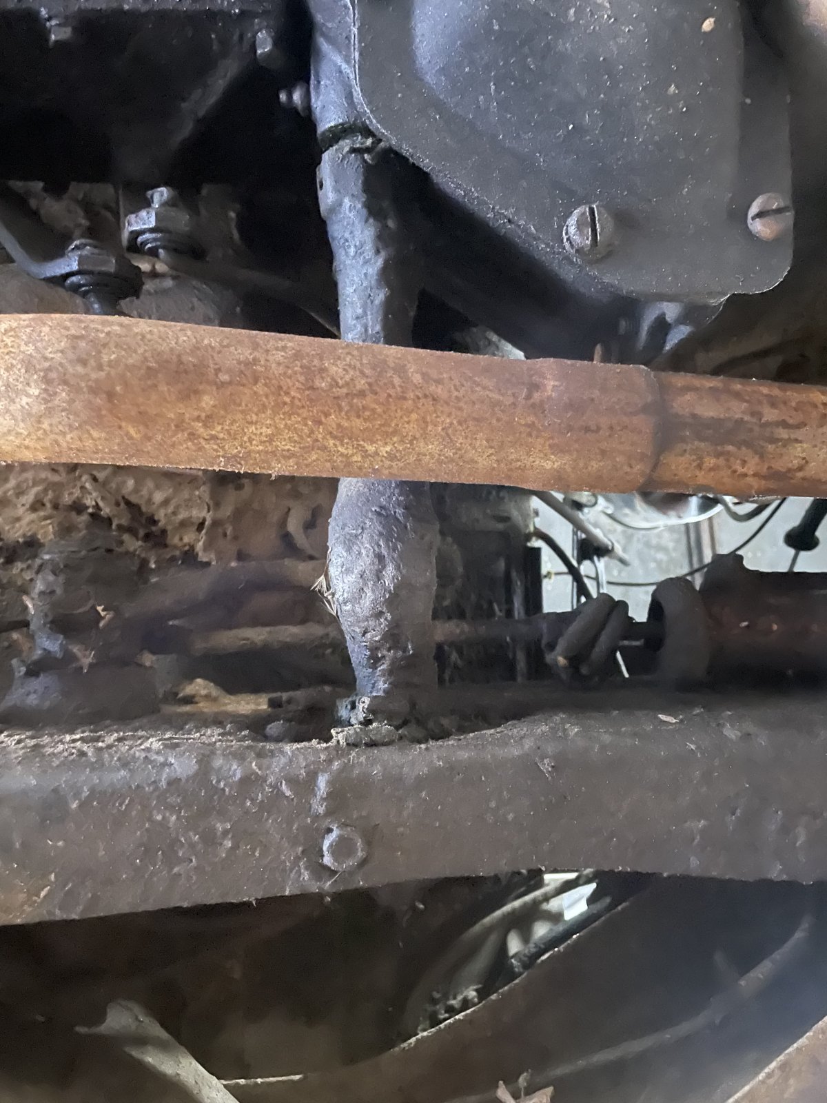

    anyway, up under the car looking at the clutch mechanism. Wondering if anyone modified the stock pedal to work a more common clutch fork?
    the other 51 I have looks to have the older style bell that would be easier to do a swap if needed.

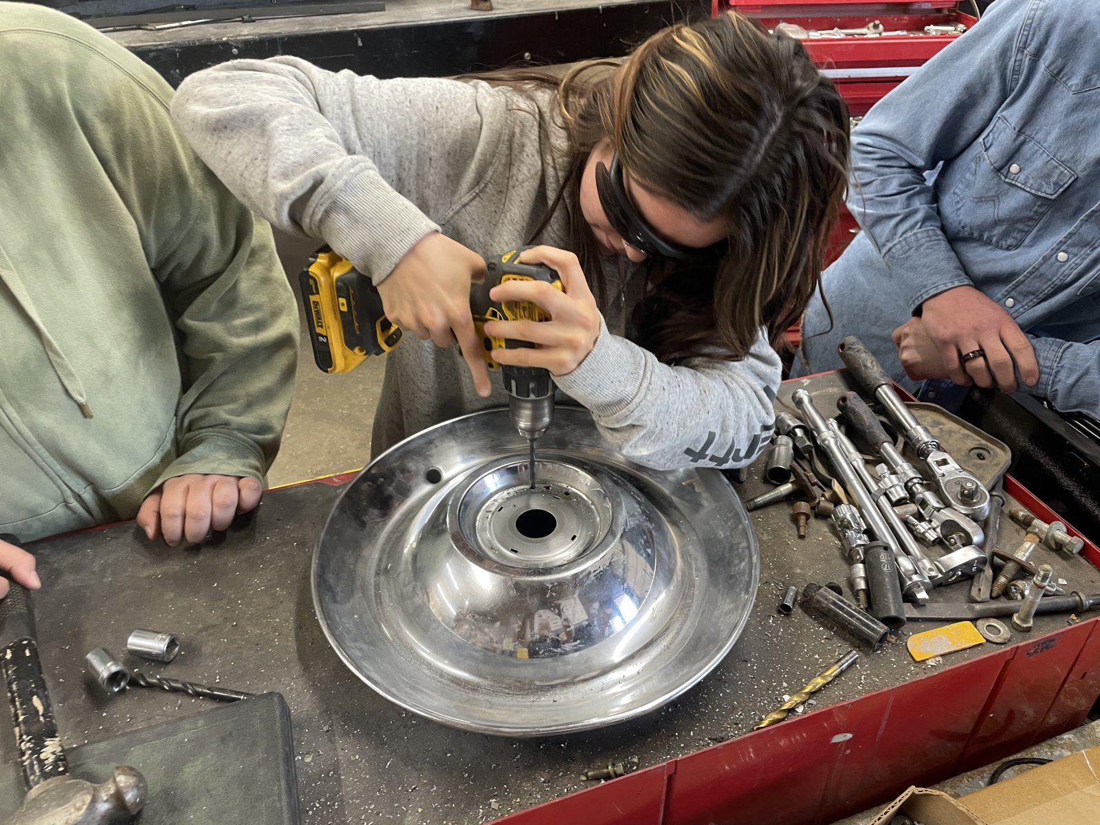

    I love everything I see but please have that young lady tie her hair back using that drill. I watched a woman drilling rivet holes in an aircraft skin pull a large chunk of her hair and scalp out when her hair got pulled into the spinning chuck.
  7. We talked about that.
    She usually has it tied back. She was leaning with her hair out of the way that caused her to halfway miss a couple welds.

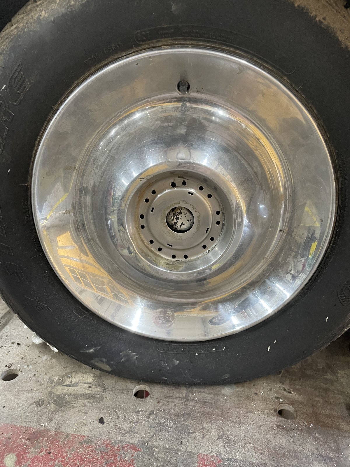

    The students working on he hubcaps are first year students. That was their first time to remove spotwelds.
